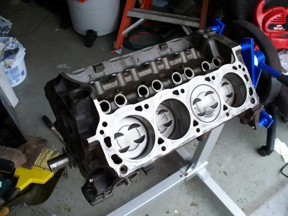

So yesterday I got the short block mounted on the stand, took off the oil pan and cleaned off anything visible:

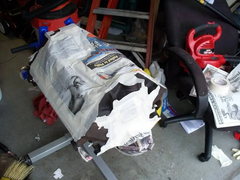

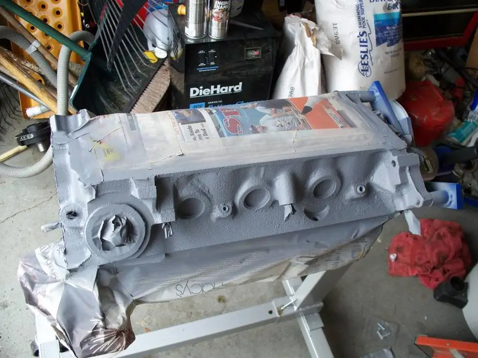

Then cleaned the block with degreaser and wax remover, and Dupli-Color Prep wipes, taped off all of the gasket mating surfaces, lifter valley, and crank case:
Four coats of Dupli-Color High Heat Engine Primer later:

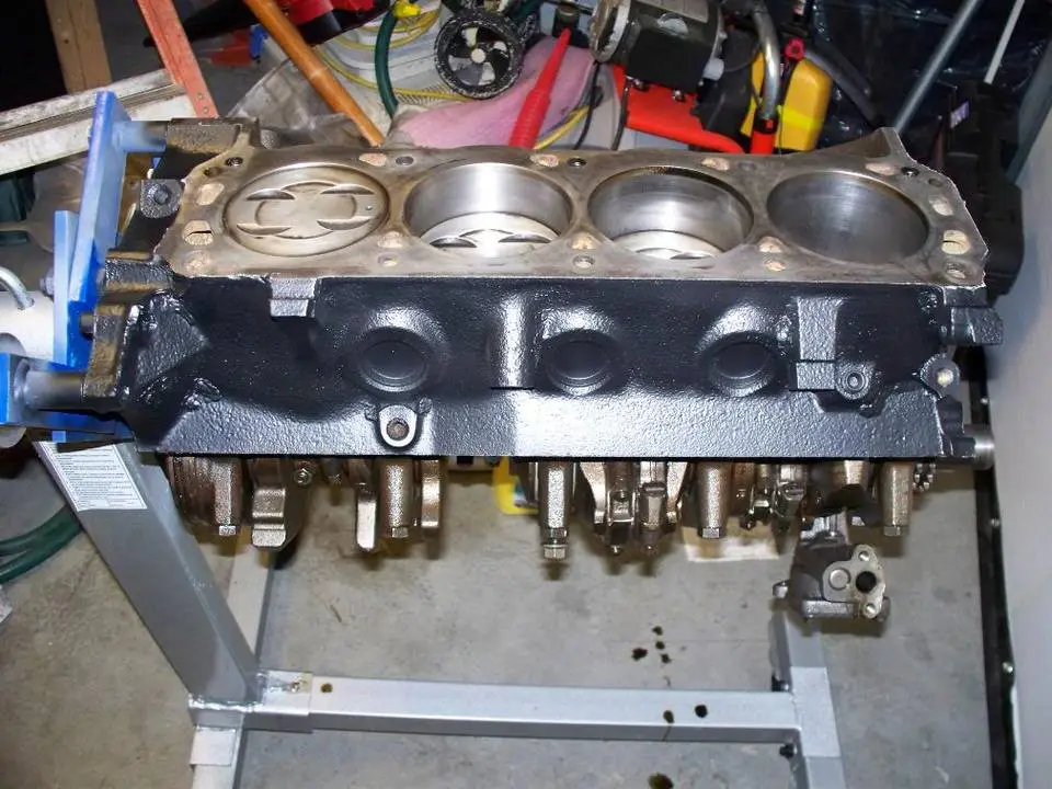

And four coats of Dupli-Color High Heat Engine Enamel, I chose Low Gloss Black for the color considering I have black TrickFlow valve covers going on and the black powdercoated Track Heat intake manifold:
Close up:

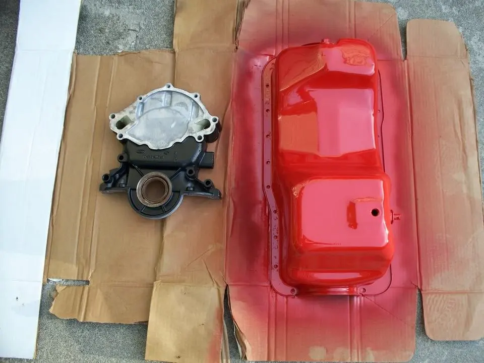

so today i had to do something, so i degreased and taped off the timing cover and oil pan and primed and painted them both... the oil pan came out really glassy and nice, can't wait for a speed bump to ruin that priming and wet sanding job :nonono: :rolleyes:

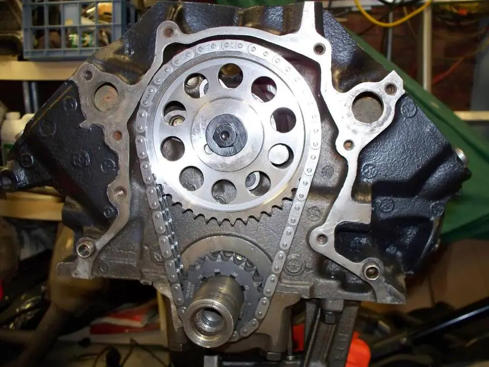

ughhh so progress has been SLOW on this engine build, some of it from inexperience, but most of it from having SH** luck... every part has given me a problem thus far, wait, come to think of it, every BOLT on every part has given me a problem so far... anyway, enough complaining... here's what i've got done so far

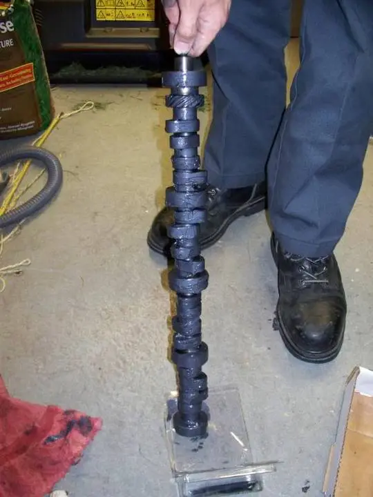

camshaft lubed and ready to be installed

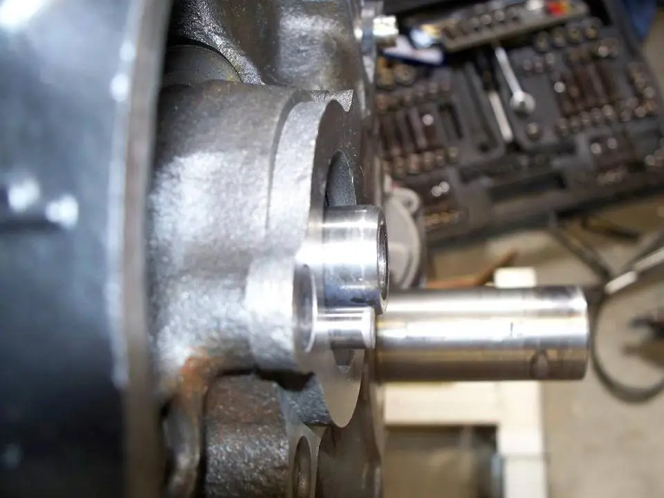

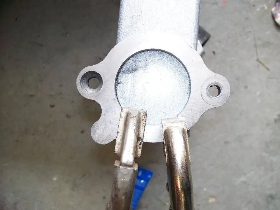

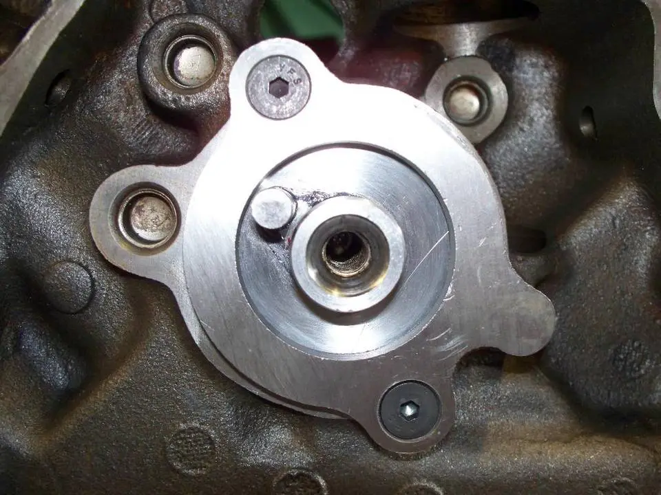

i had to countersink the bolt holes in my cam thrust plate to work with the bearing on my timing chain, this way the bolts sit flush with the surface of the thrust plate
here's a better view of what i mean
and a side view of the same

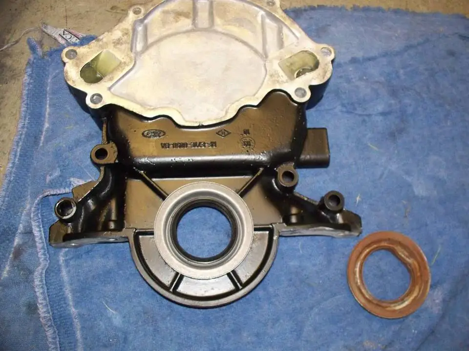

beat out the old front seal and put in the new one
timing chain installed

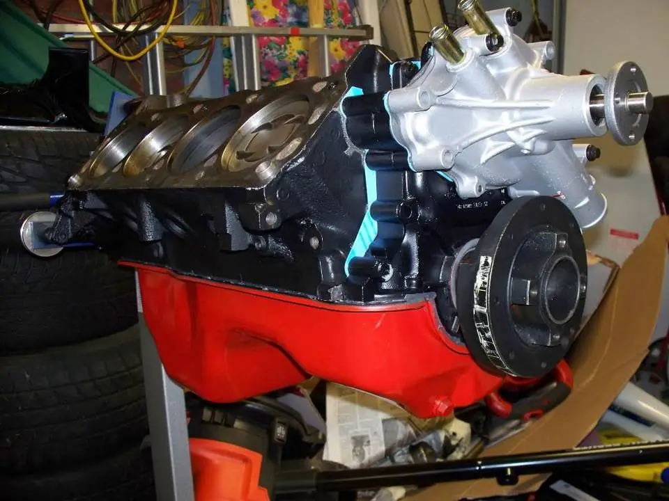

timing cover, water pump, and oil pan installed
next on the list are heads and valvetrain, stay tuned and let me know what you think!

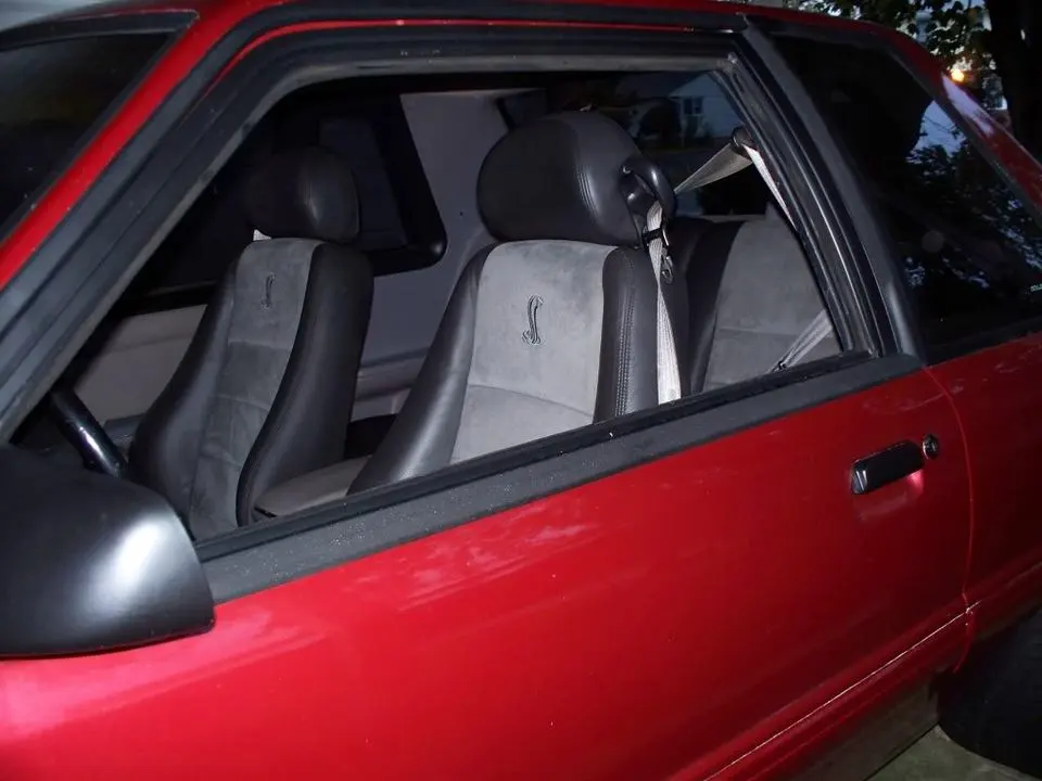

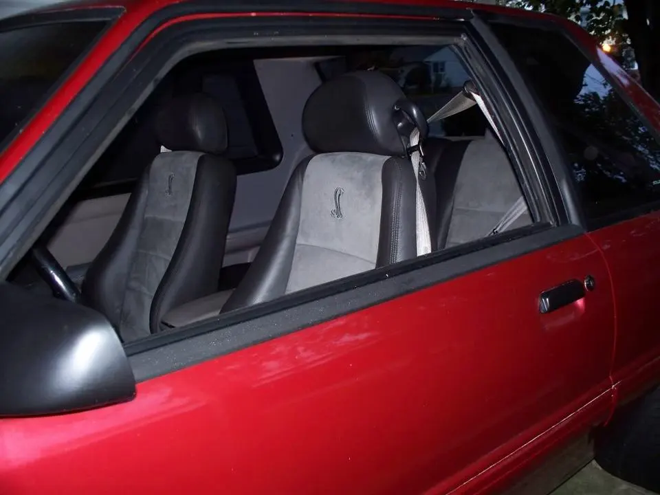

so a little update on what's been going on... i did a 3g alt upgrade, and in case anyone missed it i put seats from an '04 cobra in my car, here's a link to the How to thread and a pic of the finished product...

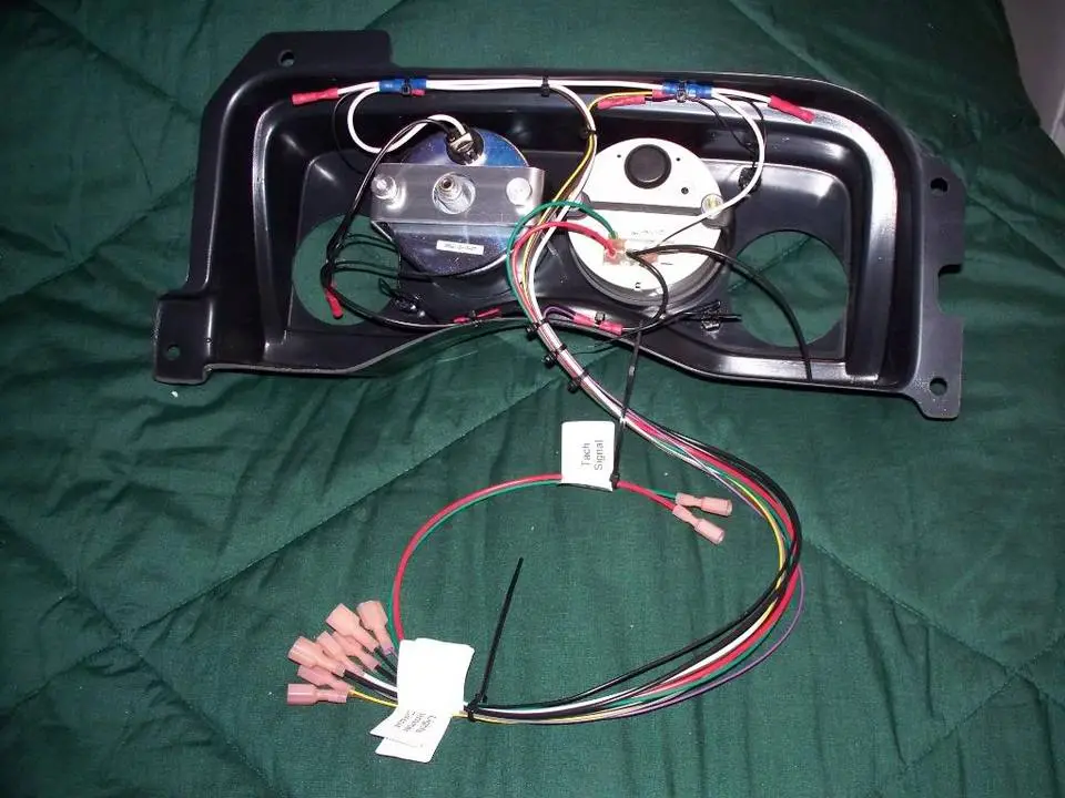

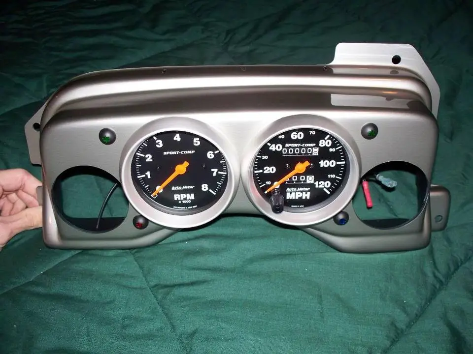

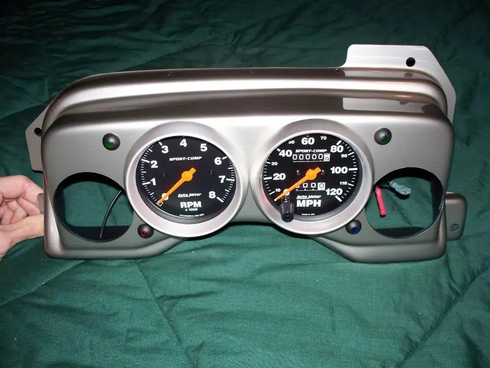

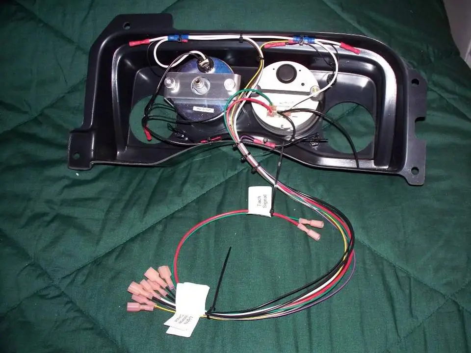

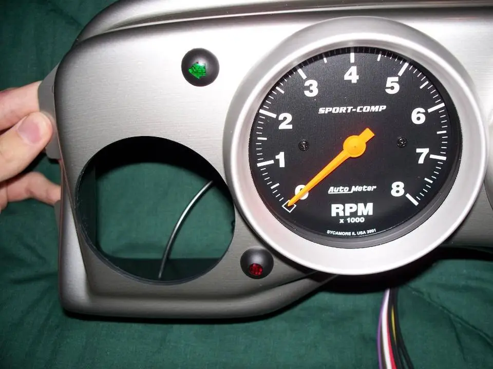

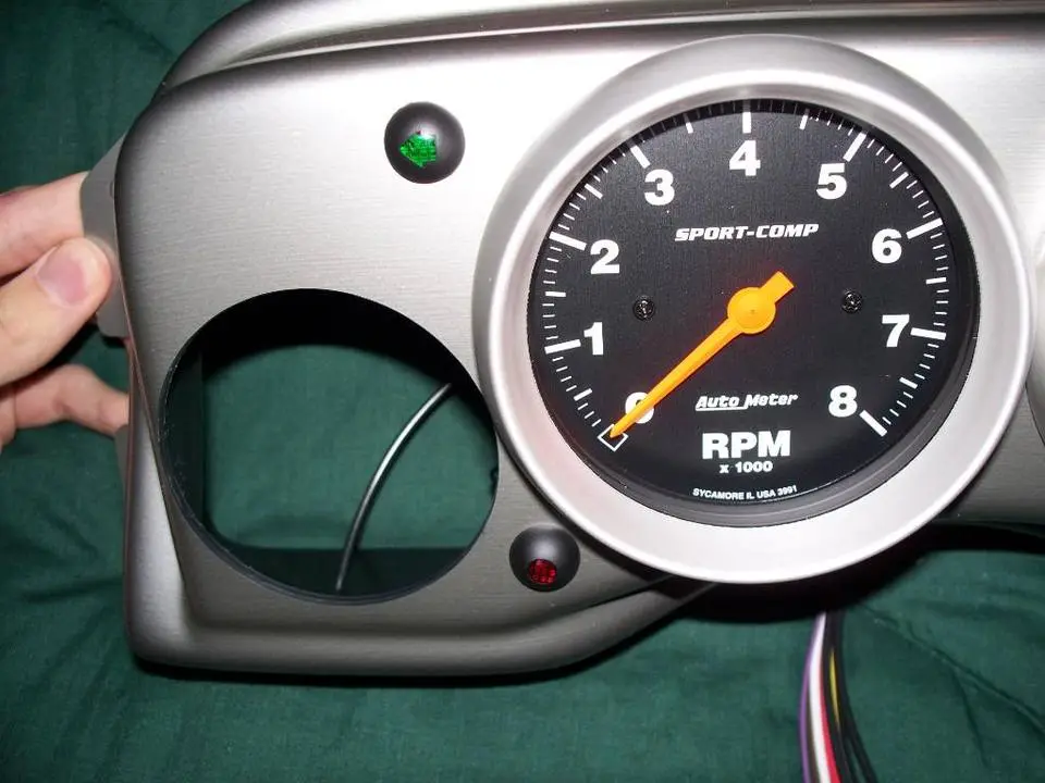

Florida 5.0 brushed aluminum gauge panel
all wired up
turn signal and check engine light

That cluster is gonna be crazy bro! I like it a lot. I also like the red oil pan on the black block. Can't wait to see more pics of the engine. I haven't stopped in this thread for a long time, sorry about that. Keep the pics comin!!
