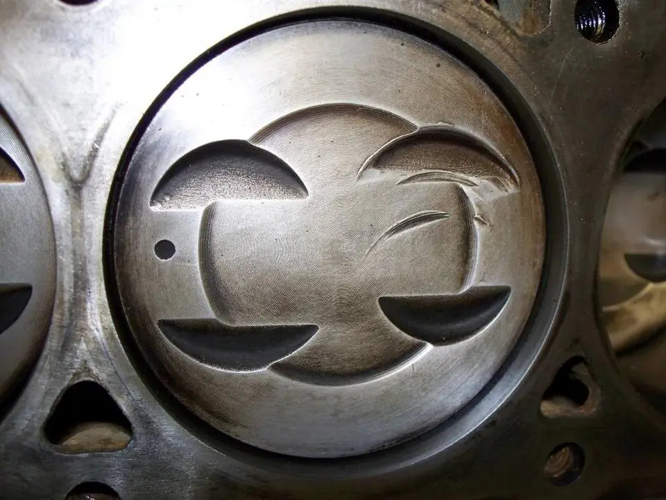

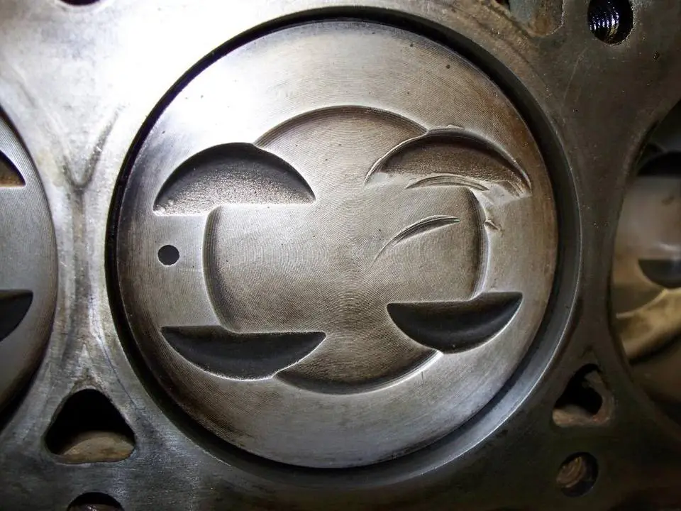

UPDATE: i forgot to mention that i'm actually not using the block shown in the early posts of this thread anymore, the #6 piston had a fairly deep mark on it from a valve striking the top of it... and i checked it with my dial indicator and it had more travel past TDC than all of the other pistons, i'm thinking maybe a rod bent slightly... it was a big disappointment but i'd rather not take the chance with all of these brand new expensive parts i'm using
but anyway... all of the parts shown on the block above were transfered to my stock shortblock, that only has 49k original miles on it anyway, and i know for sure it's good to go.... the shortblock with the bent rod is going to be rebuilt and freshened up to be dropped in a rolling chassis at some point... i'm going to flip over my old stock shorties and bolt a turbo on it... BUT that's a whole new thread altogether :nice:

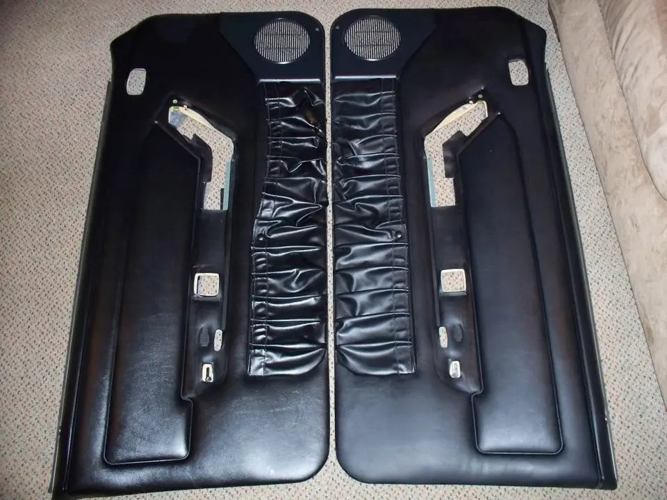

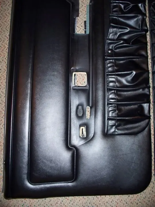

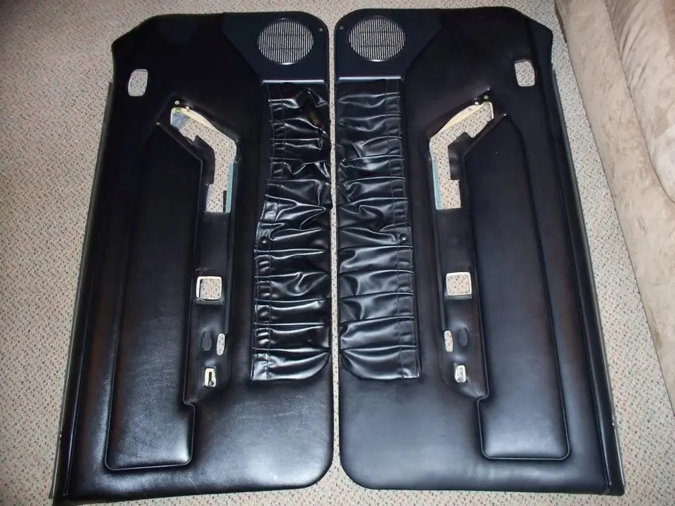

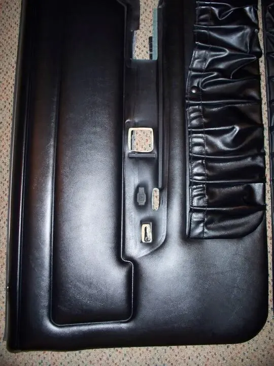

i cleaned up the OEM black door panels i got in the mail... these things were beyond dirty (they were in storage since 1996 :shock:) but i scored a killer deal on them and they cleaned up amazingly, check it out
i think i even have an idea to keep the map pockets from sagging on me...

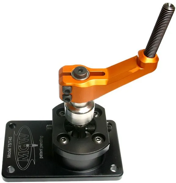

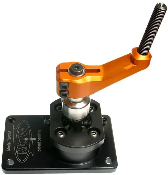

Chris, that shifter is BADASS!! I love it. It is quiet as can be. Just make sure the stops are adjusted right, I had my transmission shop adjust them when the trans was on the bench. You are going to LOVE that MGW!!!!!!!!!!!!!!!!!!
Sorry I never got back to you on those panels. I just couldn't get rid of those. I see you got some excellent condition ones. I ordered new map pockets on Ebay for Hack Job...50 resto has them too for about the same price though. I even sold my old saggy pockets on ebay for 20 dollars!! I couldn't believe it.

Thanks Matt!! I'm really excited to have the car tuned and running and to feel the new shifter... I've only heard amazing things from people who have them... MGW FTW!! I actually am kinda concerned about setting the shift stops in the right place, but i guess it will have to be trial and error?? :shrug:
oh and don't worry about the door panels, it's completely understandable wanting to hold onto those, OEM black are getting really hard to find for under like $275... i scored mine for $200 plus shipping... i don't think the guy remembered how good the condition was, they were covered in 1/8" of dust and cobwebs when i got em :nice:

My transmission shop explained that what they do is just insert the bolts and the locking nuts, then they shift the transmission into gear. They place a thin...and I mean THIN feeler gauge between the shifter and the stop bolt and lock it in place there. The gauge was almost as thin as a peice of paper. When it stops you should still be able to pull out and reinsert that gauge. That's how they did it and I have no complaints. They also did the MAC shifter in my old black notch.

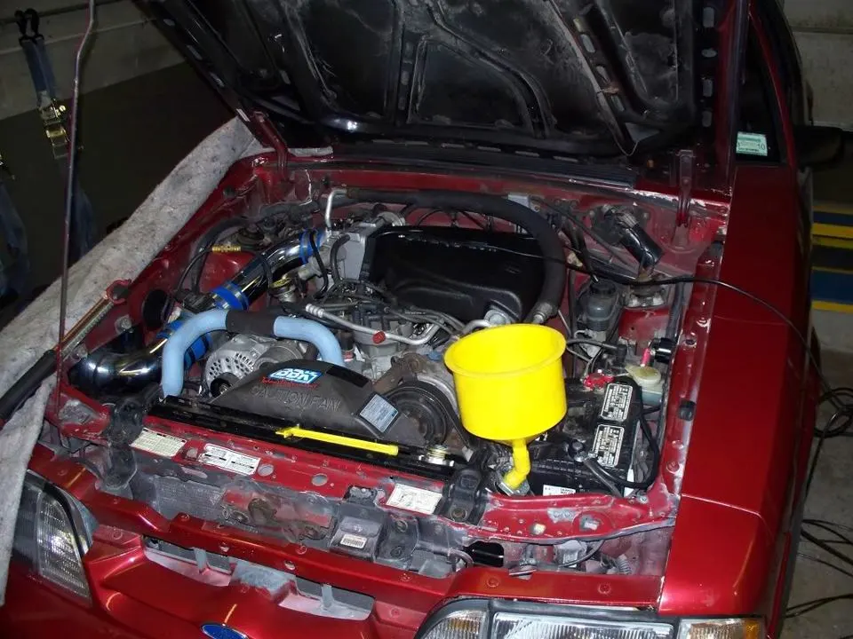

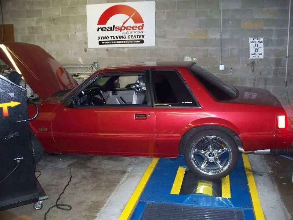

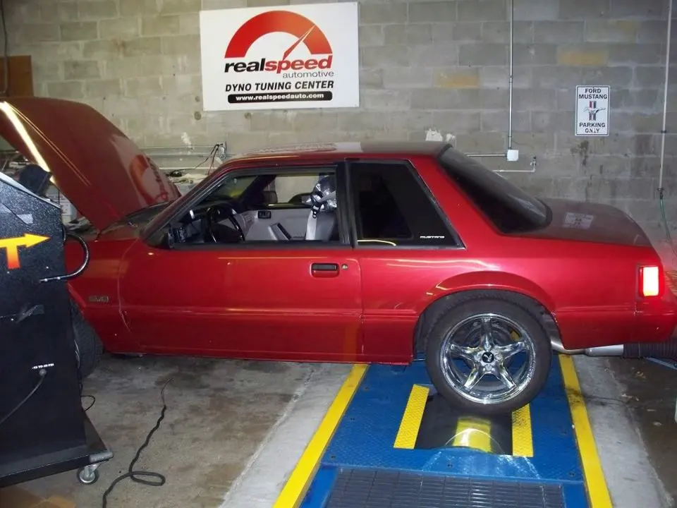

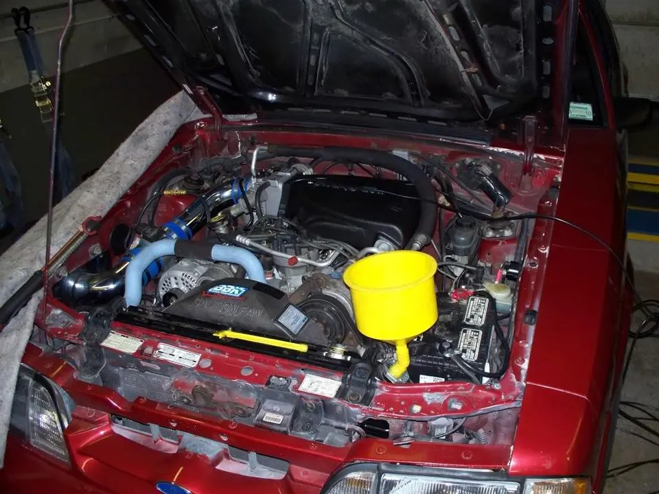

OKAY... so due to delays at the shop my car didn't make it onto the dyno until late this afternoon... i was really concerned with my rockers being loud so they're investigating why i have so much valvetrain chatter as well, he only did a few part-throttle pulls before i got there, and i managed to snap a few pics of the car strapped to the dyno and a really crappy walk around vid where the car's NOT EVEN RUNNING :rlaugh:
so, anyway, i'm going there tomorrow morning to take a video of some full throttle pulls and finally pick the car up and pay the guy... WORST UPDATE EVER, but this will have to do for now :D

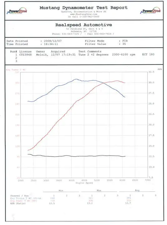

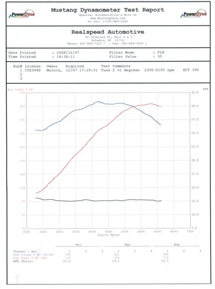

I got the car back tonight!!!!112!!11@1!!!! :D :D

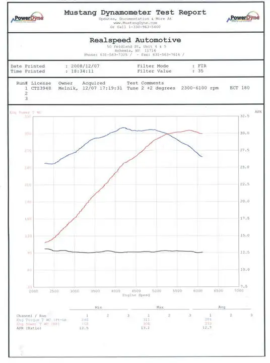

The car made...
306HP/311TQ​
Unfortunately, the car was unstrapped and finished being tuned by the time I went to pick it up, so I wasn't able to get a video of the dyno tune :( It definitely SUCKS but I'm too excited about how the car is running and the numbers it made to be upset. I put about 50 miles on it tonight when I got it home (before it started to snow!!!) and it feels STRONG to say the least. The owner and guy who tuned the car said it was pretty rare for H/C/I cars to hit the 300 HP mark on his Mustang Dyno... he said most range from 265-285. He was impressed with Jay Allen's (camshaftinnovations.com) craftsmanship on the cam, as am I. The setup Jay designed for me was everything he promised and more!
