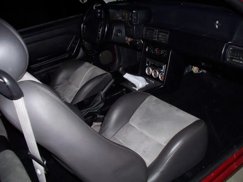

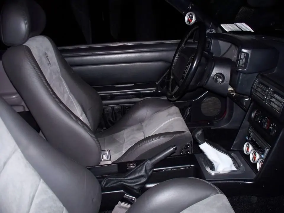

I really like your seat choice, looking really good.
Thanks Terry, '04 cobra seats I pretty much stole from a wrecked car :nice:

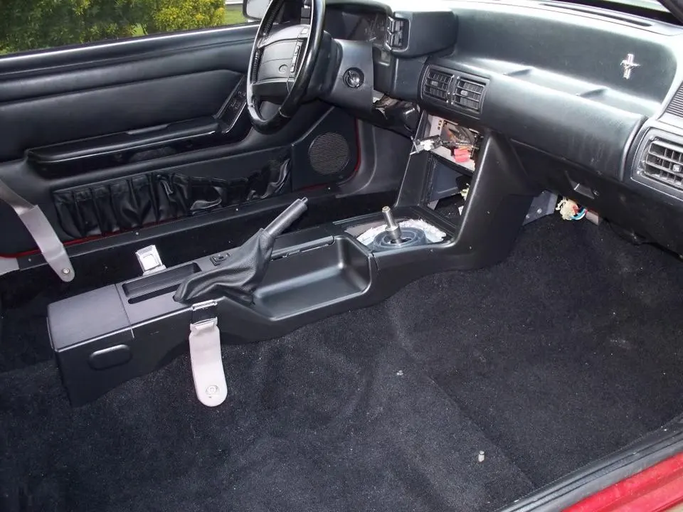

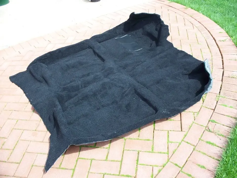

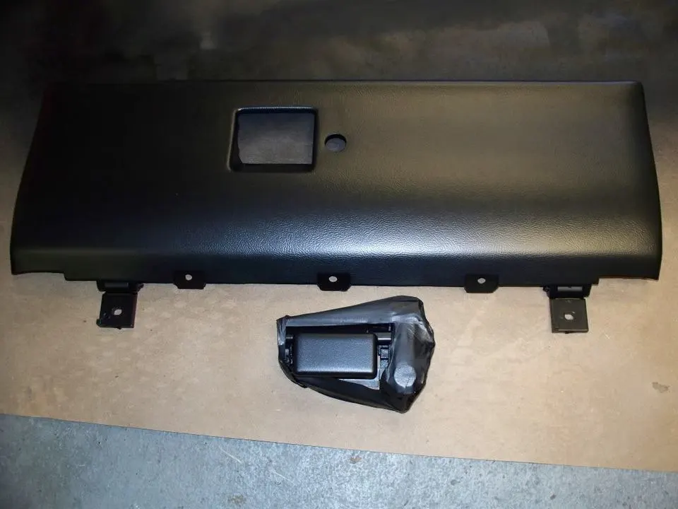

Well... today was a LONG day working on the car. Last night I disassembled, cleaned, prepped, and sprayed my center console and glove box door. Today I changed out the carpet and reassembled everything. ACC makes a quality carpet, but what a complete PITA to install (especially by yourself). All I have left to do is get the headliner recovered and paint the interior quarter panel trim and I'll have a complete black interior!
The interior is really dusty and dirty in these pics, but it's 10 pm and i'm too exhausted to clean it up now. Check it out and let me know what you all think.
glove box door and handle painted up, i didn't get a shot of the rest of it painted for some weird reason

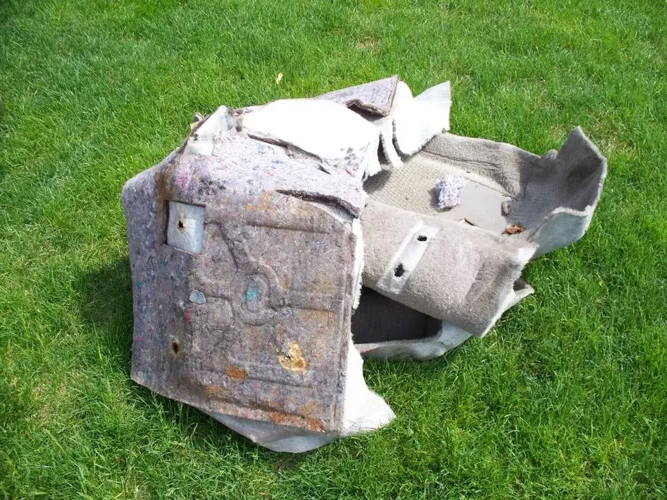

old carpet that i wrestled out of the car against its will

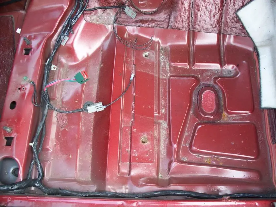

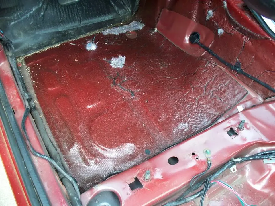

ooooooooh yeah! those are some clean floor pans, i'm glad i bought a california car :D

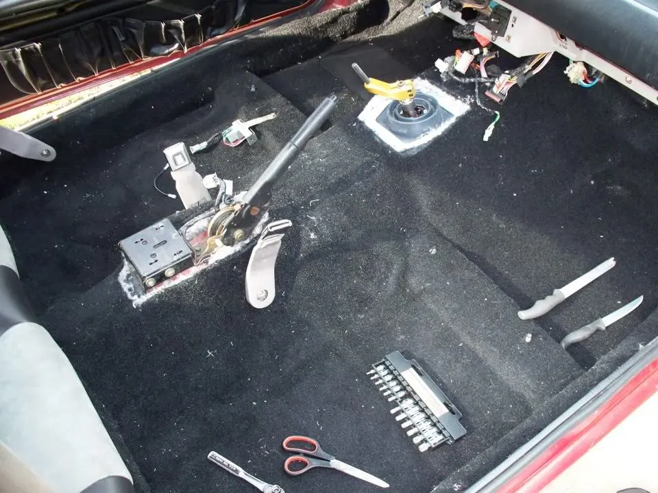

new carpet warming up and getting pliable in the hot long island sun
halfway through the installation
a little further...
and the (almost) finished product

you interior looks great, makes you feel good that you did it all yourself, did you use SEM paint?

thanks! i did use the SEM color coat... i used dish soap, grease and wax remover, tack cloth, prep spray, adhesion promoter, and "Landau Black" SEM color coat... the stuff is amazing!
it took some customizaton and trimming, i cut the ring off the old shift boot and removed the old staples holding it in place, i then threaded heavy wire through the staple holes in the ring and through the base of the new shift boot... fairly simple but just takes some patience
