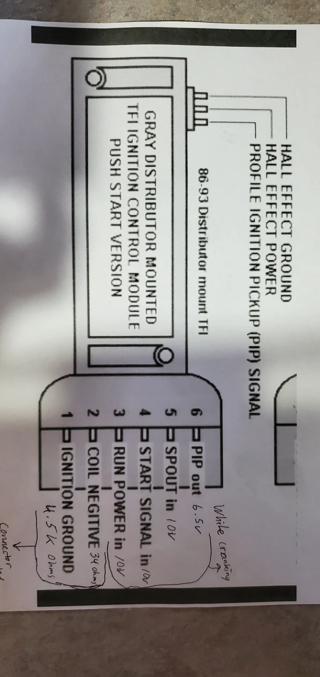

Ok so I checked for voltage at pin 1 at the ECU and there is 12v with key on and off and 10v while cranking. I checked voltage and resistances at the TFI connector and wrote them down on a diagram which I will attach

Basic things that you need to provide in a thread like this.
Stick or Auto?
Mods
Any codes?
What were the name brand of the parts that you used to replace the existing parts and why did you replace them?
The check engine light (CEL) only illuminates for emissions related codes. There can be codes and no CEL so if you have not scanned for codes please do so.

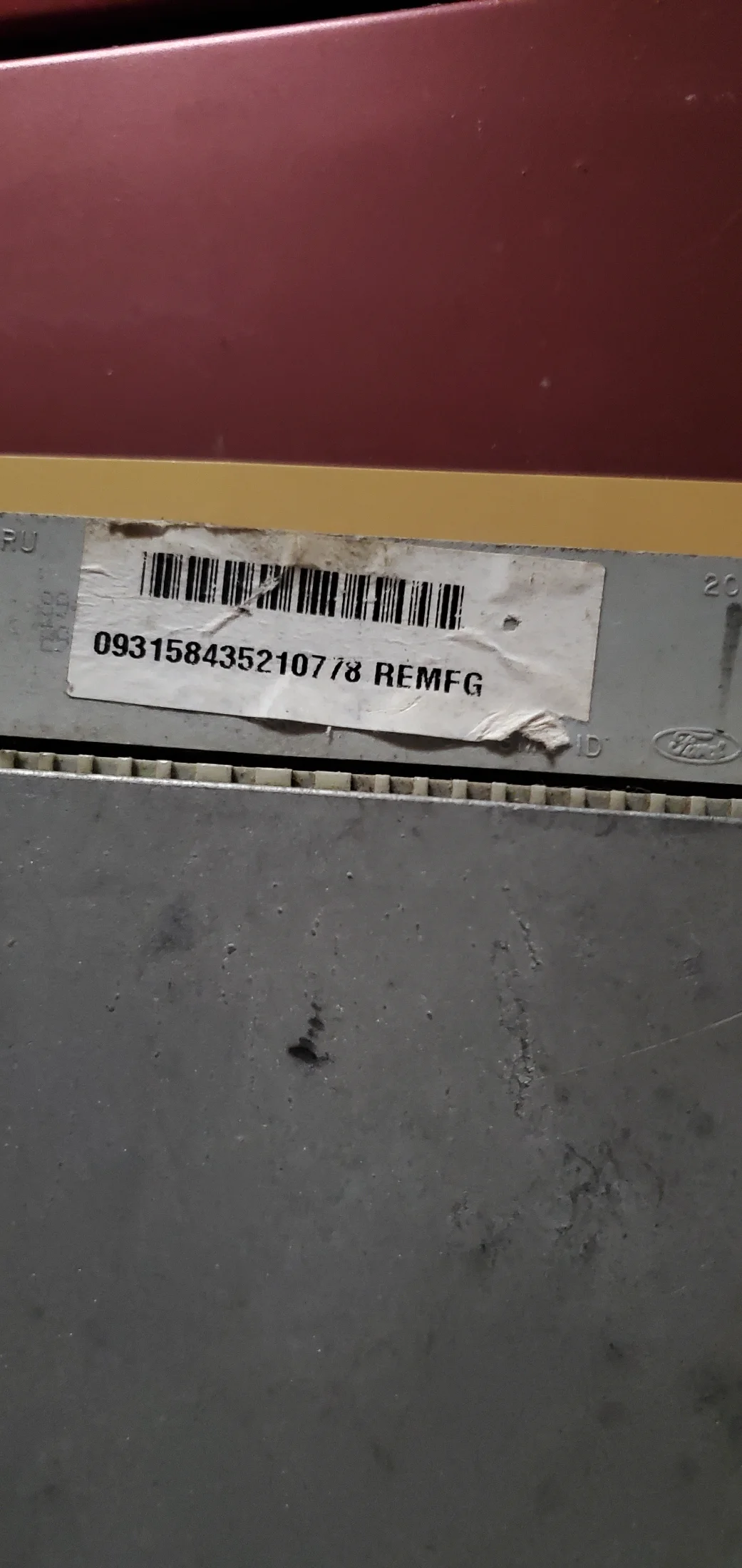

Ok so I believe it is the ECM. I checked resistance between the ignition ground circuit from the TFI plug to chassis ground and the ECM case and got 5k ohms of resistance. Then I went from TFI ignition ground to pin 16 on the ECM and got 0.5 ohms of resistance. Then I went from ignition ground pin 16 on the ECM to chassis ground and still got 5k ohms of resistance. I checked ECM ground to chassis ground and got 1 ohm of resistance.
We will all pray for the resurrection of your ECU.
So at this point I'm assuming there is something wrong with the ignition ground circuit within the ECU board. Also I believe that the ECU is a remanufactured ford ECU

My problem is that it is a reman ECM and the sticker on it says A9L which is for a V8 5 speed and my wifes car is a V8 Automatic which needs the A9P but unsure of the calibration

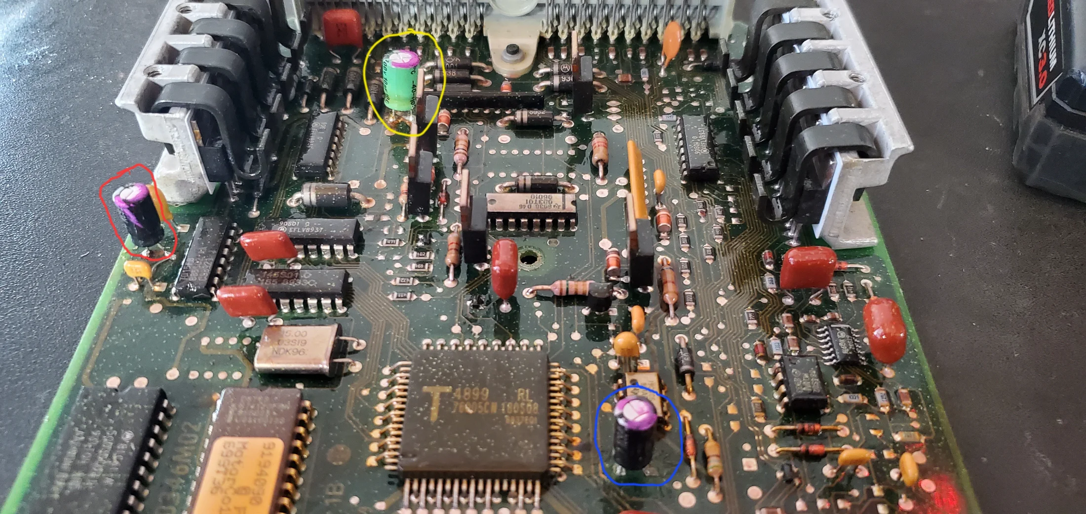

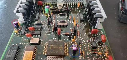

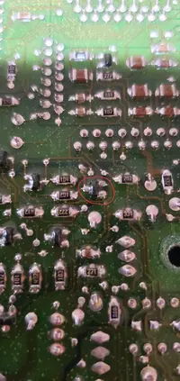

Open up the ECU and let's see the capacitors....

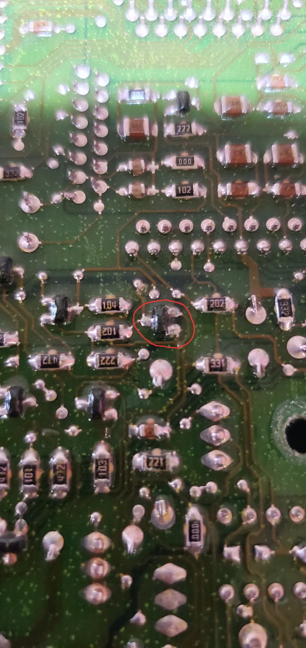

So I circled the capacitors. The one circled in red has 37k ohms of resistance. The one circled in blue has 622 ohms of resistance. The one circled in yellow has 5.6k ohms of resistance. Now in the close up photo of the backside of the ECM, the object I have circled in red has 3.5k ohms of resistance
