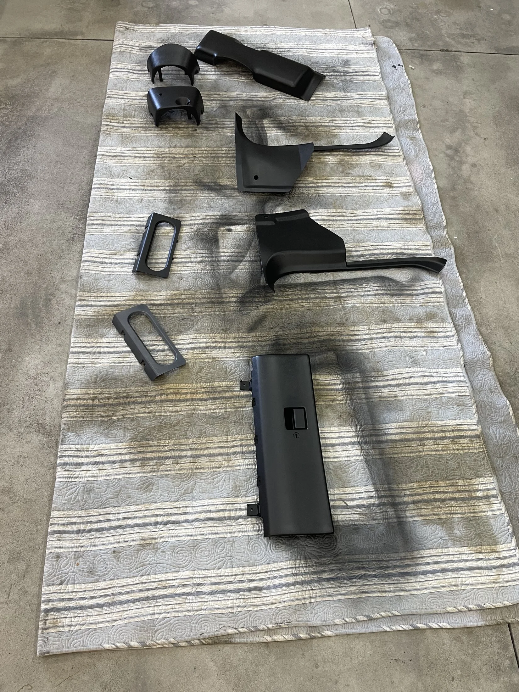

Ah good to know. I'll be doing the same. Going to start dying some trim next while the harmonic balancer is in transit. I think I'm going to do some touches of opal grey to offset the black a bit. That's the color code of the original interior. It's either do that or all black....I think some grey touches would look nice. Curious what lurks behind the door panels as well.

Small update....dying some trim pieces. I'll yank out the center console and do that tomorrow. After that, I'll be opening up the doors/door panels.
