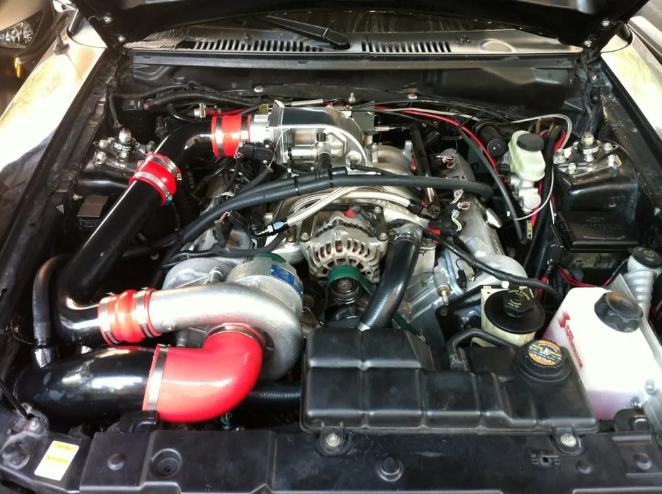

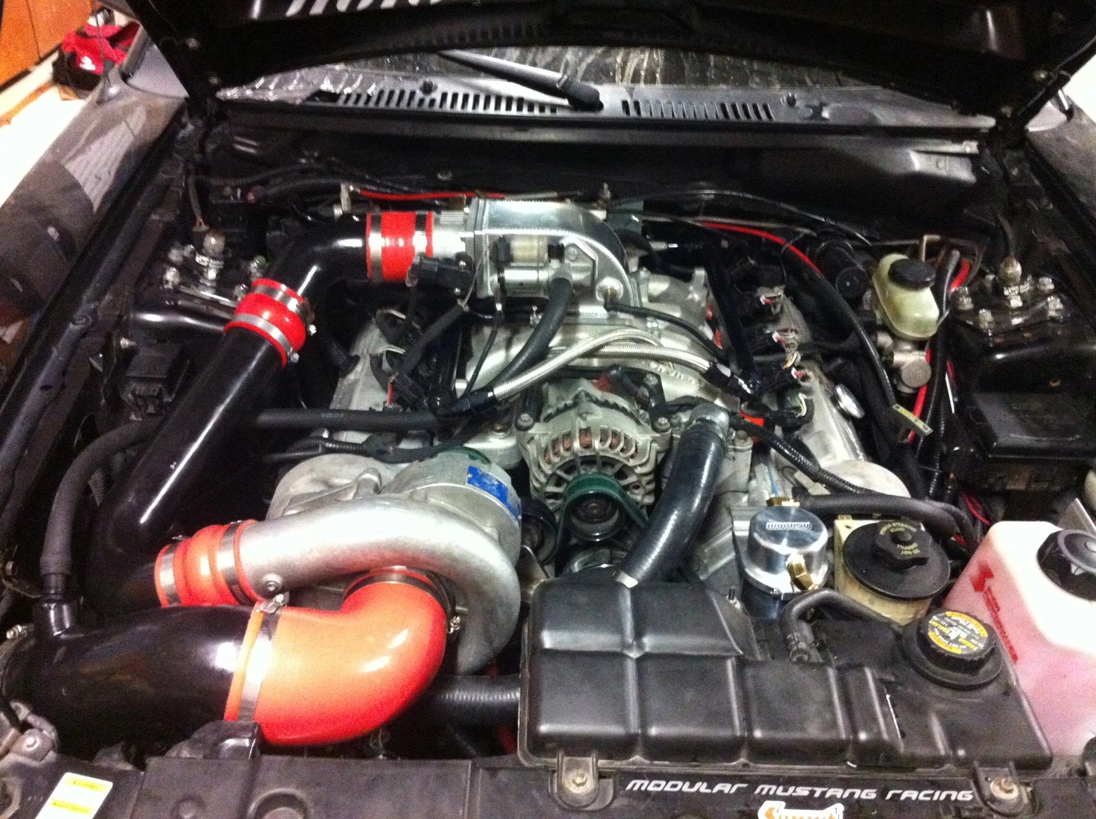

Got a lightly used V2 SI in the mail yesterday. Got her bolted up to the car and she is running again! Still going with the 2.78" pulley. Hoping it will make 17psi or so when I get her tuned out again. I think I am going to get a FMIC first, I have ton of other things to do as well though.

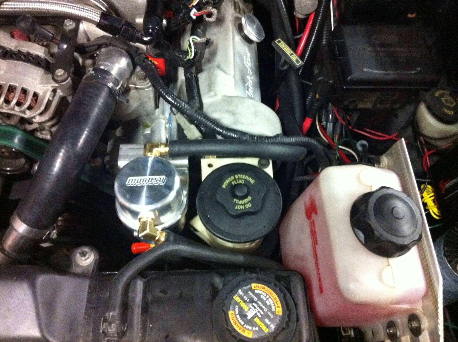

Still waiting to iron out some last few kinks before taking her back to the dyno. My idler pulley behind the SC has a bad bearing, fixing it next week. Hopefully get on the rollers sometime in Jan. Been a CRAZY end of the year. I have been doing other work though. Had an issue with oil leaking from my valve cover vents so I went with a Moroso Oil/Air separator, as well as changing up some other parts of the vacuum setup. Making more boost than ever before! Can hit 15psi without taking going all the way to red line, with meth. Here's a pic of the installed Oil/Air separator.

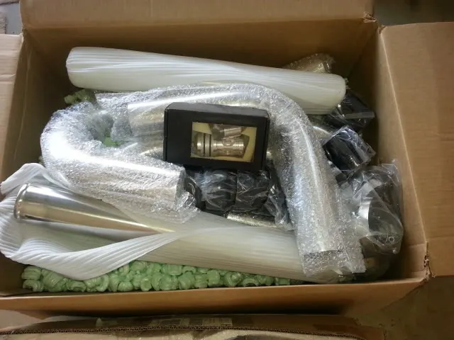

Got some stuff in the mail last week. Last few things on my list before the final tune. I got a 3" universal piping kit. I'm going to have a friend of mine tig weld it. Bought new t-bolt clamps for everything else.
