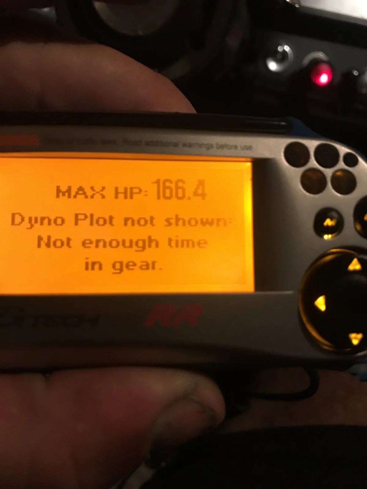

166.4 horse power! is not worth celebrating.lol.
Does anyone remember the "G Tech" ? Ahh 90s technology. (I know an 8$ app will do this now)
Now that the Mutt II is running pretty good, I pulled the meter out of moth balls and spent the last week fiddling with it.
Kind of Surprised it still works .
Listed car weight at 3300 so numbers might be inflated
Best so far is long 2nd gear highway pull
better than all the 90 hp readings on stock 1 to 2 shift
Haven't got a good 1/8 mile reading yet still trying.
This is not Flywheel or wheel horse power but net horsepower used, what ever that means
Math
166.4 HP X 1.25 (Autotrans calc) = 208HP at flywheel
The 1966 ~ 2 barrel 289 was rated at 200HP
This Has stock 5.0 cam, HEI, and the 390ci two barrel carb on her.
Wonder how close to reality this is?
Is that the wrong trans calc?
Maybe I should use a different car weight like 3600? for my fat ass.
Whats a mustang 2 weigh loaded?
I know at this level of horse power no one really cares and it is barely above boring.
But its funner to drive slow cars fast than fast cars slow!
I just want base lines for the improvements to come.
That was using the old SAE "gross" horsepower measurement, taken at the flywheel, with zero accessories mounted to the engine.
You're running an engine that was officially rated at 139 "net" horsepower at the flywheel, with all of the engine-driven accesories installed.
166 estimated at the wheels means you're making roughly 200 at the flywheel for what it's worth. ElSuperPinto only put down 267rwhp on a chassis dyno, and she's a 12-second car.

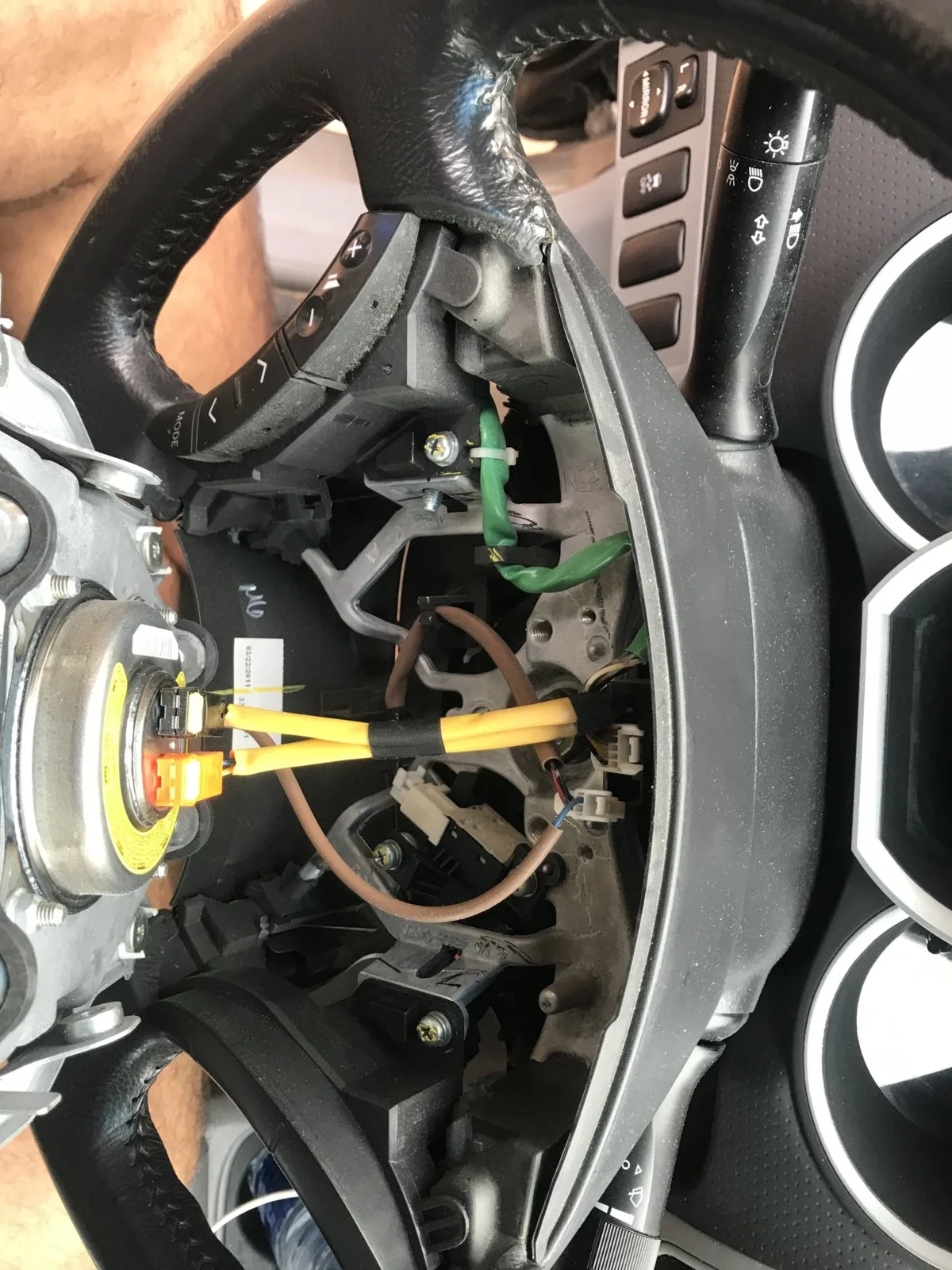

This is me changing the clock spring on the toyota to get the horn to work.
Deathly afraid of that Takata Airbag in this high humidity environment.
I lived thru it and the horn as well as the rest of the steering controls work again

Even a Takata airbag can't deploy if the system's de-powered before you work on it.
What's REAL sketchy is when you're having to diag an intermittent open or short with the airbag removed, but still plugged-in while the car's running.

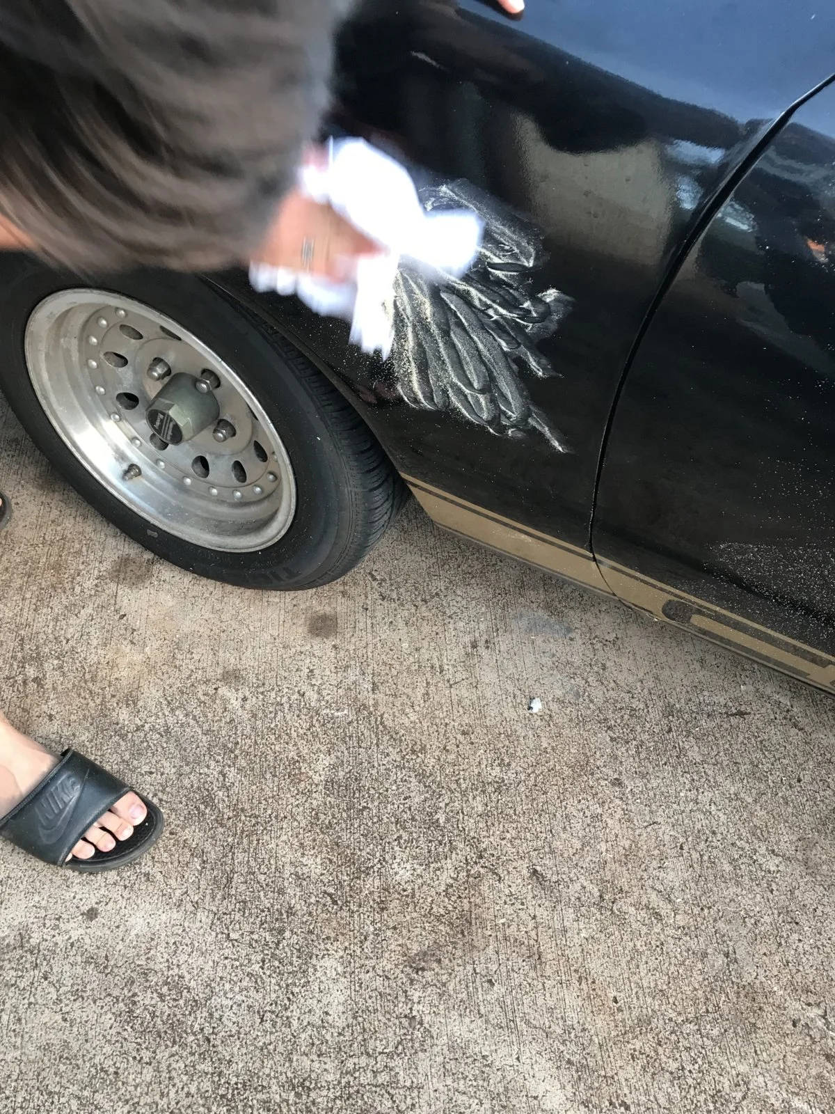

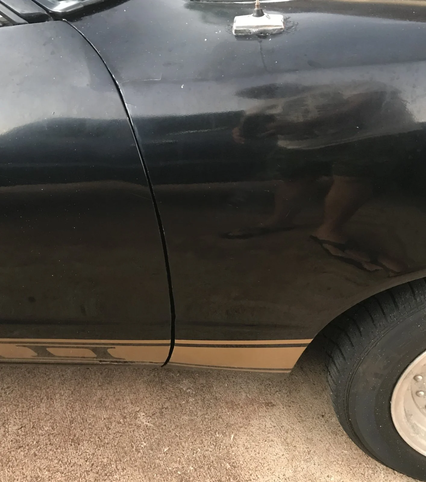

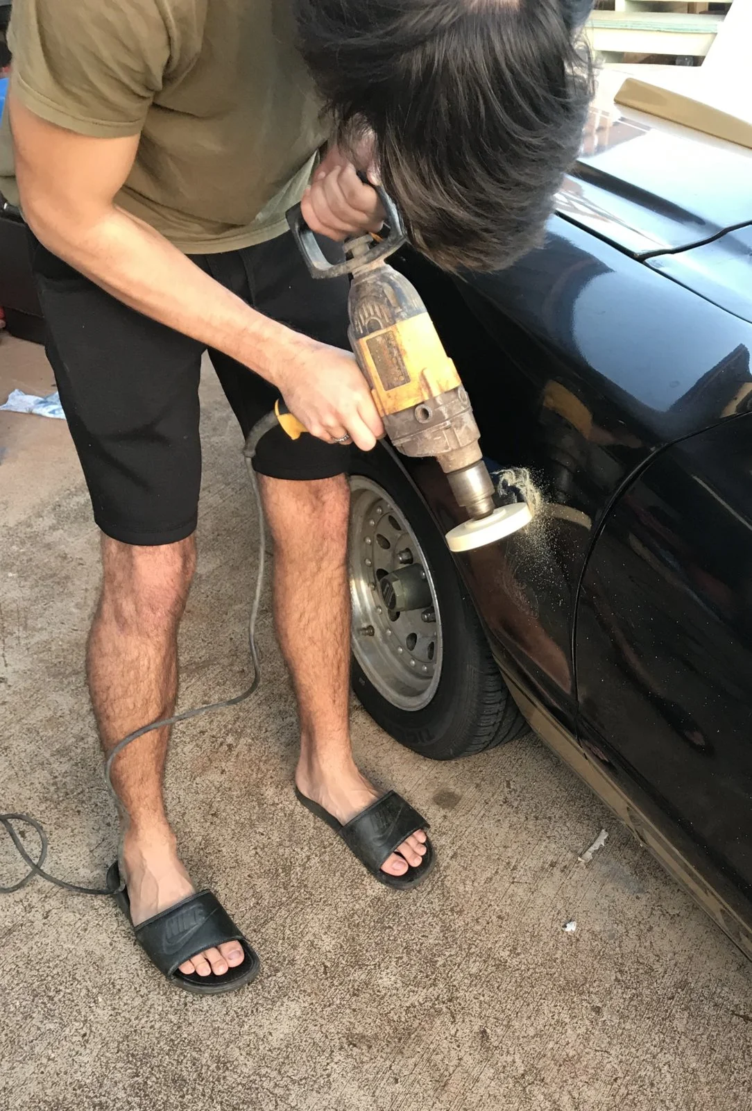

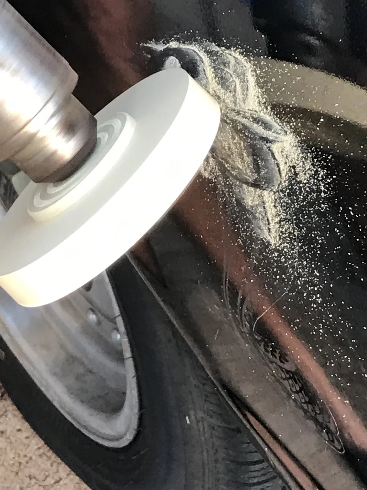

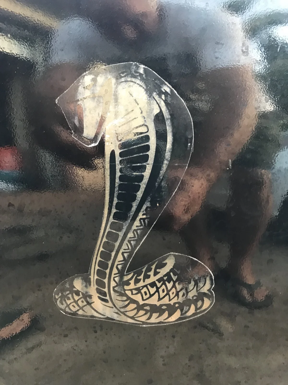

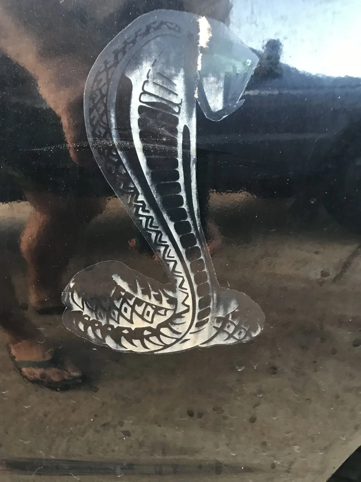

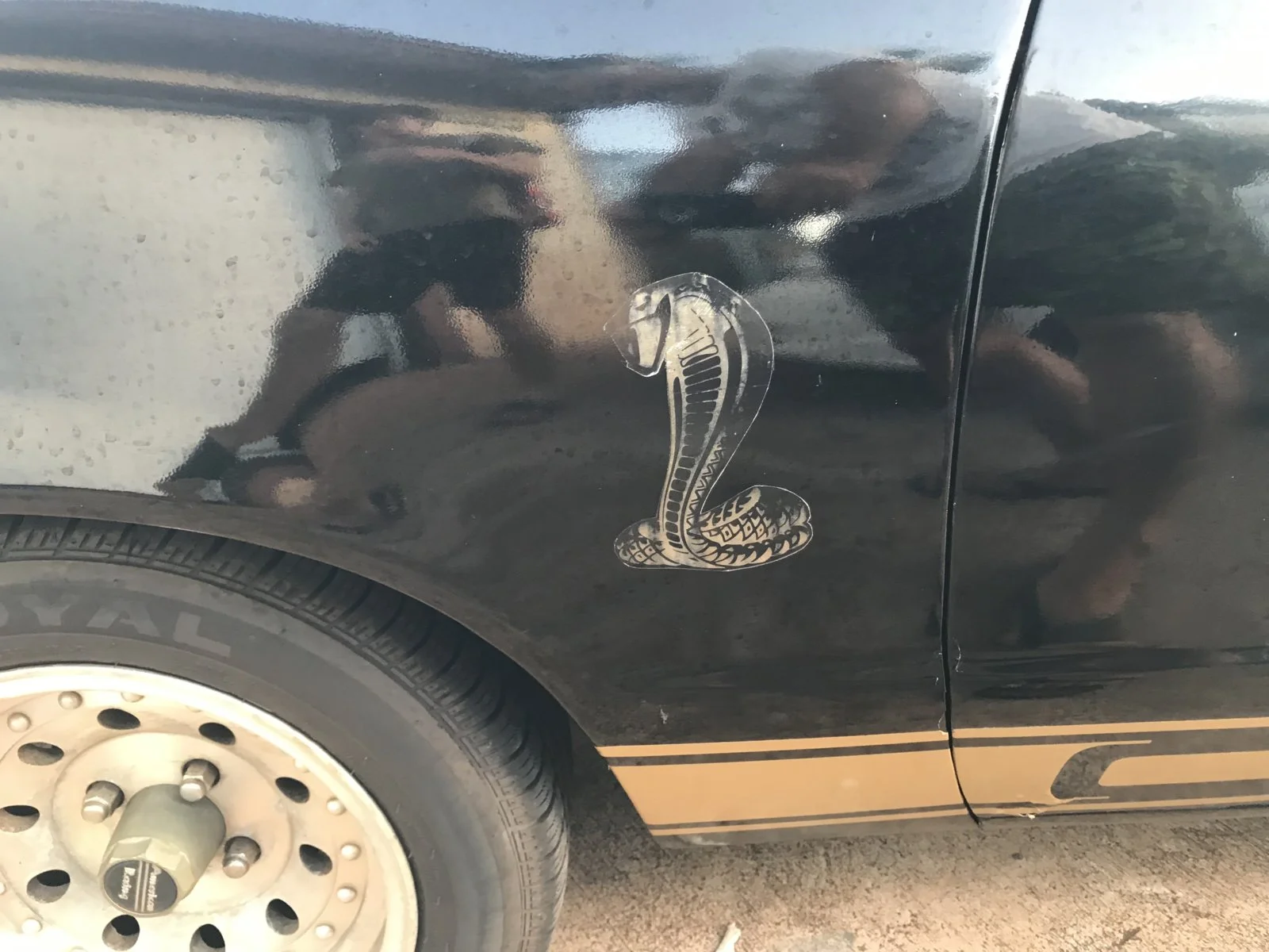

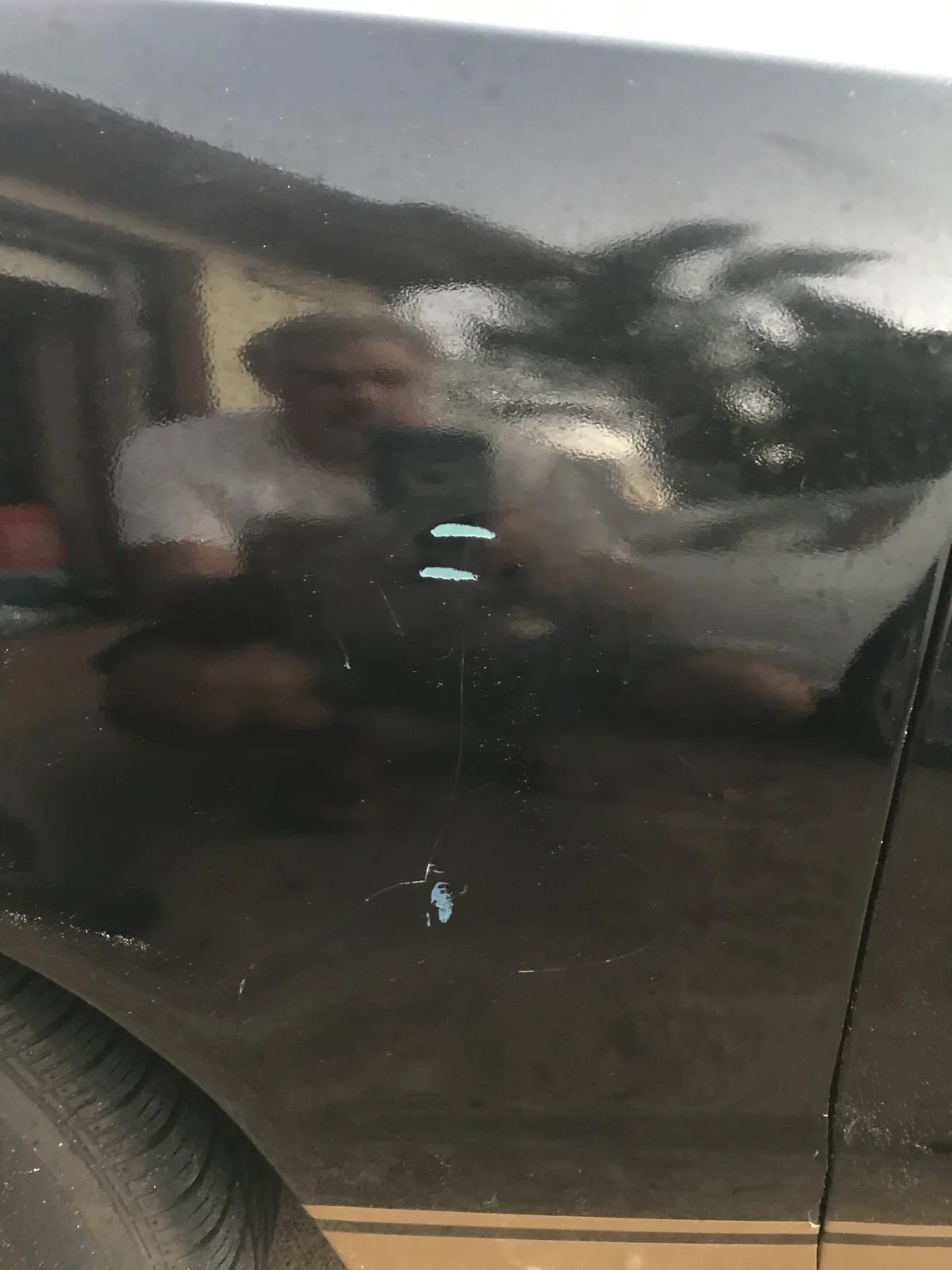

This poor snake has deteriorated .
Now that it is out in the Hawaiian sun and getting washed regularly it looks crappy
Other side is worse. You can see where the head folded during its install 12 yr ago.

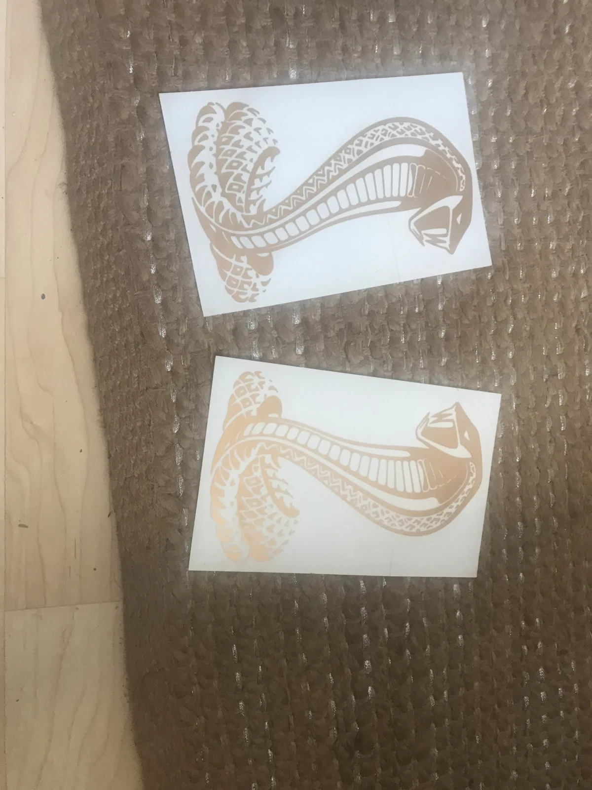

I want to buff this spot once and then have the offspring install the new stickers.
I never cared for the over badging on these cobras but want to keep stock appearance as much as possible.
Reactions: Olivethefet
I didn't like the massive amount of decals either. That was why I went all black when it was repainted WAY long time ago. But, now I want all of them back. I have a set waiting for that day.

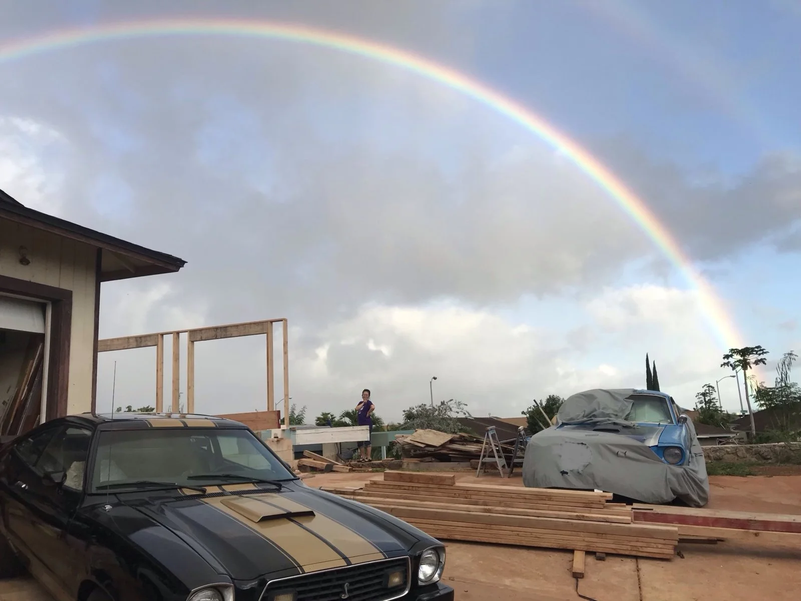

Todays double rainbow
House addition creaping around to front
Just bought Ole Blue a new cover but she still stuck behind a pile of lumber.
Turkey day is a coming!

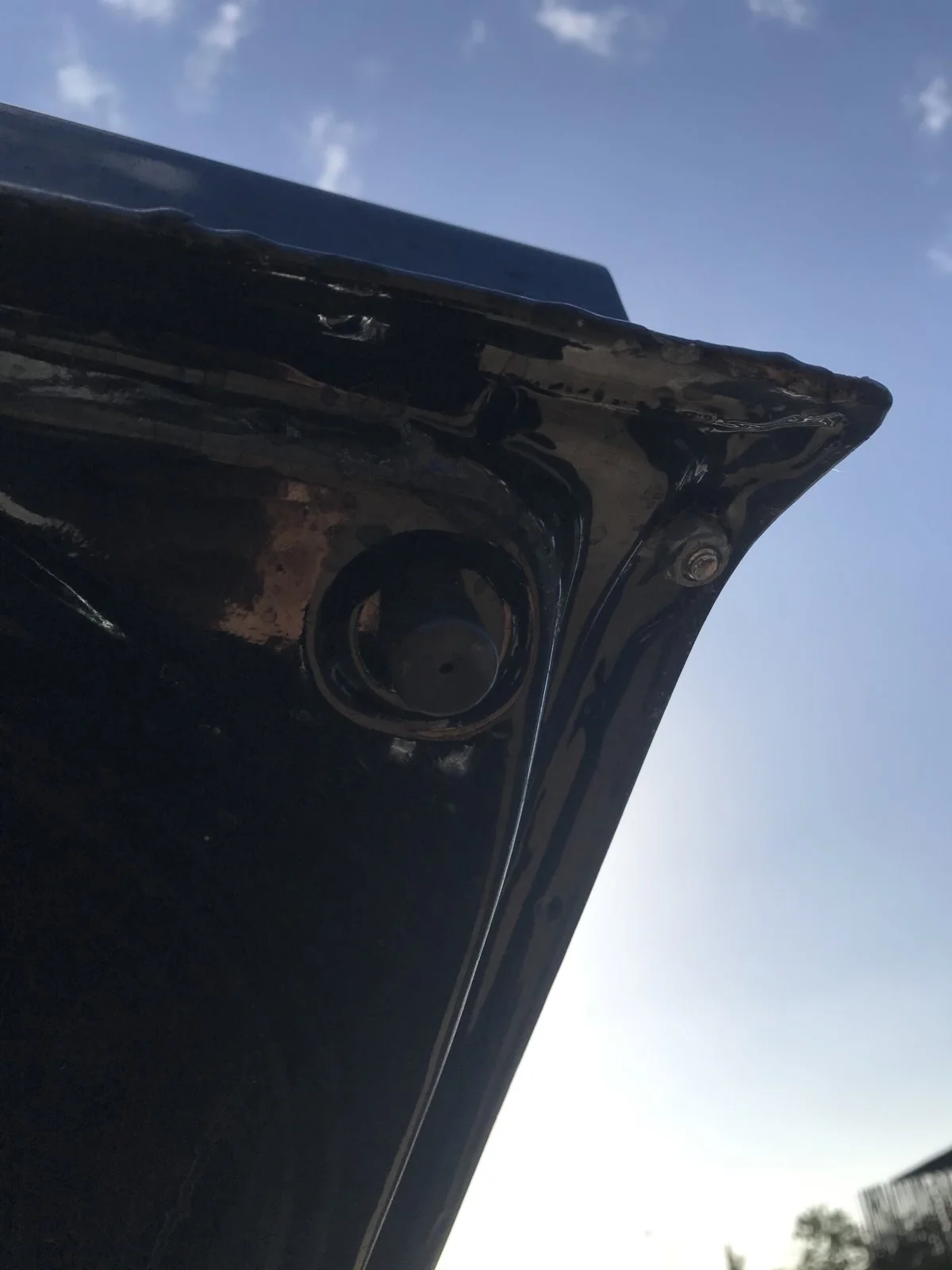

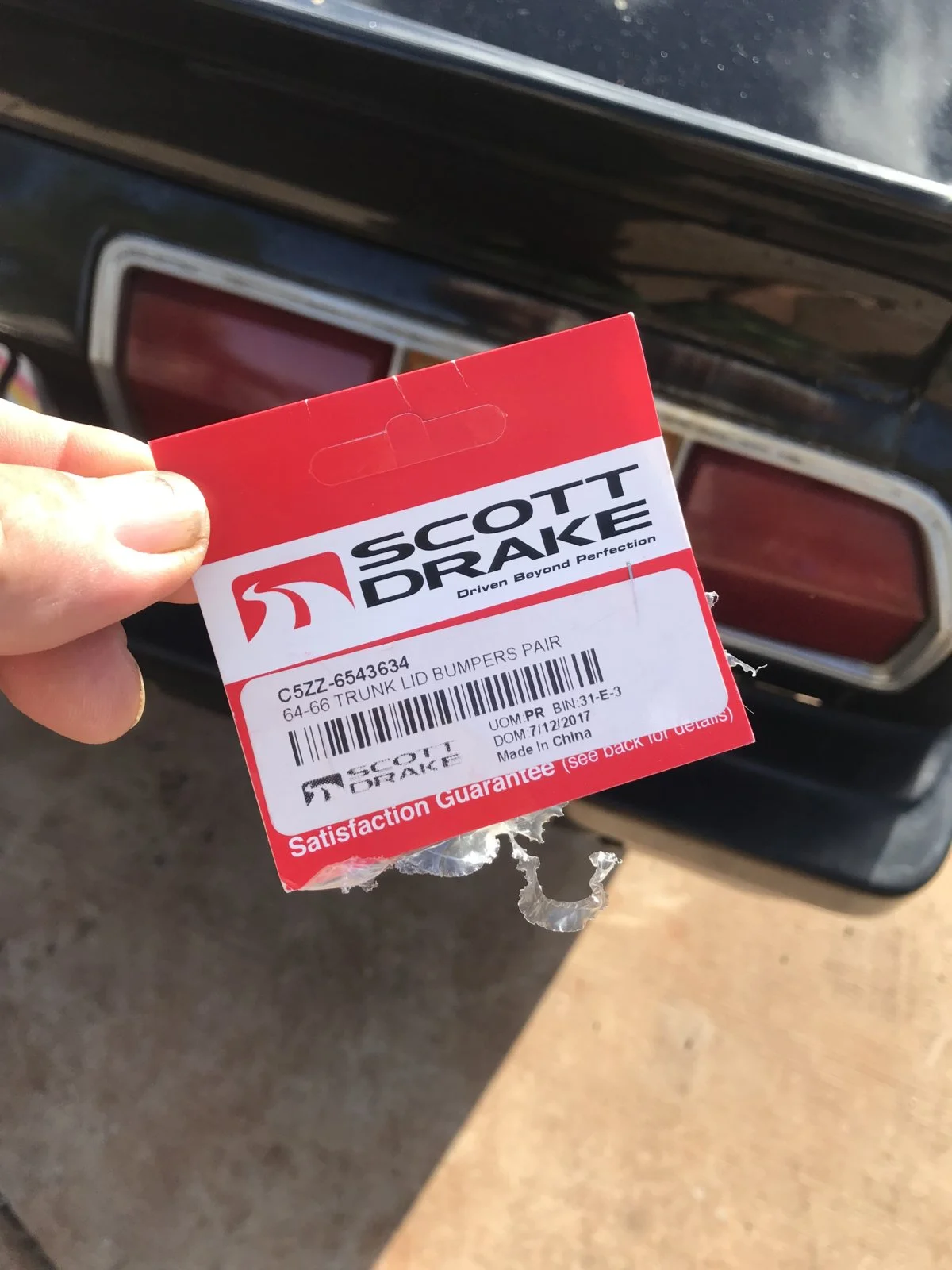

Rubber Baby Buggy Bumpers
Been listening to deck lid rattle for last 6 months for lack of rubber bumpers.
but was concerned about which ones to order, since I can't find one direct fit for the 74-78
Turns out the 65 trunk lid bumpers fit pretty good, are cheap, and from one of our known suppliers.
No more constantly clunking deck lid, now I can hear all the squeaks up front.
Should of done this sooner.
