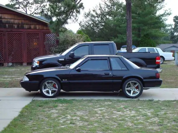

Only picture I have of the car actually. I'm 30 and got my first digi cam like 2 weeks ago. :rlaugh:
