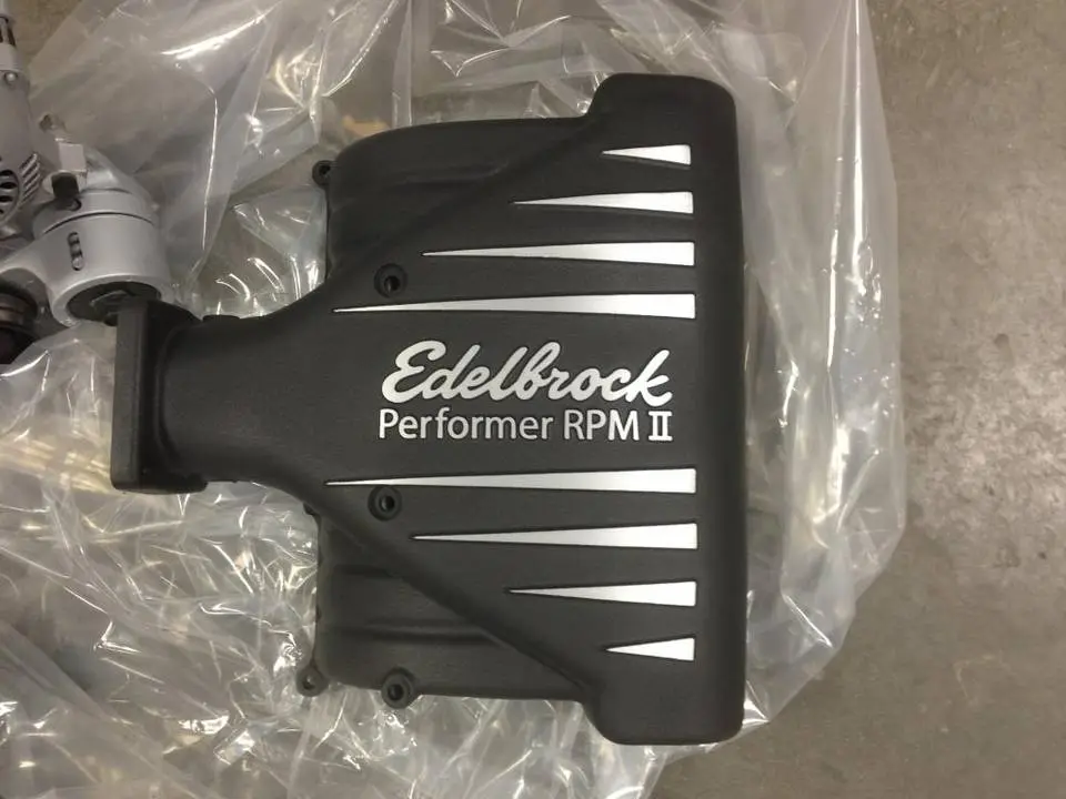

^^now you got it, i plan on selling my cobra .... you could get a RPM or similar one like that paint it your car color and sell the cobra and 5.0 stuff and do the swap allot cheaper...
