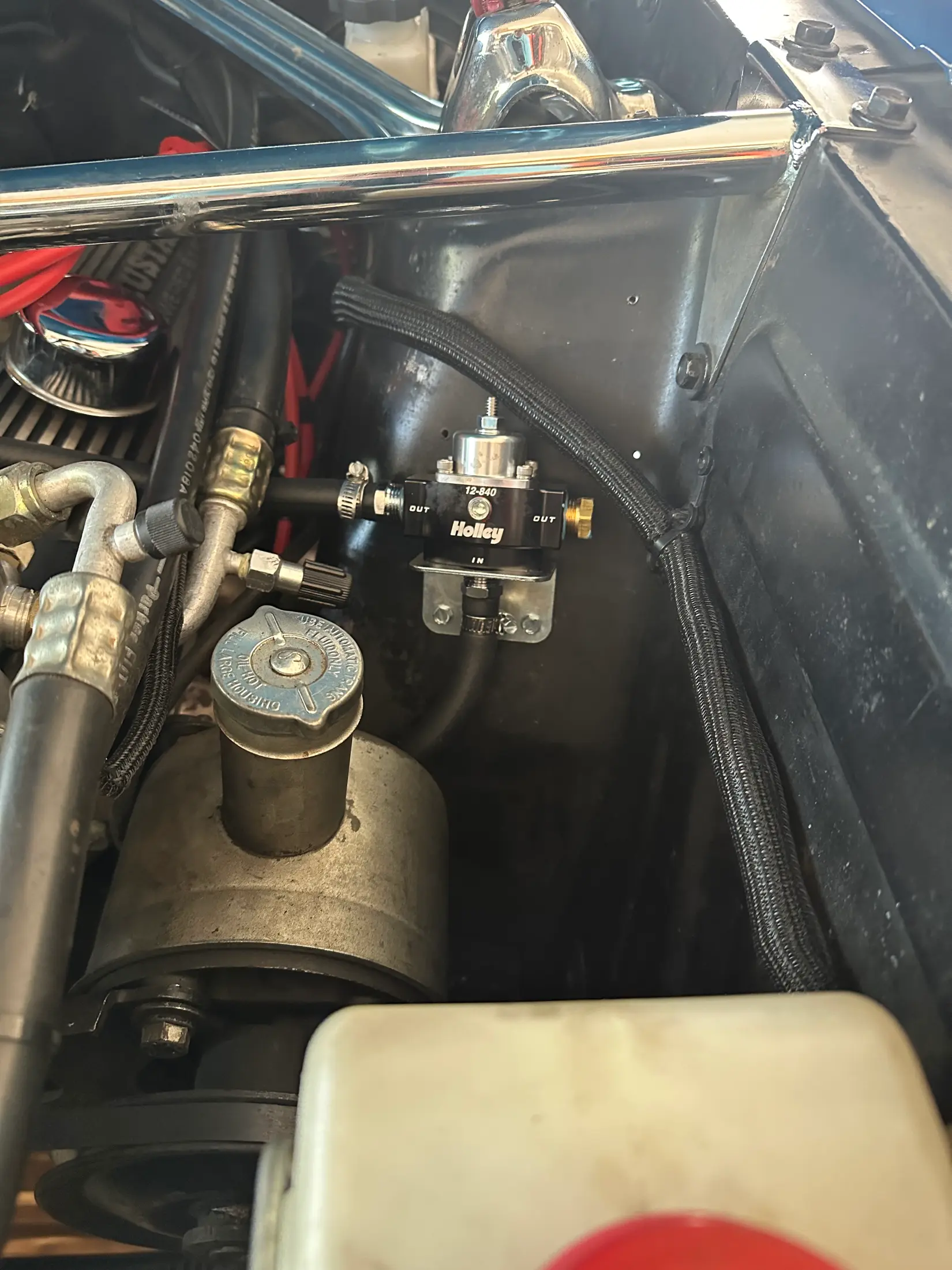

I'm gonna jump back in this week. Timing is set to 12 deg advanced to 33deg.at throttle. dont know the rpms as no tach,auto trans. I will check everything....timing again, fuel pressure (going to install a regulator setup), bowl float levels, mixture screws, etc. Will remove and clean plugs first and work through everything. The one thing I'm not sure about is that the carb is black from running so rich for so long. Best way to clean it?? Thanks for any input you may have.
Also I want to reroute the gas line to the rear of the motor (Firewall area or brackets on motor or valve cover bolts) as i am going to clean up the front topside of the motor. Should I make metal lines to mount on the "Body" (or motor) and then rubber gas line from the mechanical fuel pump to said line and then rubber lines from said line to carb filter/regulator setup?

You can run a rubber line from FP to the frame rail/fender apron area to a hard line mounted with those nice isolated line clamps, with a bend at the firewall, then a rubber line from the firewall to the carb

Thats what I was thinking. currently just have it connected with the rubber hose from the regulator to the carb. when I get around to it ill do the hard mount.
