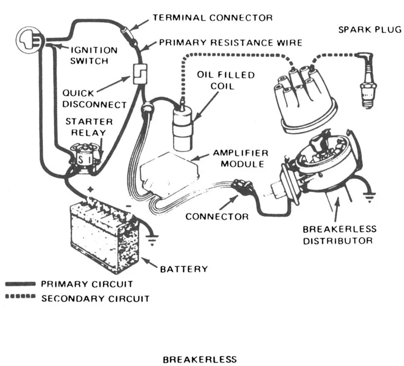

I think in 75 the ignition changed to the breaker less ignition with a module...
extra_stout
5 Year Member
Aug 27, 2018
831
955
113
Germany
Jul 10, 2021
#373
  • Jul 10, 2021
  • #373
Ah... found this picture. Could be that in 75+ there is still a resistor wire...

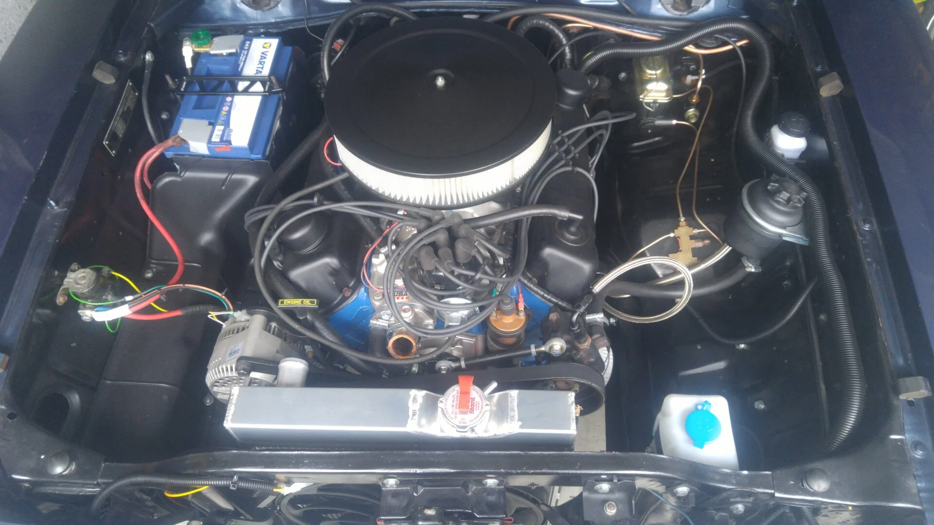

Alu radiator is hanging in there! Because it is ~3 inch smaller, I had to make brackets (I knew that before). No big deal. Now the power steering pump and the oil filter gets cold air directly... It is a feature, not a bug
Hood still closes, but I had to redrill the mounting brackets of the e-fan. Overall I have the same radiator to engine clearance, but 3 rows of great chinese aluminium radiator goodness. If I have ever problems again I can buy now a radiator that is easily available.
Because brass radiator cores seem to be expensive at the moment, I have googled current scrap prices for brass/cooper. It seems, that I will get nearly 100 bucks for 3 scrap radiators... Perhaps I will wait another 10 years. Seems to be better than other investment opportunities.
Earthing/ground of pertronix is good. Also checked the battery and engine ground wire. Everything is fine. Because the e-choke gets 12V from a relay I just hooked up the pertronix 1 to the choke terminal. Wire is thick enough, perhaps I will change the fuse from 10 to 15A. A friend told me that it is running with a 10A fuse in his car fine... Do you have any experience?
The two stage thermo switch is switching both stages... So I ordered a new one. So it will take some days till I can fill up the cooling system and fire the car up.

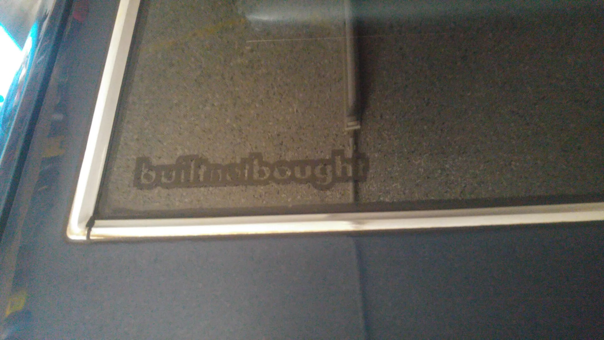

Could all be worse...
My speedo is working perfectly
Cool sticker at the rear window (10 HP worth):
