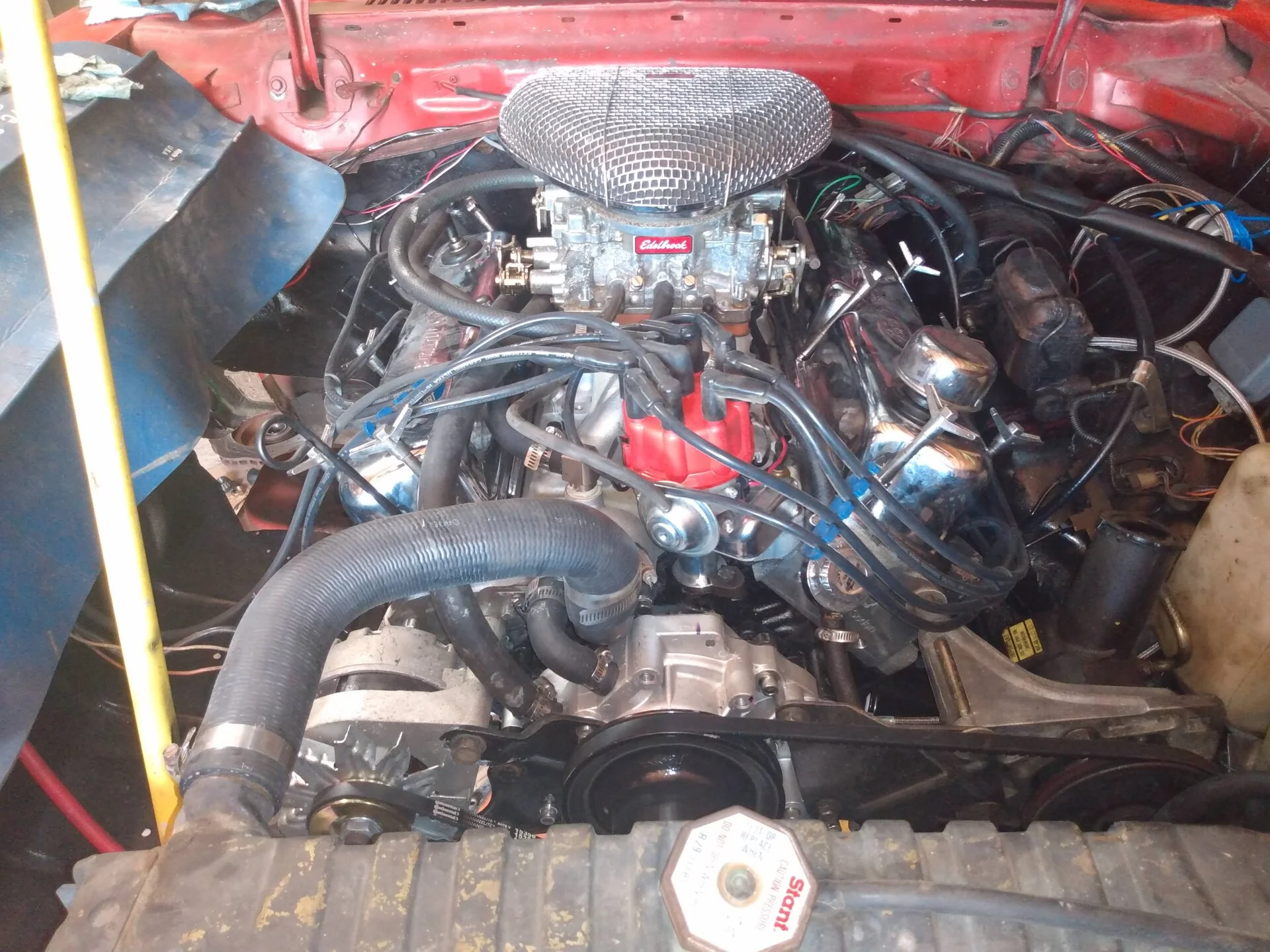

I had the same problem. Big ass oil sending unit. I used a T at the block and the extension you linked above. The T faces up and that has the smaller idiot light sender. The extension points out and has the large oil gauge sender on it. I can take a pic when I get her back from exhaust shop.
Getting old can be a pain. Damn memory. I found a pic. That plan didn't work for me either. I used the T. The top port for idiot light and braided line from side port. the braided line feeds the oil sender which is attached on fender near the voltage regulator. Follow the braided line by the master cylinder and you can see how it's rigged. A shorter line and cleaner install is on the to do list but if it works and other things don't work it gets forgotten.

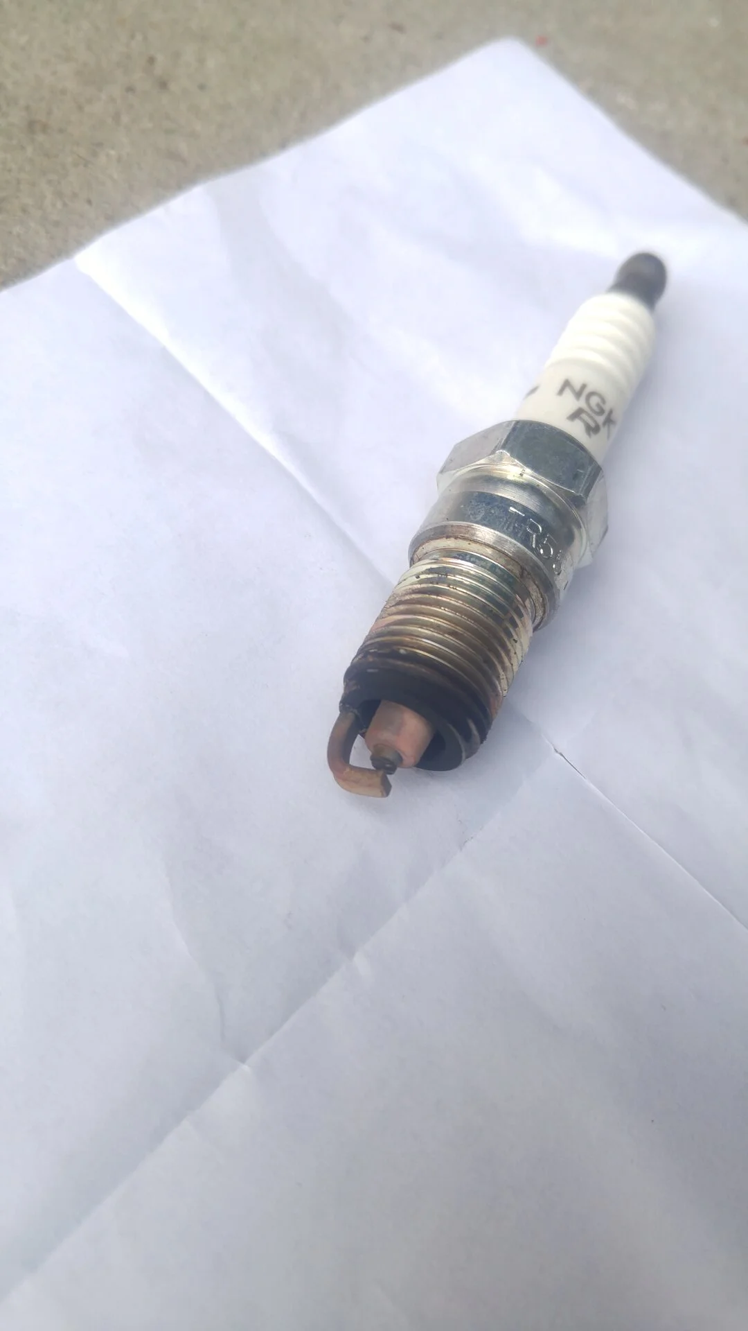

I also pulled one plug before I started the tuning session today, which looks also good to me:
