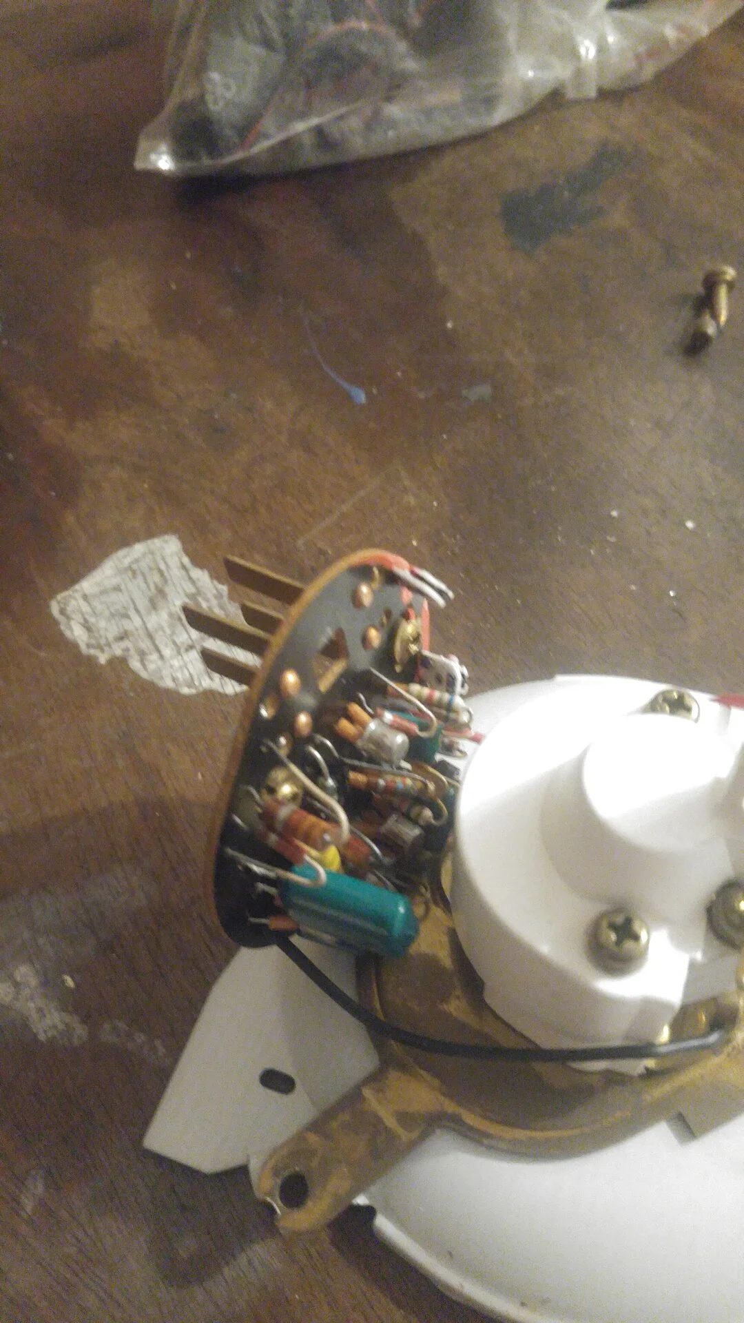

I took the spare tacho apart, to have a look inside. There is a board inside which is a "frequency voltage converter". If I find the right capacitor and resistor and swap them with the right size capacitor and resistor I have a V8 tacho... Or I try to catch a jedi squirrel and let them do this kind of stuff.
You can do this? I see a new cottage industry.

Can you do an T5 swap? You never know till you do it!
Interwebz, arrogance (on competency of real experts), ignorance (on lack of own competency) and a small amount of criminal energy is the right combination to tackle this problem.
I need a source for tach signal which an old battery charger should solve. Or I will visit a friend who has a signal generator. Perhaps the solution is very easy: from the board there are two wires red and black to the tacho itself (the tacho input is just a DC voltage in the right height). Perhaps it is sufficient to put a poti into the red wire and adjust it till I have the right RPM on the tacho. If not, I will cry my heart out in front of my friend with the signal generator (he has some competencies in electronics) and hope he will solve my problem.
The backup solution is to use a chinese cheapo 2 inch RPM gauge, put it behind the original screen and put the original needle to it.
Anyway I will report.

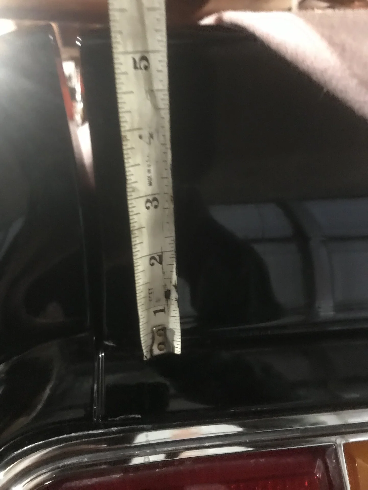

Could someone measure for me the height of the original Cobra rear spoiler?
I just saw that here in Germany are GFRP rear spoiler in similar style readily available for Ford Escort and Ford Capri. I just want a middle section without the corner things, perhaps I'm lucky and can find something from an european can, which will be easier to source. And if it doesn't fit I can send it back...

I'll try to remember when I get home from work in a couple hours. I think it's roughly 4 inches (101.6 mm).

Is this what you're looking for? It's just over 5.25 inches. It's curved though on both sides.
You are also a nice guy! Thanks.
Sadly the currently available rear spoiler is 7.5 inch high...

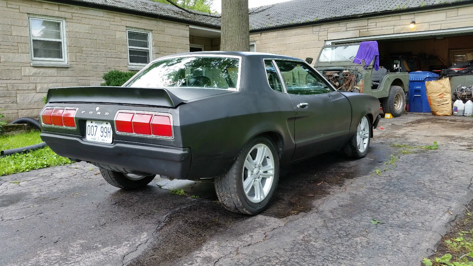

I"ve seen a coupe with what looked like the standard hatch spoiler somehow made to fit. If memory serves I saw it on YouTube - I even know what the car looks like, but I can't remember the guy's username. His real name is Adam iirc.....

That didn't take long! lol
Here's a video of his car from about a year ago. Maybe you can get a hold of him and get some info?

Not sure I’m sold on the spoiler on a trunk (notch back coupe). The rear angle view is fine, but I like it better on a fast back.
How about photoshopping a pedestal style like the 93 Cobra, but at the right angle?

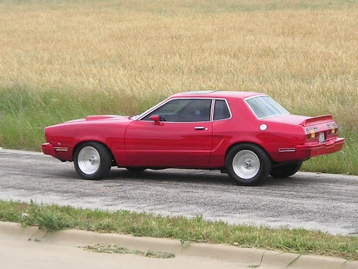

I had a pedestal style spoiler on my old coupe. It was essentially a copy of the old spoilers that were used on 69-73 Mach 1s and the like. I thought it looked pretty good. I tried it on my Cobra before I had the body/paint done and it just didn't work for me on the hatchback, but I thought it worked fairly well on the coupes.
Unfortunately the only pic I think I have of my coupe anywhere are the ones from where it was wrecked.
I'll have to see if I can dig them up and post one. Maybe it'll give an idea of how it looks on a car that's in one piece....

Here they are - I had them on my FB. FB is good for something sometimes.....
