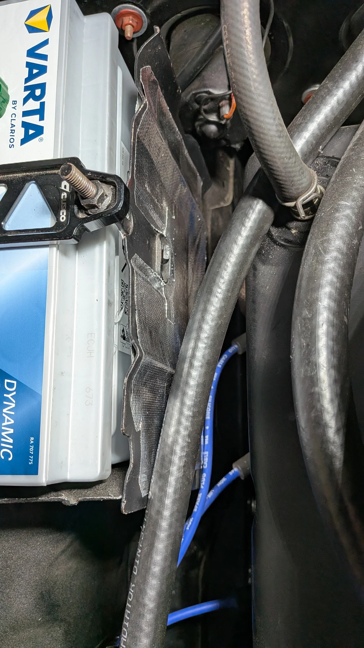

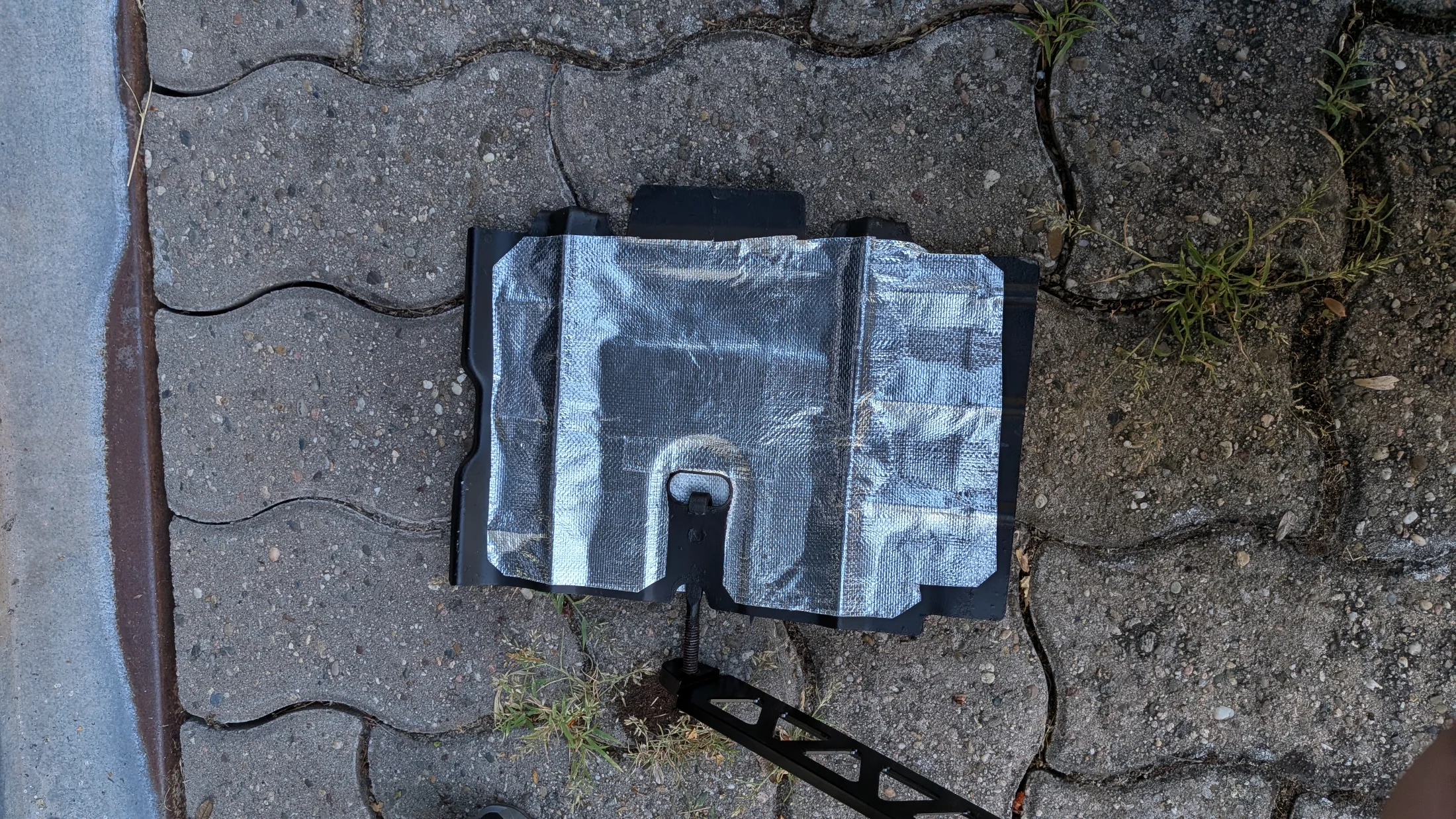

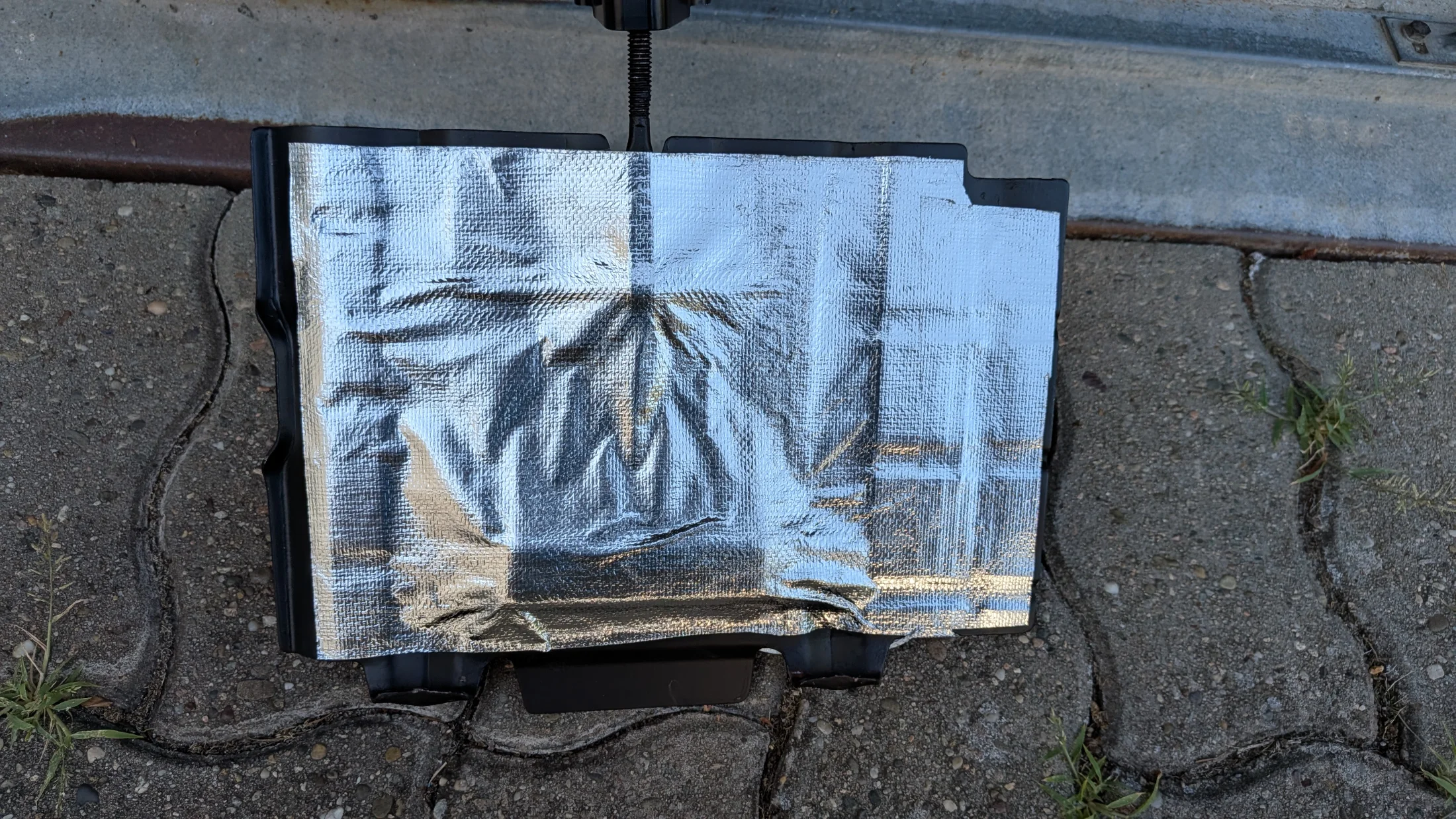

Had issues with my battery... Finally I replaced it and optimized the bracket Holding IT down with some heatshilding.
Perhaps it helps. Lets See.
