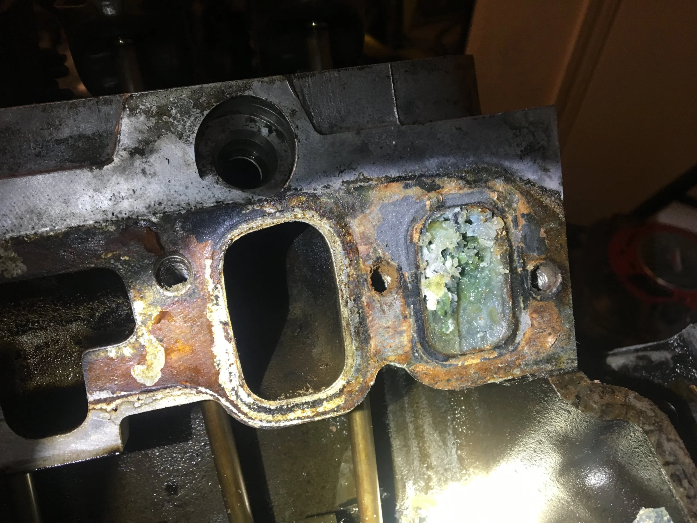

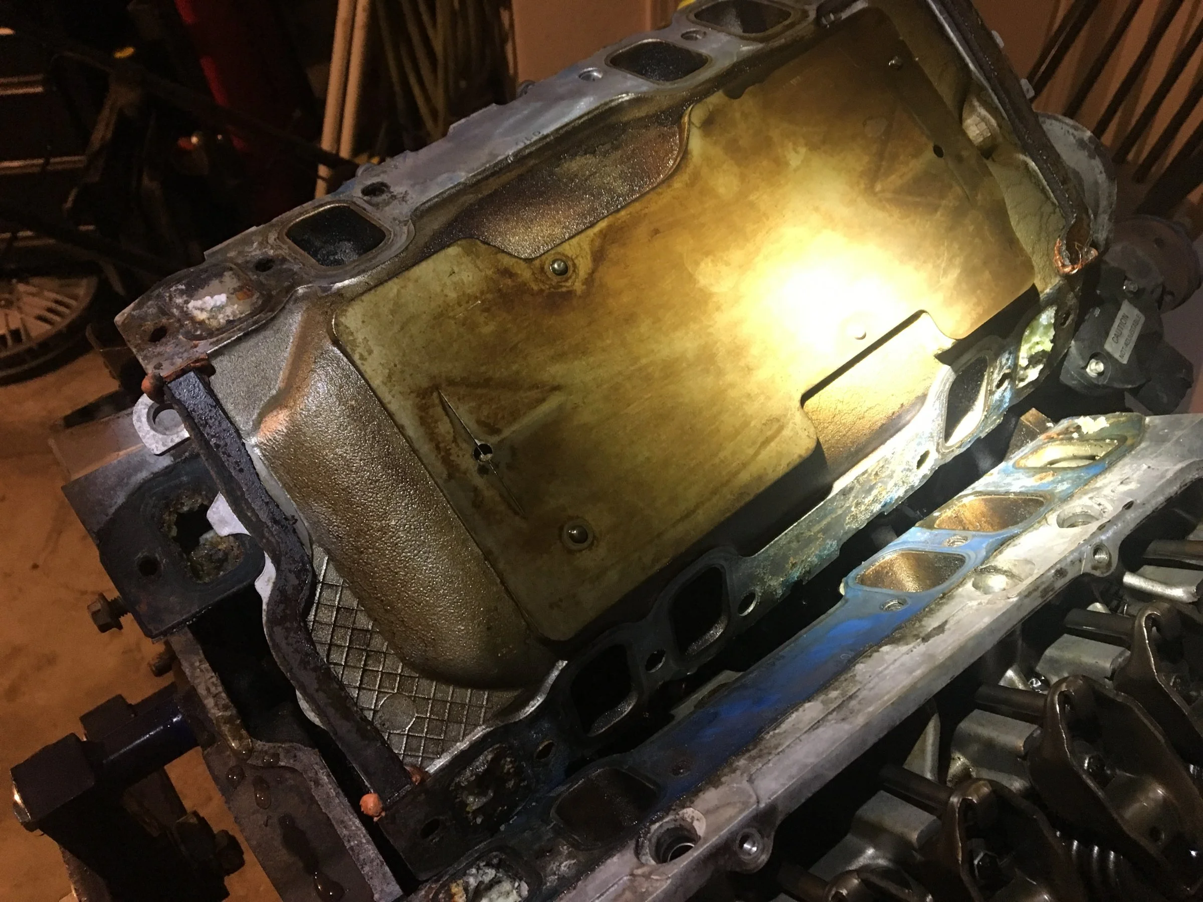

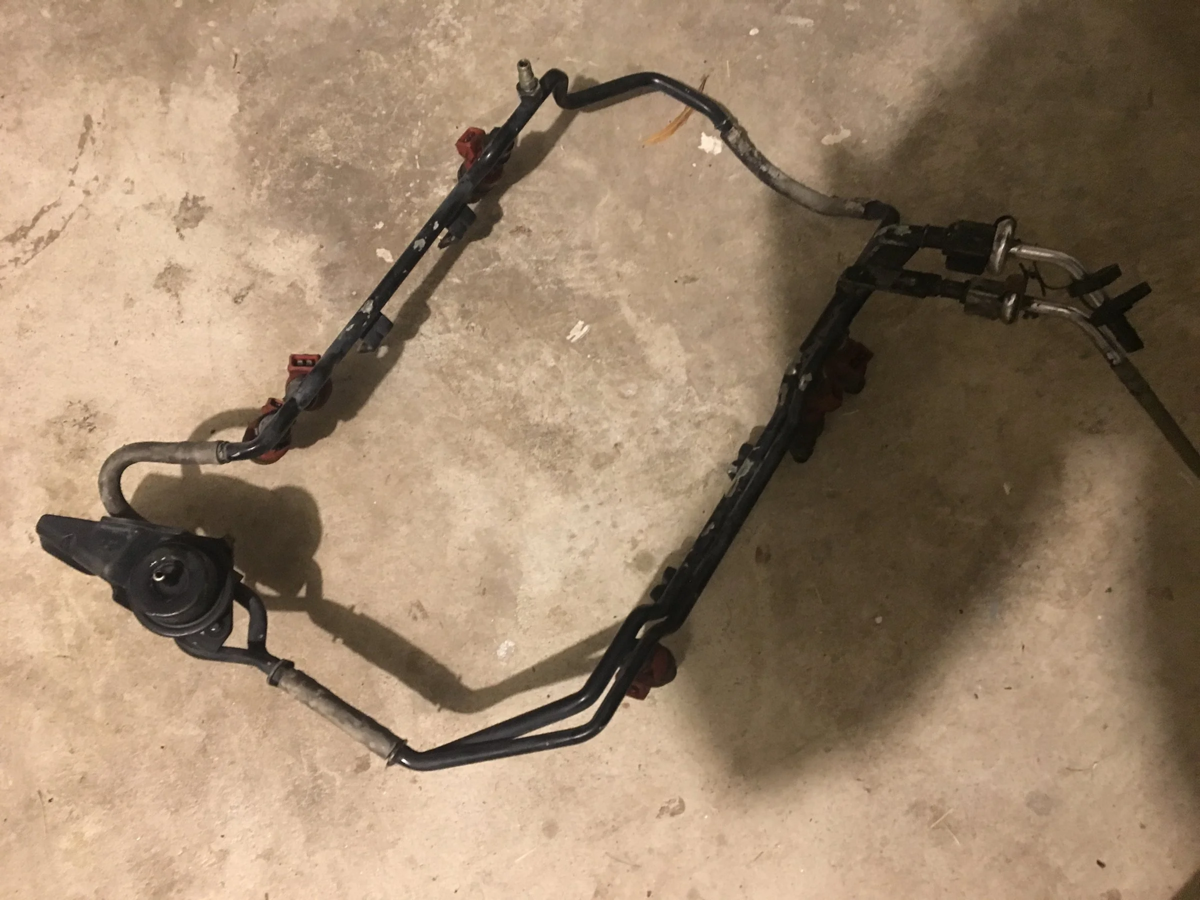

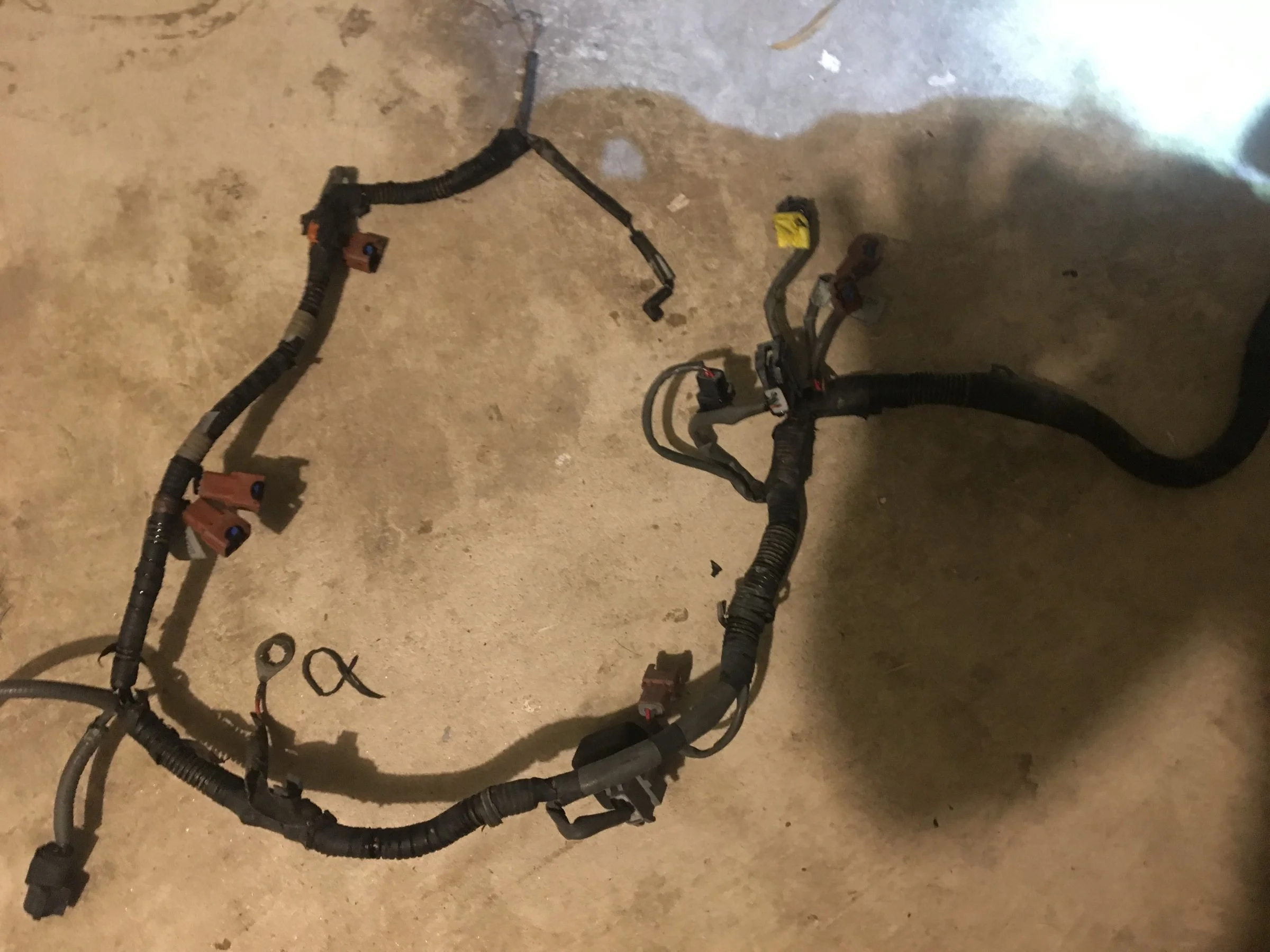

I pulled the injector harness, the fuel lines/injectors and the intake manifold.

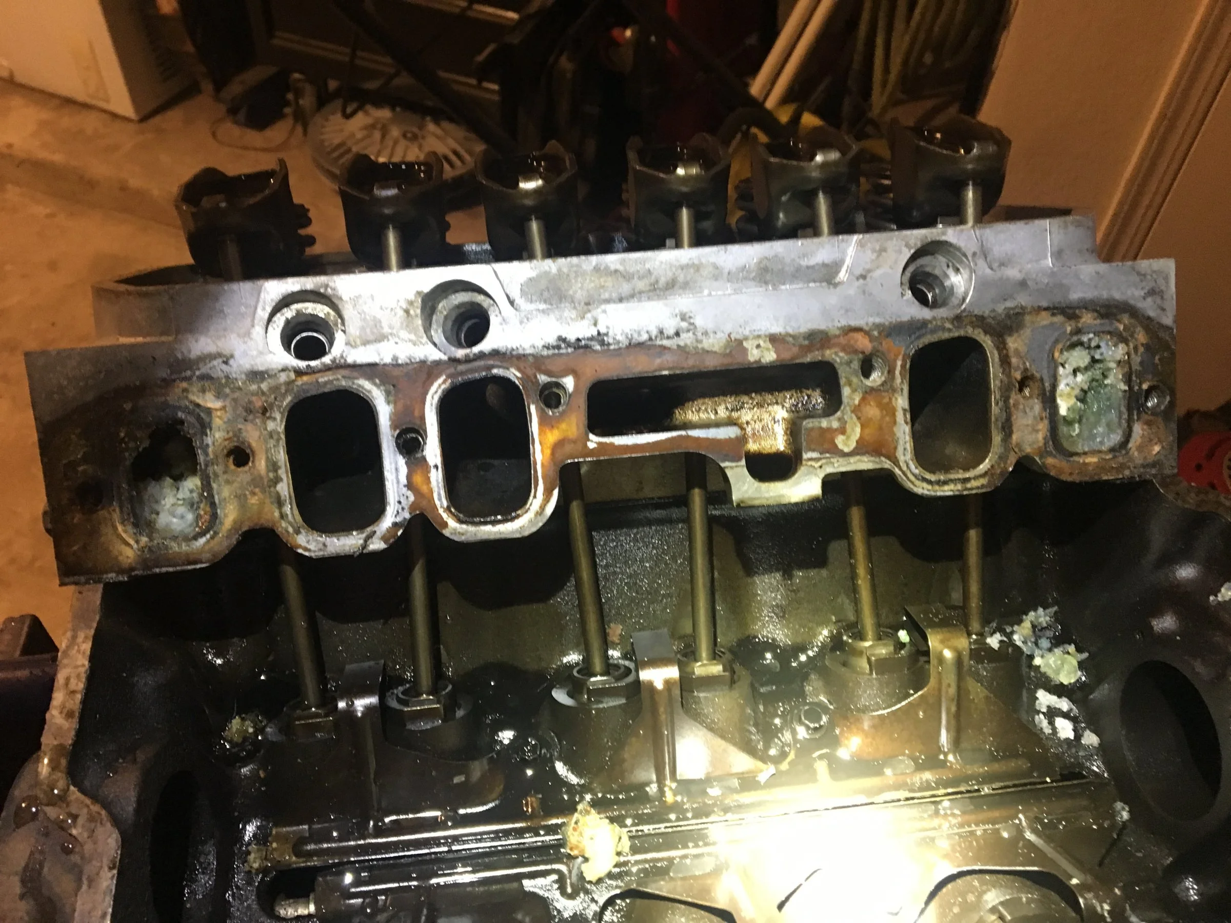

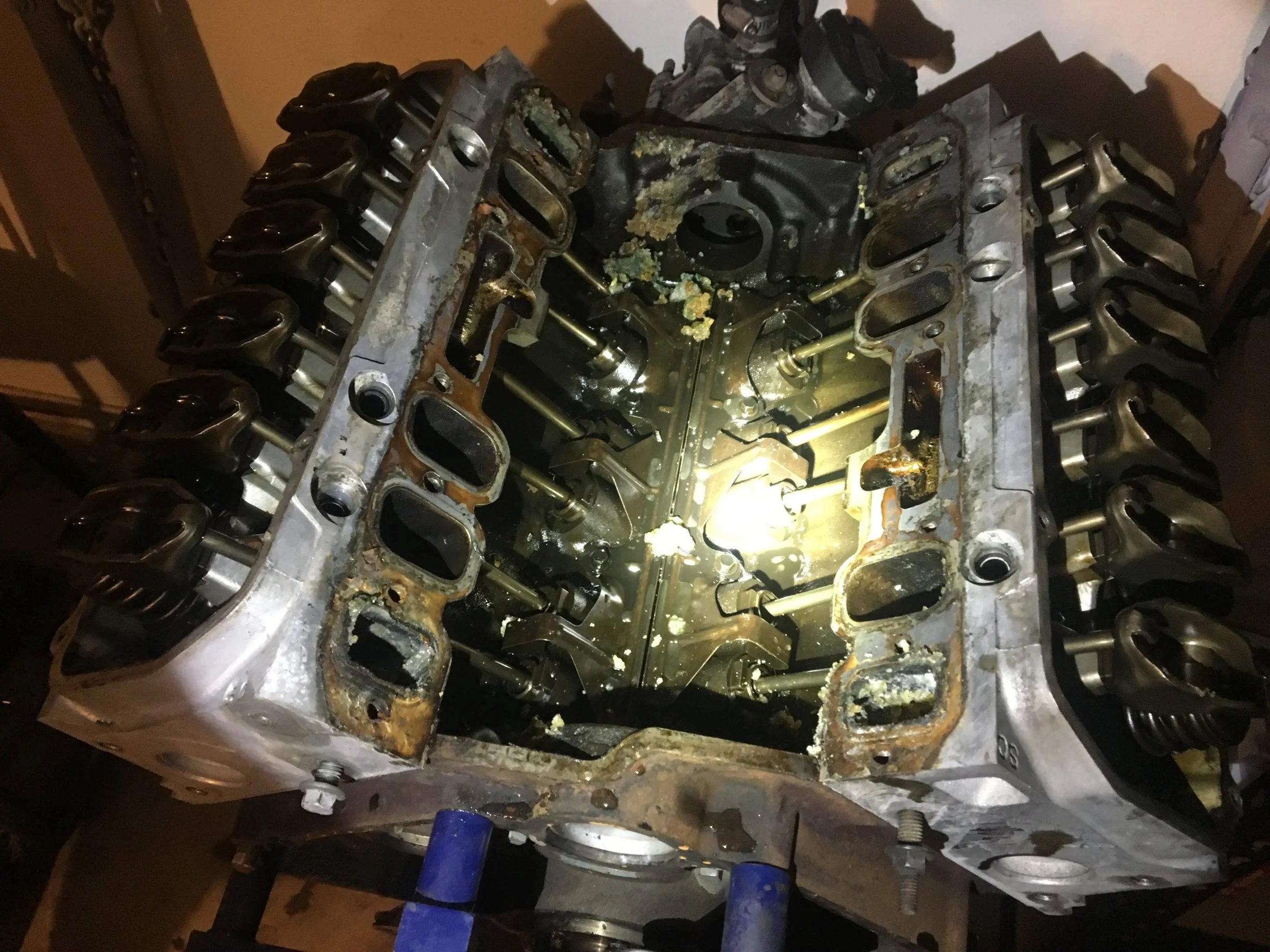

So, what did I find? I'll let you look. Look at the coolant passages at the front and rear of the left head. The front is completely blocked off from using a stop leak. Let this picture be a warning to y'all that might think that is a great temporary fix for a coolant leak. OMG, the front was completely blocked!
Beyond the completely blocked coolant passage:nonono: it looks pretty nice in the valley.

Didn't realize the SC had aluminum heads. Were the heads off the mustang aluminum, too ?

That engine looks pretty good inside. Can't wait to see the cylinder bores.

My original heads were aluminum as well Scott. Ford started putting aluminum heads on the V6's in '83. The supercoupe heads have larger coolant passages in the heads and block (obviously pointless when the heads are completely plugged up with Stop Leak though:nonono:).

I'm interested in seeing the head gaskets tomorrow.
