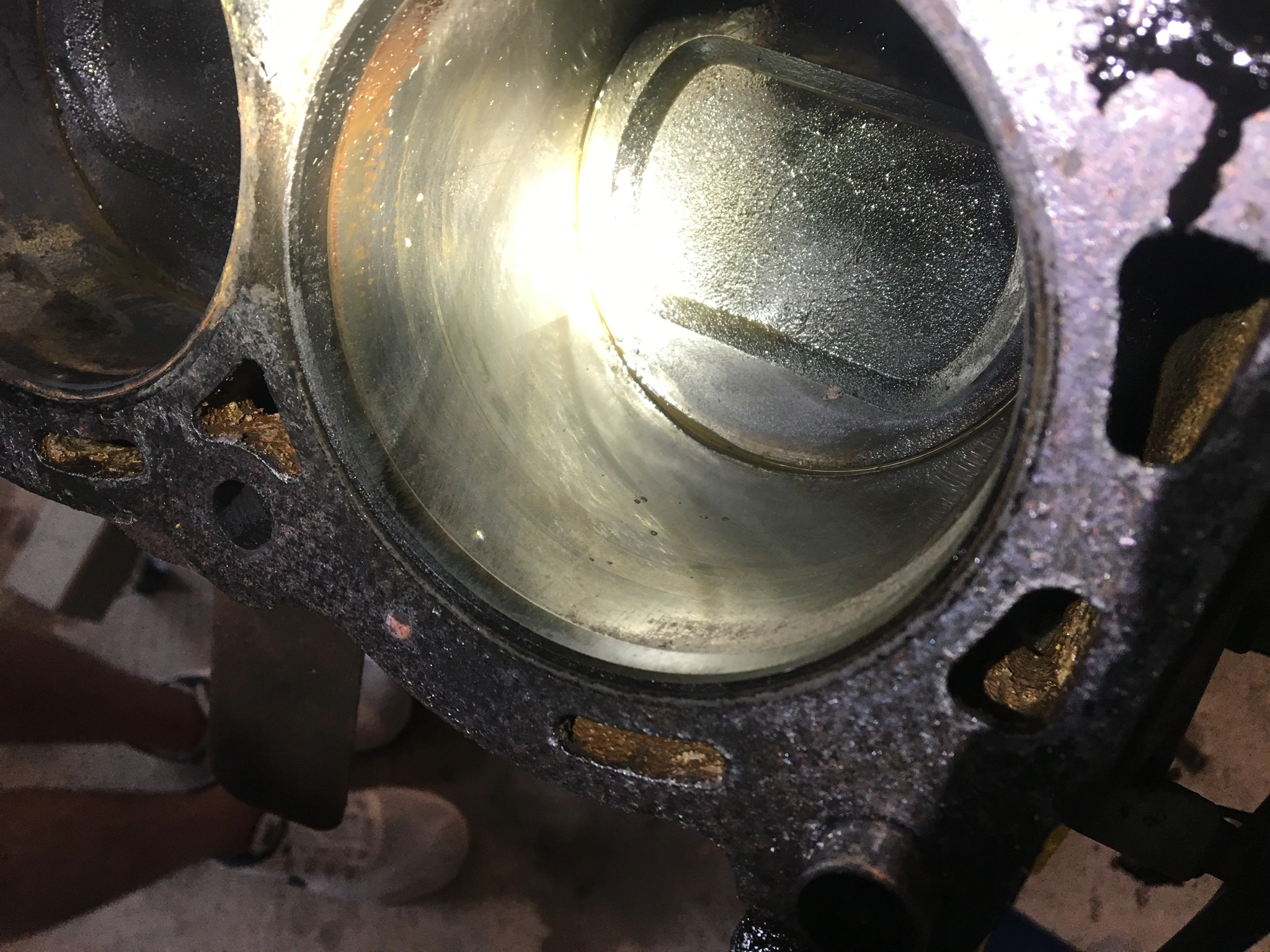

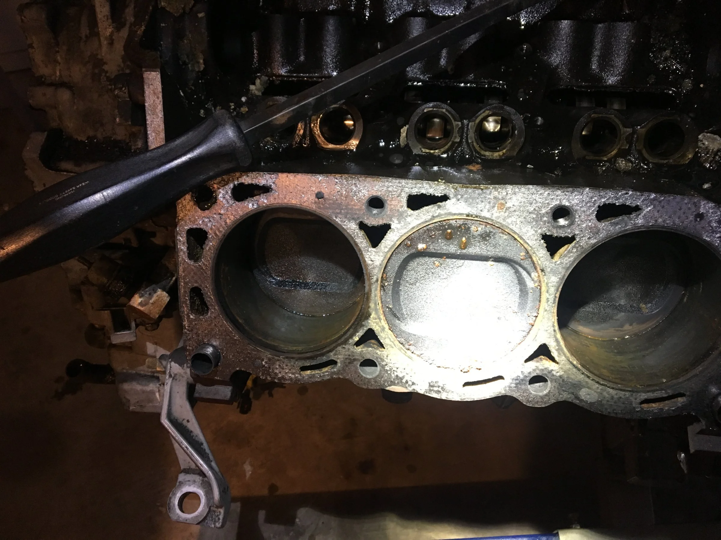

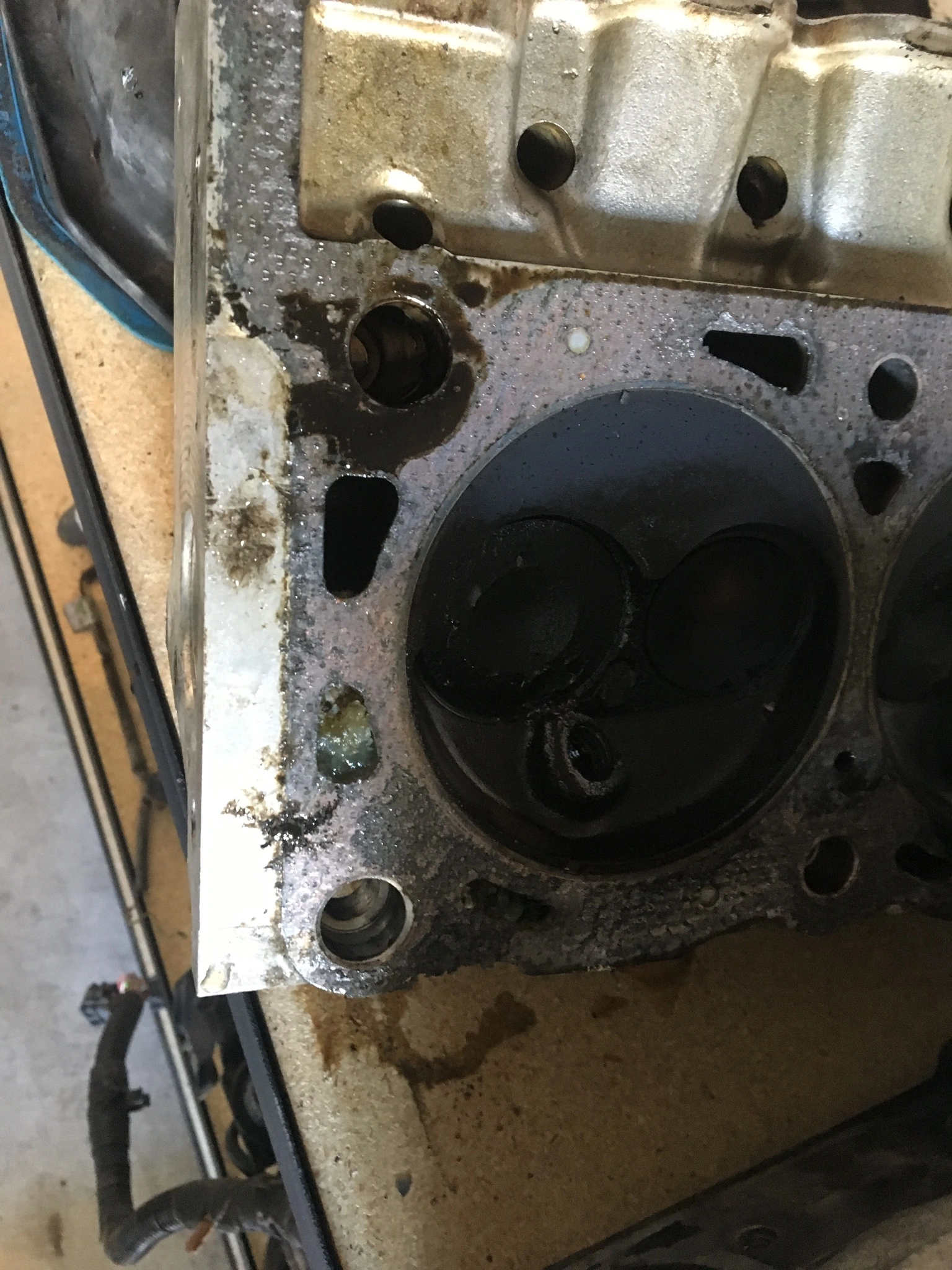

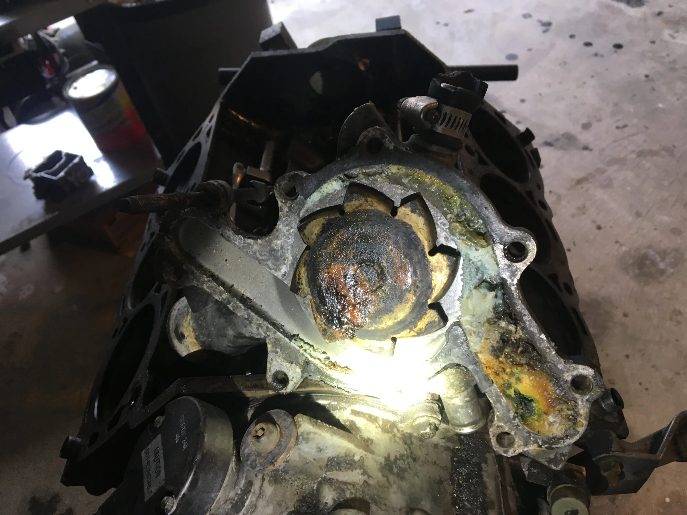

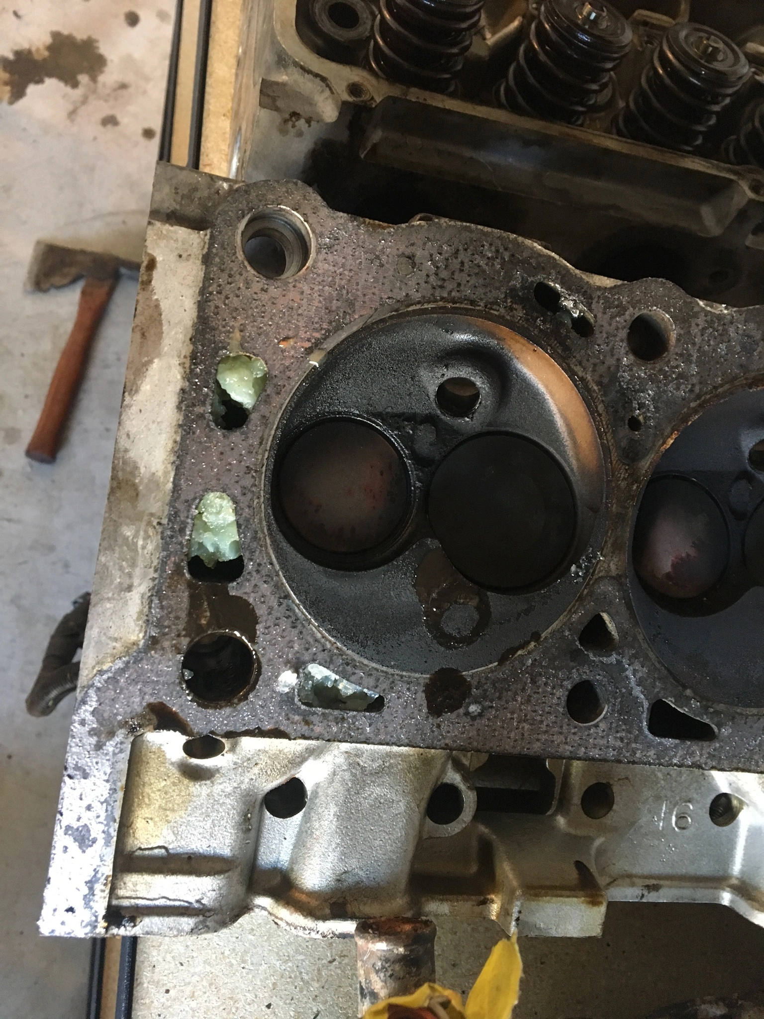

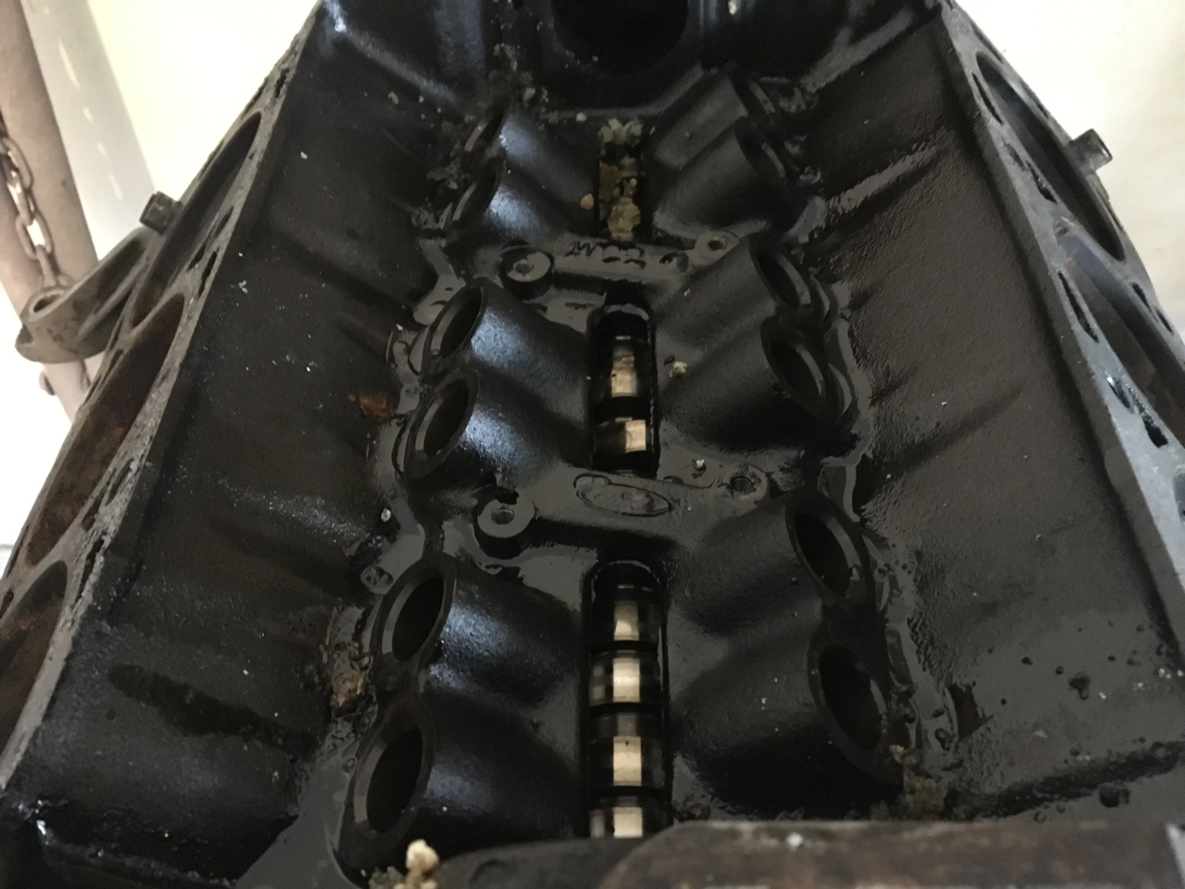

So I got the heads off today. The coolant passages are a little plugged up too.
The cylinder walls are not impressive. I might need more than a honing. That's ok, it's going to get a full service shortly anyhow. The head gaskets looked just fine though. There is a glimmer of crosshatching in a couple cylinders. It looks like an engine that has set for a number of years. No real big deal other than the Stop Leak.

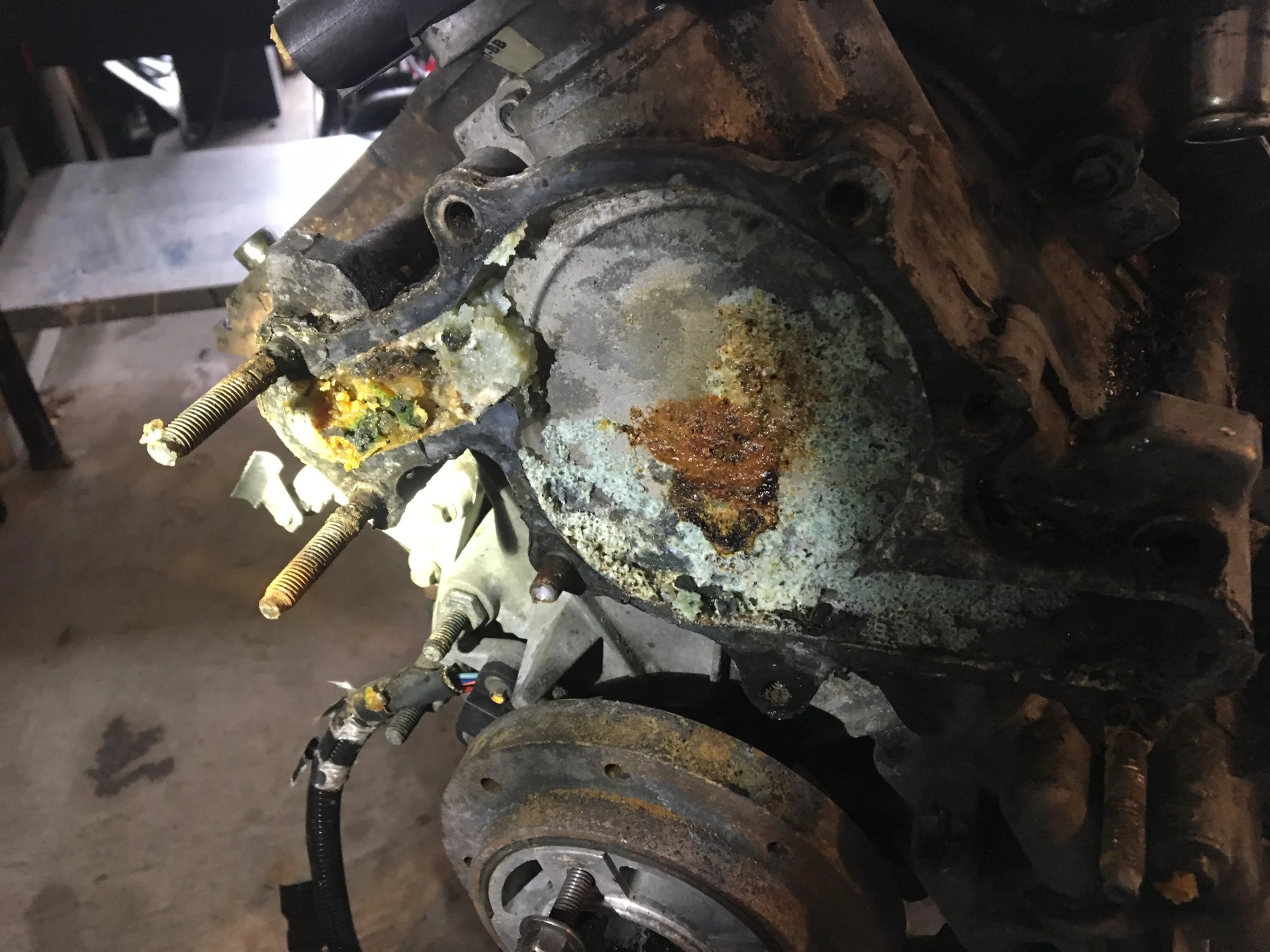

I also removed the water pump. The passage going into the right side of the block was completely blocked with the Stop Leak crap.
That poor engine must have been running bad hot in places.

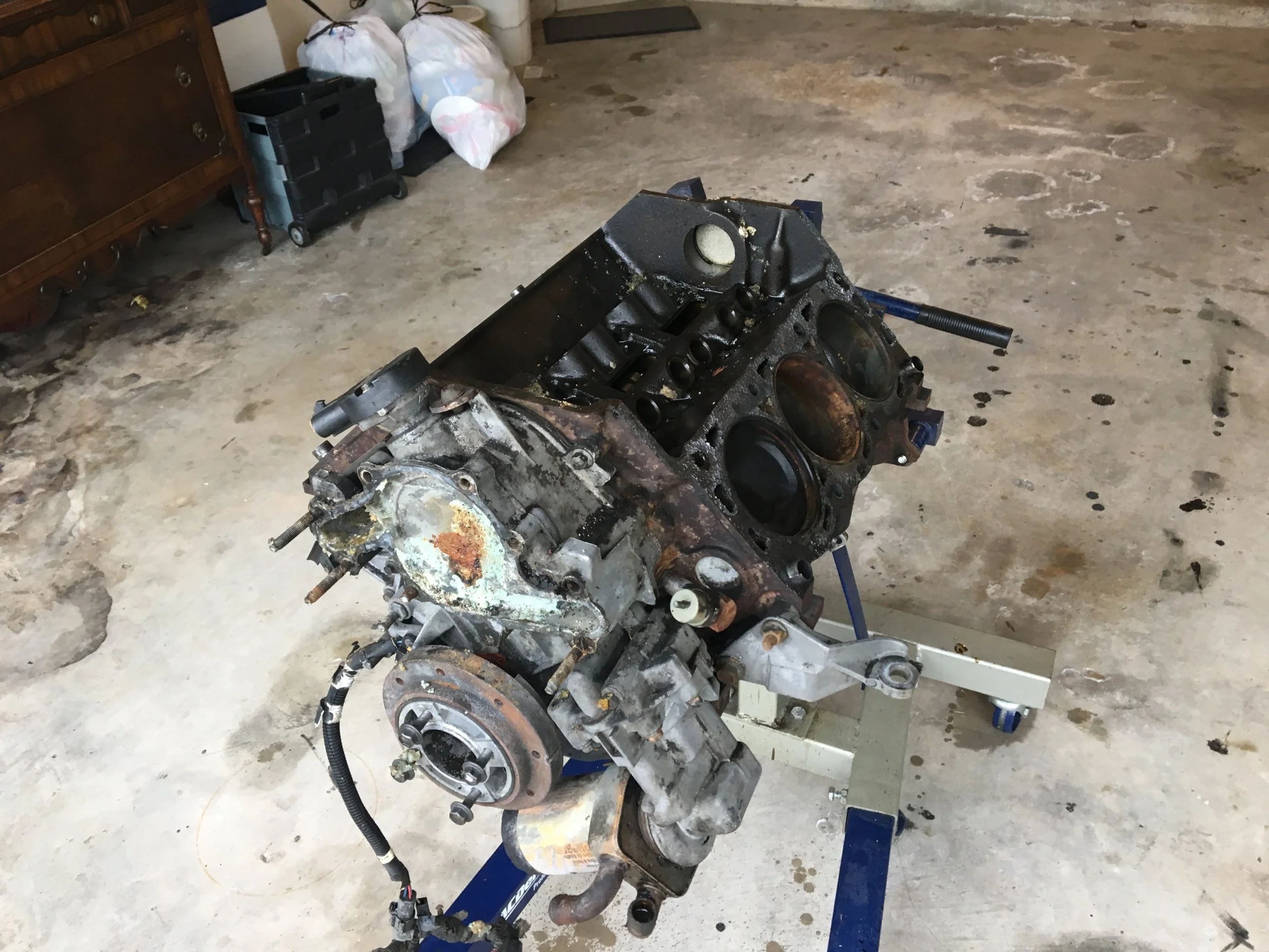

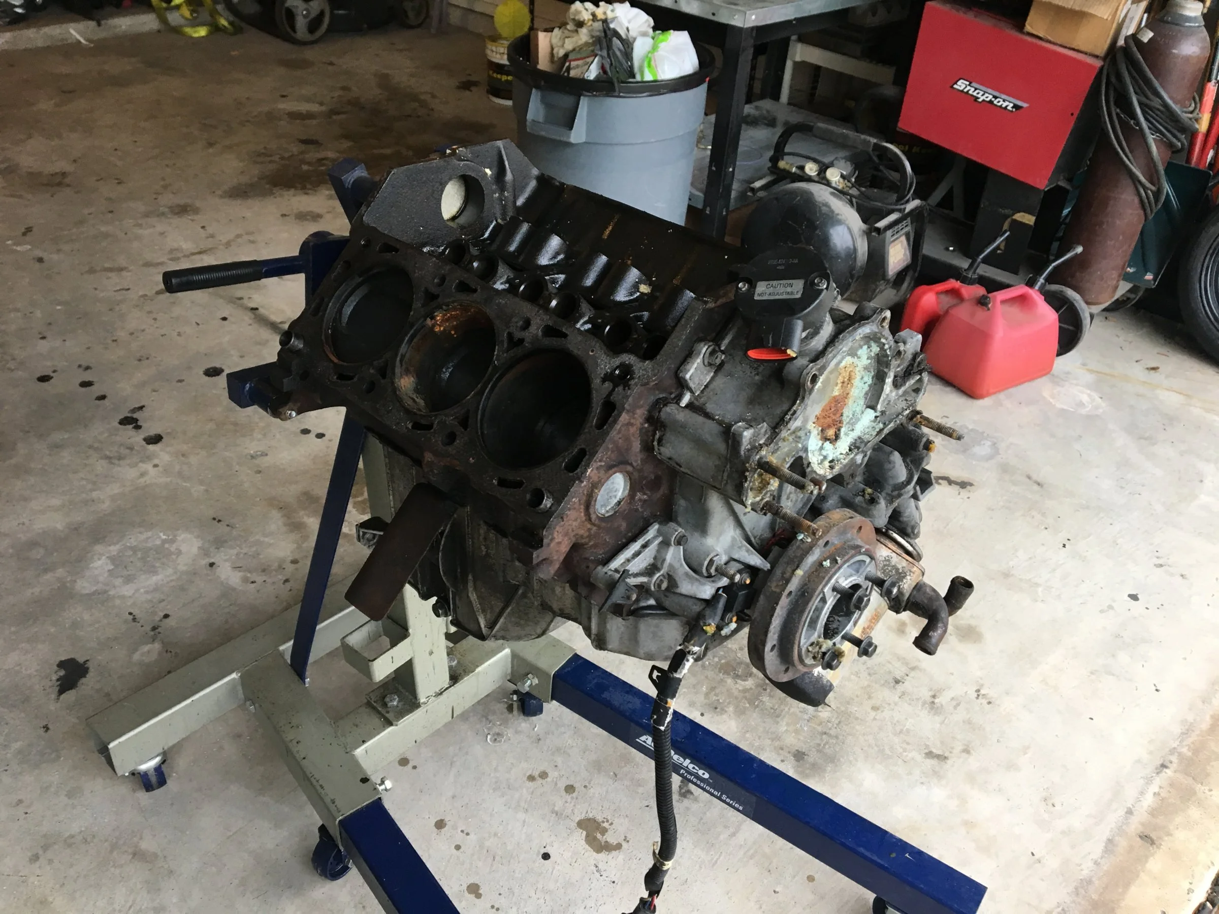

Oh well, here’s how it sits for now. I’ll be pulling off the rest of the front end including the cam within the next day or two.
