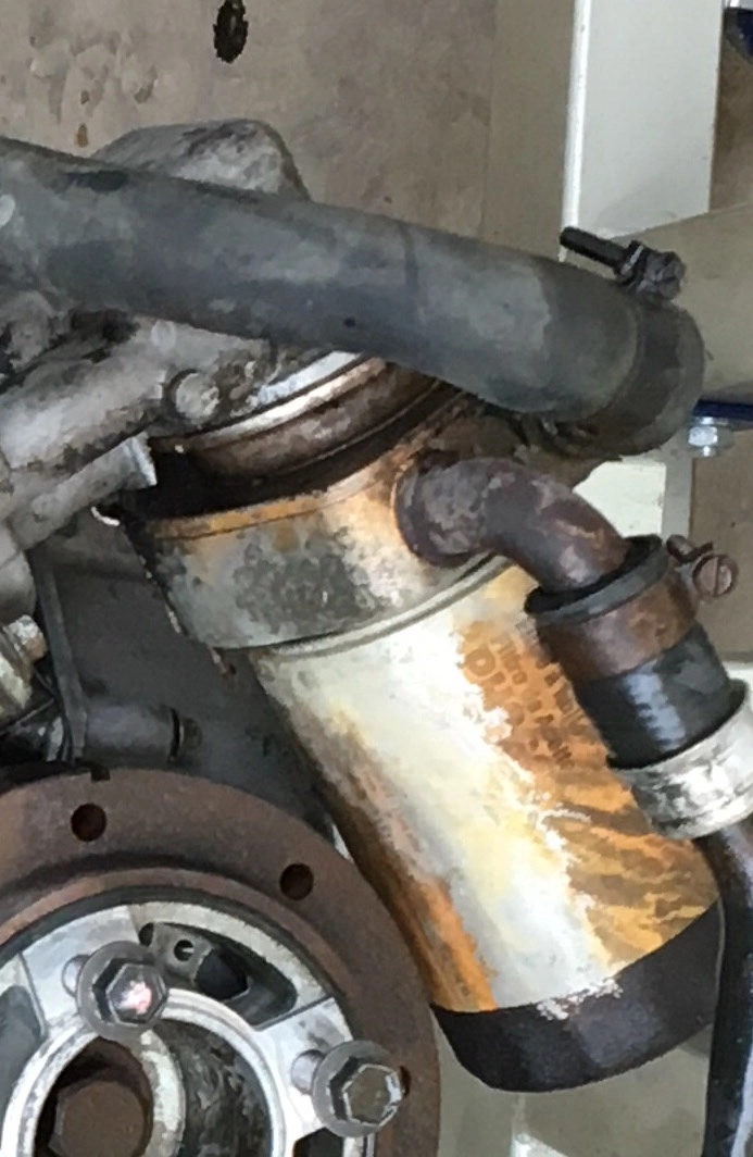

If for some crazy reason a high volume Melling oil pump from a 302 is the same as a 3.8, then I have you covered there. Mine wouldnt fit with my oil pan, so Im just running a stocker and have the high volume sitting in a box.
Unless your oil pump is external, then no it don't fit.
Like mike said, it’s external.
Which brings up a question. Why did ford run a coolant line passage around the pump? The oil filter actually attaches to the coolant adapter. Is this some sort of oil cooler? I’ll dig up a picture.
