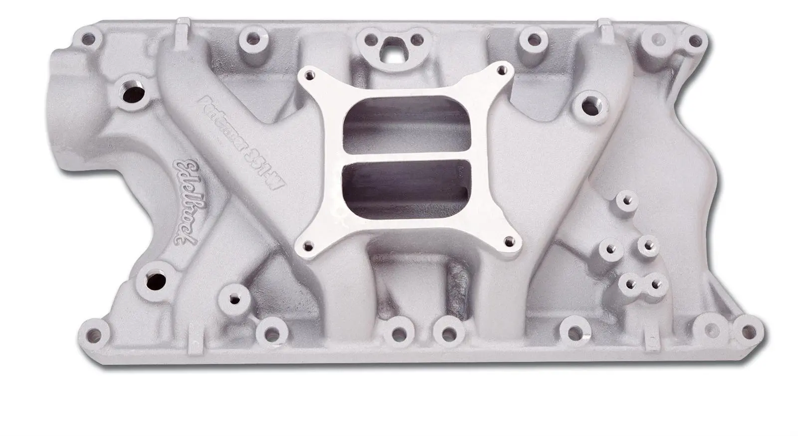

Every induction system for a 351 is gonna hang way the hell up in the air. A conventional intake (Victor/Super victor) w/ either a 4 hole TB, or an elbow is gonna be UP there. If you go the opposite way, and put some low profile 1970's style stock height intake on the thing to get it to fit under a stock hood, you trade away any advantage a 351 will have over a 302, cause you'll choke the piss out of it.
Just look at this lifeless looking thing......
I think I'm gonna puke....:puke:This is 4.150" high.
Then look what happens when they only perform a vasectomy...(Balls still there, but no longer able to fully perform)
Ah Oh,......looking like maybe we better rethink the hole in the hood thing.....now we're hanging 5-3/4" up in the air.
And lastly,....coming in at the same height as our blank shooter, the " aint nobody touching my junk" offer.

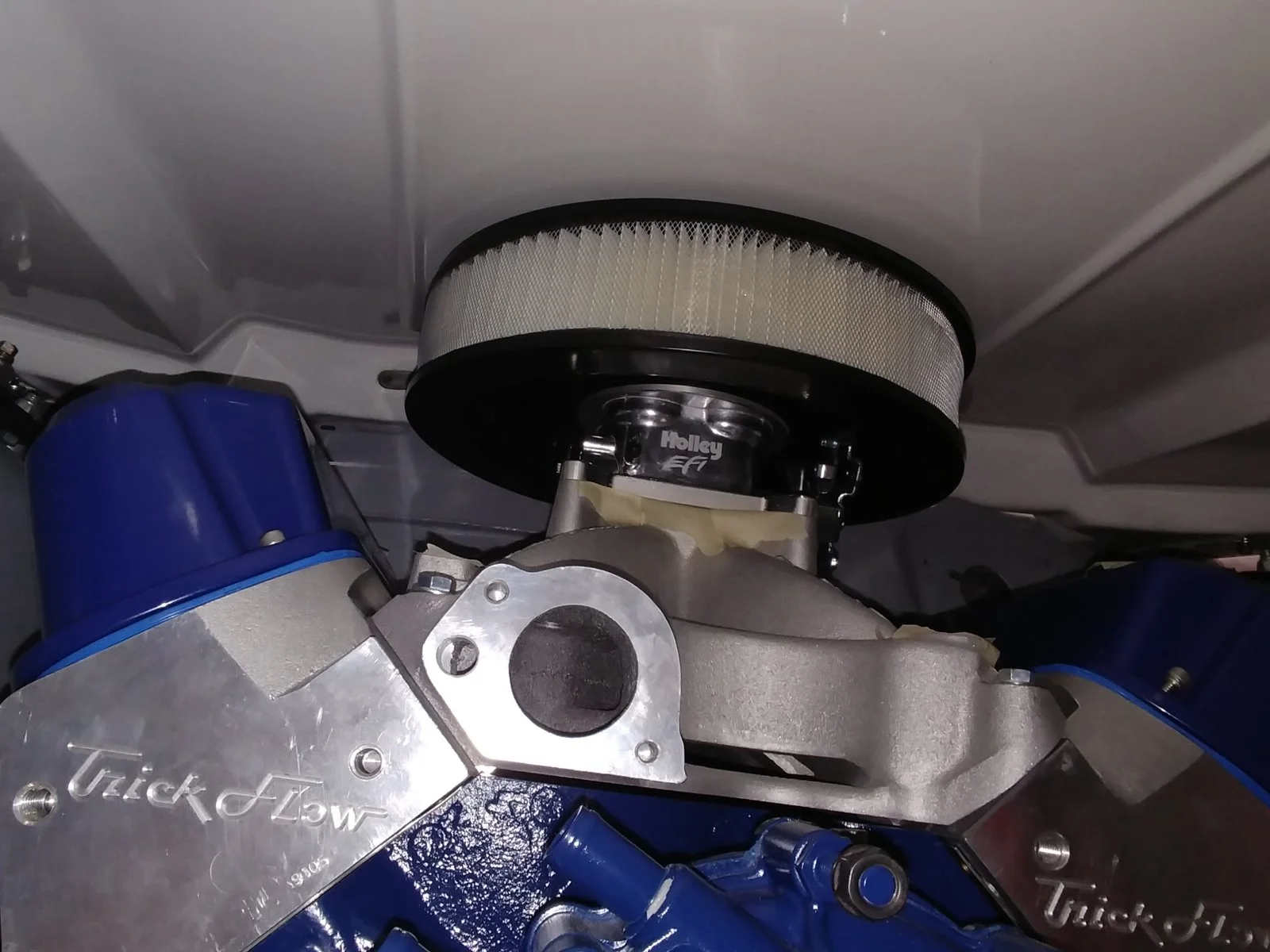

so this is from my build thread but should give you an idea. Dart 351, super victor efi intake, holly cast throttle body and a cheap summit brand drop base 14x3. Using energy suspension mounts (vert mounts), racecraft k (there are others that sit the motor lower, team z I believe does), 1" k spacers, and a 1.5" cheap ass cowl. Only about 3/8 or so of clearance, but with a different k, drop mounts, and maybe an accurate tb I think it would fit under a sticker, but just barely.
Edelbrock also makes a low profile elbow that a will let you use a fox style tb, I've seen those fit under a stock hood too.
