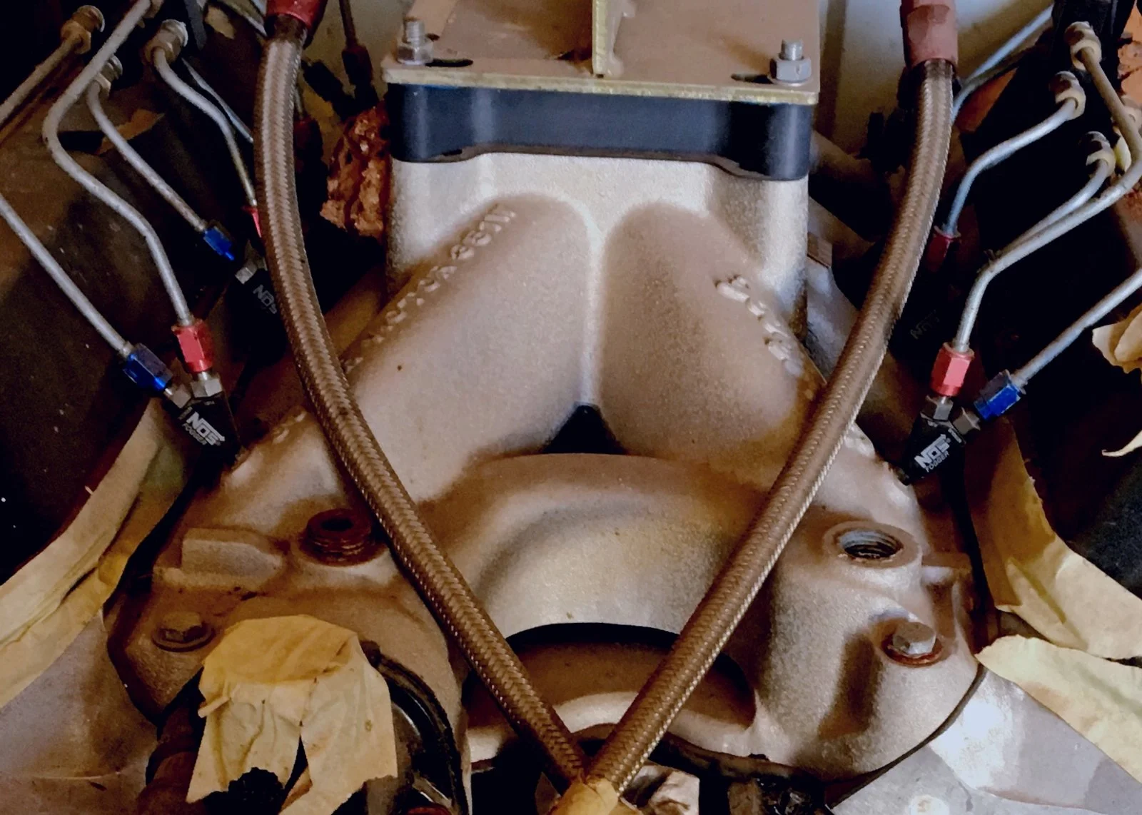

super vic plumbed for juice. carb version of what mine is. anything smaller on a 408 with decent heads would be a waste.
If you're not going to use the NOS, you can probably have someone weld the efi bungs in the holes the NOS nozzles are. Nothing's hard if you have enough money or skillz. There's a guy who is the super moderator on the Holley EFI forums and he converted a 460 RPM Airgap to EFI himself. Pretty good skills to figure out how to get all the injector bosses on the same level on a dual plane.
Reactions: Davedacarpainter
It wouldn’t be that difficult to tap that intake for efi, would it?
it'd be easier and cheaper to start with the already efi version. those n2o nozzles would probably have to move, those holes welded up, and new injectors bungs drilled and welded in. probably several hundred in labor/machine work. you could probably sell that one and buy an efi one with no loss.
That is one of the tall boys, measuring 5.750 high.
The nos nozzles are already in the holes that you'll end up using as injector locations. I'd use what you got, as you're gonna end up drilling holes straight through that Runner right on top of the hole that is already there. The nos nozzle is drilled diagonally, the injector bung will eat that hole all up.

I was at my brother's today. I looked over the intake of the 408. It's a 2924 Super Victor Edelbrock.
Through just some mild studying, it's best operating range is between 4500 - 8500rpm! OMG! I sure do like the way it looks, but that power range will be a little tough stop light to stop light.
A different intake will be called for.

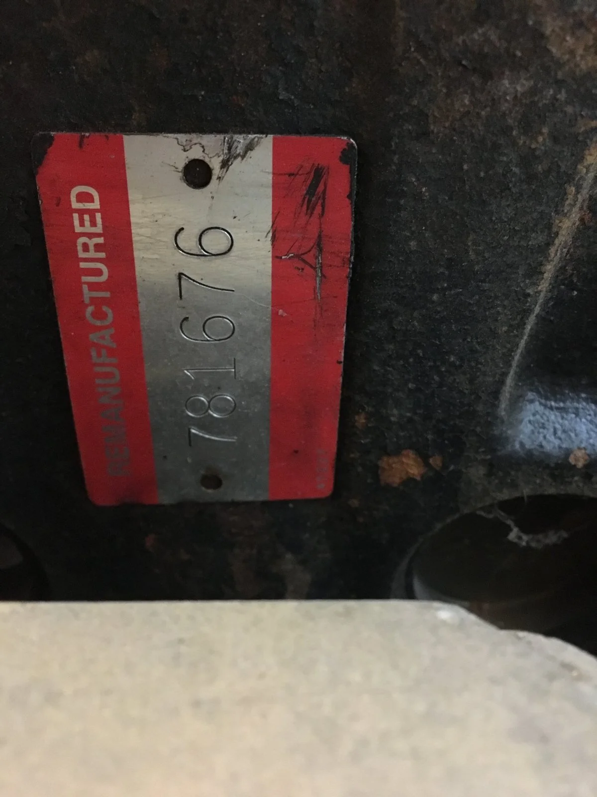

Plus, not everything my brother told me may have been accurate. Anyone seen one of these tags on the side of a block before?
It may be a 408 like my brother said still. Doesn't it take a minor overbore to make a 408? I thought the biggest on just a stroker was a 393. Am I wrong here? The tag suggests just a cleaned up block to me. So, it's at least a 351, i think I can say that's for sure.
At the minimum, the engine will have to be torn down completely and I'll have to do some measuring.
That cheap black paint on the block will have to go to. It ain't nearly pretty enough.
Now I'm a little anxious about the internals. My brother could have put a stroker rotating assembly in it.
Pay no attention to an advertised power range on a stroker, the cfm requirements go way up.
A 408 will be a 4.030 bore (cylinder refresh) with a 4.0 stroke. 393 will be the same bore with a 3.75 stroke. Obviously you'll have to open it up to know you have there.
