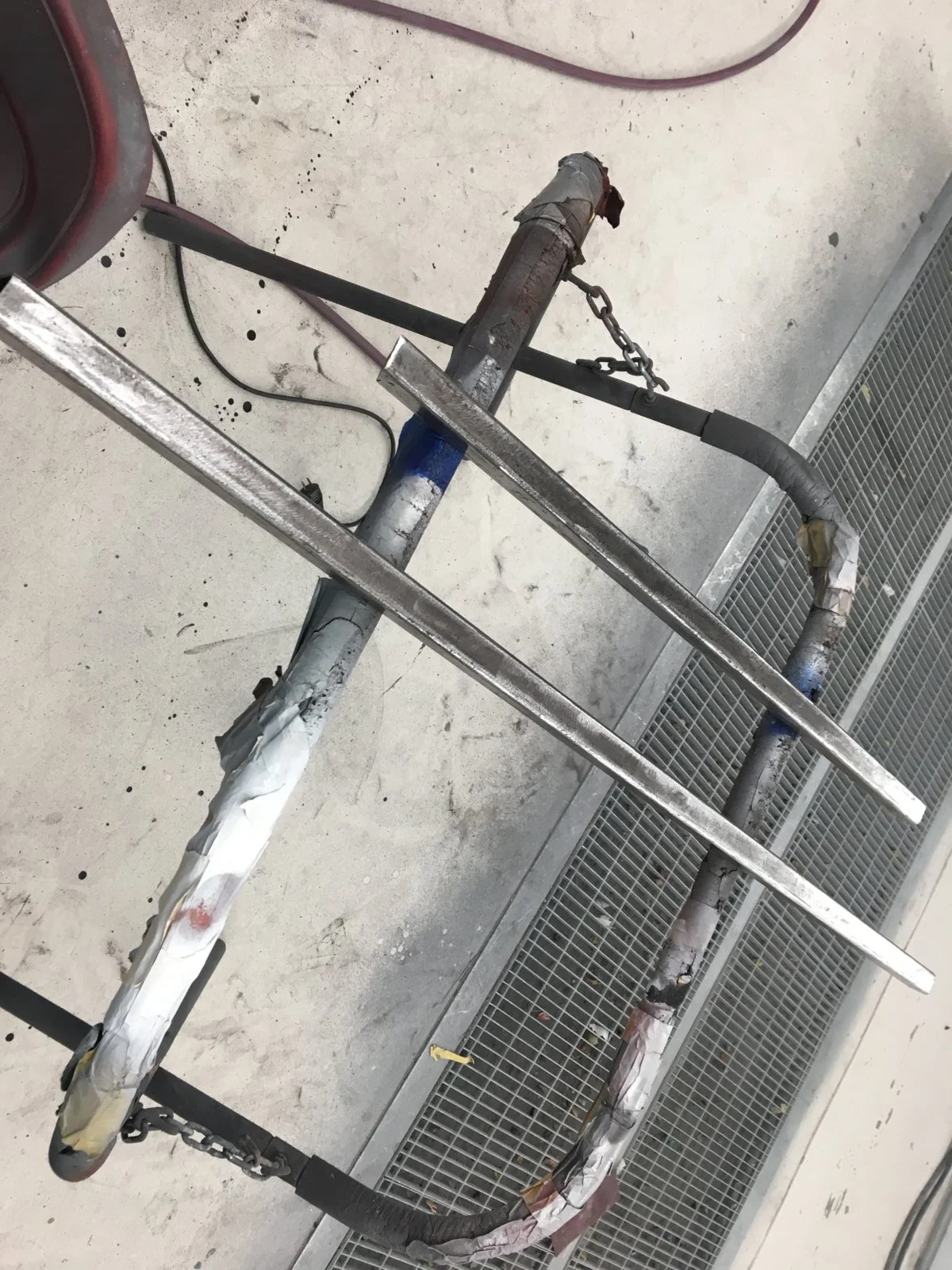

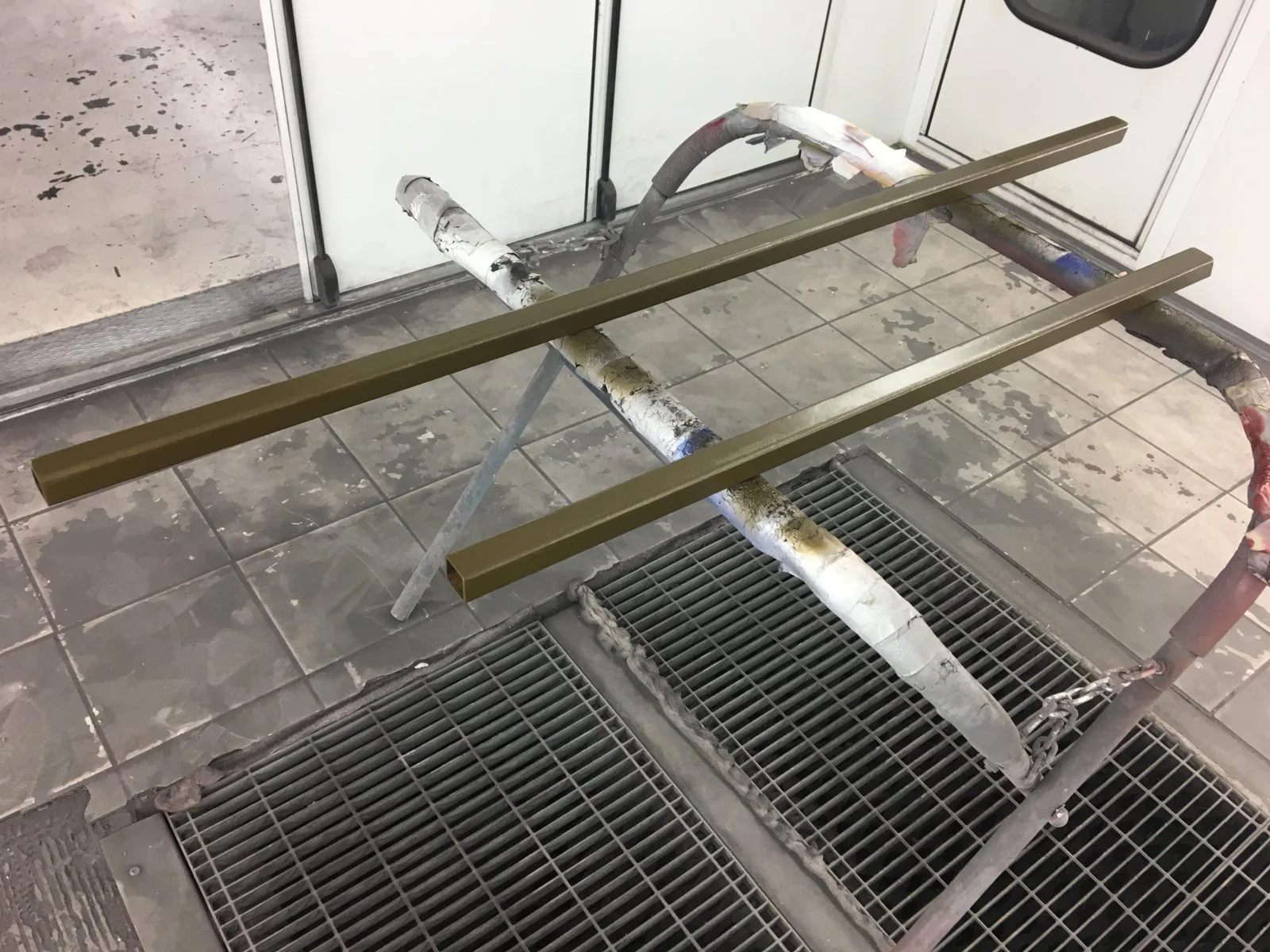

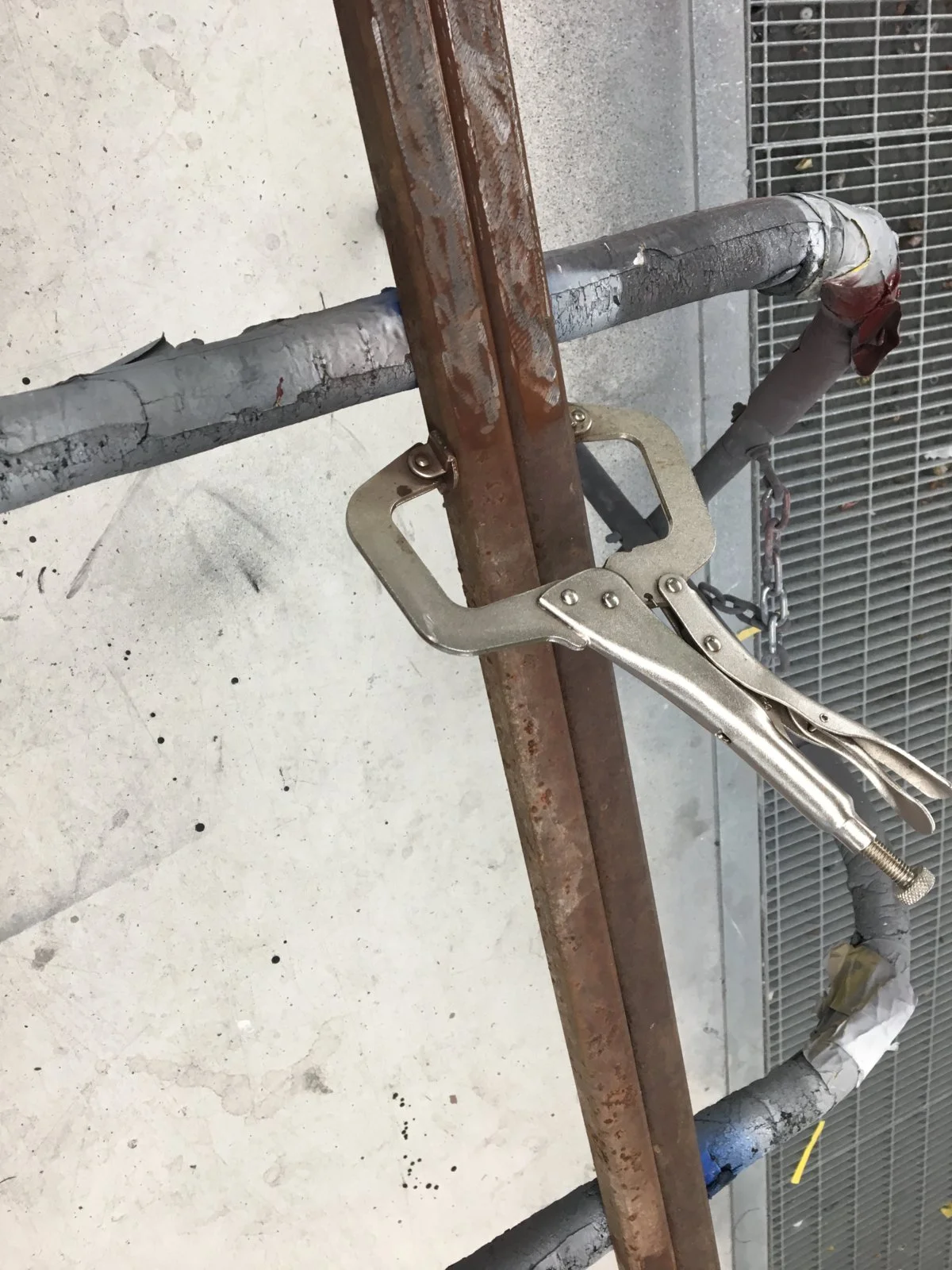

Well, I’m sitting at work waiting for my 1x1 bar stock to finish baking. Here’s pictures,
All ugly
Ground down
With an acid etch paint on them because it’s raining here today.
Not that big of a deal, sure. It is nice to use my air tools to clean it up though! A shop compressor has slightly more air capacity than the old home unit, lol.

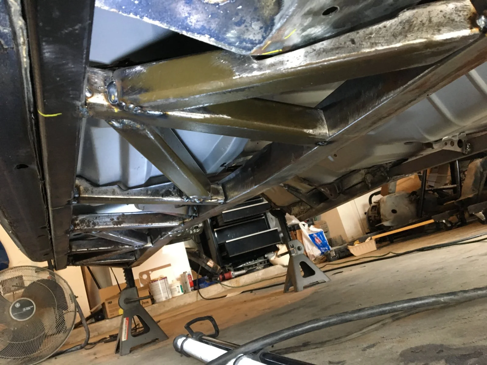

So I went to the garage naively thinking I would bust out a couple more rungs and three or four diagonals.:nonono:
God didn't keep me in suspense very long on what would be difficult.

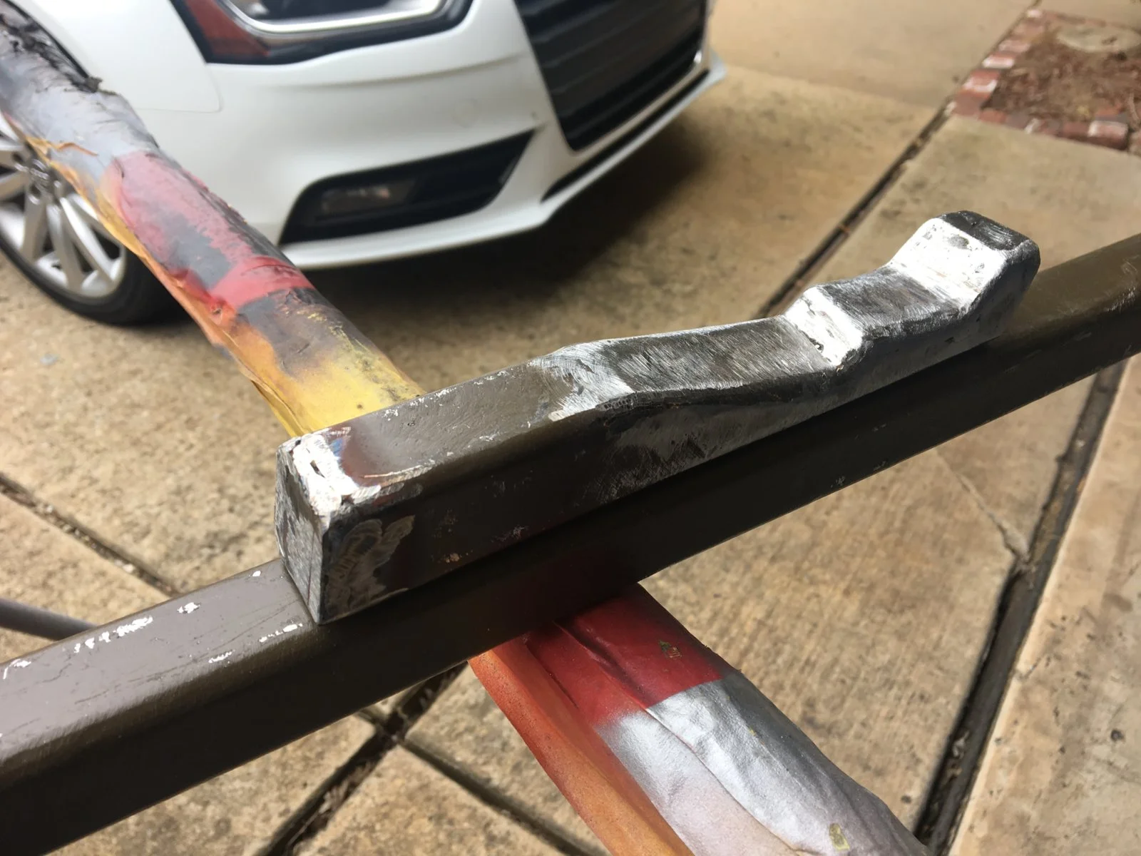

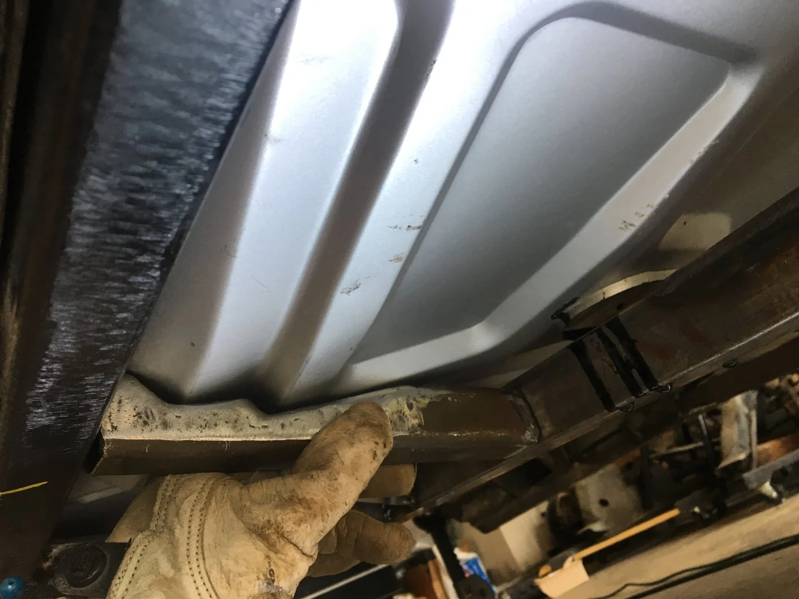

Rung number four was the first thing up for bids. I measured and cut a piece and laid down to see how it would fit.
#4 goes right under the rear seat footwell area. It drops quite a bit here. Enough to interfere with a nice straight rung of a chassis support.
I was left with three choices, one: cut into my new floorpan to make it fit......nope. Two: beat the snot out of the new pan to make it fit the straight rung......again, nope. Three: modify the rung to fit around the floorpan......winner.

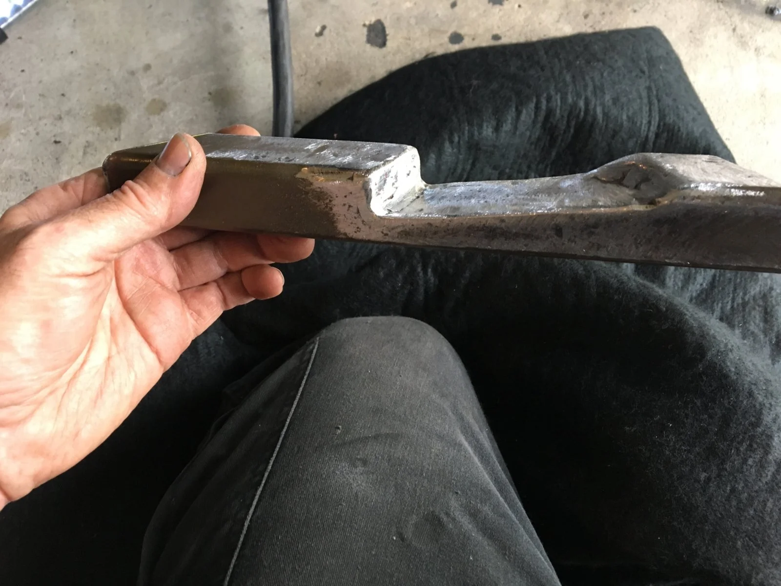

It took about 2.5 hours to make this one rung. I had to draw a basic design on the rung of the shape of the floorpan and cut it out with my die grinder. Then I went through the phase of laying on my back fitting, grinding some, fitting, grinding, etc....
Eventually I had the shape I wanted. Then I had to cap off the cut out areas. So I cut out four small caps, welded them, and dressed it. Once I had the shape all cut out I found out I'm an idiot and cut it about 1/8" too short:nonono:. So I added a cap to the sfc end to give it the extra length.
It fits up wonderfully now.
So, on to rung #5.

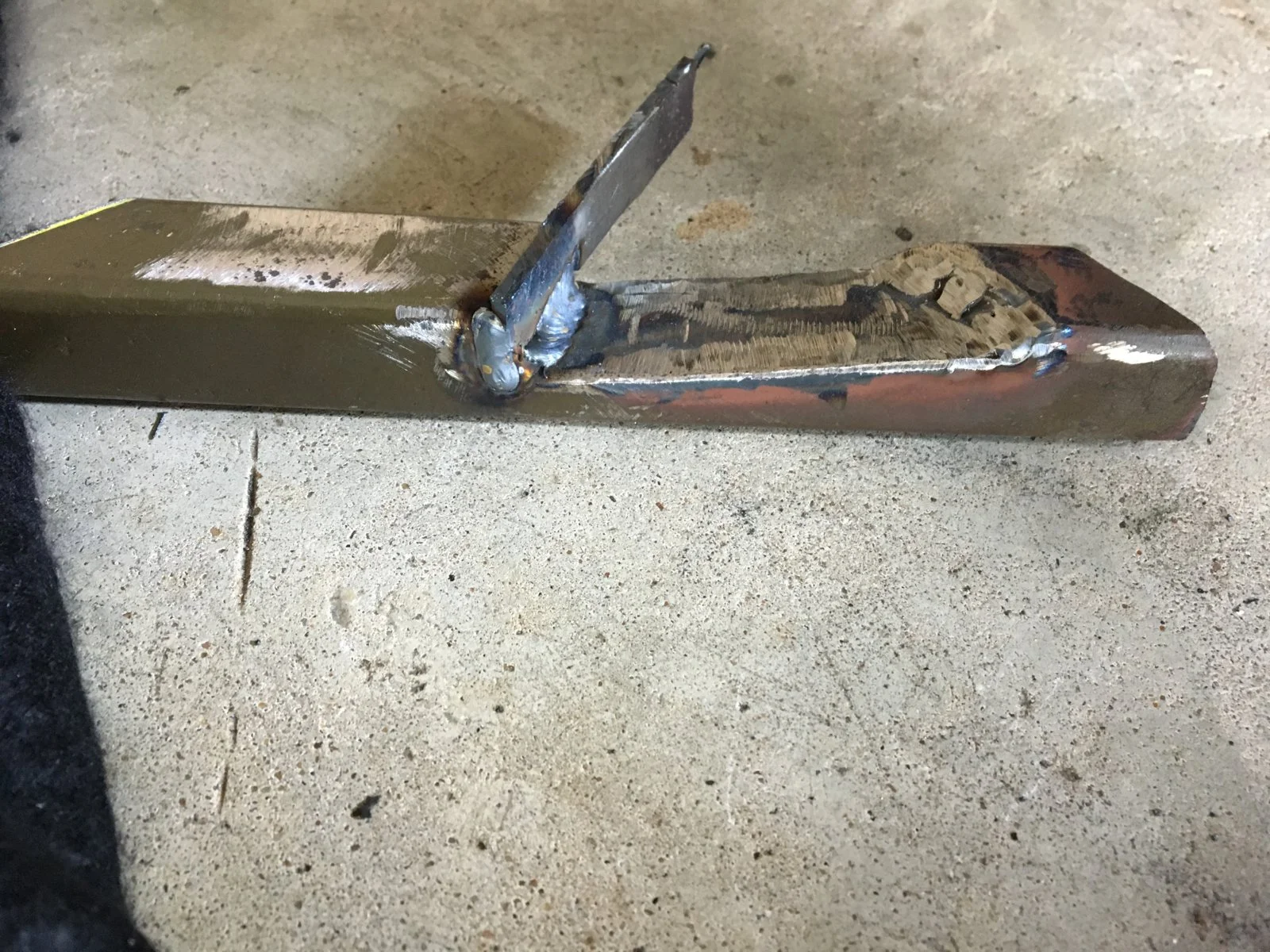

Okie dokie, rung five was a piece of cake, maybe ten minutes involved in it.

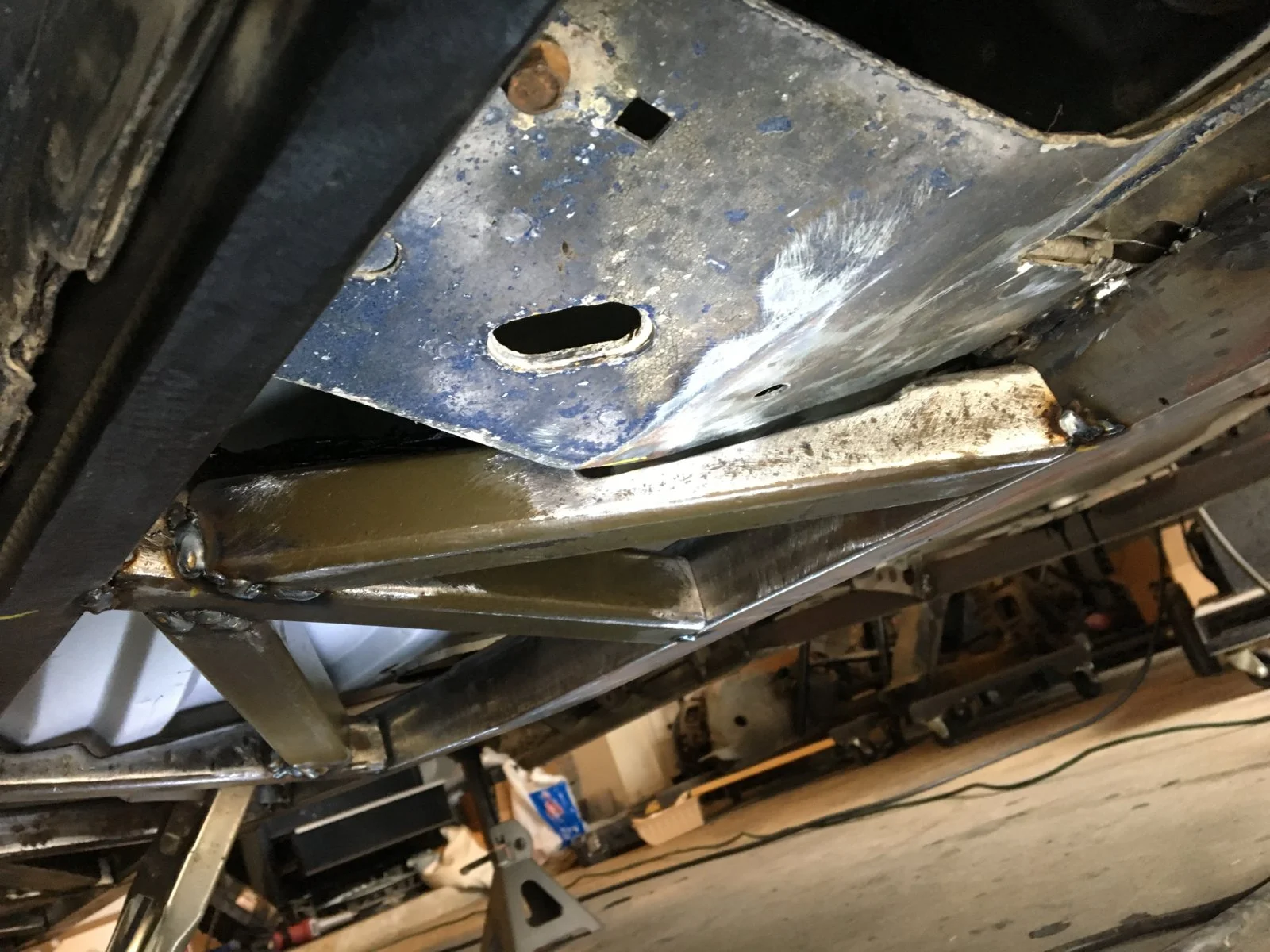

Then the first diagonal, piece of cake again.........Then came the rear diagonal brace.........:nonono:

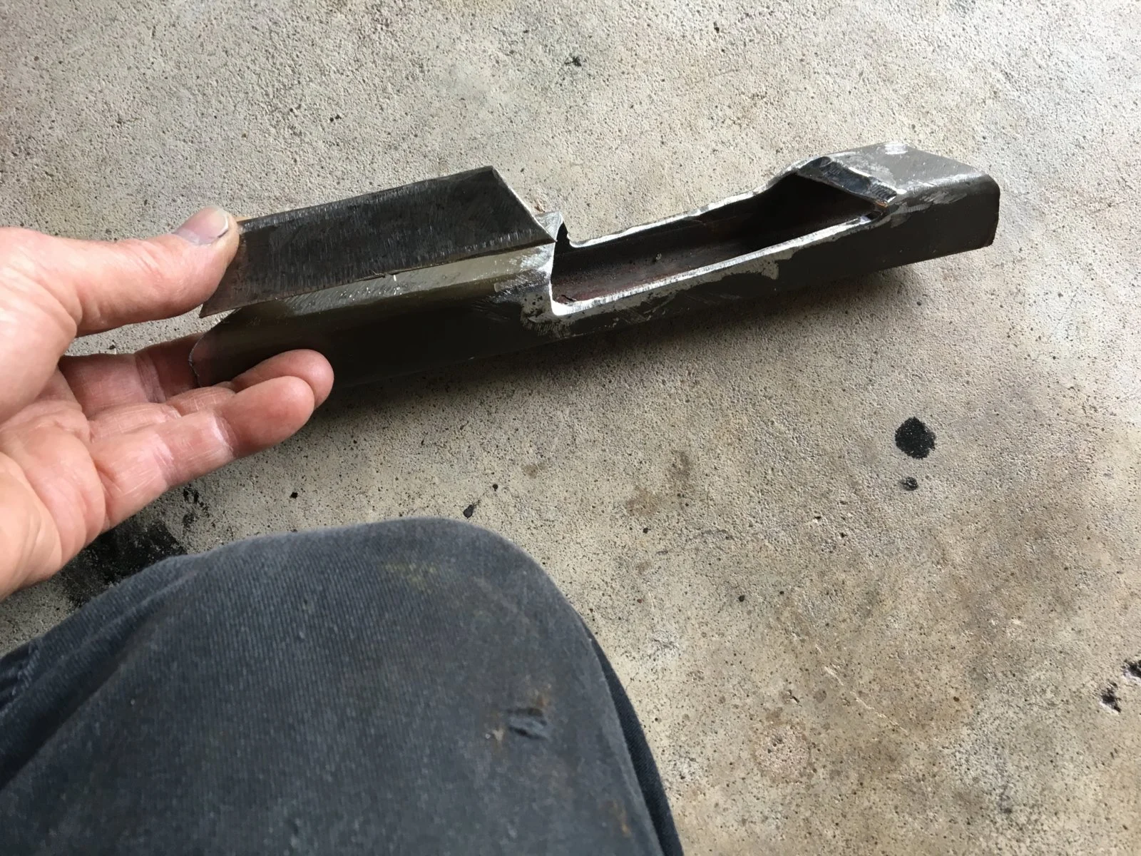

It goes from the jr directly underneath the torque box. The torque box is in the way. Choices again, cut out the torque box? Uhmmmmmmm.........make the rear brace conform to the torque box.....:nice:
I did like before with measuring and cutting out a chunk, then the fitting and grinding thing. I cut out the first patch piece to fill the new void.
welded it up and dressed it, took another piece of scrap and partially welded it in.
Then I cut/ground off the excess and finished welding it up and dressed it.
Tack welded it into the cs.
So, here it is, the driver's side chassis support fabricated.
Now I'll need to cut the spot welds off the sfc and the rocker pinch weld, drop the cs out and put it on a stand and do some pretty perimeter welds around the connecting tubes.
BTW, when I drop the cs I will be seam sealing the floor to rocker area and probably the front and rear edges of the floorpan from the underneath side. That is, before I weld the cs back in.
Then I'll coat all of it in POR15, to include the cs. Weld the cs back in and coat the welded areas.
