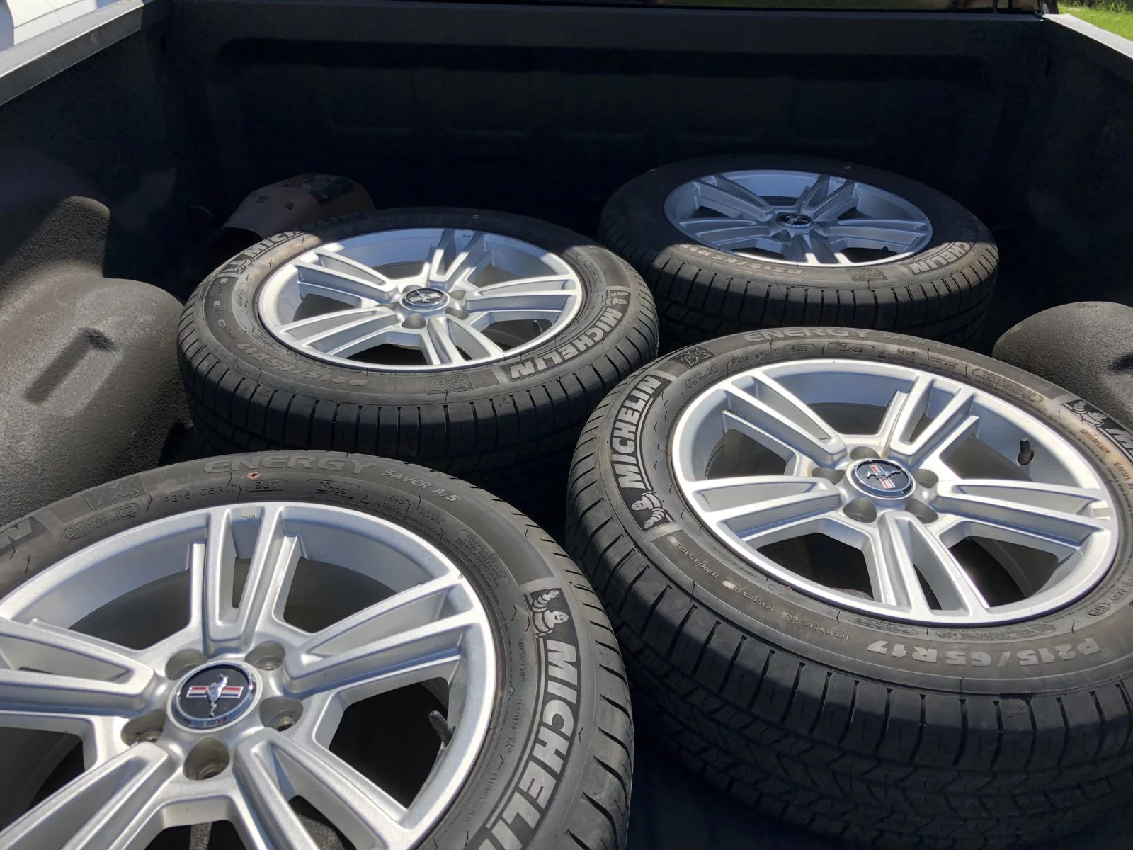

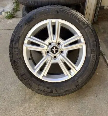

So I'm getting these tomorrow to make the car a five lug roller.
https://tulsa.craigslist.org/wto/d/17-mustang-wheels-with-tires/6690500653.html
These are actually going on my son's mustang and I'm taking his old ones. He could use a new set of tires.
His are the 2009 16" version of these.

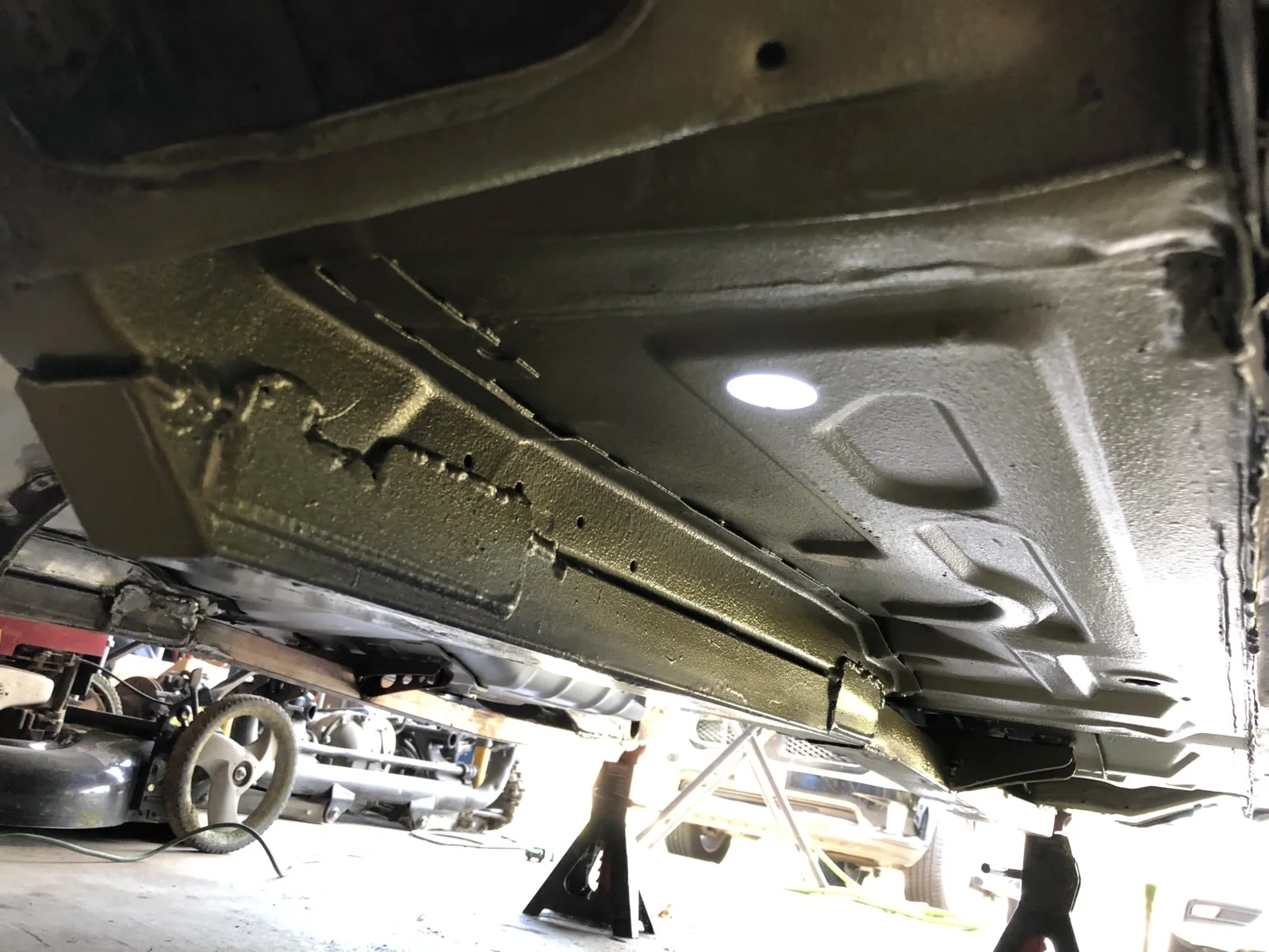

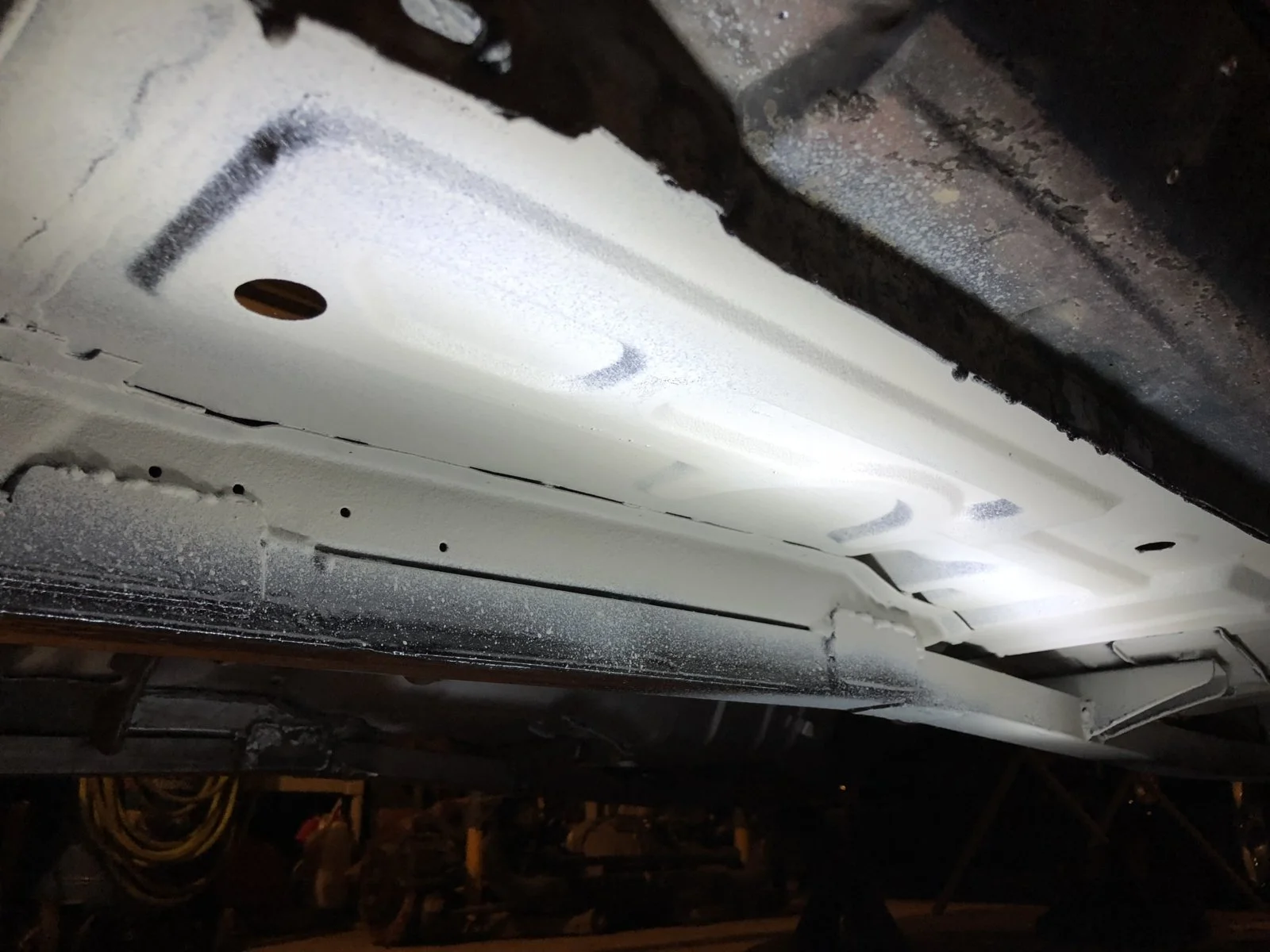

It really doesn’t matter how late I do the undercoating, it just MUST be done today.

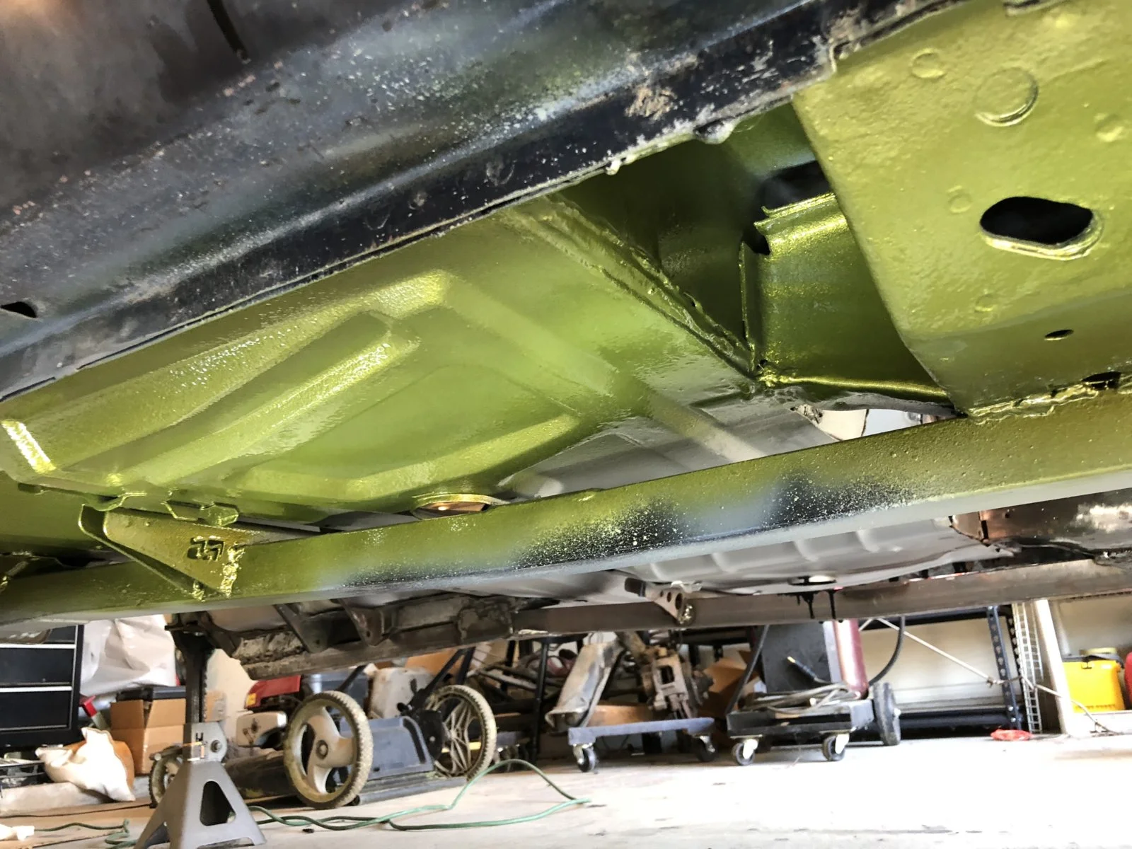

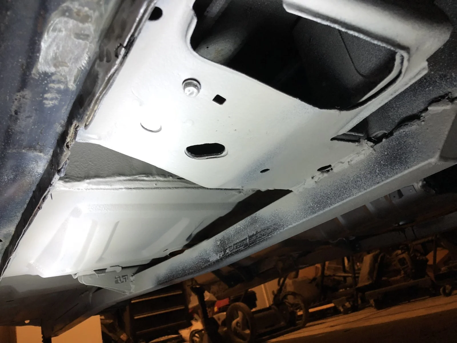

I want to make the undercarriage green, hence the color of the undercoating. I need to spray the back sides of things before I weld in the cs.

I shook up the green, got some sealer and my gun. I'm ready to go.
I just want to wait till ten before I click on the compressor. Keep the savage beast appeased that way.
So , by lunch it should be green and relatively shiny under there. Shiny as the texture of the undercoating will allow.
By the way, the undercoating isn't really undercoating. It's rocker chip guard. I feel confident in topcoating chip guard without worrying about peeling.
By the time I get back from getting the new wheels this afternoon, the paint should be hardened enough for me to consider welding.

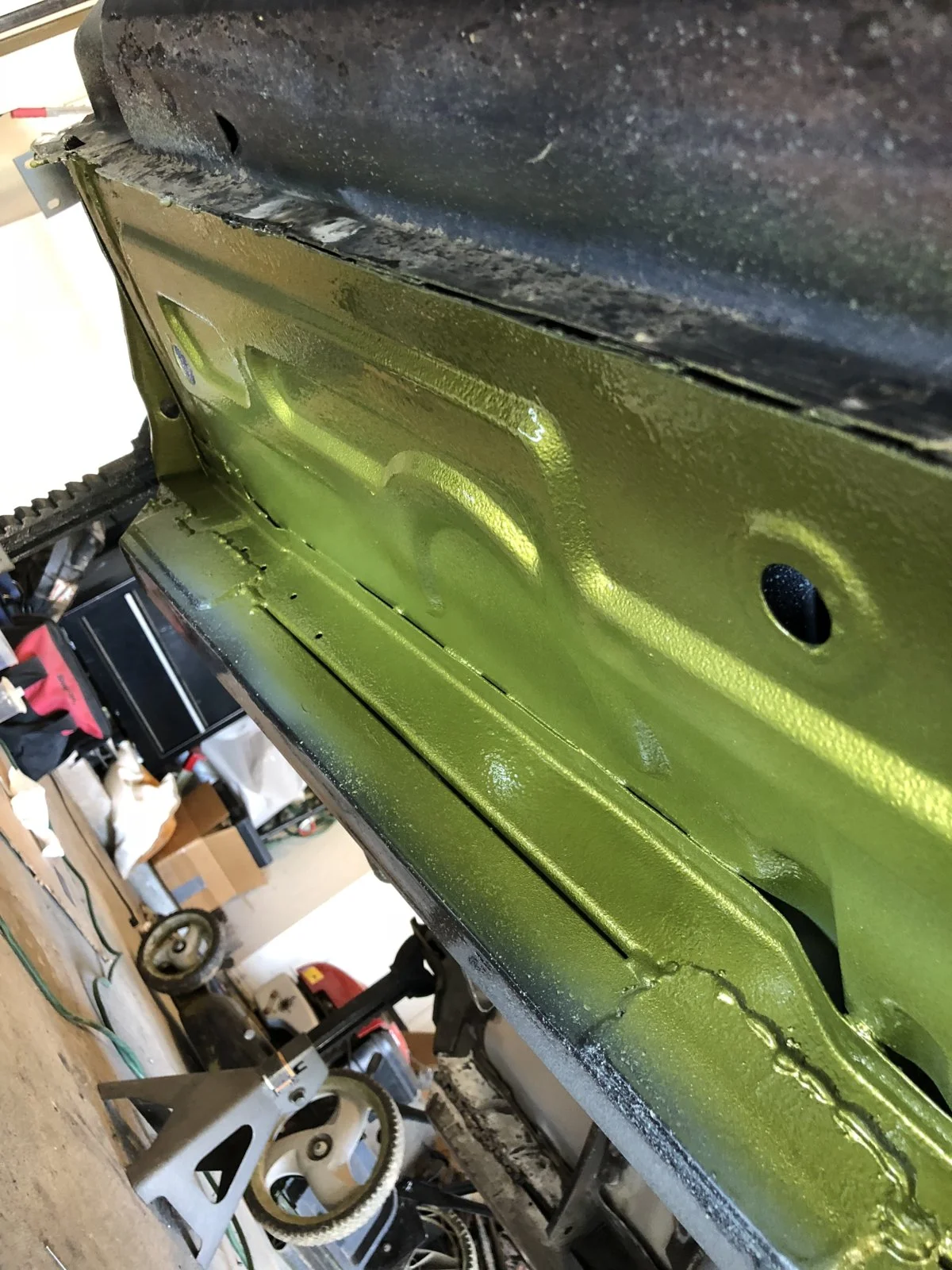

Ok, I scuffed the undercoating with a red scotchbrite, blew it all off, then I used a tack rag on it.
BTW, perfect day for me to do this out in the open today. Absolutely no wind! Ask how often we get days like that in oklahoma.
Anyhow, I sprayed a sealer over it and then sprayed the color. I'm letting that dry right now and then I'll go clear coat it.
I went and got my son's new wheels.
