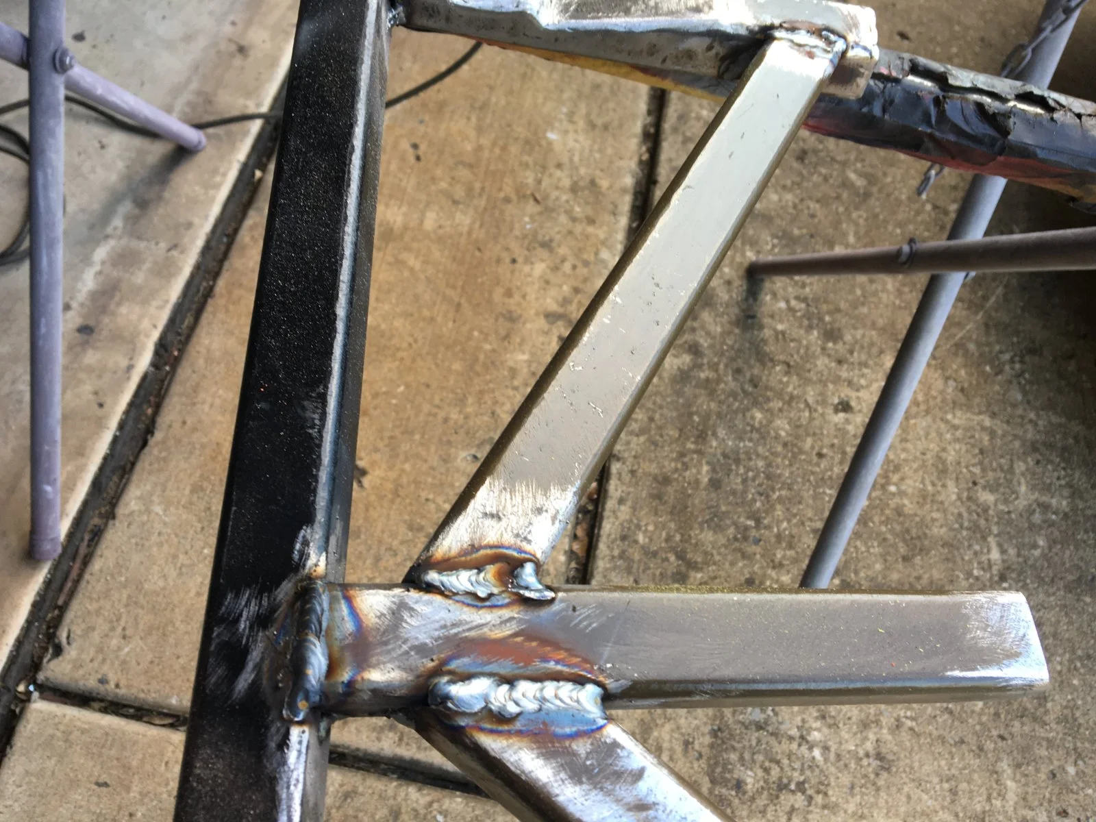

I cut the spot welds on the sfc and the pinch weld and put the cs up on a stand to get ready to weld.
This is as pretty as I can seemingly come up with today, sad......
I need to dress the top welds to not be a problem when mounting back up to the floor. I think I'll dress all of them now.
Oh well, it's as solid as can be now!

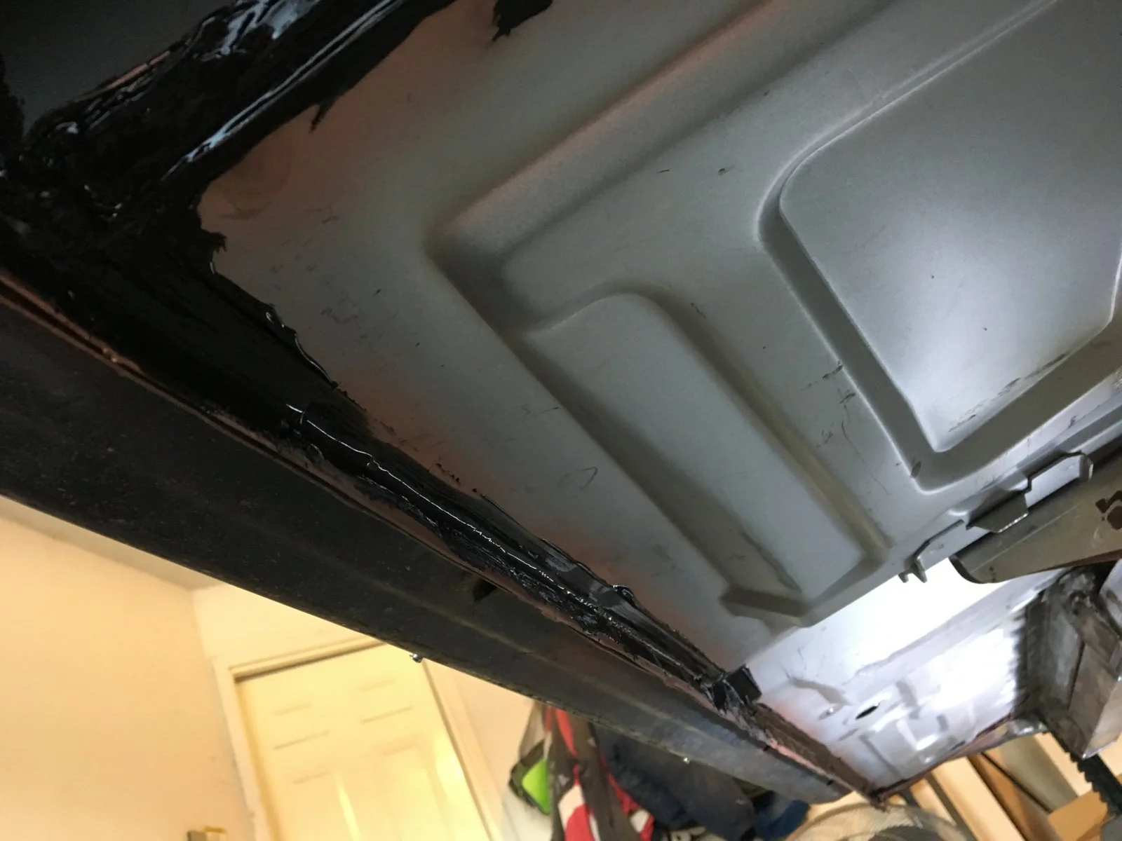

So, my big/little progress. I sprayed some primer first, scuffed it and spread the seam sealer.
I had to get it on there tonight so it could harden, Cleaning it up will take ten minutes.

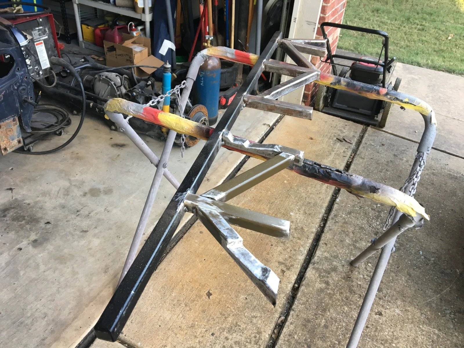

I took the cs to work with me today, it seems some people are getting a little crabby with the beautiful sound of grinding metal. What's wrong with these people?! lol

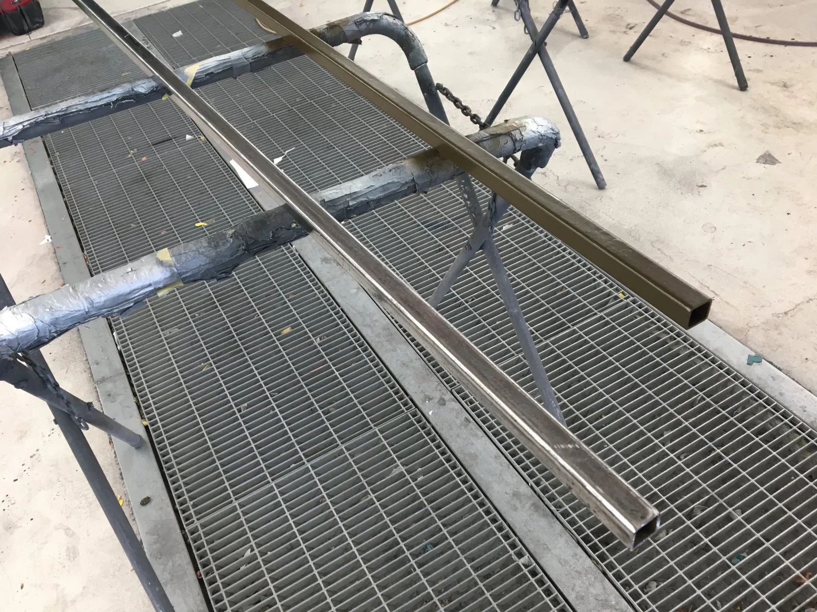

First off, I got the kit for my right side cs. Some assembly required.......

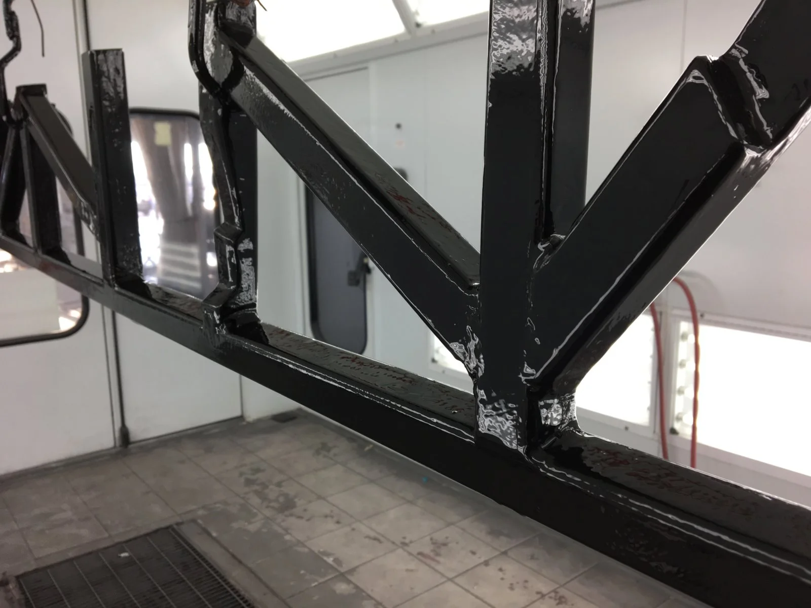

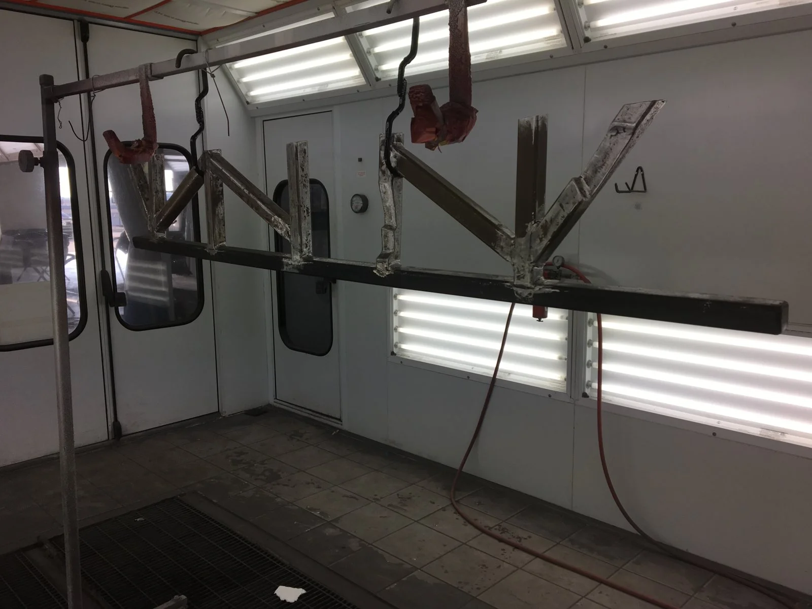

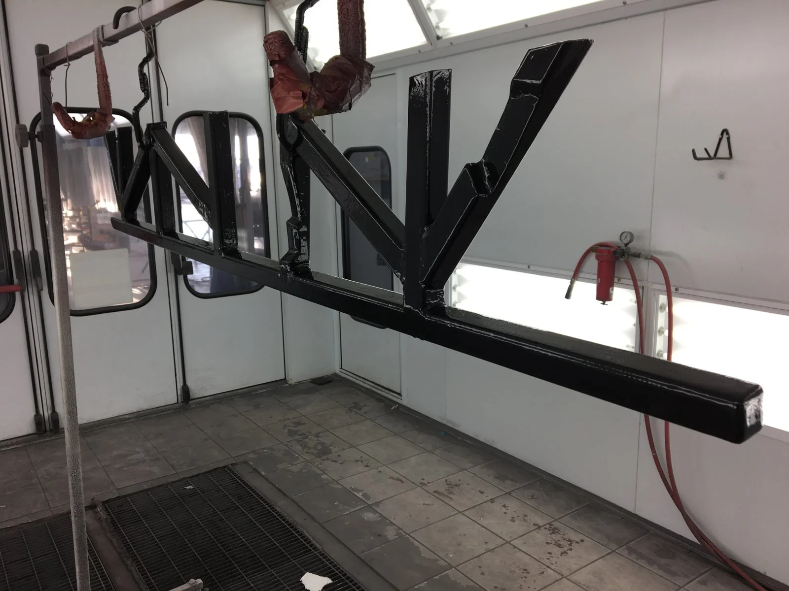

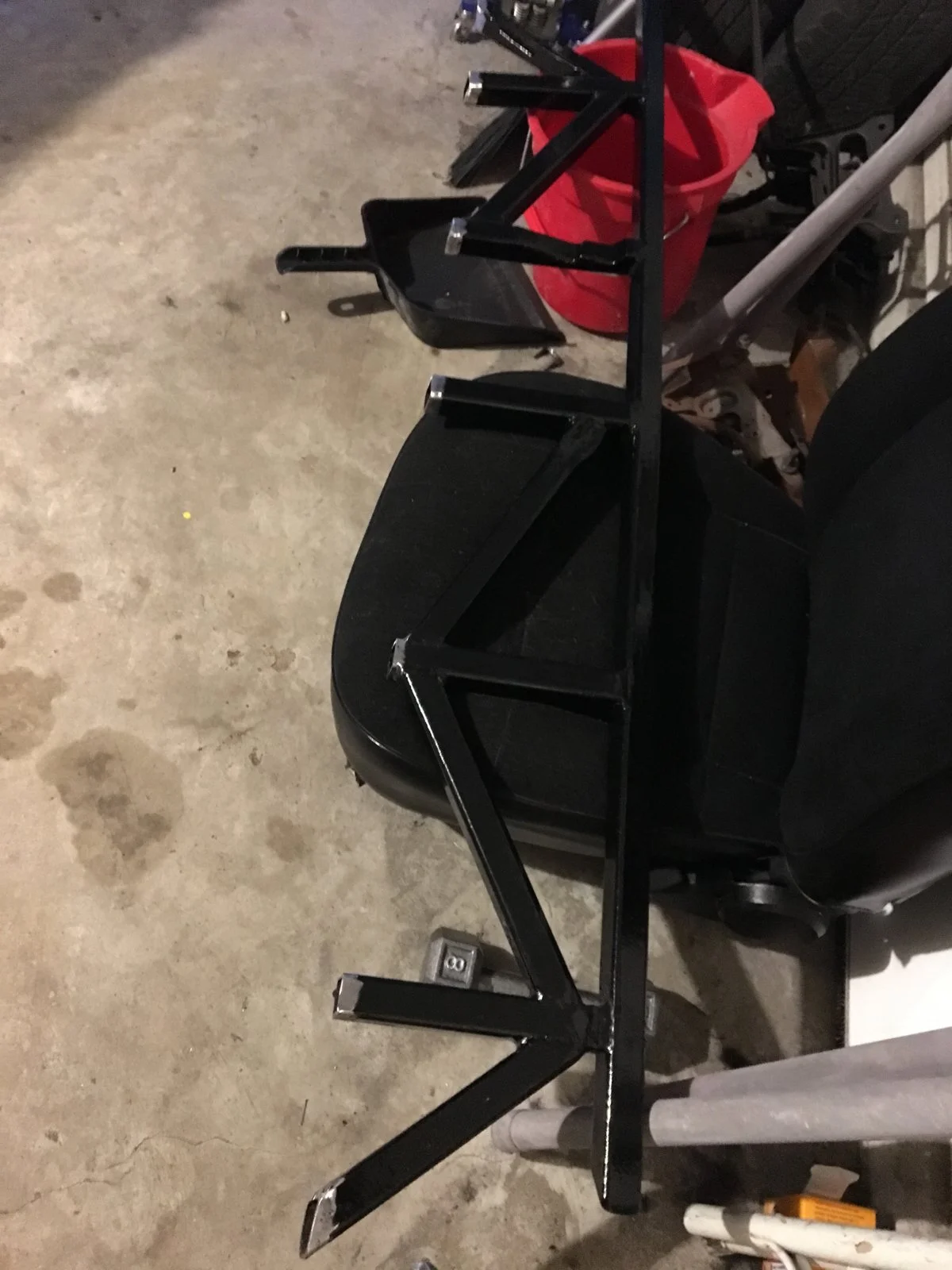

I dressed all of those welds on the cs and hung it in the booth.
Then I decided I wanted to try to spray POR 15. It's a little thicker than most paints I spray at work. It sprayed fine though.
I thought I would try a bake cycle on the POR 15. So I baked it at 160* for thirty minutes. It did almost nothing for it. Heat does NOT speed up the dry time.

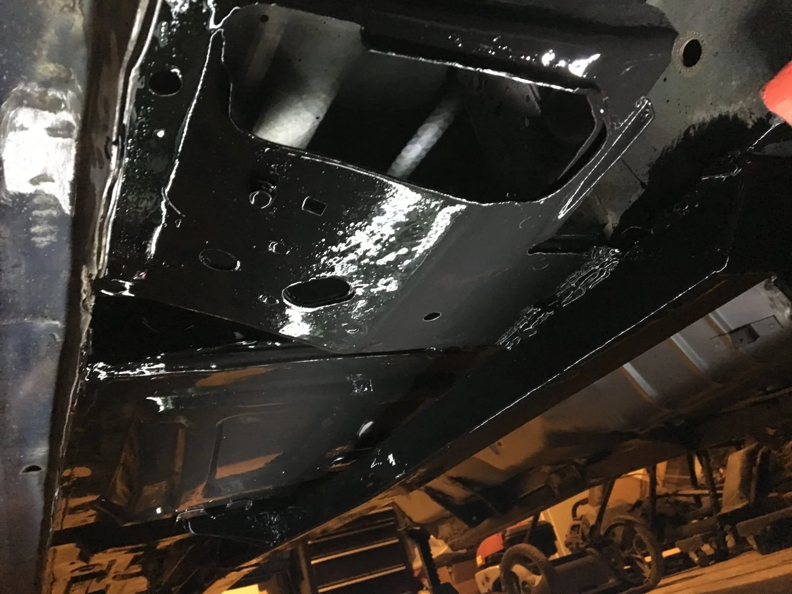

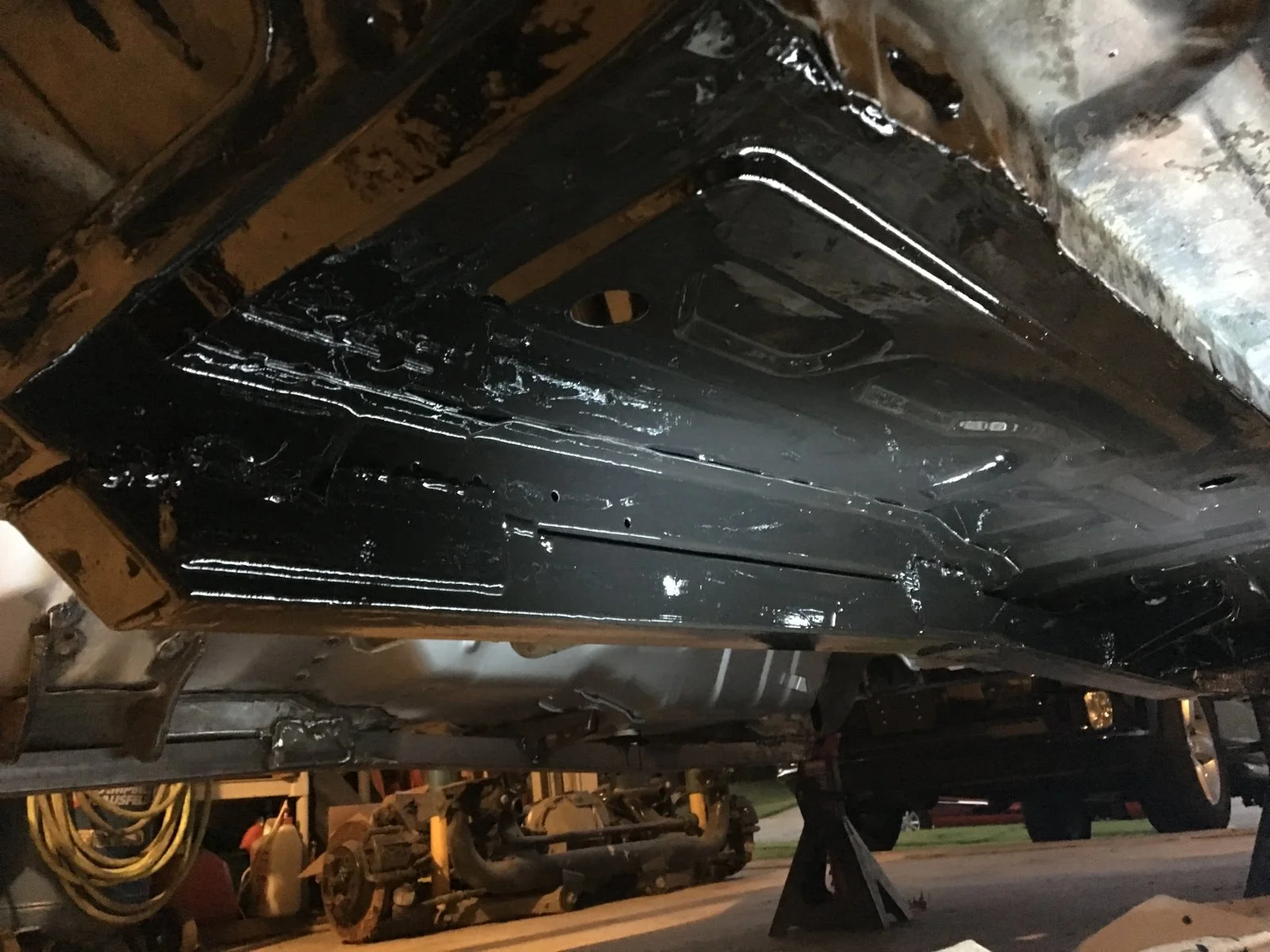

Tonight I coated the area of operation in POR15. From the torque box.
To the engine bay.

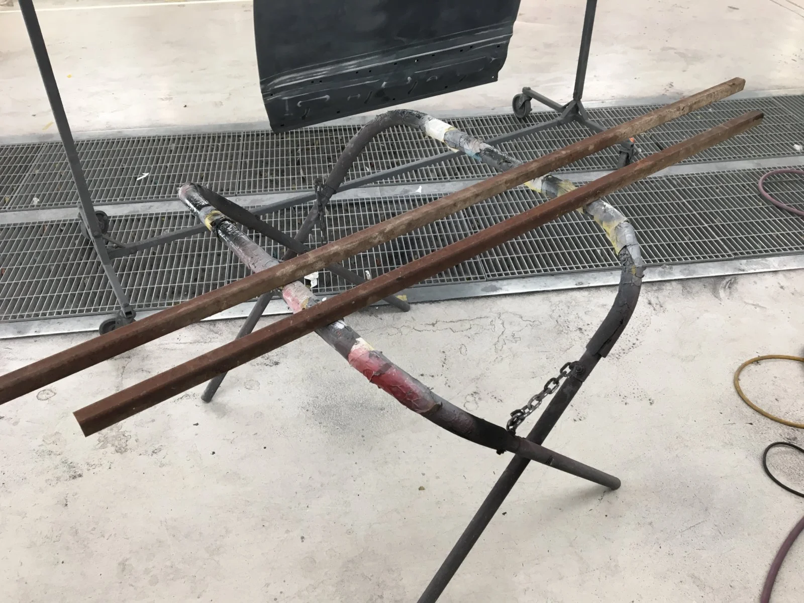

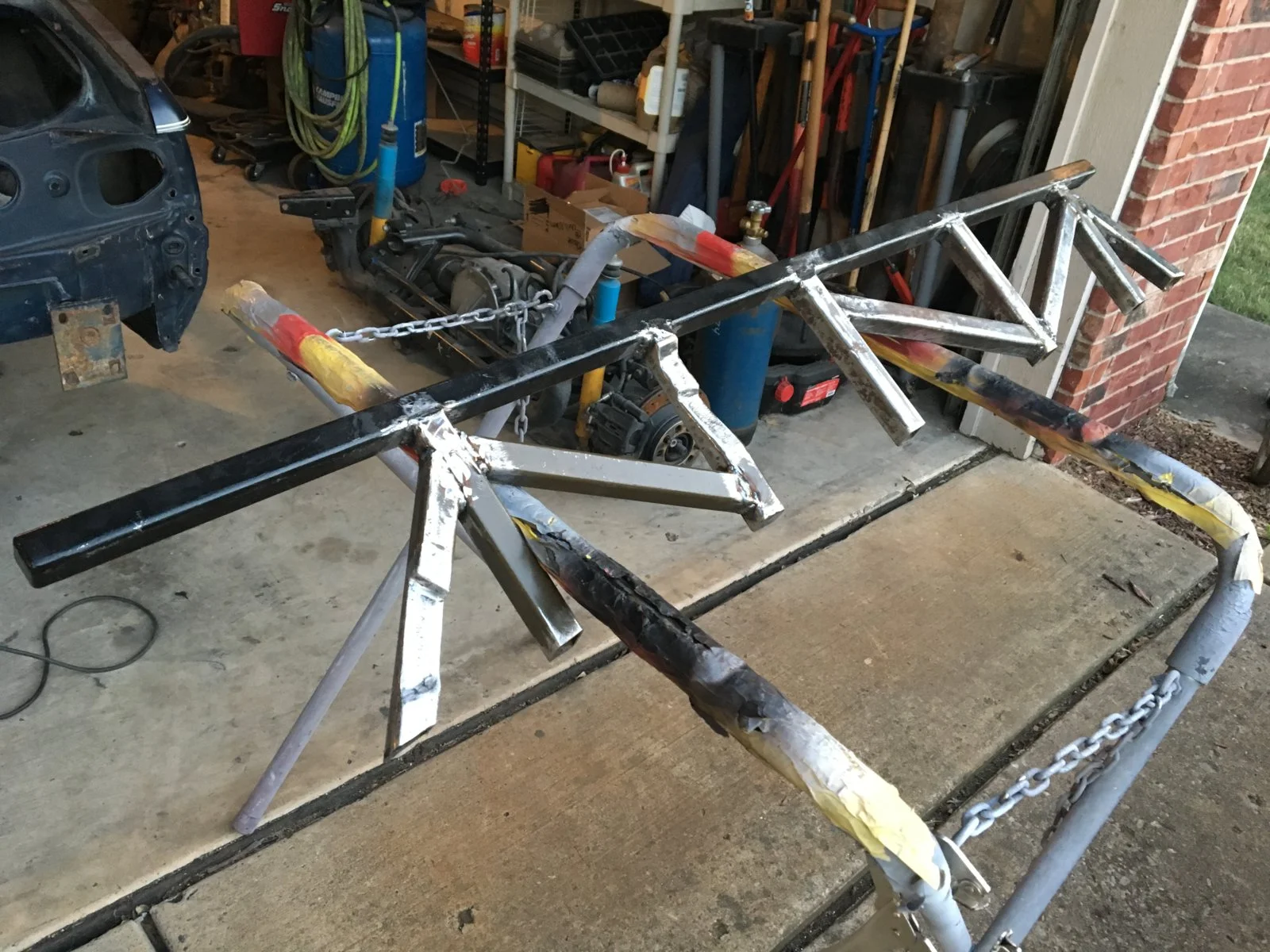

I finished what I wanted to get done, so in keeping with my kinder, gentler disposition I ground down the passenger side 1x1’s to get clean metal here instead of at home.
Then I coated them with the same etch paint as before.
Before
After (mostly)
