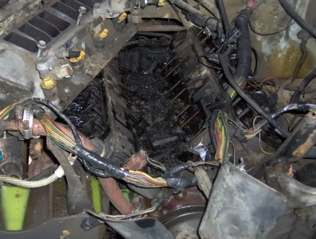

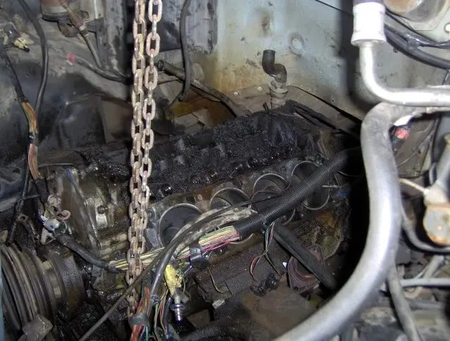

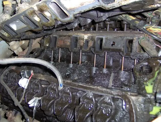

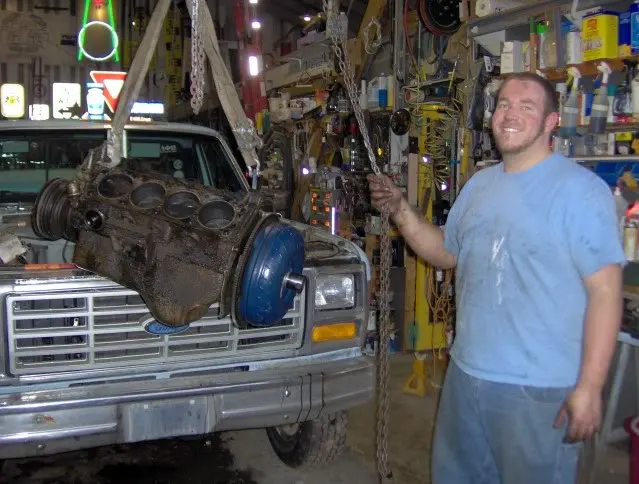

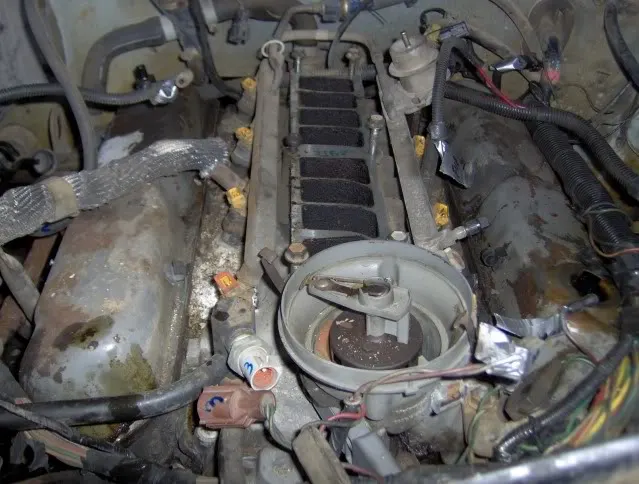

So... Came home from college and started tearing my block apart... UGH!!! HOOOORRRRIIIBBBLLLEEEEEE!!!!! But not that bad. Biggest problem I had was trying to get the fuel line "quick snap" crap off. Took the intake manifold off and opened her up and found this... Probably should have followed the warning signs of the gunk in top of the heads. I'm just going to throw a bunch of pictures You can see the progress. Took the heads off the gasket was good and there weren't any "cleaned spots on the bottom of the head. Figured it was a cracked block, pulled the entire motor in a day. Never having done anything like this before I thought I dun purty good for a 1.5 day project. On the look out for a new block so I can strap it all back together and ride on. Over all wasn't that bad. If anyone can explain how this much sludge gets in a motor let me know. Lots of not being taken care of I suppose. On to the pics. See if I can do it right...

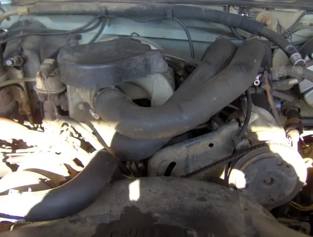

Got some more pics now... beware...
Found a good deal on a motor in an 86 van. 30,000 some miles. Going to pull it drop it in when I come back home again. Not bad for an amature huh? Soo... much... grossness.... Looks like somebody took a dump in the motor.

The block for my 4 cyl to 5.0 swap looked exactly like that. There wasn't even a ridge on the cylinders, but a crap load of GUNK and I rebuilt it. (Haven't put the block in yet) A good cleaning and i bet that block can be rebuilt.

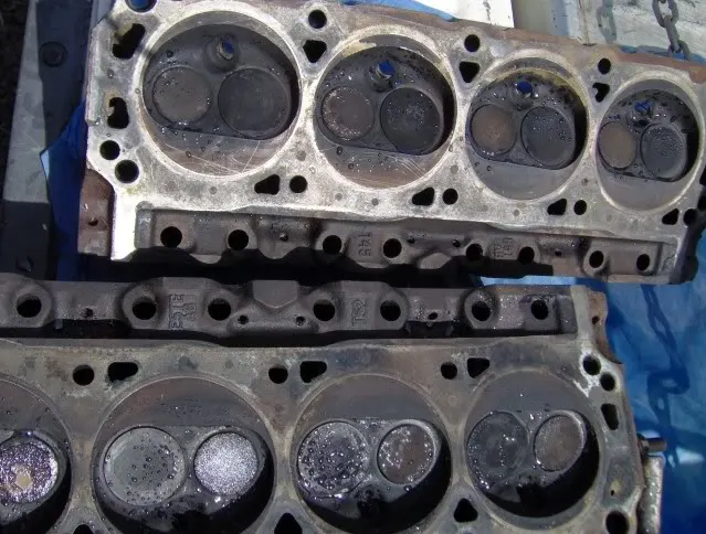

Finally got my dad, back home, to check out the heads that came on my motor they are E5's...?
Is this bad? Are these worth spending money to have them ported and valved? Or should I just go buy a set of cheap E7's?

"E7" is short for E7TE. The E7TE head was originally engineered for an '87 F-series 5.0L truck, that's why it has a "T" in the engineering number. (T = Truck) They were also on all '87+ 5.0L engines that happened to be "H.O." (all Mustang, some Continental, all Mark VII, some Town Car, some T'bird, some Cougar). Any '87+ passenger car that had a "S.O." 5.0L engine instead of H.O. continued using the E6SE head.
The E6SE head was not ever used on the truck engine. That was a passenger car head only. ALL passenger cars in '86 used that head. The '86 truck 5.0L used heads from the '85 truck 5.0L (E5TE). Mustangs/Capris in '85 did not use the '85 truck head. The '85 Mustang/Capri 4V engine used an E5AE head. The '85 Mustang/Capri CFI engine used the same heads from the '78-'84 5.0L engine (D8OE).

i would get some E7's. You can find them cheap, I mean dirt cheap. I have two sets that i won't even try to sell, cuz they'd only get me about 10 bucks a pop. I see people advertise them for 50 bucks and weeks and weeks go by. So yeah, don't pay more than 20 bucks unless they've recently had a valve job, port and polished, etc....
