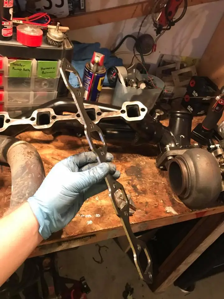

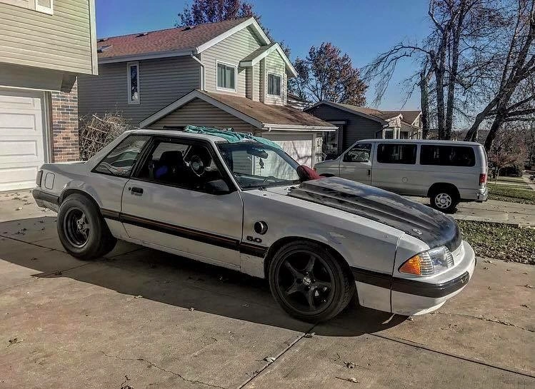

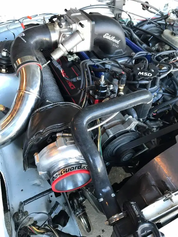

Well it been awhile since I posted but the fox is now boosted. I got the on3 kit installed and I am very impressed with the quality of it. I I plan In getting a VS racing 7875 and also using vs racing wategate a BOV. Ive read a lot of good things about them and I have a couple buddies that run them and have really good luck with them. I tried using rtv gasket silicon on the exhaust manifolds because after talking to everyone running this kit that what a bunch of people recommended, however it leaked after about a month. I then researched some more and decided to install some remflex gasket and since then I haven't had any issues.

Sweet. Who did the tuning? Whats it make at the tire?
My buddy, messed with the tune so far but I couldn't really get it dialed in until I relocated my air temp sensor to right in front of the throttle body. The intake gets heat soaked so much that it would throw off the tune a bit. Im running some 4 lug drag stars on some Nitto nt555r. So far I really like the tires for street use, I have tried them at the track yet.
What system are you using to do the tuning? quarterhorse or a standalone system? I happen to know some workarounds depending on the system.
The car is running Megasquirt pnp2. I really like the layout of everything and its very user friendly in my option. Also there is a lot of people around where im from that are familiar with it so they are always able to lend a hand when I have some questions.
