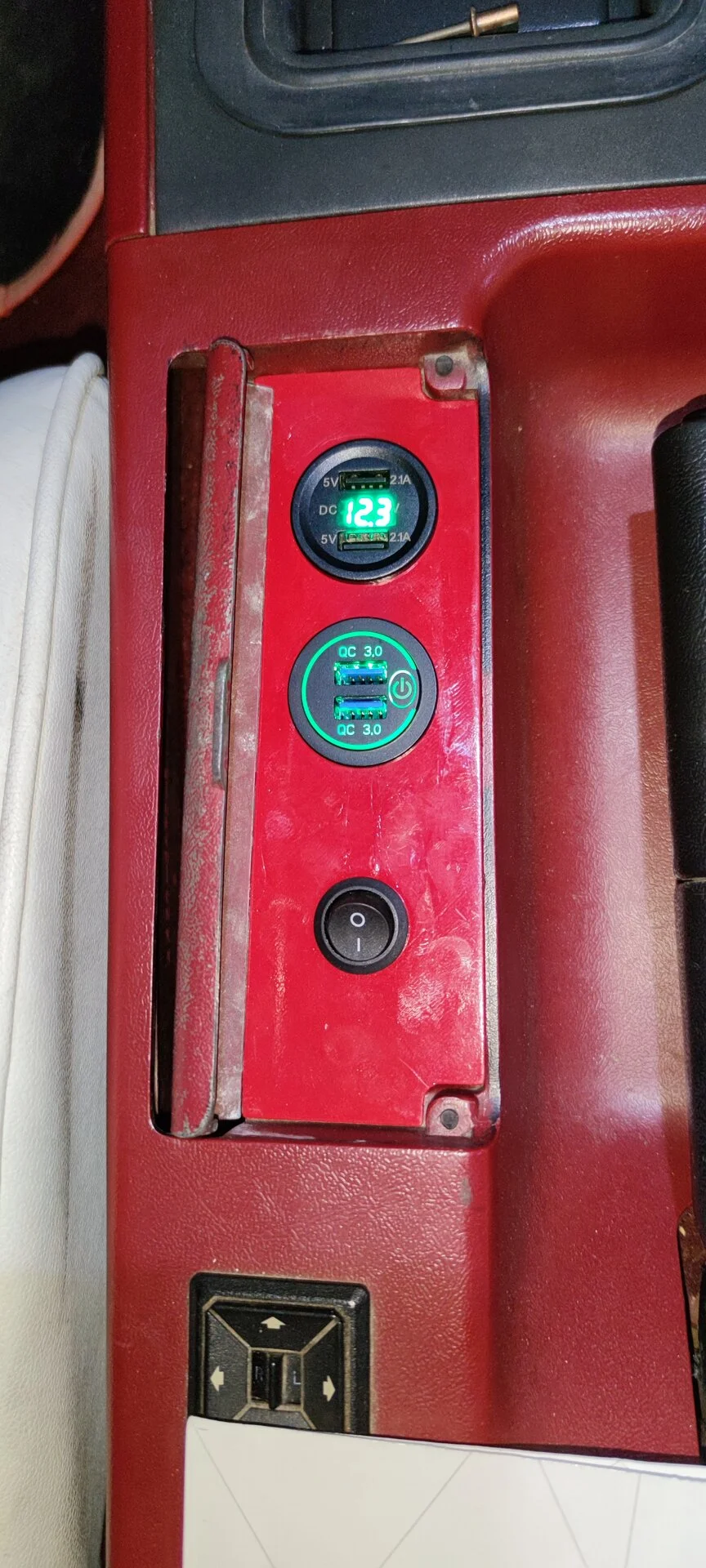

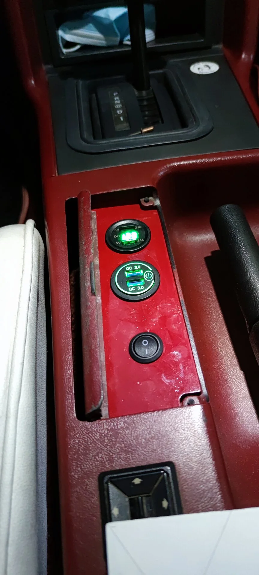

Back to stang... Apart from bleeding lifers(s) I made cruising easier in 2021.:
3d printed panel, 2 usb chargers (one with voltage indicator, other double QC 3.0), switch and cigarete lighter plug and I assembled this prototype. Switch is there only to turn off both chargers to avoid battery drain.
Ashtray and stock lighter out, panel plugs in and click into place. 30 sec install/remove time. No drilling or modifications to OEM parts, simple and quickly reversible to stock ashtray.
Color tone was fail and finish is not exactly piano look, but hey this is a prototype :-)

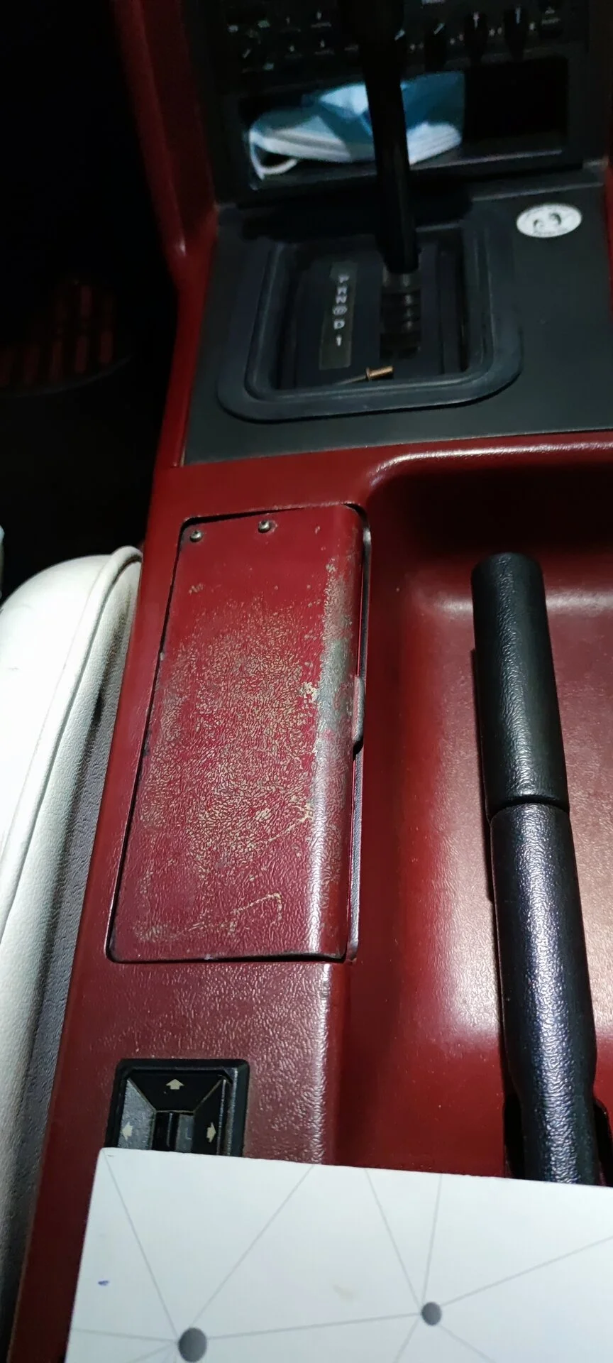

BTW My ashtray lid is metal, but I see other ones as plastic. Was this some PO project or were there metal lids also in '88?
Either way mine looks pretty bad and worn out (as you can see on pictures) plus it is broken and I am waiting for larger order to squeeze new one in...
Question - nobody gave me a indirect clue or opinion:
Driving our 302 with bleeding lifter(s) should be 'fine' (or harmless if you like) till wintertime? I am religiously:
a) waiting 5-10 minutes in idle to pump up lifter and noise to disappear before I touch accelerator or drive...
b) take care if cold start knock will change or extend duration (currently till coolant warmup)
c) tracking warm engine valvetrain noise (at the moment normal)
