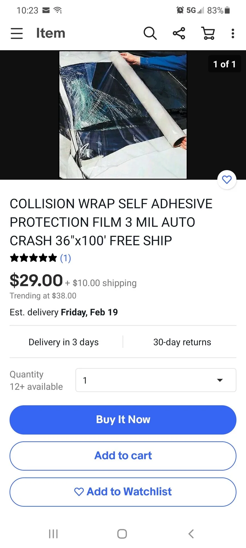

It has adhesive on one side. 3 mil is as thick as a contractor trash bag. Works very well. Tape and plastic works too just doesn't look as good.

Thank You @90sickfox. I will use vapor barrier as a temporary solution. When I throw myself on interior I will replace that with proper alubutyl water/sound/heat insulation.

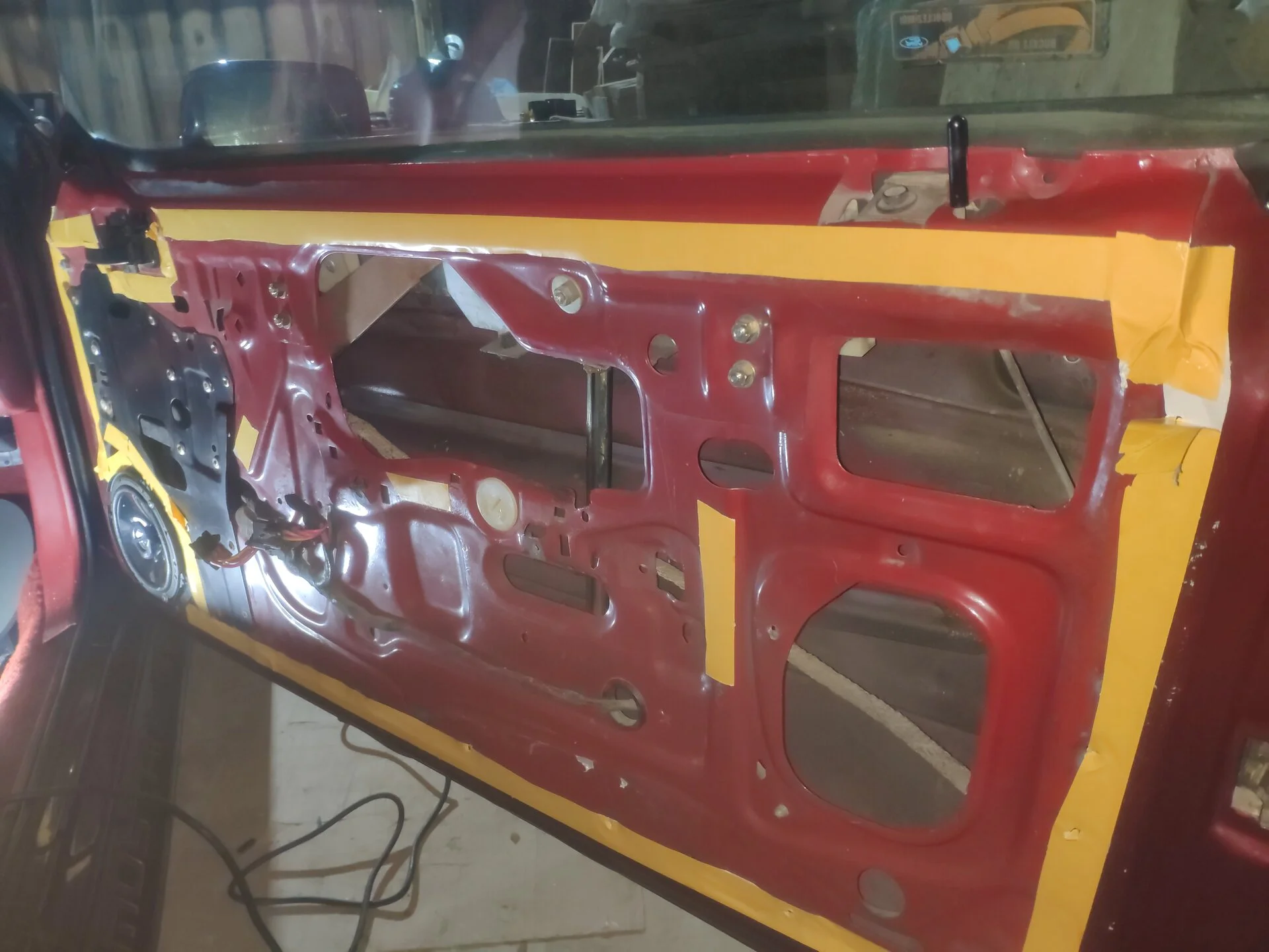

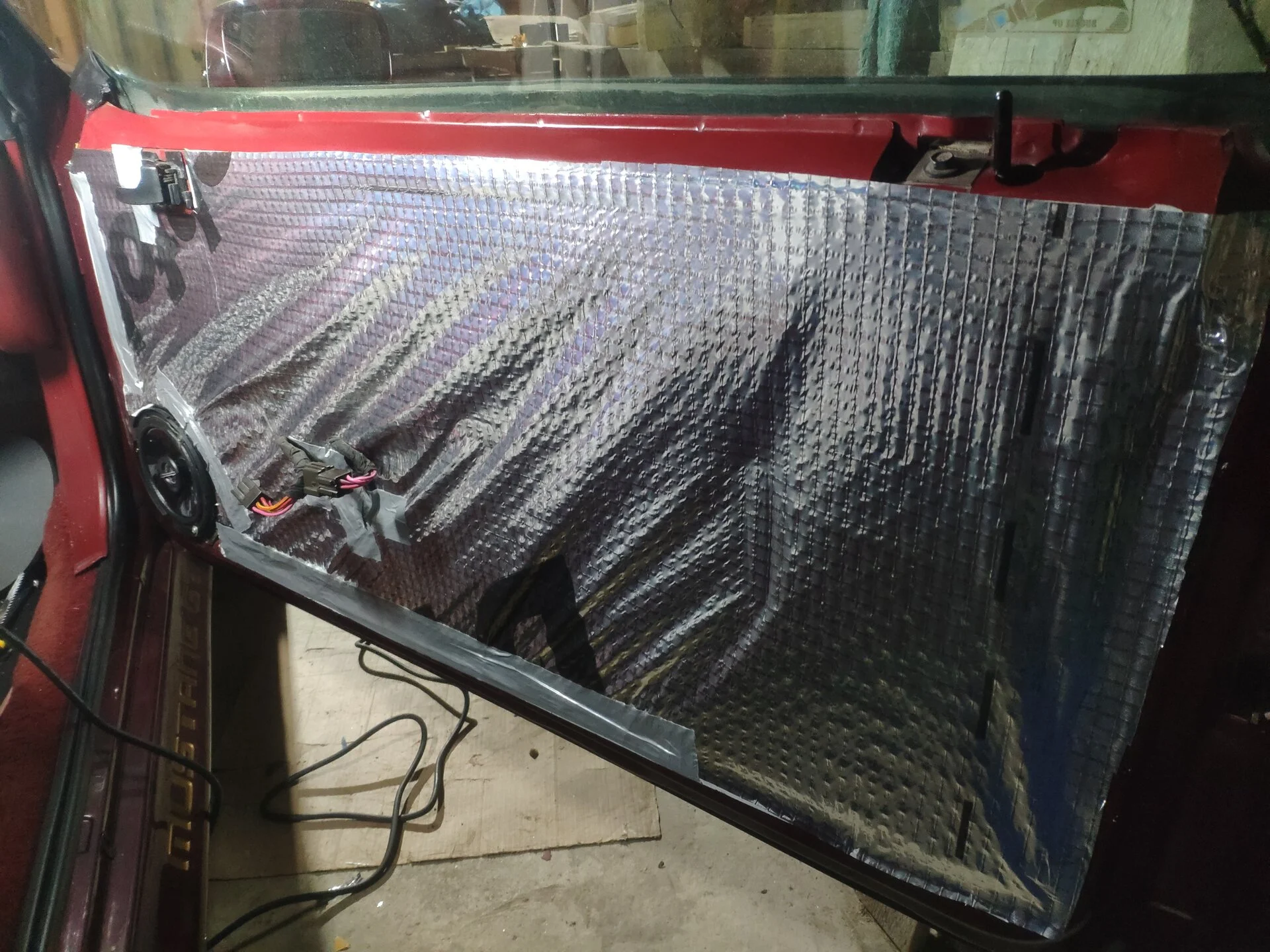

As a matter of a fact, passanger doors done. I dont know how You are known to construction works, but this reinforced vapor barrier as its name suggests - let's vapor OUT, but is not letting water IN. 3M double sided tape is also used instead od sealer cause this is temporary only. Foam to be cut tomorrow :-)
Pictures... of course :-)

Passanger doors fixed. Vapor barrier, 2x3mm (2x~1/8") insolation. 10mm (~3/8") was too thick and pushing plastic clips out. Be aware on projects.
Switches taken apart, cleaned and polished contacts - working like new.
New speakers got foam around edge. This and insolation in door made bass pretty sharp compared to tin can bass before this door fix.

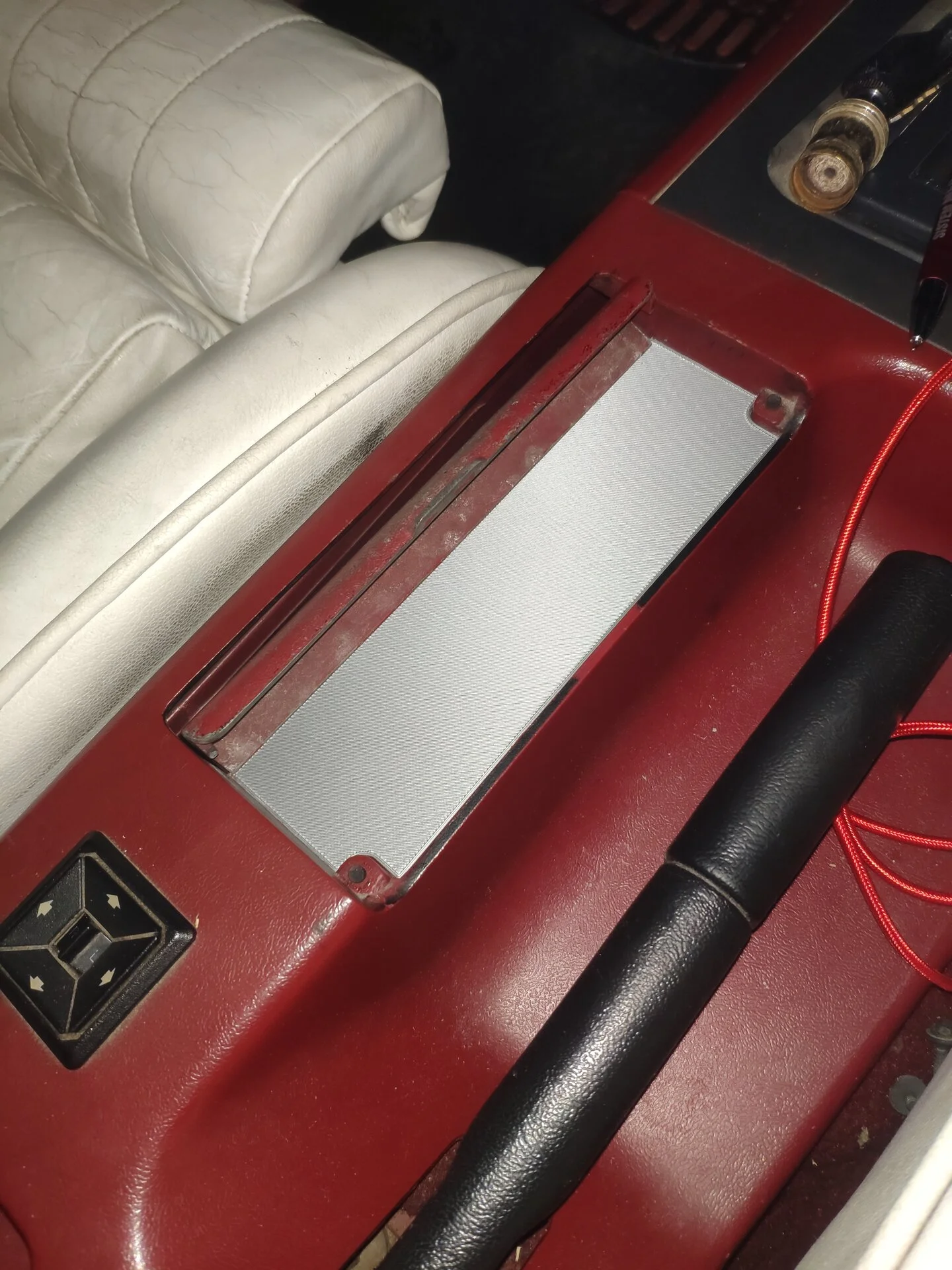

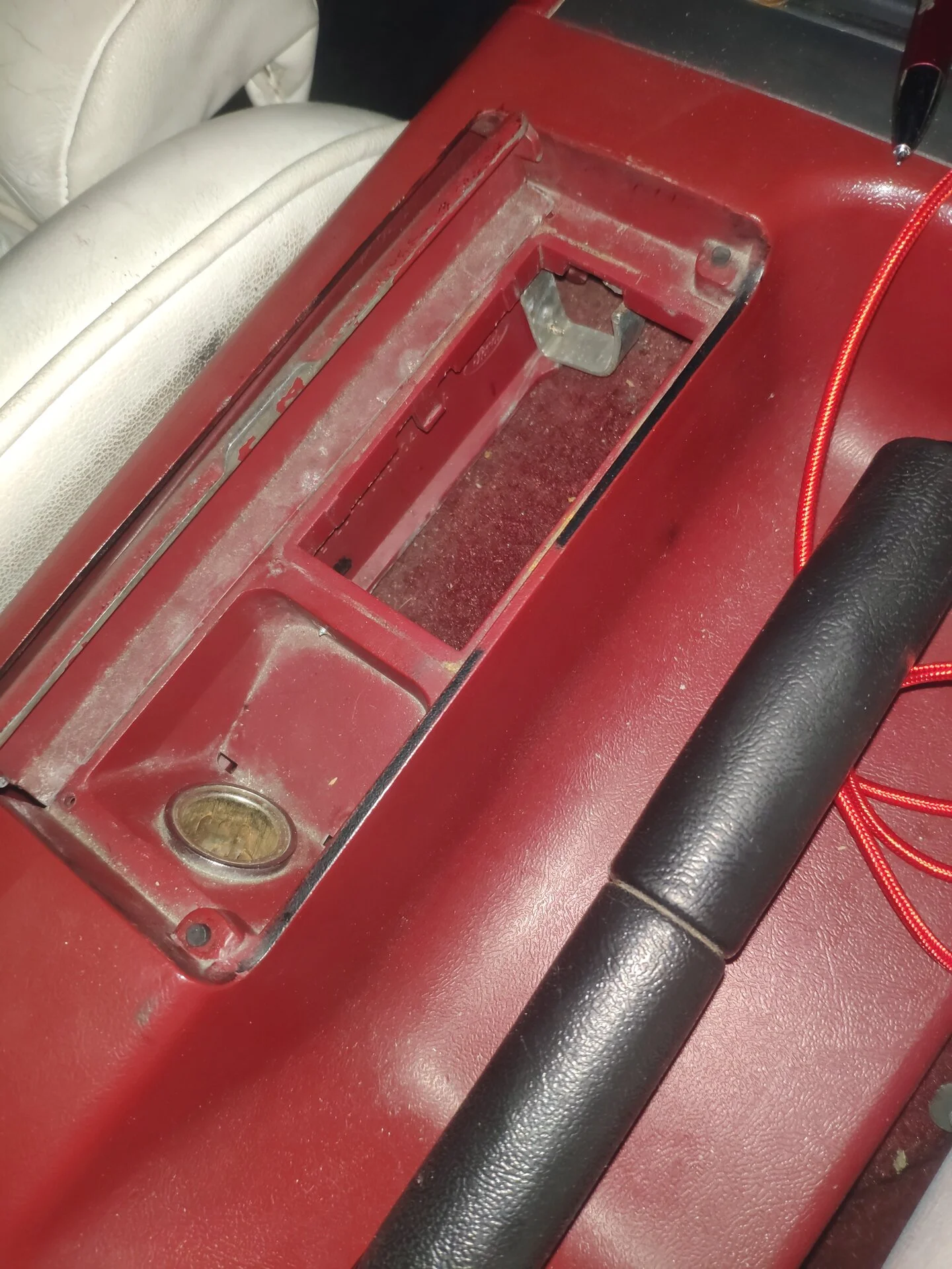

I will put in 3D printer topic opened when I finish, but I am working on ashtray reversable mod. 'Under lid' prototype can hold chasis chargers/switches/whatever. Design will be simple push on. You remove ashtray and lighter and stick cover on. Install whatever You want, close the ashtray lid and nothing is visible. Picture attached.
For cup holder one would need to cut console a bit, and I dont want that, but You can change model if You like. When I finish I will upload so You can print them piece of cake...

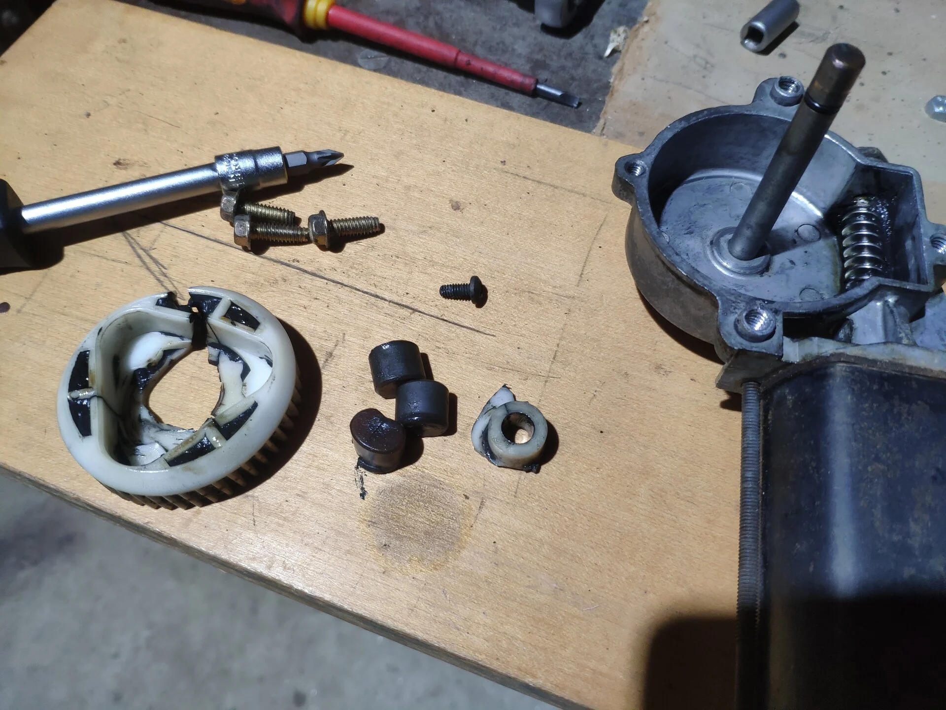

Then I removed drivers side rear quarter panel due to window not working. Suspected motor failure, but it is only gears. Modeling in process :-)

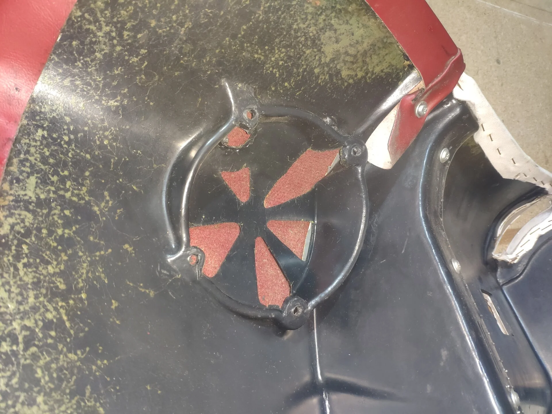

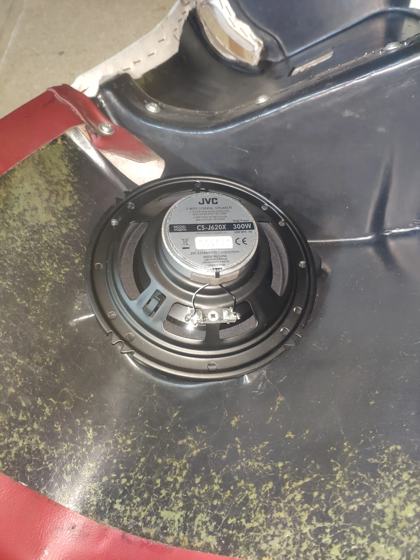

Rear speakers were not working and I was wondering why... Cause they are missing! Bought dirty cheap 6.5" JVC and they bolt in perfectly. You can see model on pictures, as some of You have PITA to mount speakers back there. I decided to mount cheap ones just to have them in, as I read here they make no sense back and under there...

@arnie93lx my system if "Premium radio" therefore it should have amplifier and 6 speakers (2xdash, 2xdoor, 2xear quarter panel) from factory. Due to age, wear and tear I decided to change all of them.
- In dash there were stock premium 3.5" so I used dremel to grind some 1/8" away and squeezed in 4" 2-way. They play perfectly.
- Doors had 5.25" (I think) and they accepted 6.5" with no modification except a little bit of liner adjustment in speaker opening (they come a bit more squeezed in low-front corner of the door panel)
- Rear quarter speakers were missing. Some say there were 6.5", some say 5"x7". No way there were 5x7 in my case. 6.5" fitted as they were always there.
To make all reversable, I left OEM connectors untouched, and used plastic clips to splice into wires and hijack speaker signal.
Regarding window gears... to my surprise after half a day of measuring and designing, I fixed it with first try. From "dead" motor, I found it was only shattered gear. Luckily I have some knowledge in 3D software and 3D printer available... link is below

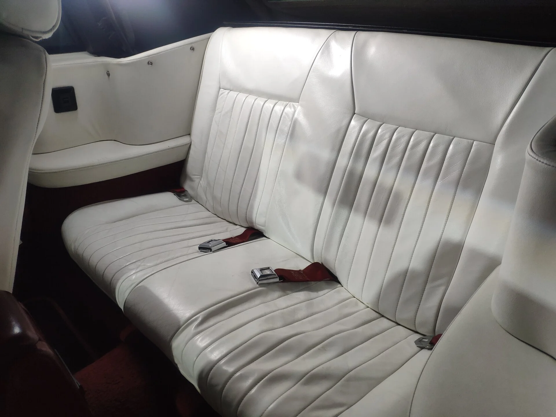

While waiting for new balancer... rear seats done.
Fixed electrical windows, mounted new speakers, added 3mm foam insolation of rear seat support and under seat, gave to leather some dressing. Looks good :-)

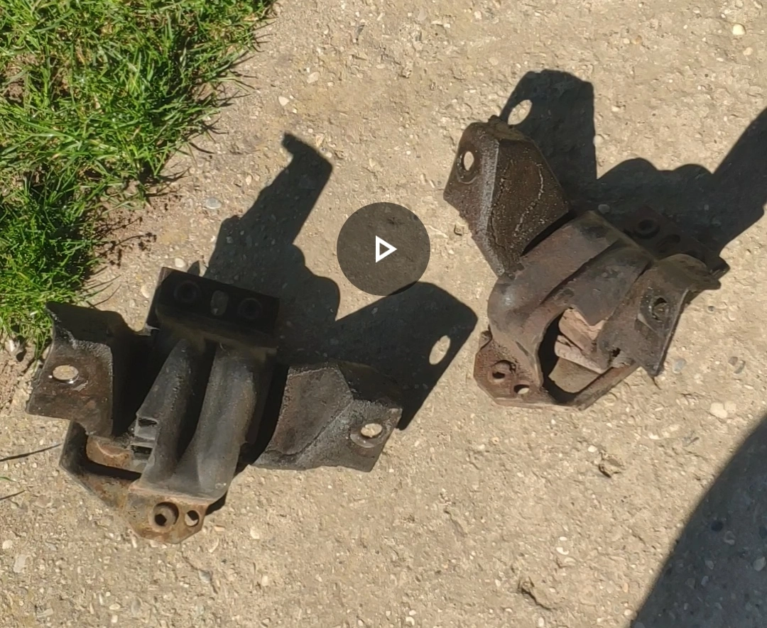

Time to change factory engine mounts from 1988:
Lifter front of the car on stands, some wood blocks under pan. Soaked nuts and bolts a bit.
Drunk a radler in one shot and so I did the nuts and bolts, both sides (in one shot) :-)
Trickiest bolt is PS back. I found a way without removing starter. There is a nice hole when You remove font right wheel, giving access to engine mount bolt and space for some 2-3 rachet clicks. A bit of wrentching, buy way faster than removing starter....
There we are, unbolted tranny mount, intake hose from filter and fan shroud to give it a free space and lifted the engine.
PS went out as piece of cake. New in easy.
DS... here I used master Yoda's patience... So when I lifted the engine it was lightly tilted to DS, that is why PS mount went out easy. Tightened PS Mount a bit just to tilt engine, gave a lift one more pump and I drove that mount out between K member and filter. New one in with a lot of wiggling and shaking engine.
Everything sat down in place after lowering engine.
Old mounts are shot. Rubber deteoriated, they ring in hand.

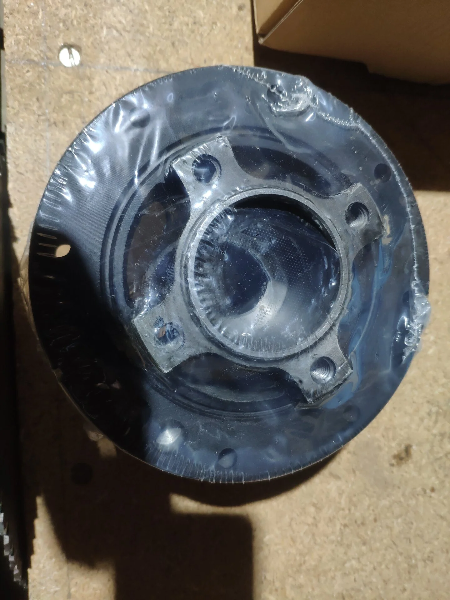

Balancer from Germany arrived, but bad news... :-(
Dorman 594-024 is HB which I received.
After install and firing up I got something new: knocking. Goes away as engine heats up.
Oil pressure and level okay.
On cold start knock is pronounced at idle. As You give throttle goes away, but as You release throttle comes in.
Lasts few minutes and only on cold engine start.
What I also saw is that second new balancer is WOBBLING! The first one (Autotecnica) was shaking engine 1100-1300rpm but was cold still. Just received Dorman is wobbles but engine is cold still plus I have knock on cold start.
Tried to start without belt, HB still wobbles. Checked crank to hb bolt with torque wrentch, it is over 90lbs (bolted with airgun). Pulley in front of balancer is perfectly still.
In between two faulty new balancerd I only changed engine and tranny mounts.
What to **** is happening now? I am lost :-(

Look at the balancer, is the outer ring wobbly or the whole thing wobbly?
Today I started it. Pulley still, outer ring wobbly, then I killed the engine a.s.a.p.:
I dont know if it is optical, but to me it seems like rear inner part of balancer (backside towards timing cover seal) is having a romantic lateral and vertical dance... :-(
We will take it down for third time next week. As I work in cutting tools industry I will borow 0.001 and 0.01mm runout gauges to check crank snout... Wish me luck... :-(

I agree with the horror story, does rock auto ship to Croatia? Is there a Ford dealer near you?
Yap. It was Rockauto who sent me first faulty Autotecnica HB, but I got refund for that one without hesistation.
Ford dealers in Croatia are actually "Ford Europe", as I concluded from my inquiries for some 'generic' parts and vehicle history they are like other company... They have no support or any clue about US cars. Mondeo and Focus are their mainstream.
The other, Dorman, I got from Germany. See pictures.
Actually now I own three 'faulty' balancers (OEM, Autotecnica and Dorman)... :-/
