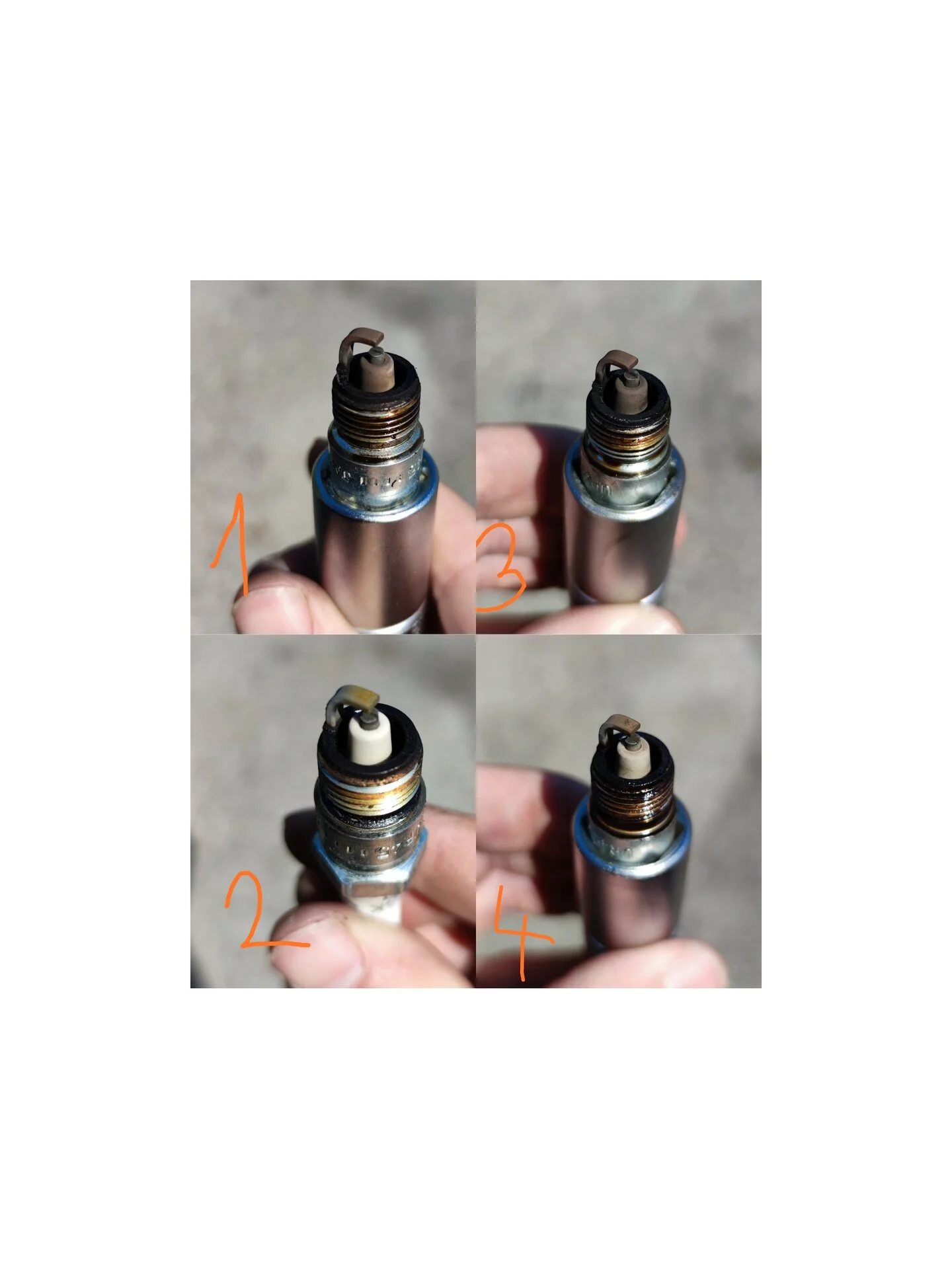

Althru it sounds close to rod knock, I unpluged spark plugs one by one and I heard no noticable change in knocking... stethoscope points to valvetrain cyl #3 (under throttle). I still did not manage to lift the car.

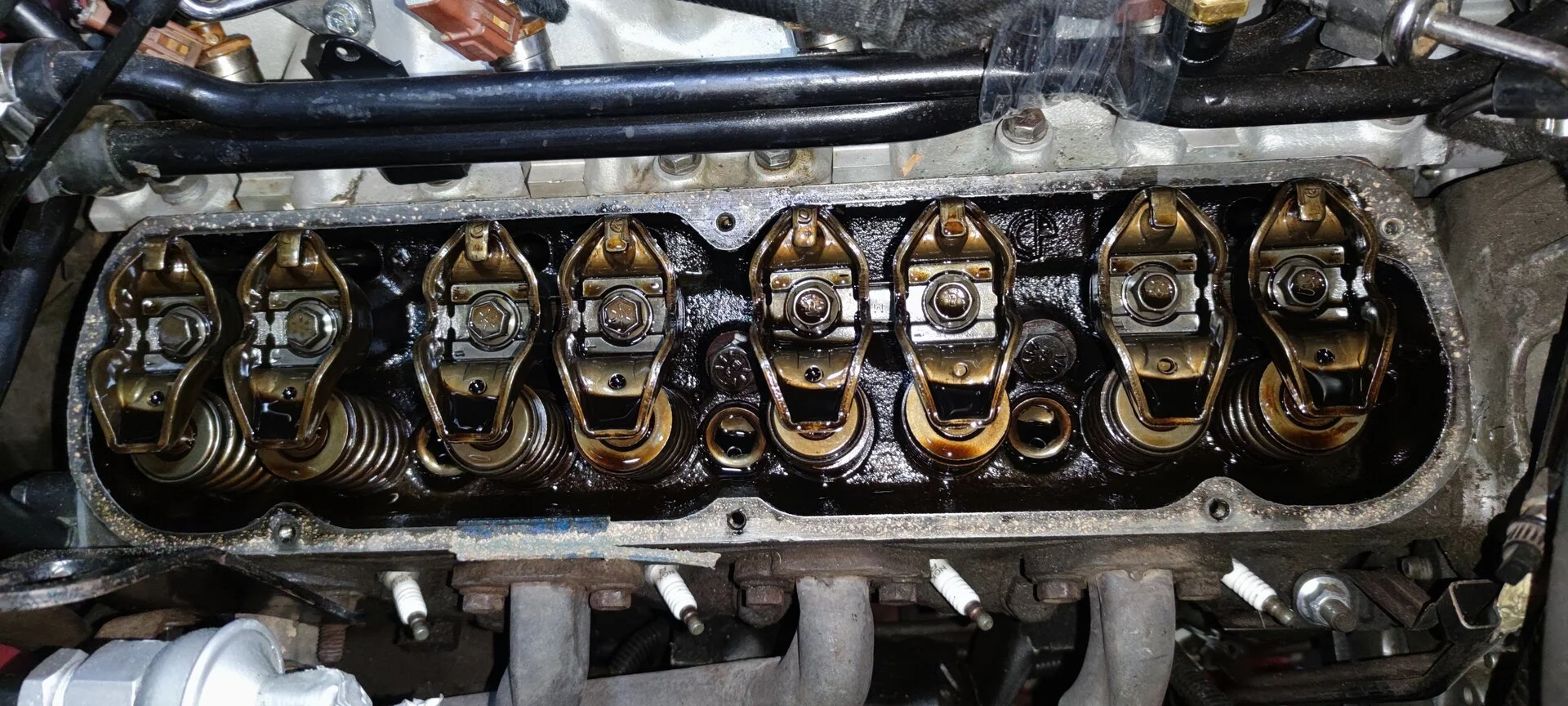

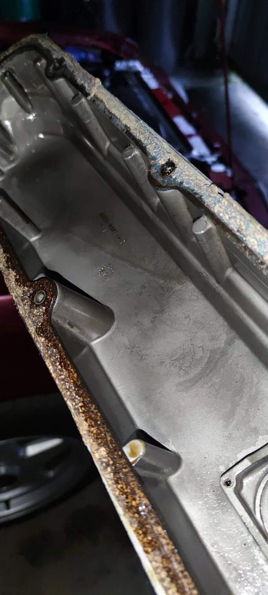

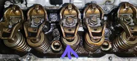

Huush, just opened DS valve cover this evening. It took me long time to take freshly installed cover. It was like welded :-(
No visible or loose parts...oil and/or seafoam cleaning well, valve train is cleaner than I did it on top end resealing this winter.

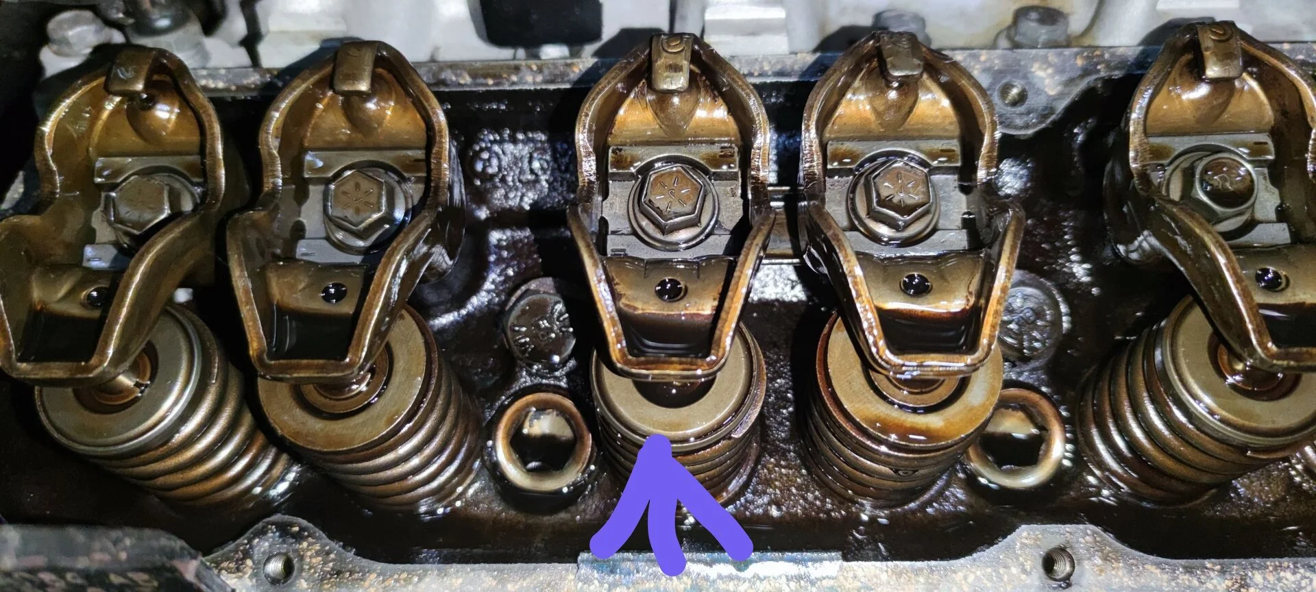

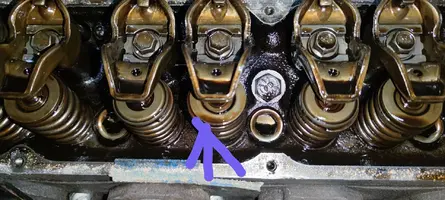

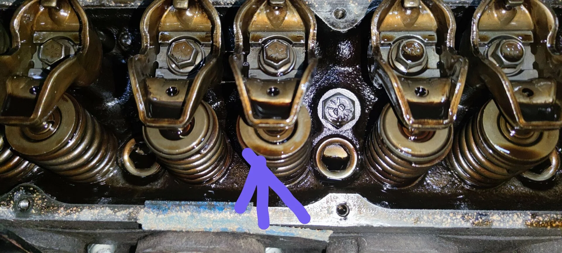

Only visible to naked eye are #3 rocker arms are not centered on valve tip.
I am not sure if this would cause a horrible knock sound? Would it? @General karthief ?
But just there... interesting...right under throttle and egr plate on valve cover my ears heard most clatter from stethoscope.
Quick test: There is no play left/right nor up/down. Lifters are rock hard.
Will re-check tomorrow play, pushrods, boroscope thru pushrod hole...

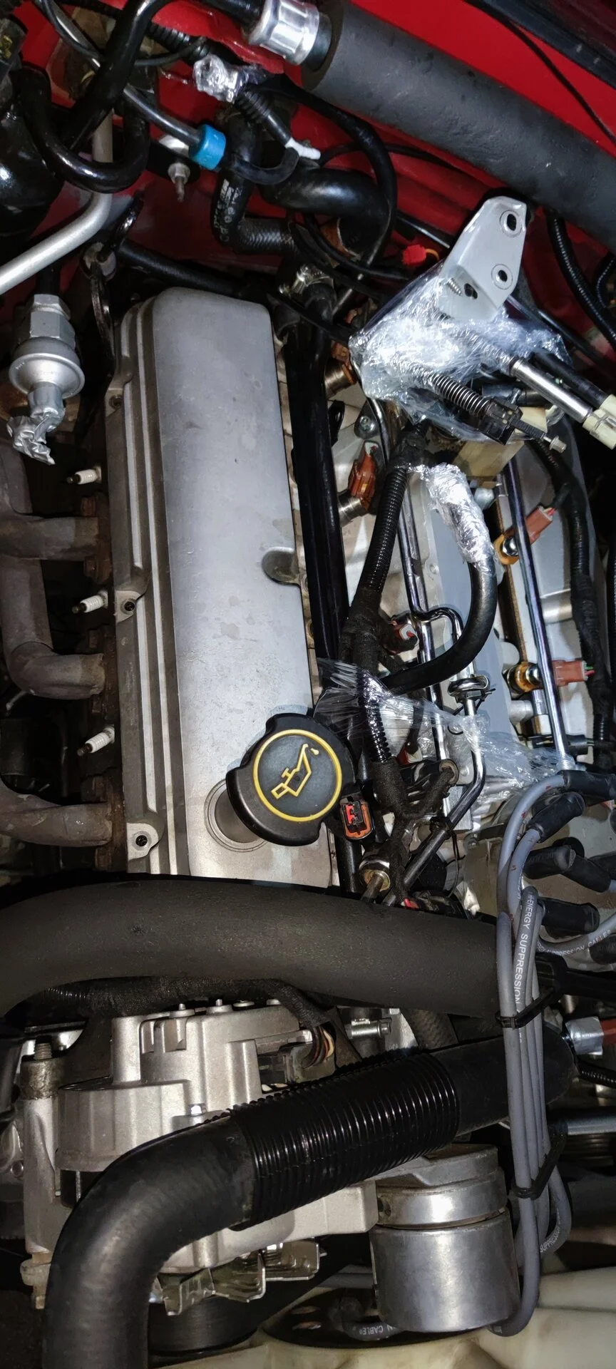

Today we started engine without valve covers after checking all rockers. For first few minutes engine worked flawlessly, and mechanic asked me why did I call him :-)
Then it started old habbit and knock in valvetrain rhythm. Oil flow is normal thru pushrods.
Cyl #3 and #8 rocker bolts transfer most ticks.
Mechanic told me lifters, but I should not take him for granted. So, like most probably.
Took a risk. Ordered new Melling pushrods, Elgrin set of rockers & bridges & rocker bolts and Ford racing 302H roller lifters.
Now help me god and wish me luck...If it's not valvetrain, stang will be parked and wait for winter....
I will give it a careful ride before parts arrive (in two weeks).

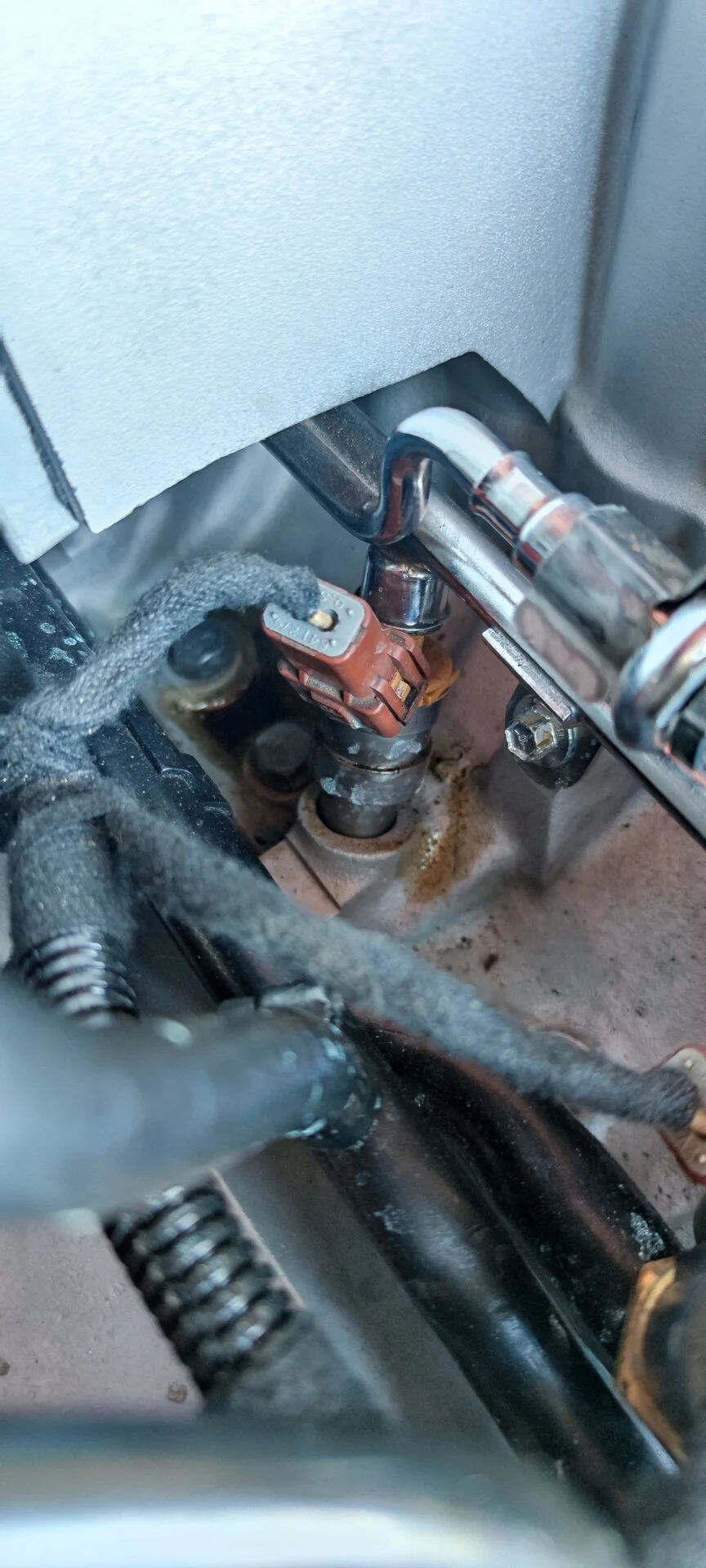

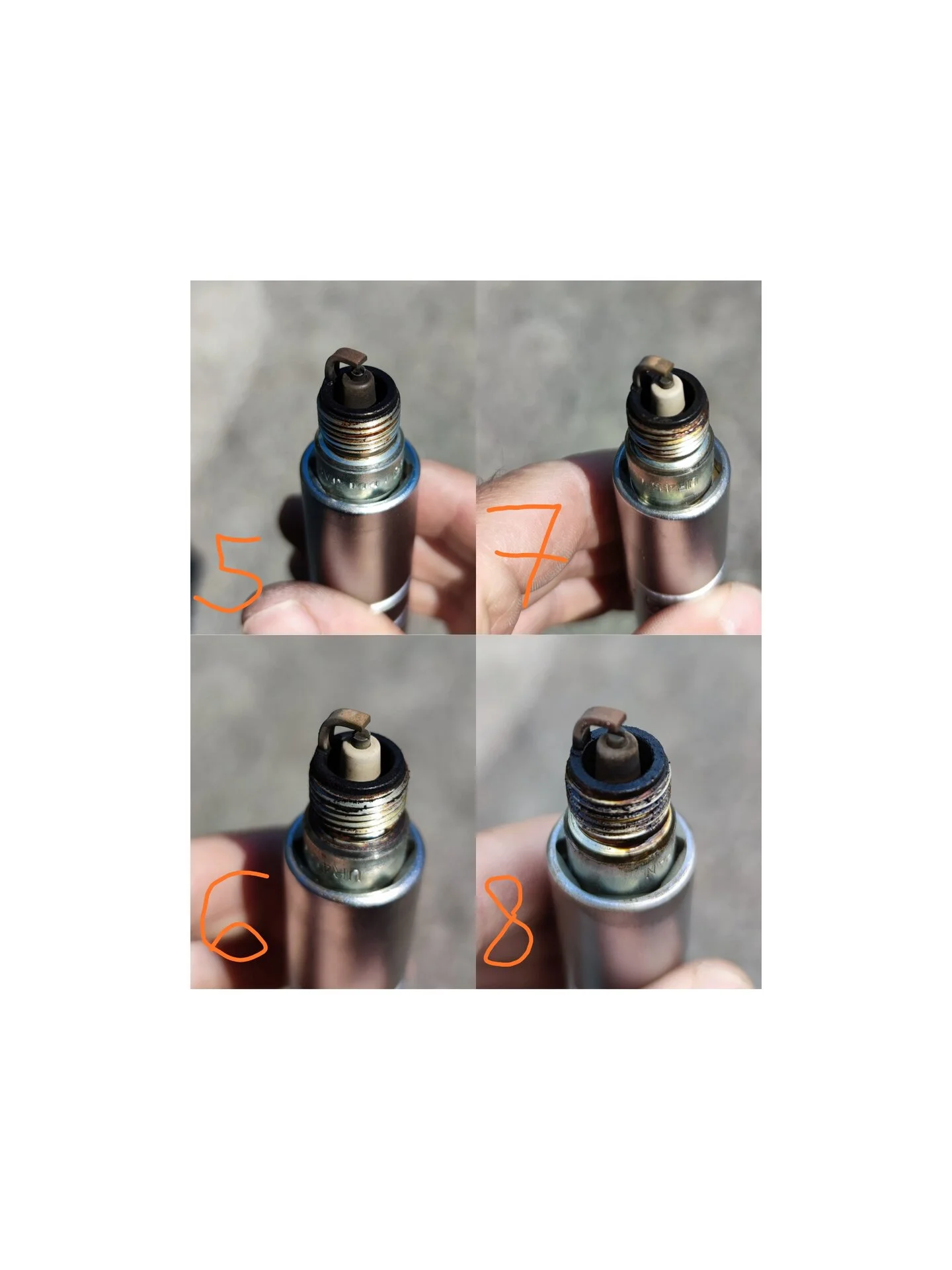

Pulled the plugs (should have done that earlier) and found traces of overfueling on #2.
This makes me think (maybe too much, You will tell me):
In winter I had gooood puff of white smoke on start which I auto-assigned to condensation (it was cold like hell) and it went out of my head.
Rewinding past, on first crank few days later after changing HB (plus engine and tranny mounts) I got this mysterious knock.
To add, there was no more noticable white smoke, but it was also a lot warmer.
On the other hand, I have a bit of fuel odor in oil cap and dipstick.
Only few days ago I saw small puddle around injector #2. On sunday I saw #2 spark plug with yellow-greenish tip suggesting flooding. #6 and #7 are also suspicious, but not so clearly like #2. See pictures attached.
Is it possible that I have leaky injector causing knocking?
Would a bloody leaky injector knock on idle and go away with RPM, car would run normally?
How can I proof/test this?
Possible or only my imagination?
Be aware I am not in USA, and I can't get another new/used EV1 19lbs injector in less than 2 weeks :-(
P.S. When I saw this puddle I disconnected #2 injector from harness, with no noticable change in knock. But if it is leaky and stuck open, it would make no change, right?
