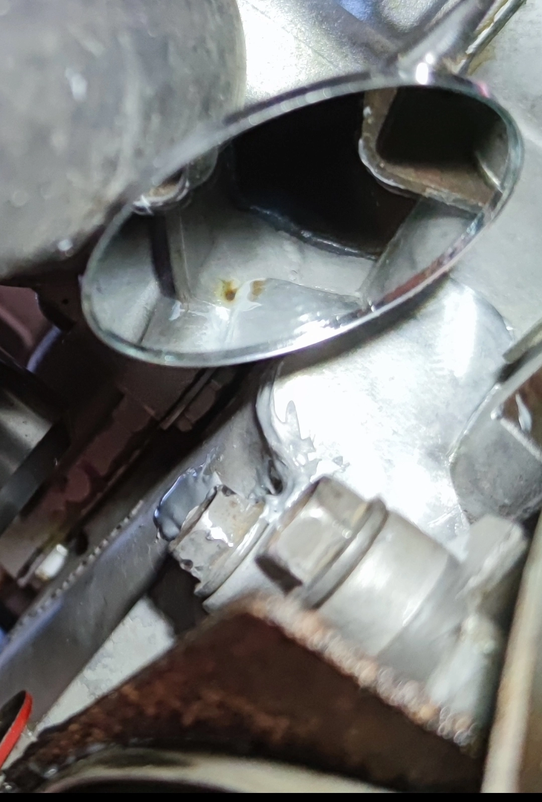

What I discovered latest this weekend by myself is #2 injector and #2 spark plug pointing to fuel leak which could (or not) be knock reason behind the scenes at the end. See my post before Your reply.

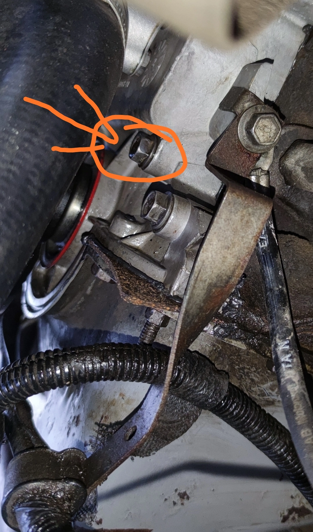

You could pull that bolt out, clean and use thread sealent, put it back, worth a try.

Will try to tighten first and then, if fails seal that bolt.
Check post #159. Oil smells a bit like fuel. I was sure it was #2 leaking inside (beside outside like pictured), but now it seems like it may be "moving around fuel rail".

Tightened timing cover bolt while I was there, but no go. Oil still dripping. Bolt is oiled after drive, oil is gathering at lower cover lip where oil pan meets cover and from there makes mess while dripping in drive....
We need to lift the car, clean all and wait for a oil drip to determine source 101% and take action. Bolt sealing or redo of timing cover, mechanic will decide...

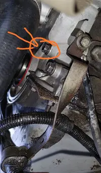

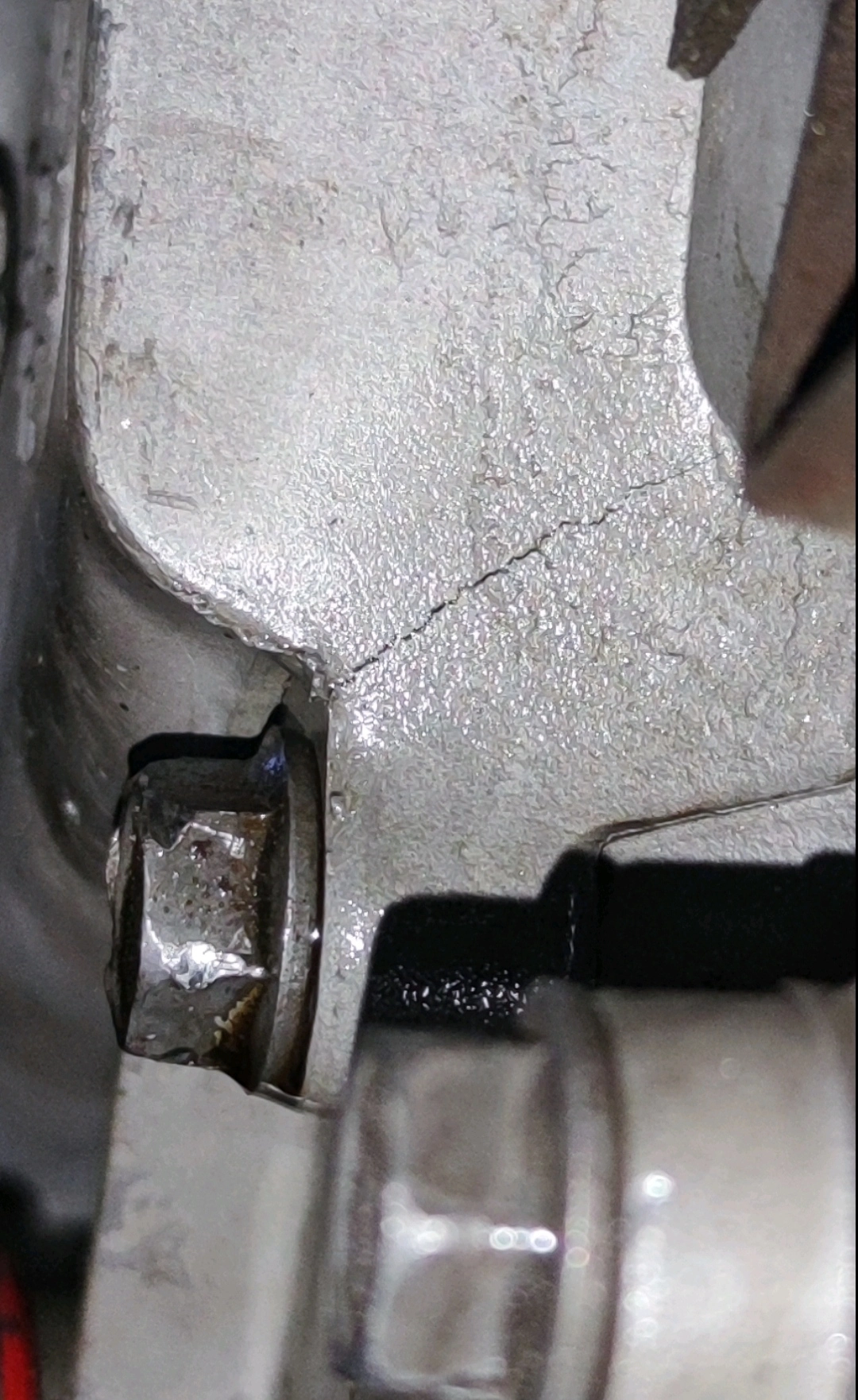

It is not bolt after all .... It is a timing cover crack :-(
(see attached picture)
Any use from aluminium welding rods here?
Epoxy (like JB weld), liquid metal, or anything to temporary fix leak at this point? I don't know load at this location (drivers side lower upper bolt to block).

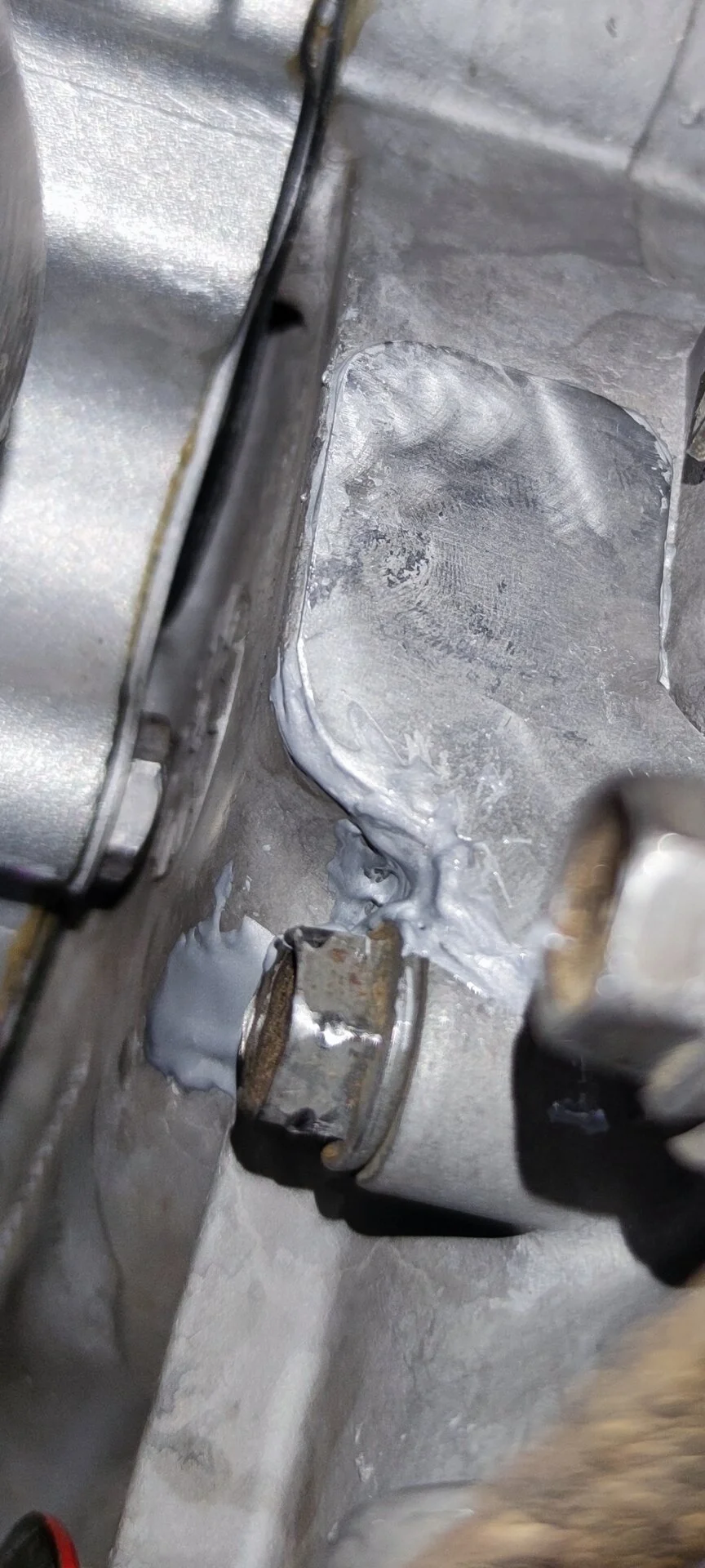

That is luck, I leak 12 days before car show... desperately trying to save the day :-(
No room for anything down there... even proper light... :-(
This may be sloppiest job I did on this car but I gave my best in tight space.
JB weld alternative in EU, up to 150° and ~19N/mm2 strenght. If I did it right, should hold for some time...
Clean, clean, clean and again clean...
Then roughed corner on timing cover and 0.02" aluminium sheet. Again clean, clean, clean. A good layer of liquid metal and pressed together.
Leftovers I pulled around to make "structural improvement" in corners around bolt. 24h is cure time, wish me luck....
If it will leak, last chance before taking cover out is gasket maker in bolt I suppose...

Okay, I managed to stop leak with 2-component liquid metal above around bolt :). For now!
BUT now I have a smaller leak further to outside driver side, a bare tip of DS timing cover where it meets oil pan (I suppose - I must clean area and remove cable bracket to gain access). Needs at least 20 mile trip to reveal itself.

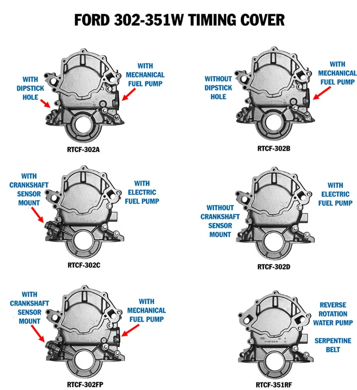

IT should be the same cover for 79-93.
Maybe not for Your sources, but for 302 motors, I can find dozen types of timing covers:
- with or without mechanical pump
- with or without crank sensor mount
- with or without dipstick hole
- normal or reverse water pump
I have Ford RF-R5AE-6059-FA on car right now. That is 100% sure.
If You look at rockauto, mustang '88 has following available covers:
- first one ATP has crank sensor mount,
- second Pioneer 500302M "could be" according to look,
- third Pioneer 500302E seems to me like it has mechanical pump flange,
- last Dorman also has crank sensor mount.
Edit: found picture on my mobile, attached

It is not a different place, but oil found a way behind "JB welded" aluminum sheet. It is crawling down slowly by timing cover side and seems like gasket leak... See picture of leak source.
Liquid metal a.k.a. JB weld, step 2 tomorrow...

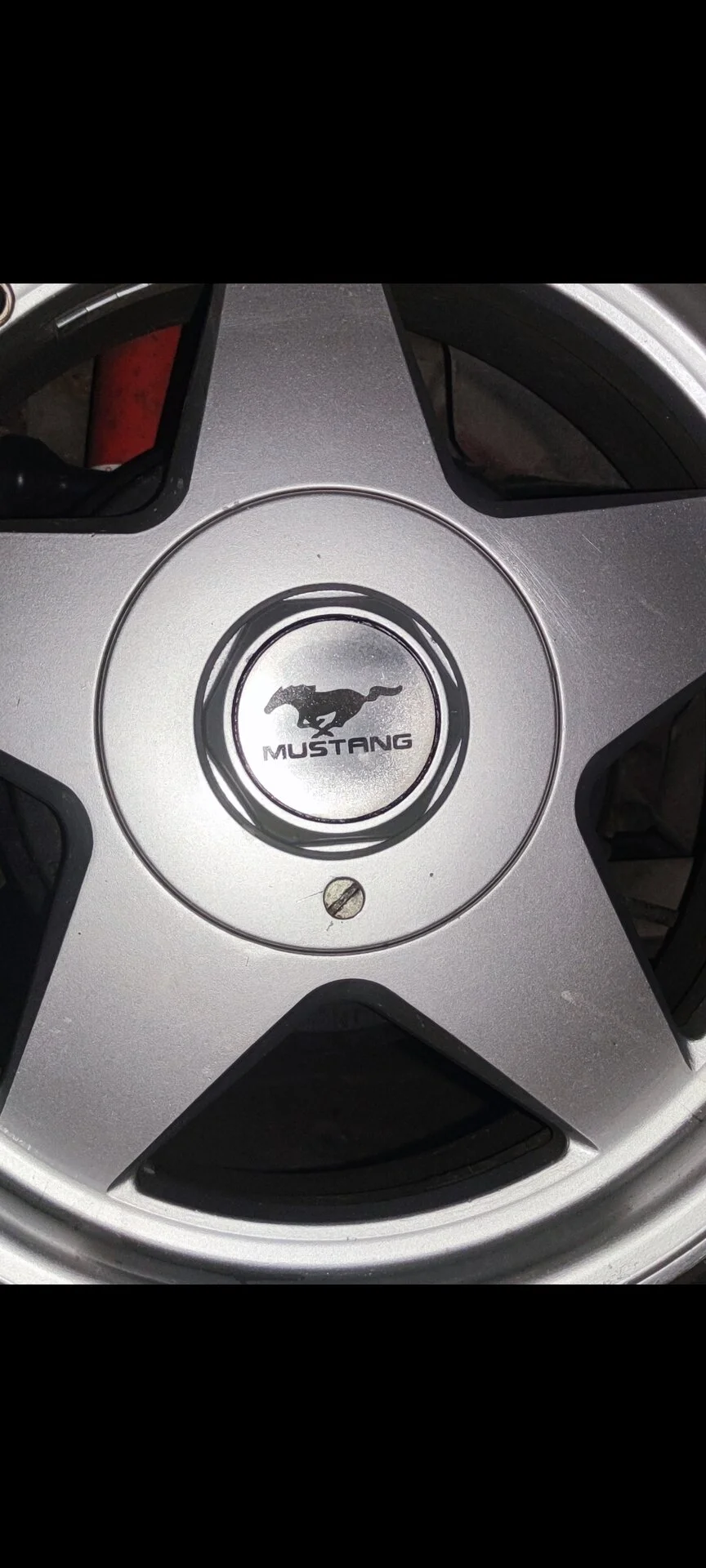

Made some nice inox wheel center caps in between. Laser marked and polished, with protective coat of clear paint as finish.
