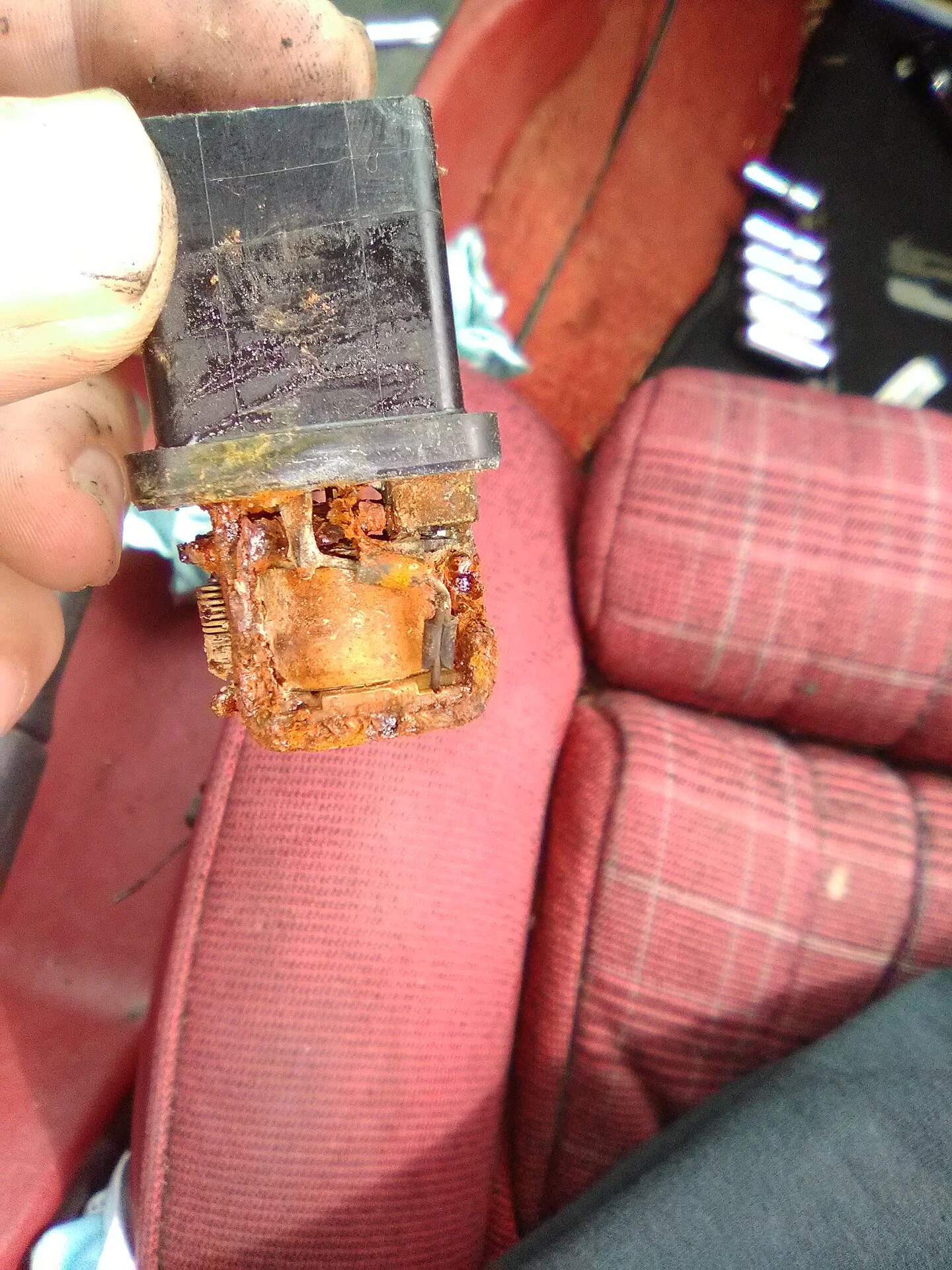

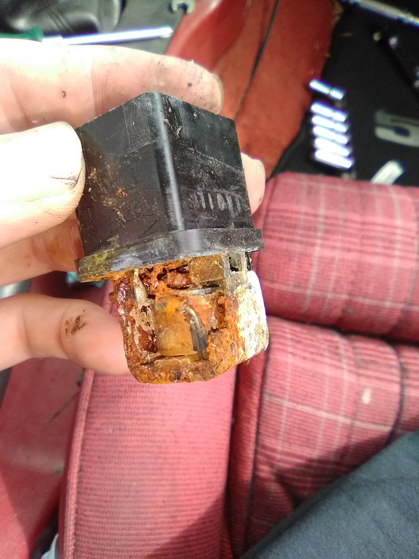

^^^ Fixed that issue. PCM relay. Rusted into 20 pieces. Lol. What? Thats too crazy when i saw that. That had to be a fire hazard.

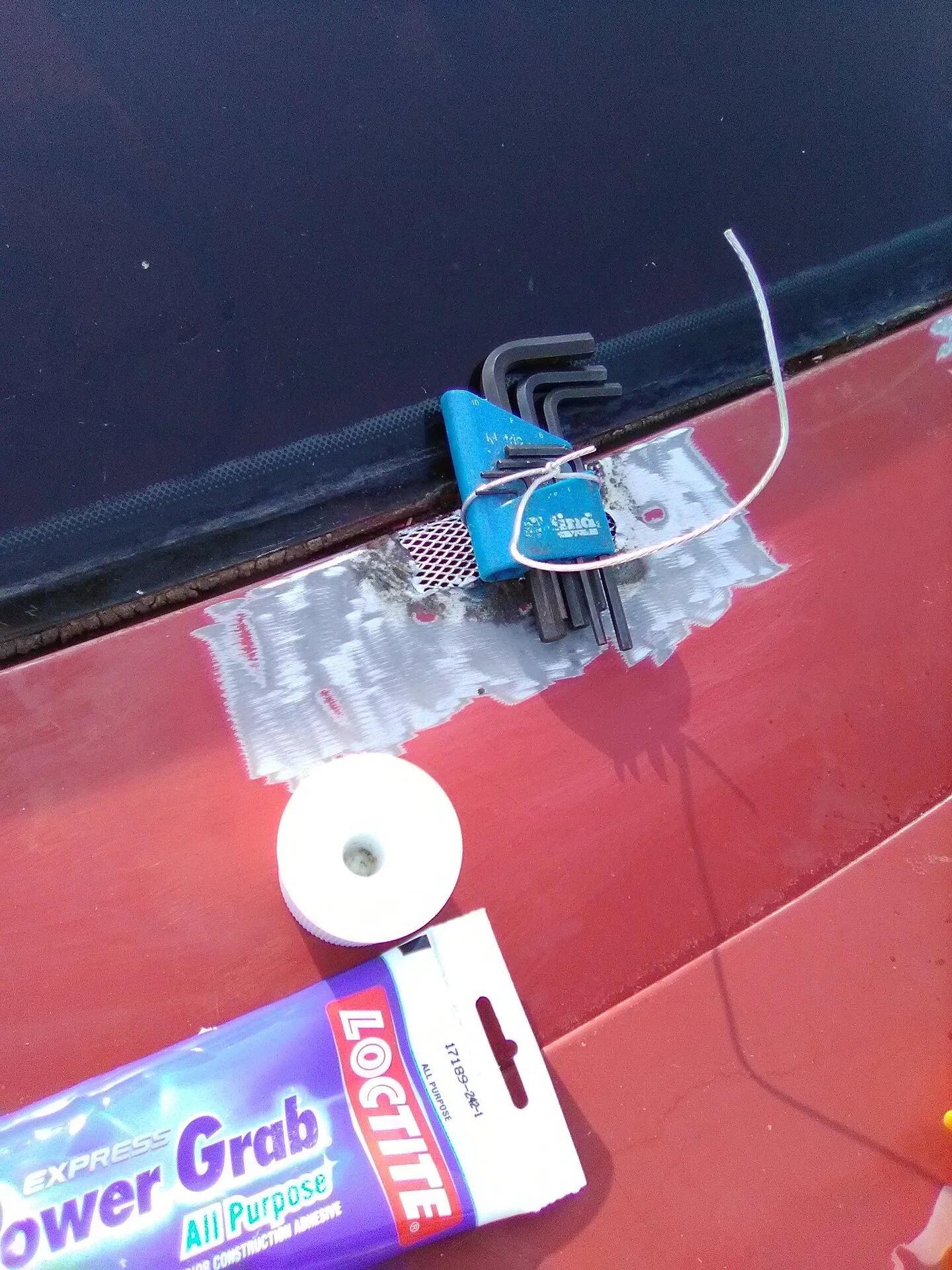

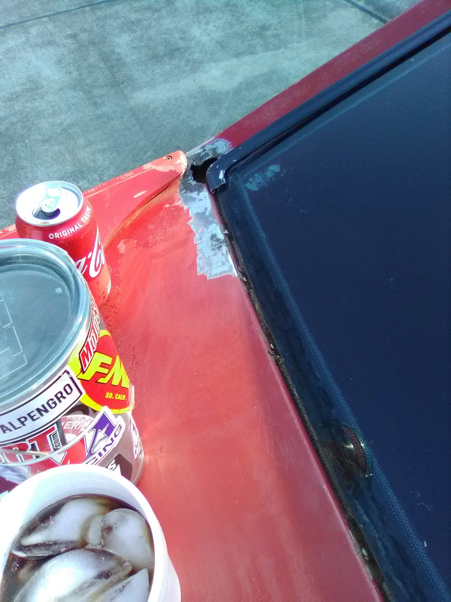

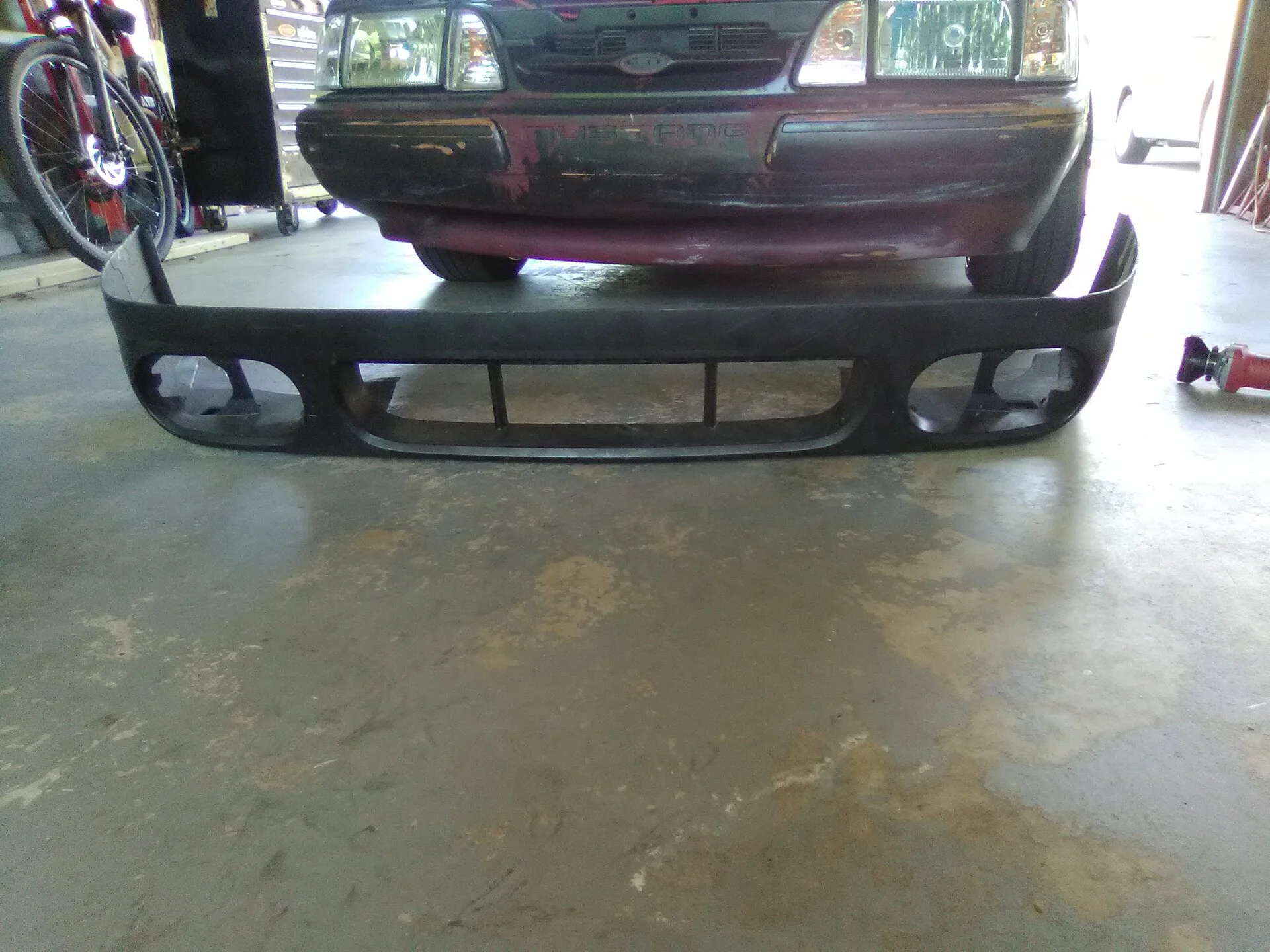

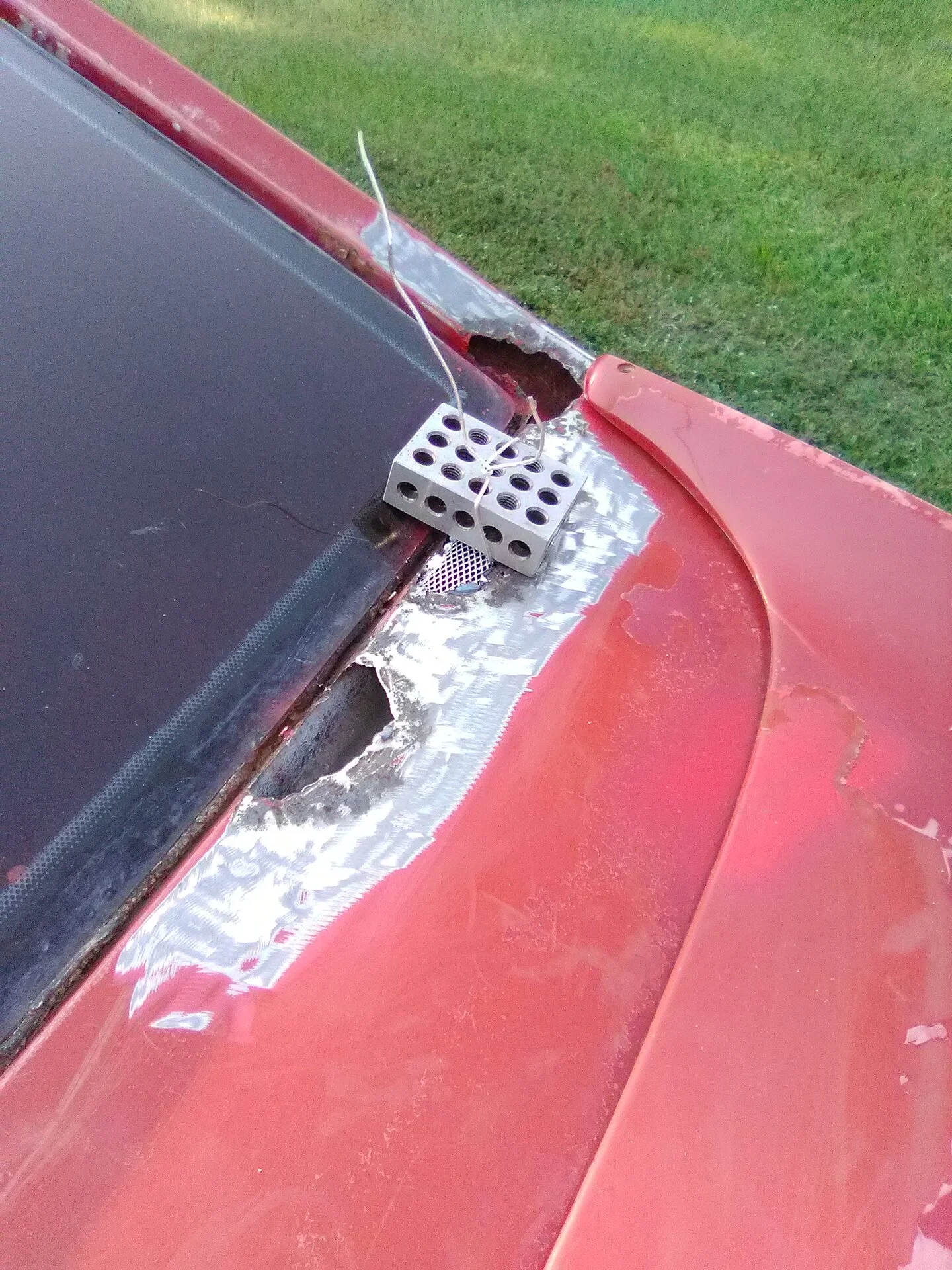

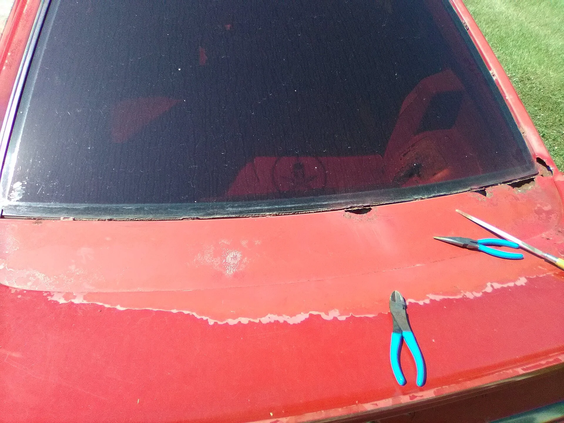

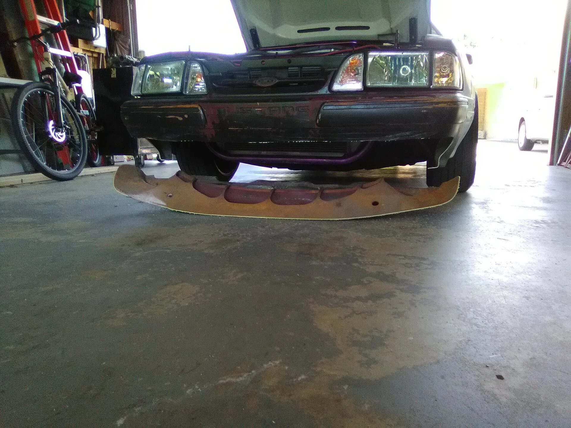

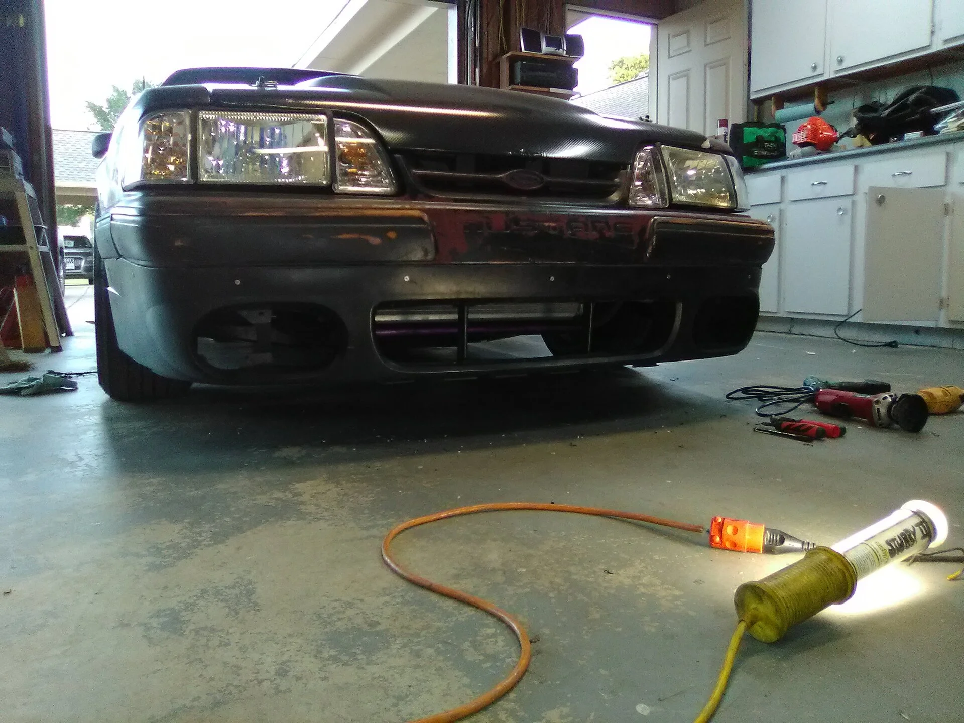

Mod of the day:. Got this 03 cobra bumper on. Its crazy how good it lined up at the fender well. Just by chance. Ill get those pics tomas.

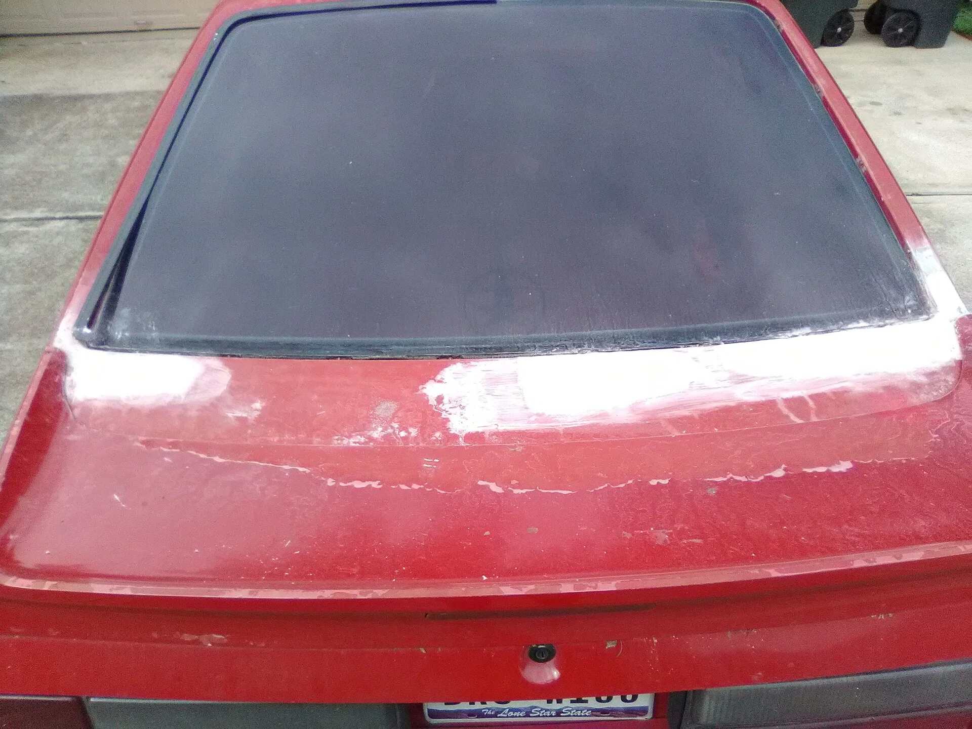

Patches my hatch this week also i had bought a good hatch, and realized the connectors were different so didnt screw with it. Just gonna take the window trim and give it back to the guy i bought it from.
Cut out most all the rust. More pics of this finished tomorrow.

Foxslider said:
Why you say?
Looking forward to doing the wrap soon and getting it 1 fresh color. Just gotta cough up the dough first. Lol.
Just found a saleen rear bumper cover local for $80, gonna have to go buy that and get it on.
A member here swapped a cobra bumper on a mustsng, don't have time to look, someone will kick it up.

What hatch did you buy that isn't going to be a bolt on plug and play affair?

That someone was me...lol.
My front bumper and car color are identical...only I bonded mine on instead of the riveted look. That's what forums are for. I likes it a lots.

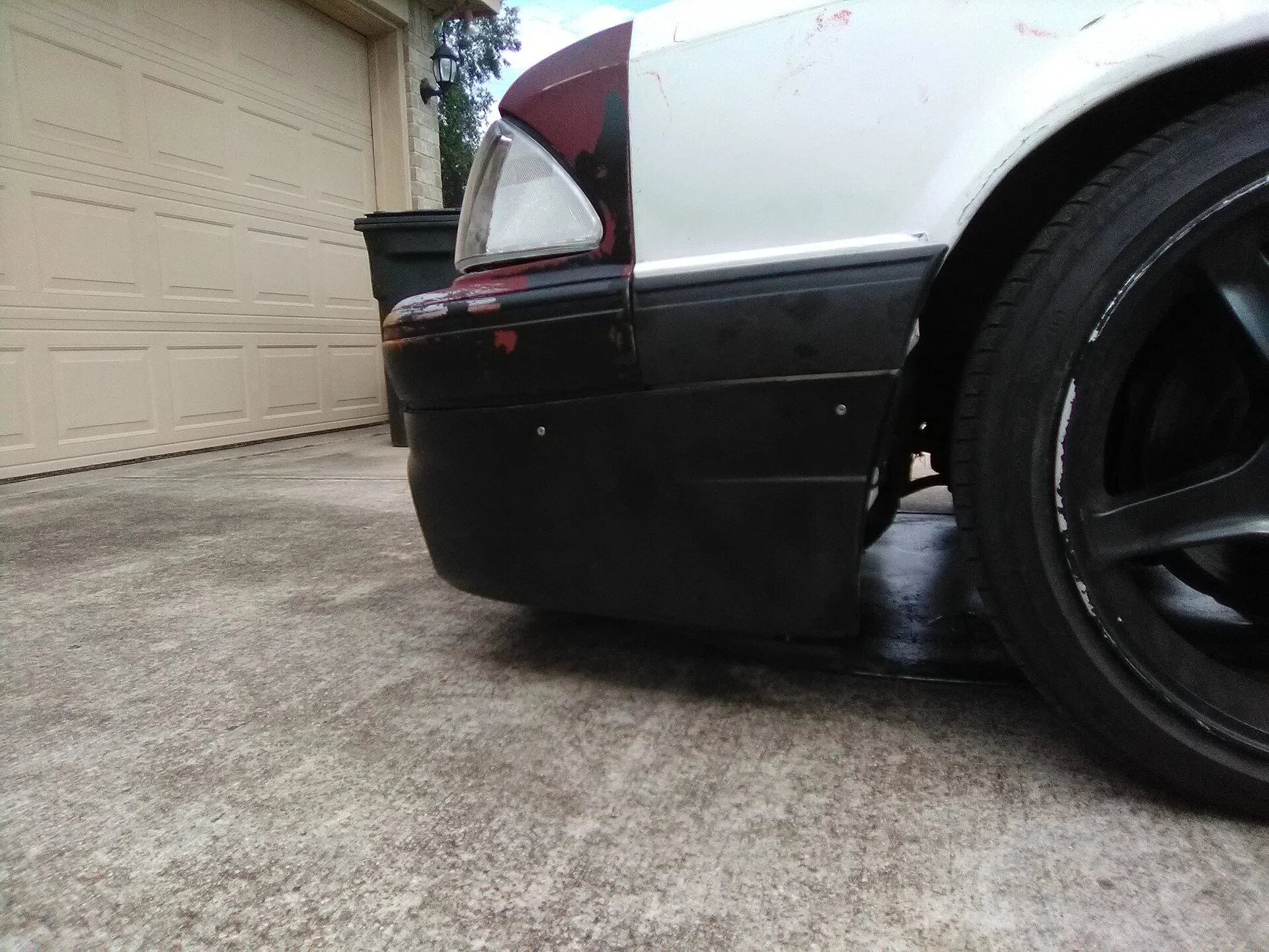

I saw it. I was thinking it was you. Looks good. Ya im super stoked on the look too. I countersunk the holes i drilled and since the bumper was pretty thick and avoided the washers. So got the bolts flush. Ima wrap over em. I saw some ppl make a bracket for the fender well part, but mine really firmed up once i got the bolts into the metal part of the fender. Its good as is.

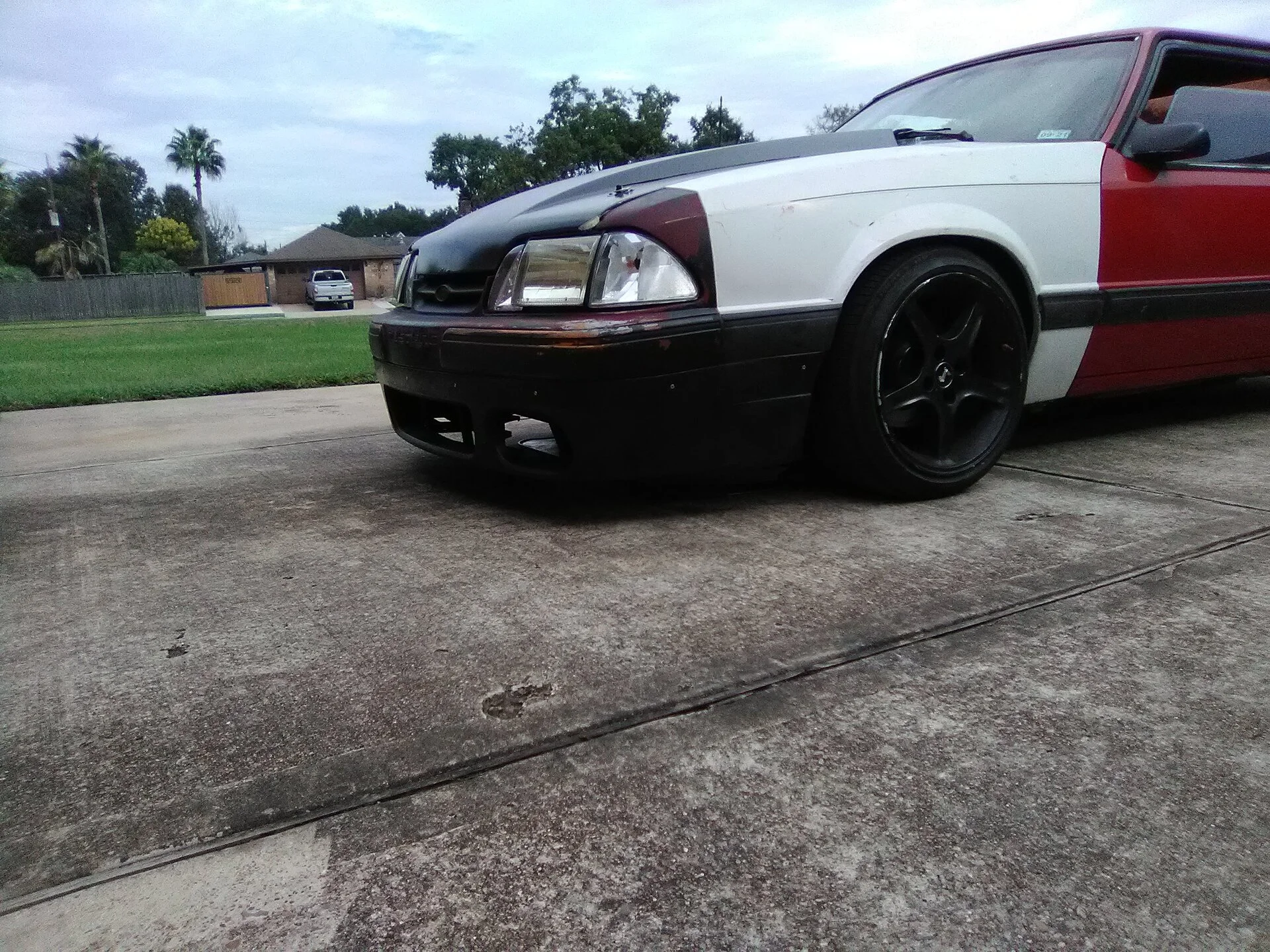

Few more pics:
Bout to put on couple pieces of molding then finish sand and prime the hatch. Got more "cool" (to me) stuff coming. Carbon hydro dipping a few things. Already failed twice on the cowl cover. I think my activator was old/bad. Cheap film, bad water temp.

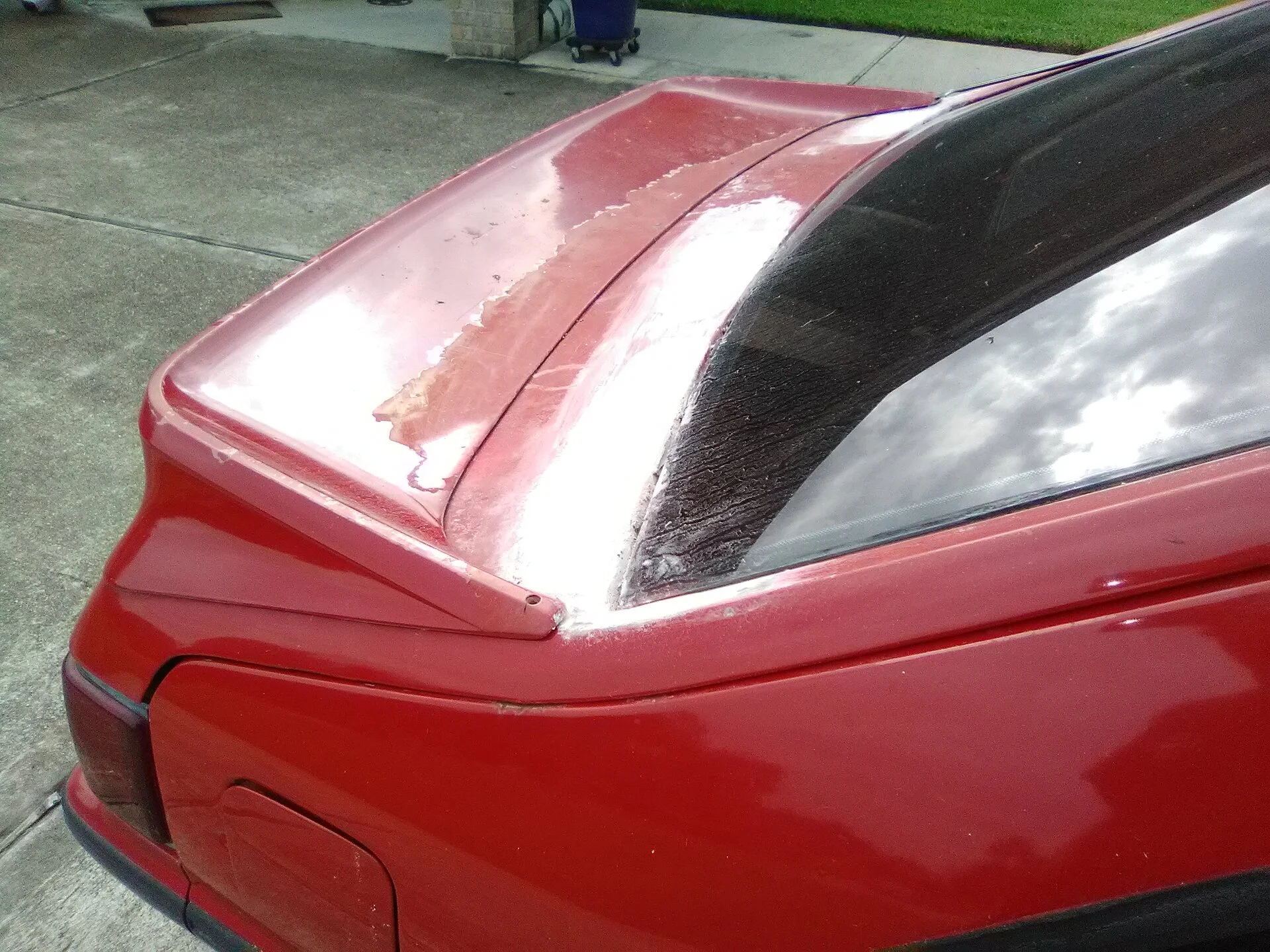

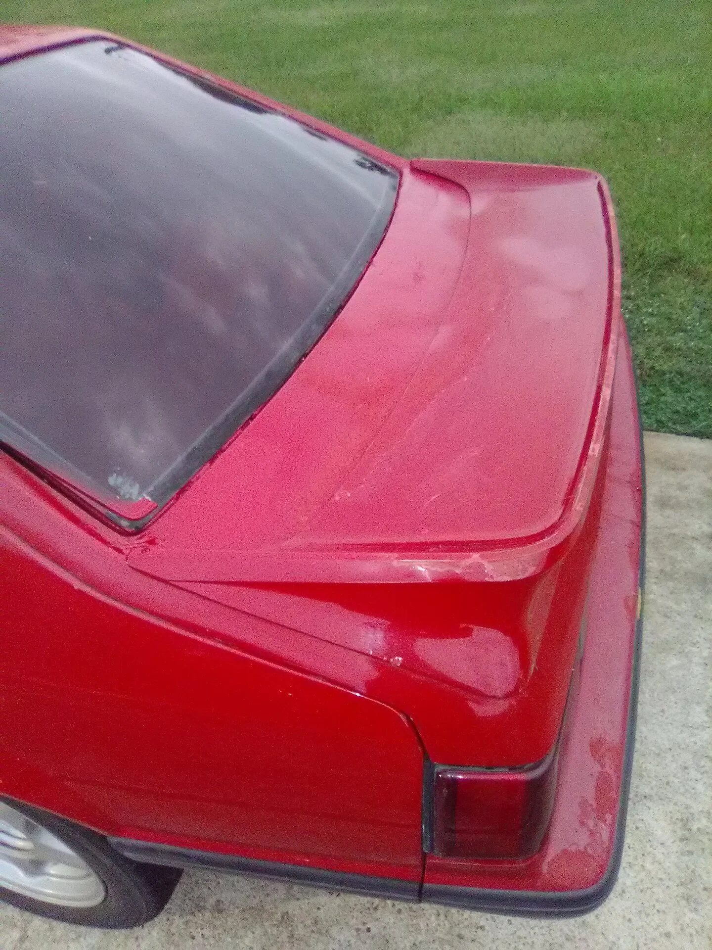

Hatch primed up. Gotta fix a rust spot on door, by window molding trim thing, then ill order some teckwrap (only clue im giving lol)
Dont know what that is in the pic, btm left side by wing/window corner but its good and smooth there. Better than pic.
Ok, maybe its a small divot/imperfection, and it looks terrible in the pic. Lol. Shows up more than i thought.
