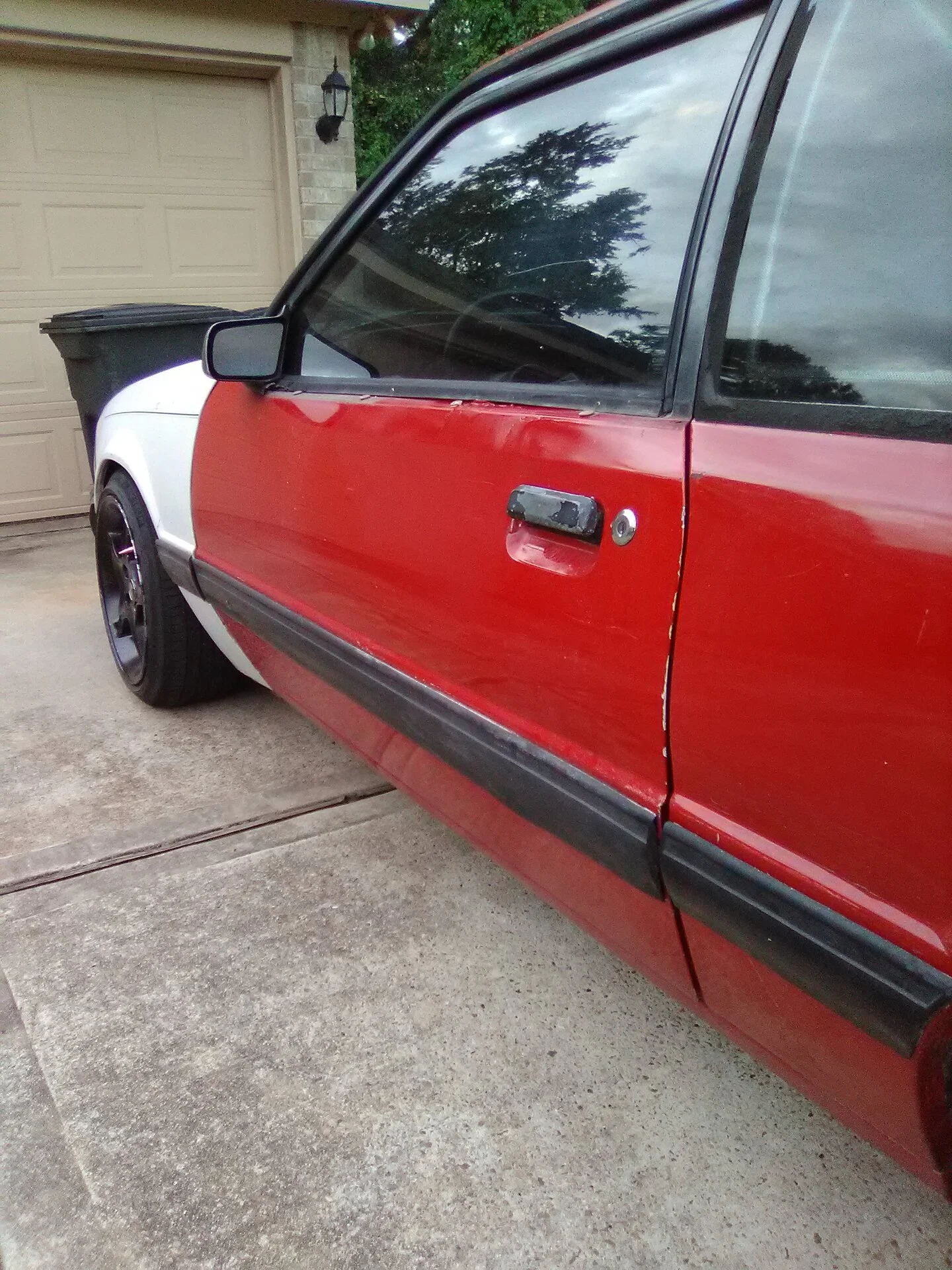

Was a little rust hole here, (top mid door) but forgot to take before pics. So you only get finito. Lol. The primer/paint might be 3-4 shades off. But still damn close!
Ya, i'll sand the end of the door and get it squared away some.

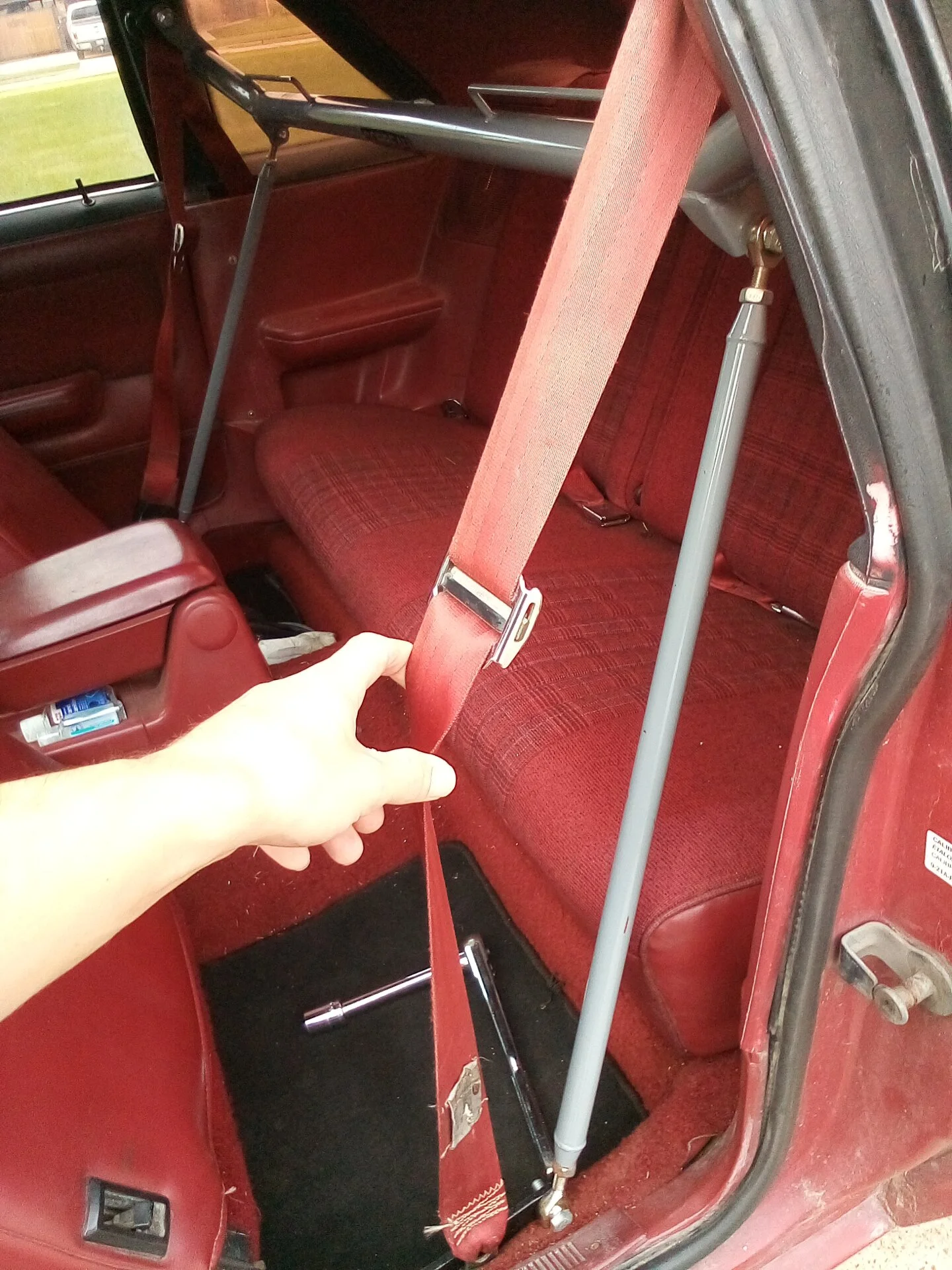

Mod of day:. Corbeau harness bar. Which was an inch short on each side. Not happy with fitment. Made it work, just had to get longer bolts and an assortment of washers/spacers for the top. And open up holes top and bottom a few thou.
Did pick it up for $120 though so that was nice. Just 1.5 hr drive. But talked to the guy for a good while.. had a nasty 8.2 deck dart block 363 fox. 150 shot. AFR 205's. G force T5. Didnt get a ride in it tho dangit!

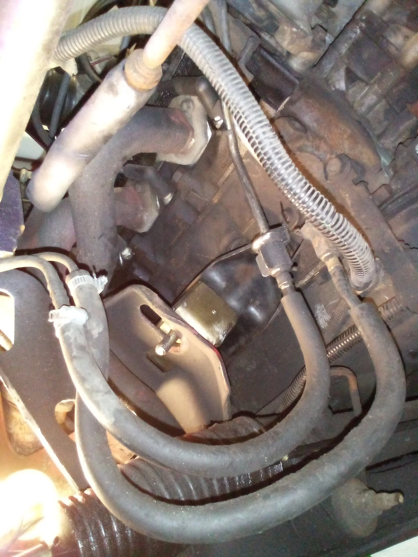

Mod of day: solid motor mounts. Mustered up the motivation to give it a shot. It worked out ok. New motor mounts a bit higher cause clearance problem with rotor cap/strut brace. How did i get it on? Crow bar against manifold strut brace thanks for asking. Lol. I had to take cap off to get clearance jacking motor up for pass. Side. But i let it down before tightening of course, gotback to itlast and was like :poo:.

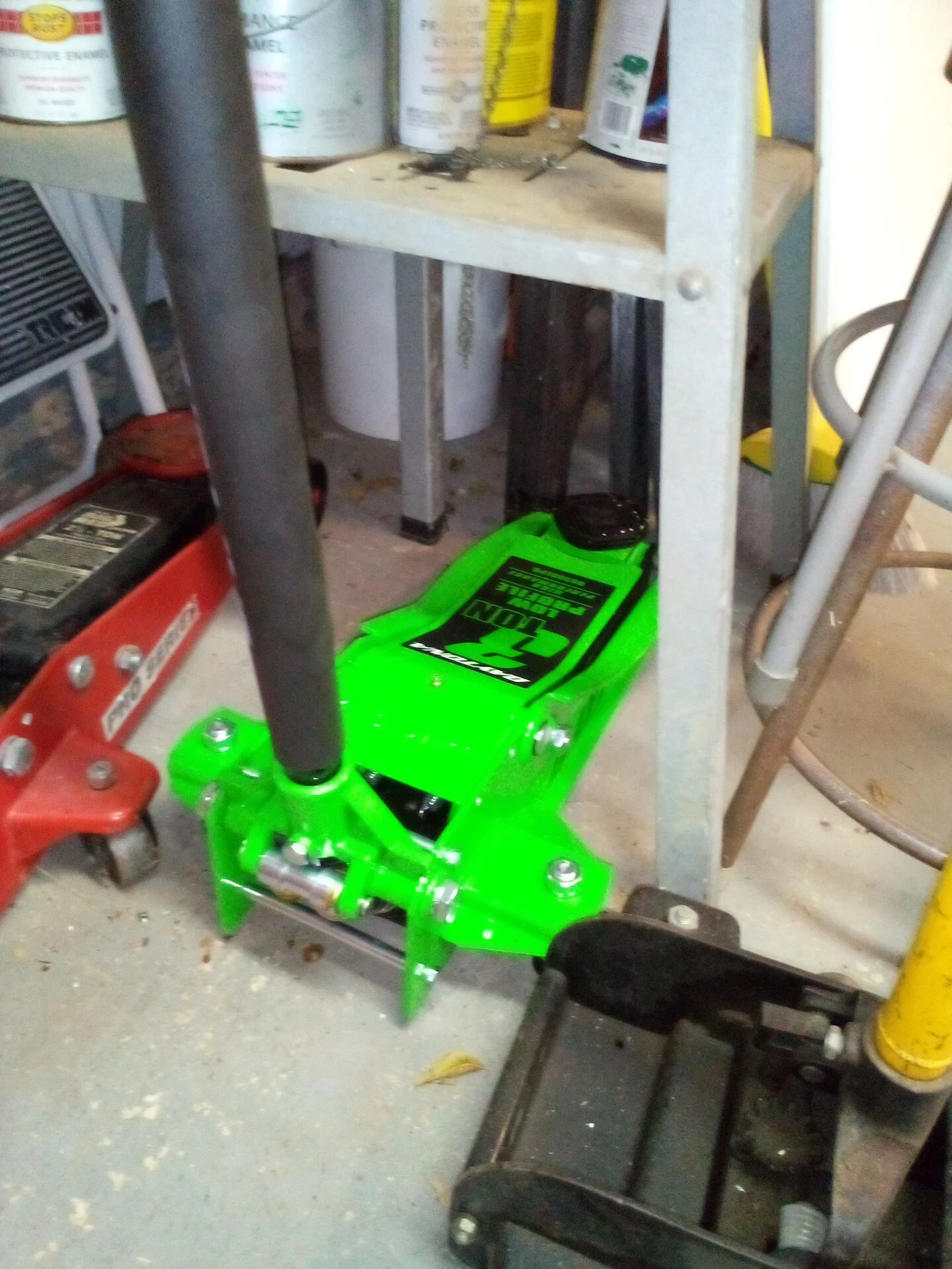

But before that, my jack decided it didnt want to go down. So had to go buy a new jack. (Was alrdy an issue a new jack has been needed)
Picked up the motor mounts for $20 a while back.
Drive test: do notice some new vibrations at idle and shutoff. Not bad at all.
HUGE difference in feel. No :poo:. Feels pure and solid, no lunging, immediate power transfer. Its awesome.
