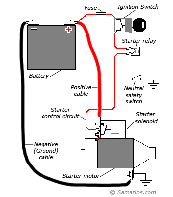

Here’s a good pic of the circuit.
The key pulls power from the battery that tells the relay to go down to the starter solenoid, which pulls in the “big power” from the big cables to crank the starter and start the engine. But electric is a circuit so it’s got to get back to the battery (through the big ground) so it can do it all over again!!
I think it gets solved between doing all those solutions. We'll see.
Bingo, think of it this way, look what the factory did, they have engineers that know all about current and what size/type cables and where they go, and why they go there, you just need to figure in the length to cable size/type because your battery is in the back. Ever notice the factory don't use aluminum cables? And they don't stack grounds, with the exception of the computer ground, negative battery wire to inner fender panel then another wire from there to ground going into the wire harness with the cylindrical connector.
Preciate it. But my neg. Batt doesnt go to starter how it appears directly. The starter is fed by the other cable coming off the starter relay.... That looks like a hi torque setup if i had to guess.
Does still show the path or circuit needs to be complete to work properly though. Which based on my understanding my circuit is not complete. B/c no starter ground or no ground from engine to firewall/strut. My ground is batt to frame to engine block. I need engine block back to frame. Im thinking. Which is dangerous in of itself.

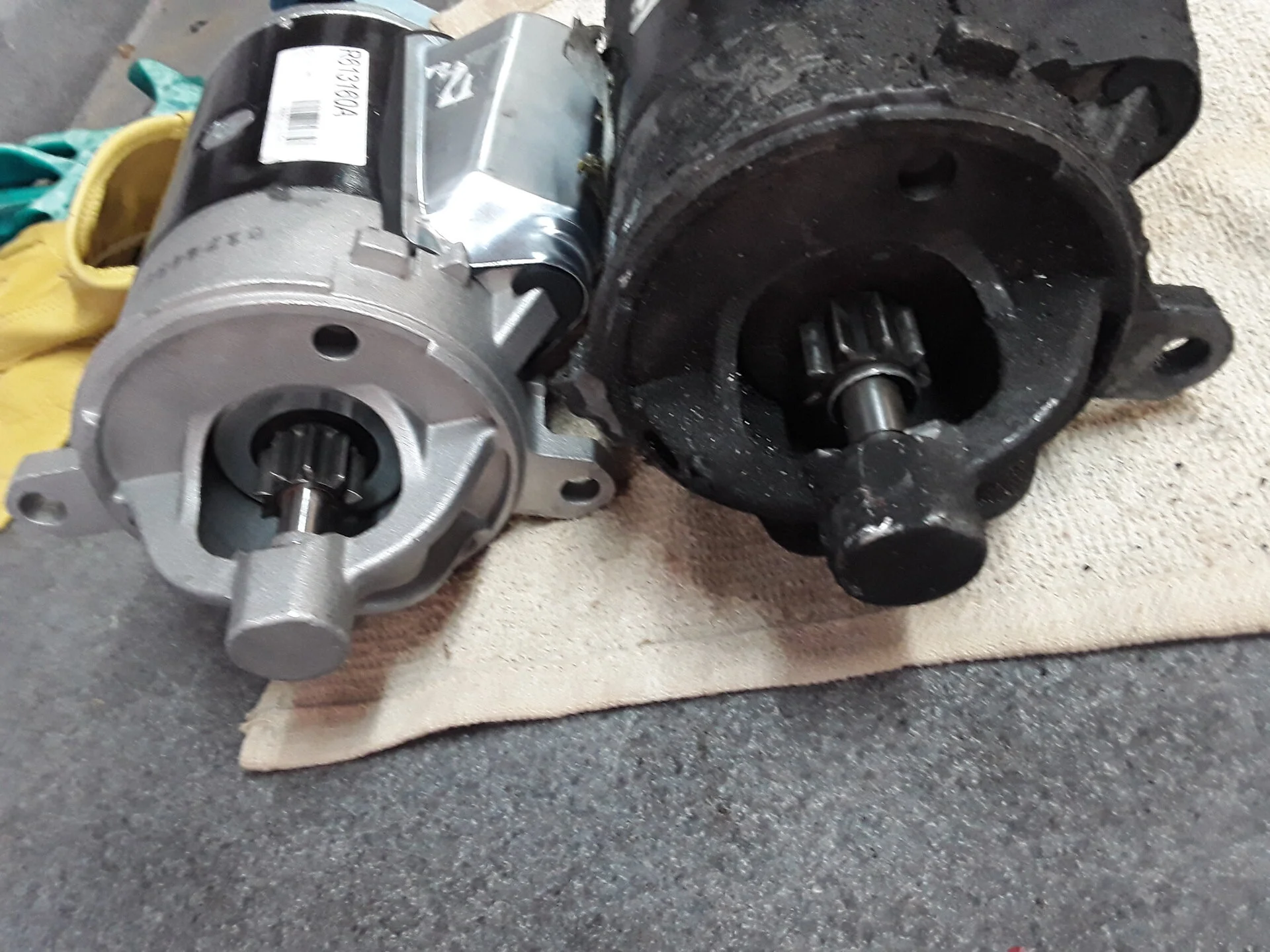

Put a new starter in. It starts faster. But the hot start issue still persists, apparently. Also ran the computer ground to the battery. Just cuz that needed to be done.
Also had my old 3k rpm cut out problem arise again. The new fuel pump did fix that for the last 6 months.
The ear was broke on my old starter, and the internal ms didnt look much better. Gear teeth were fine though.
Was all excited b/c rain came and thought i was going to get to drift. But failed when the 3k cut out arose. Smh. Lol.
So i got it up to temp. Drove around 20 minutes. Came back, tested starting hot. Worked fine.
Went to gas station, let it sit for 5 minutes, then just bearly turned over.. and had to stop before it blows the stupid fuse that someone thought was a good idea to put on the pos+ battery cable. More over engineering from some unqualified source im sure.
I think your problems stem from a :poo:-azz Chinese starter. Why do I think this? Because I went through the same damned things. Wouldn't turn over when it was hot. Headers, right?
Reactions: Foxslider
Ya, Bbk shortys. I just got a new starter. But it didnt do it before my wreck/battery swap to back. Ill admit, i should have gone hi torque. But the lifetime warranty on the ultima at oriellys had me sold. And i quickly regretted it, when it didnt solve the issue. (Starts better though for sure, cold) Though by chance, a new starter was needed anyway.
