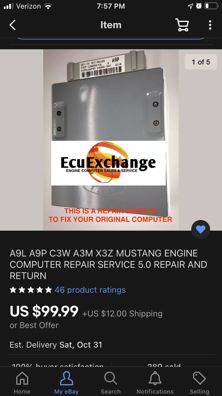

In case no one else has told you about them, the ECU Exchange on eBay is a great way to get that A9L running if you are stumped. They took a schizophrenic computer, straightened it out, tested it, and returned it to me before an in-state yard could ship one they had on hand when I needed one.

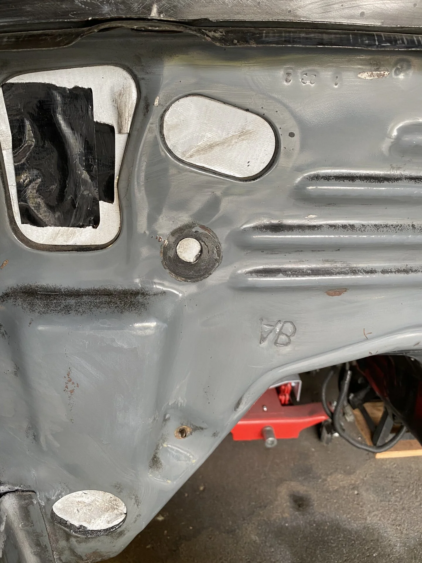

If this car was color changed they did a really good job as its white everywhere, with no other colors under it but the stock blue primer. I do think it has been repainted. From the pedal wear I have no doubt its an 84 K car.
Hate to say it man but that car was repainted.. why would their be blue primer? My 91 GT is a two owner car and has paint matched engine bay as you can see.
I agree. Even if the E-coating was showing through, there still would be body matched paint present in most of the bay.
My engine bay was poorly painted by ford. Below the pinch weld was mostly just gray e-coat, but the vast majority of the engine bay was in fact painted black...just poorly.
The underside of the car was not painted. Mine was just the same gray e-coat. Later on, I did por-15 on top of that.
