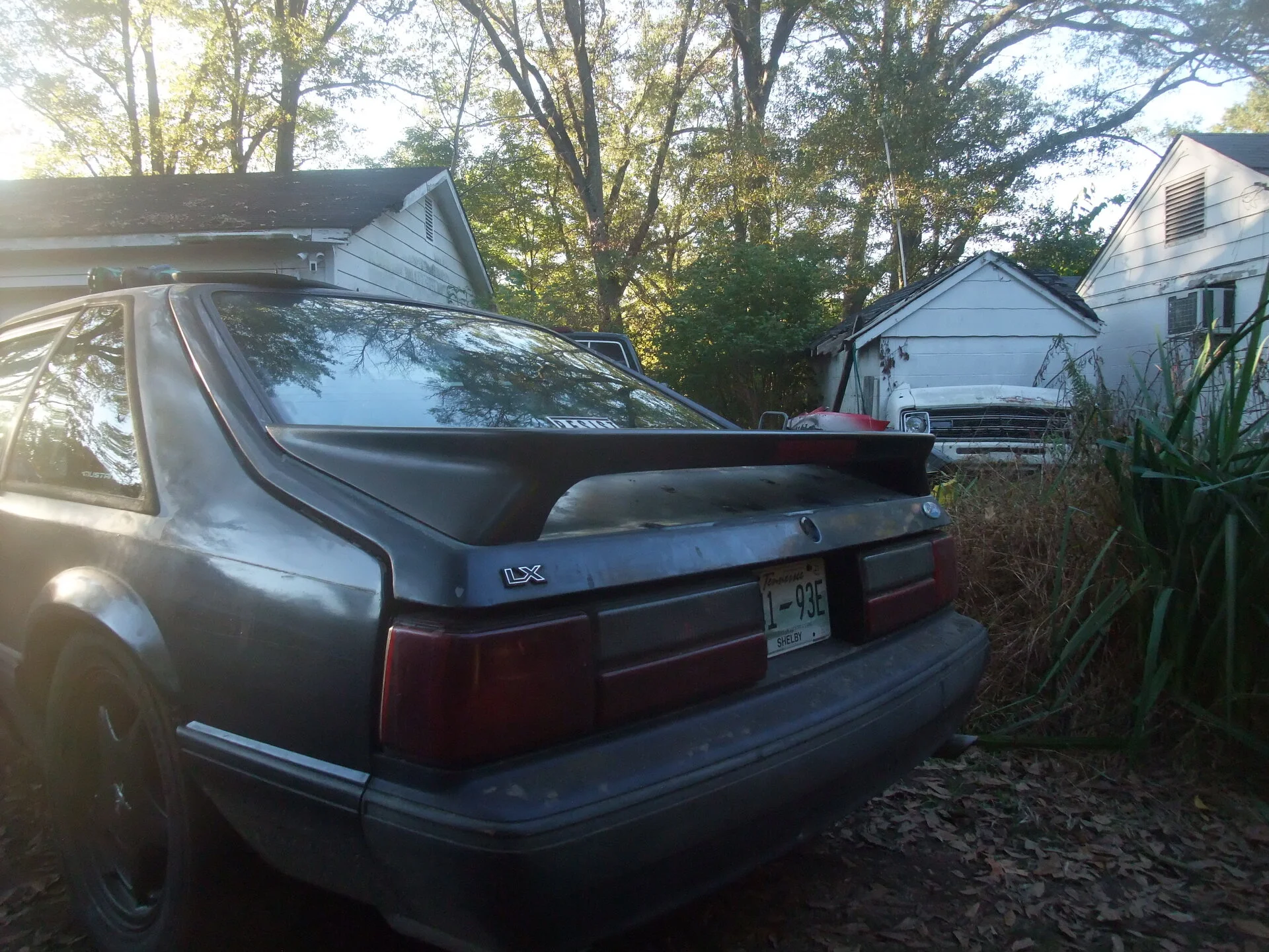

Took the GT rear wing off the parts car and put it on my 89 LX, I like it. It's flat black so doesn't stick out like it would if body color. I also swapped drivers door window from the parts car to my 89 as its window was chipped at the top. I figure the parts car has about $700 worth of parts on it....not bad for $265.
GT wings look killer on LX's :nice:

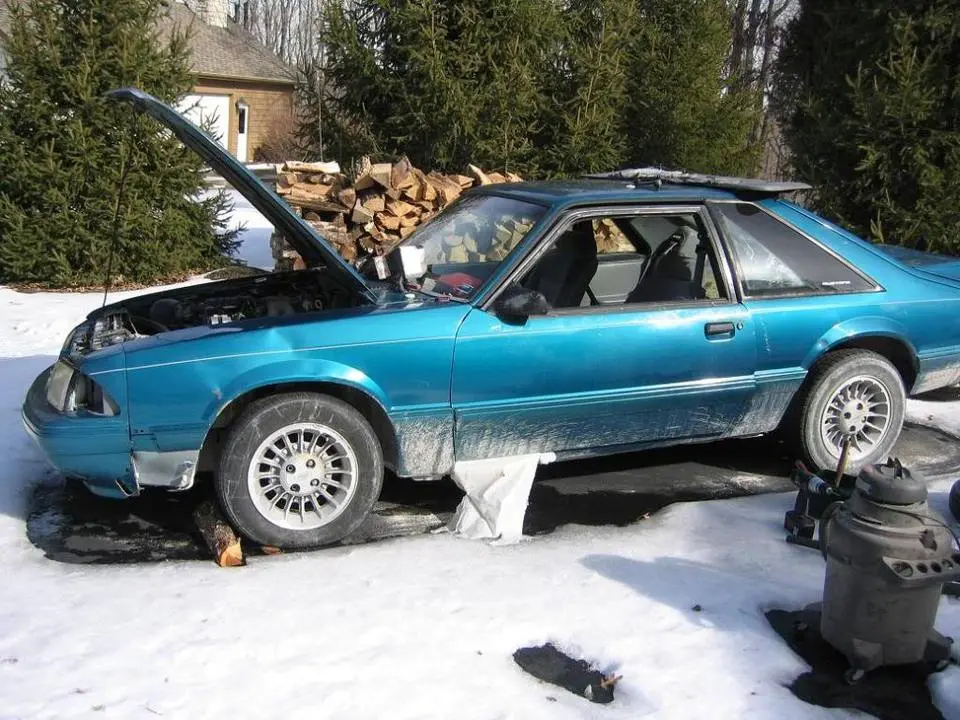

I know this car was in a minor front end accident, as thats the reason I was given as to why the Cervini hood is on it. The passenger fender has a couple dents, that its not obvious how they got there, and I'm wondering if it might be a sign the front end is tweaked. The 1st dent bulges out in front of the fender arch and then behind the arch there's an inward dent. Is this how these cars bend?
Usually the inner fender would show signs of bucking As well. There are a couple crimps in the frame rail designed to collapse.
it is possible to damage the febder and not affect the inner structure.
pull a fender liner and you can do a pretty good job of inspecting the aprons and rail
Been busy w other stuff. Took the Door lock to a locksmith today and got keys made for $22. Crawled under the car and looked good at the framrail and it's fine....the dent is just in the fender. I bought another used white fender, for $75. It's straight but has holes drilled in it and a bondo repair. I can probably fix the original fender on the car. I have a stud gun and know how to use it.

Regarding your fender dent - it is possible that the fender was damaged by the frame rails being moved. On this car, the dents in the fenders were pressure bends because the car went down into a ditch and the front end was pushed up. When I took the fender off and attempted to bolt on a new fender, it would not fit because the front of it was cocked up in the air and the rear of the fender contacted the top of the door. It took frame machine time to pull it back into proper position.
I only post this because the possibility exists, not because I think that is what has happened to your car.
