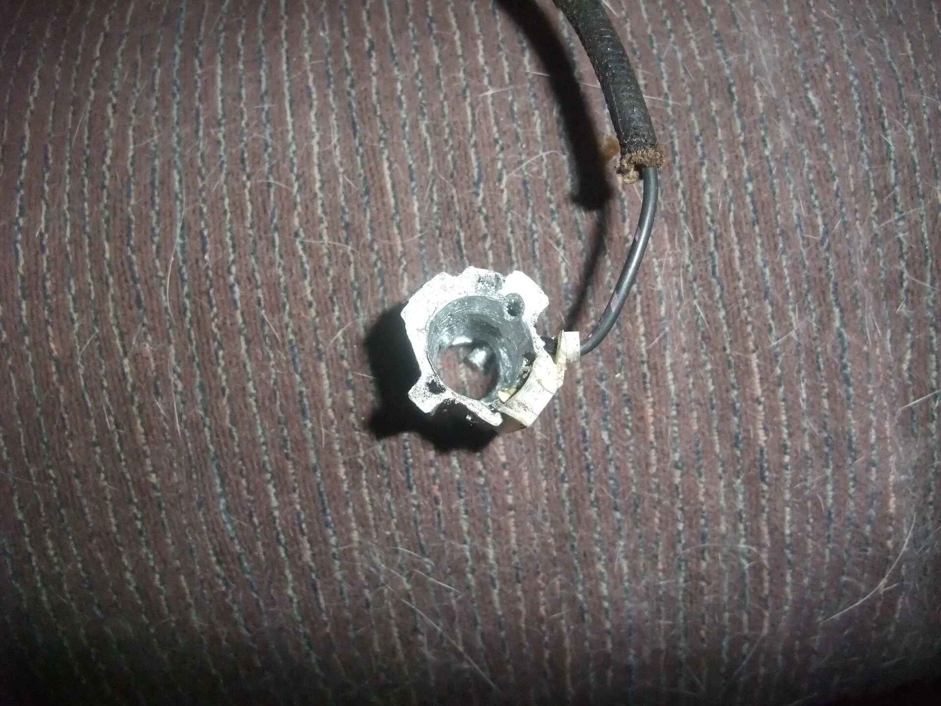

problem solved, Drilled the ign lock, and installed new one. My fuel pump runs constantly, good for getting the 6 yr old fuel out, but a problem....Good thing I have a ECU capacitor replacement kit. Hopefully it will solve that problem.

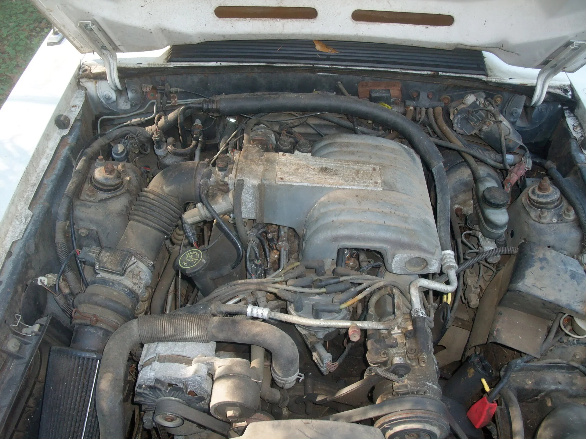

Car just got $1000 more expensive. Ordered a bunch of interior stuff from LMR to get it right. Mainly headliner and door panels. Car is cleaning up nicely, got the pressure washer out and the engine bay/door jambs, etc look much better. Dropped the fuel tank today. Should get a fuel pump/strainer Mon, got a filter today, will put the capacitors in the ECU tomm. Hopefully Mon we see if it runs. It cranks fine ATM. I was told it was a fine running and driving car when parked. Need to find a set of Pony wheels and paint em white. Car appears to be 100% stock except for the $900 Cervini ram air hood. (Hood is $640 and under hood ram air kit is another $280) and the wheels.
