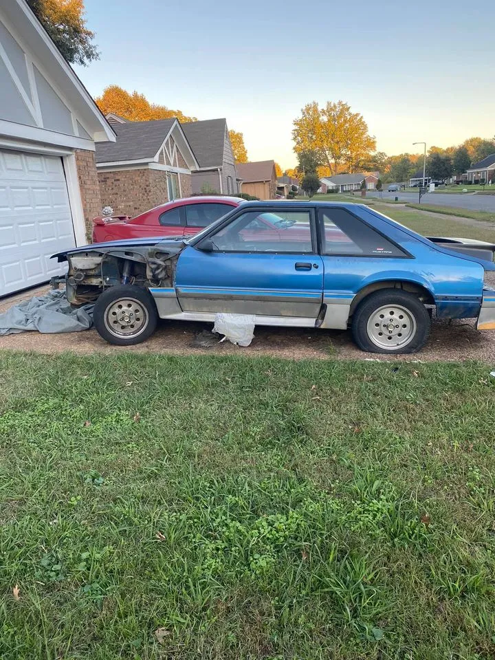

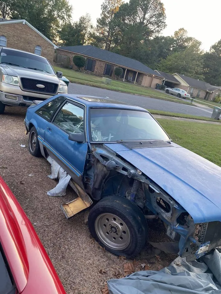

I just made a deal to buy 89 GT parts car for $200, The doors, hood, and GT rear spoiler are worth it to me.
