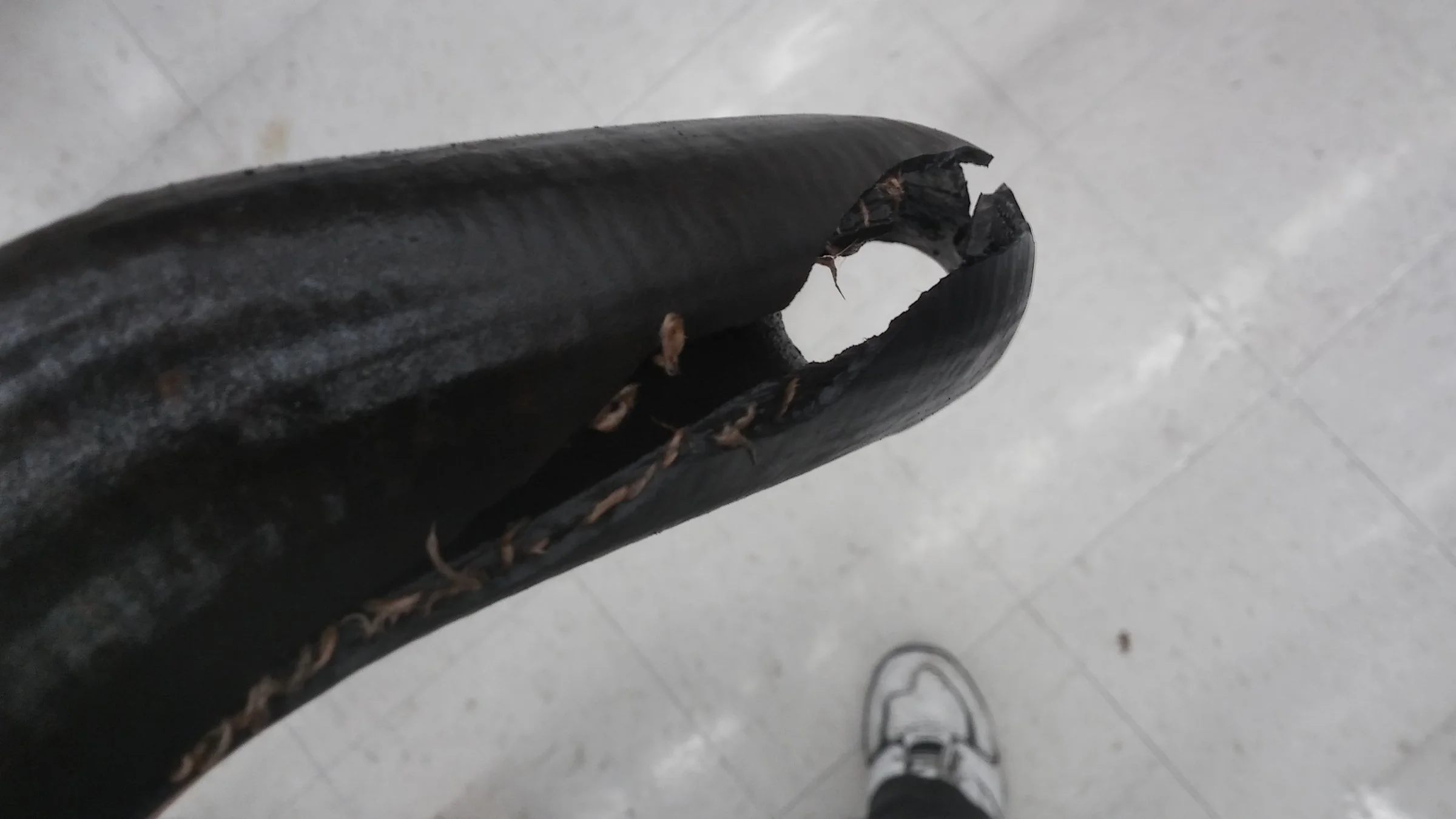

Driving up one windy continous HILL... my Fox body SLUGGED up to the peak of the hill. Pedal to the floor, moving to the top speed of 5 MPH...the LOWER RADIATOR HOSE BURST!!! Rusty brown water and coolant SPRAYED the entire engine bay.
Now that I replaced the hose, slight coolant flush, NEW Coolant added,.. How do I.. or WHAT do I use to wipe down, CLEAN, power WASH maybe the entire engine bay and top cloth underneath the Hood with out damaging my engine further?!?

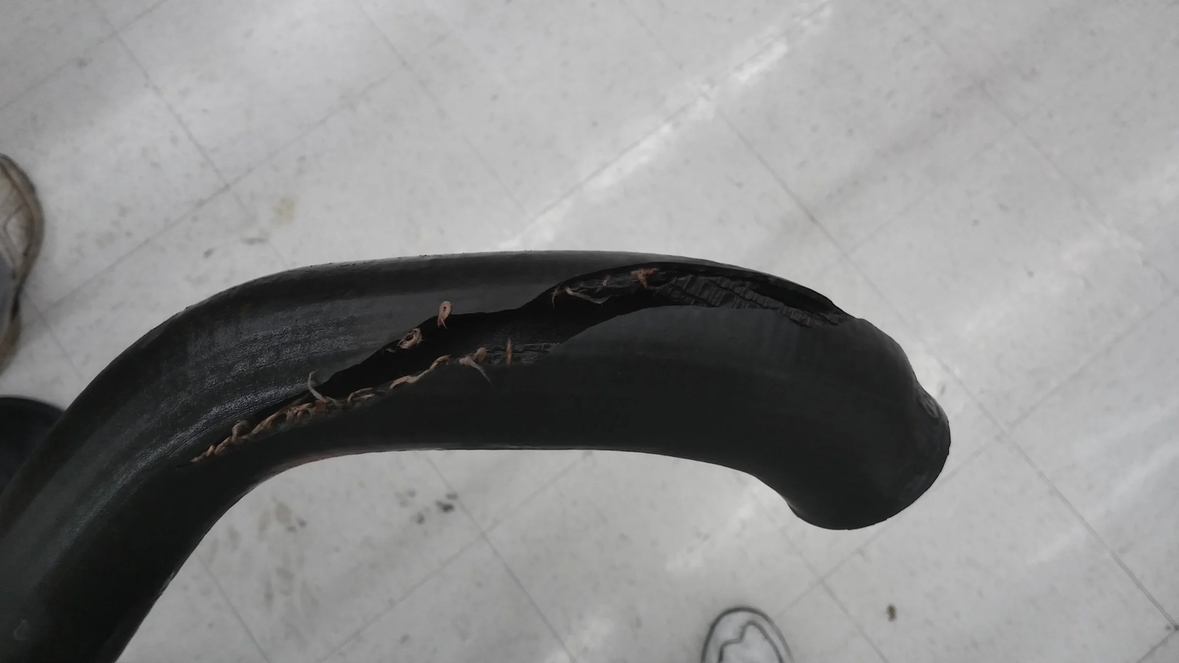

Now the hose issue, is that wear at the base of the start of the tear? I would try to contact the manufacture, because that type of failure is worst case scenario. Was your radiator clogged and or was the spring anywhere to be found?
I seen the without the spring a less serve hose burst, but only once and it was dry rotted.

2 ive flushed the system 3 times now in the last 4 months. It must be the radiator that need to be replaced as far as the rust is considered... Far as i know. 90$ The lower hose I had no idea was ready to burst. I assume the cut was on the engine side where i couldn't see when I changed the THERMOSTAT not too long ago.
