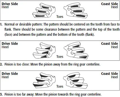

Run a pattern check on the gearset
Chances are your pinion depth is incorrect
On an 8.8 it's a little bitchy to set them up
You start with dummy bearings all around
Assemble it and check the pattern
Then if it is off you just change shims and re assemble it again and recheck the pattern
After you are satisfied with the pattern, you assemble it with new bearings and road test it
You might still have to play with it a bit more to get it perfect
As stated above, If the gears are Lo-Po all bets are off on noise
However if on coast or accell only, the whine can usually be solved by changing the pinion depth
Good luck

What I have found from the school of hard knocks
If it howls on coast, The pinion shim needs to be thicker
Sending the pinion closer to the ring
Yours, if it howls on accel, most likely needs a thinner pinion shim
Change it by about .008 each time

I would have a different shop check the pinion depth
The whine should be there but not real bad
Most people (shops) have no pinion depth gauge for your 8.8
So, they either rely on a marking on the new pinion, or just guess as to which shim to use
They guessed way wrong on yours I believe
It might be time for you to learn to overhaul a rear end
It's really not that tough, especially if you get or make dummy bearings

As far as special tools
All you need is a dial indicator on a magnetic base (to check the backlash)
You do need some heavy artillery (to crush the sleeve)(at the end when you assemble)
Normal labor about 900 (they are going to have to start over)
