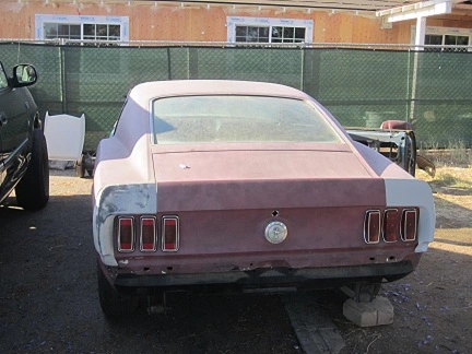

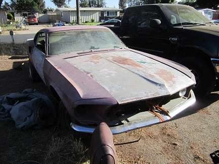

Hey thanks for the replys.Also just got my project a few days ago.

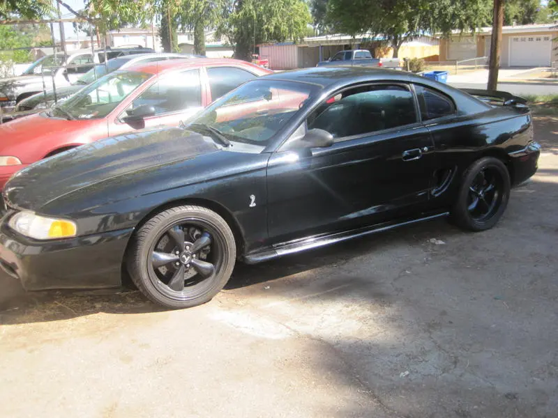

Seems a shame to parts out a 94 Cobra that's not a wreck, but it sounds as though you've already had some fun with it!:cool: Being that the 5.0 was only in a few SN95 body style cars for only 1, or was it 2 years, it's a little bit rare. If it were me, I would try to find a wrecked/tortured Cobra to strip and maximize the value of that one you have by $elling it. Of course, if you've been driving it awhile, you know what you've got. You may still be able to get a few $$$ for the bare body shell.
My $.02,
Gene
I tried to sell the cobra a few months back.Plan being to put a down payment on a newer front engine rear wheel or 4 whell drive car.I was trying to get 4 grand for a car that made 424 hp and 470 ftlbs at the rear wheels.No buys here in san diego CA cause the car won't pass smog.
List of mods on the 94 331 stroker gt40x aluminum heads port and polished.Edelbrock intake with 70mm throttlebody.Ford racing supercharger cam.Sct chip home made water to air intercooler system.Vortec V-2 si trim s/c with 2.70 in high traction pulley. richmond built T-5 manual trans with ram clutch aluminum drive shaft and 3.55 rear gears.
All that for 4 grand and no takers.And the list is longer when you get to the tires and leather seats and such.
