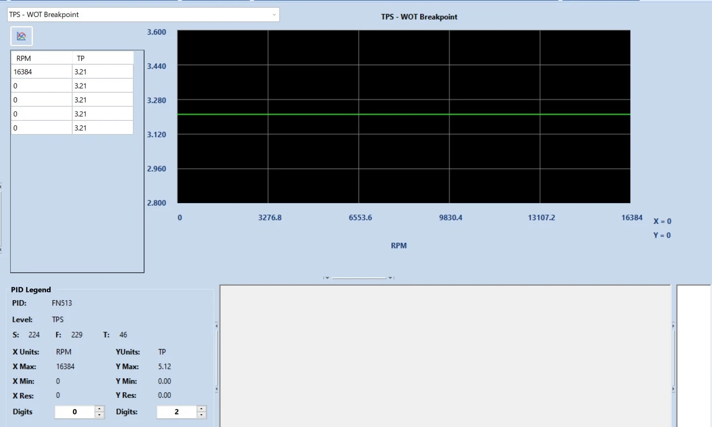

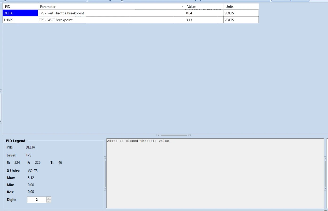

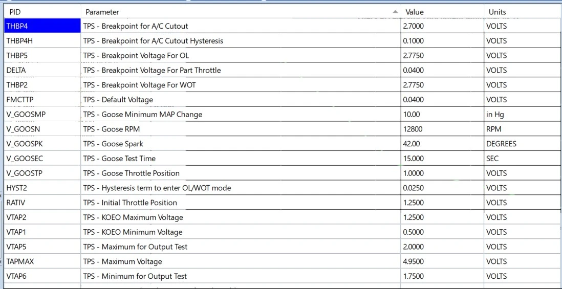

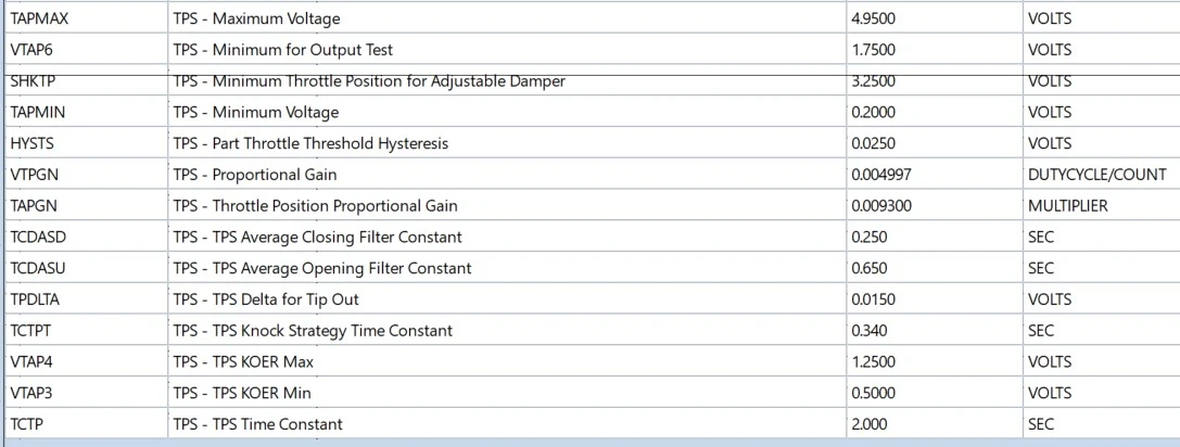

If you stated that youre using a 1994 TPS with an A9L..?..;- Theres your problem... a 1994 runs on the CBAZA strategy not the A9L..
The voltages dont match up// whether or not its a potentiometer it still has an internal grid that works differently
Heres A9L.. Notice how many settings there is for the TPS
vs CBAZA
Buy the right TPS and also Im pretty sure the 94TB is larger too and used a 70mm Mass Air Fow sensor to match..
Im pretty sure once you get the correct sensor the engine will start cold but will also run lean with a pretty fast idle..
Good Luck
