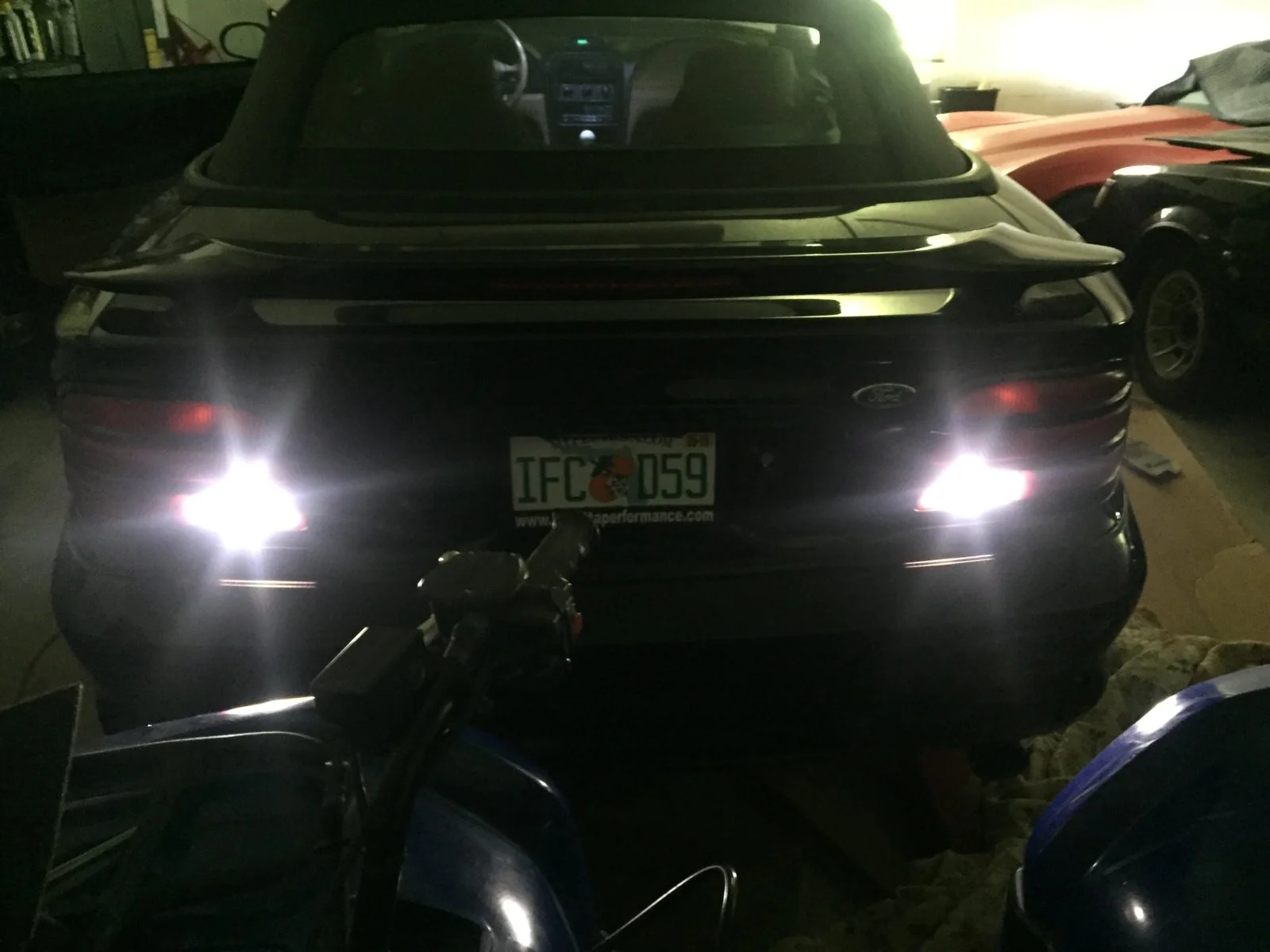

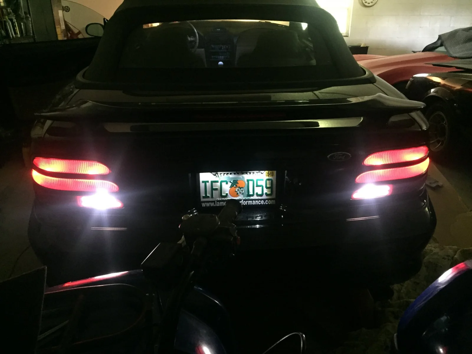

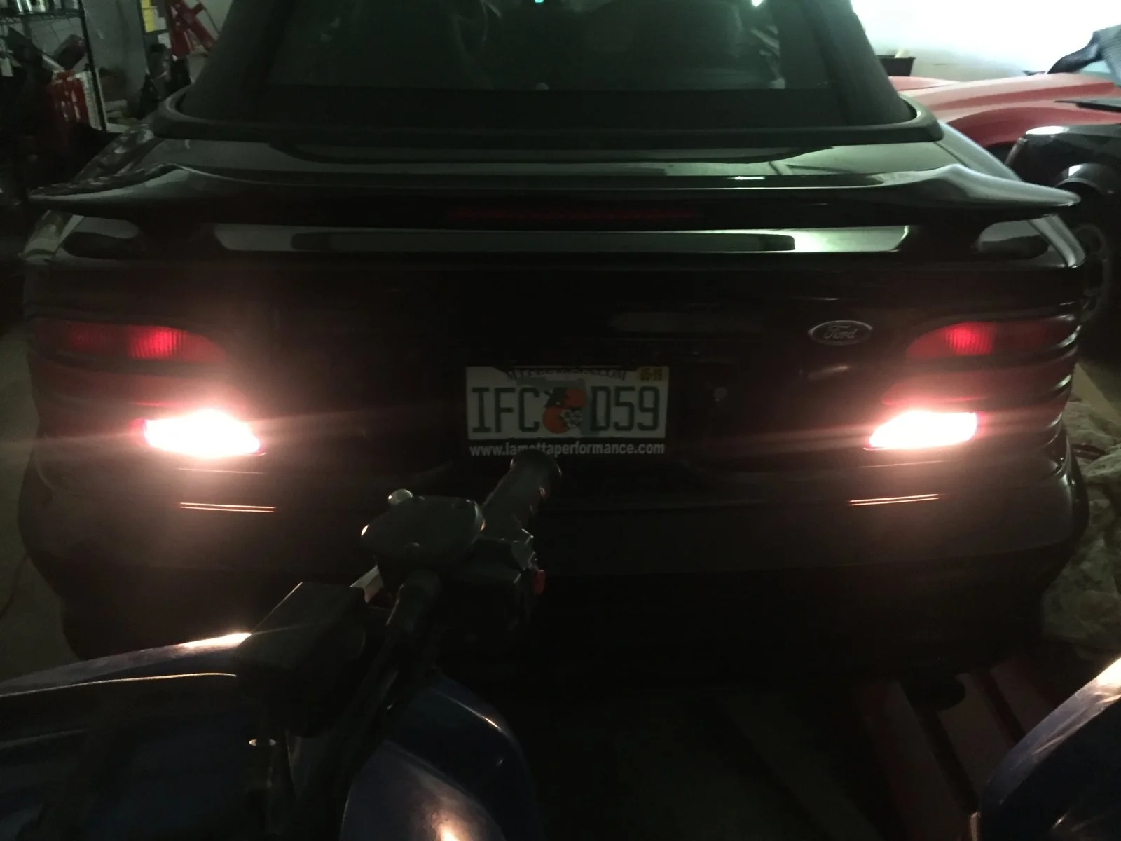

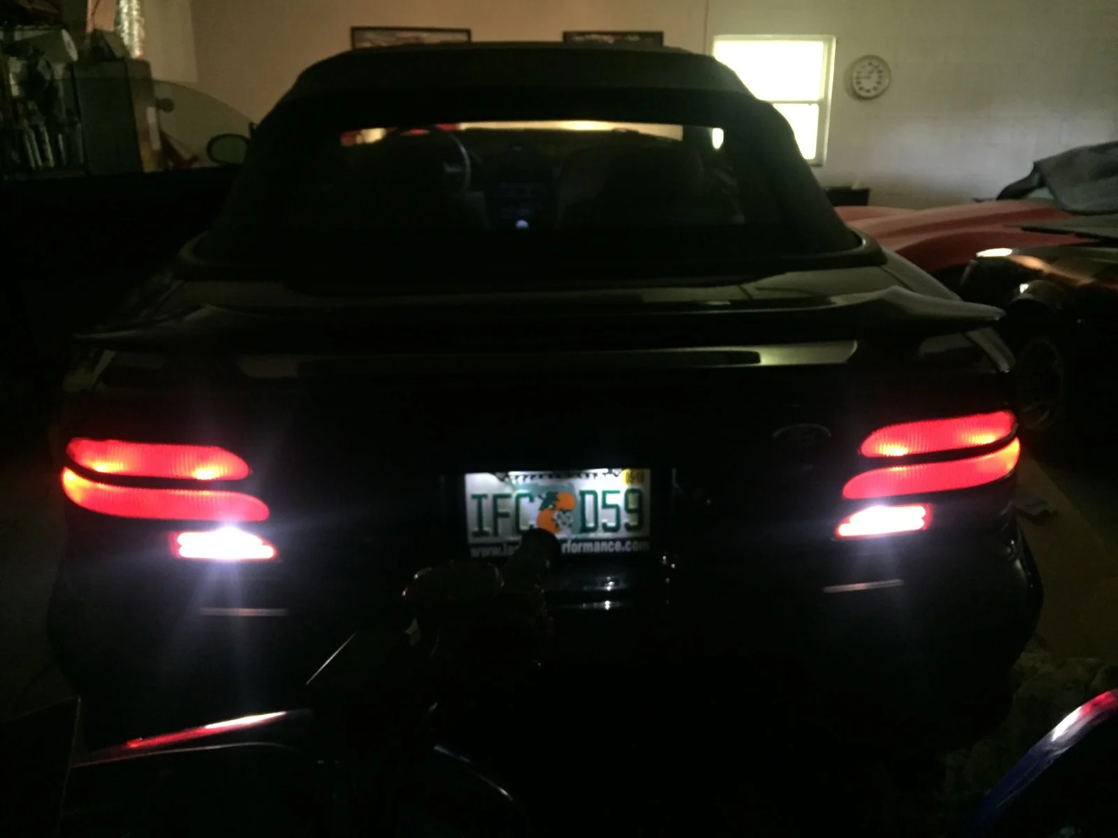

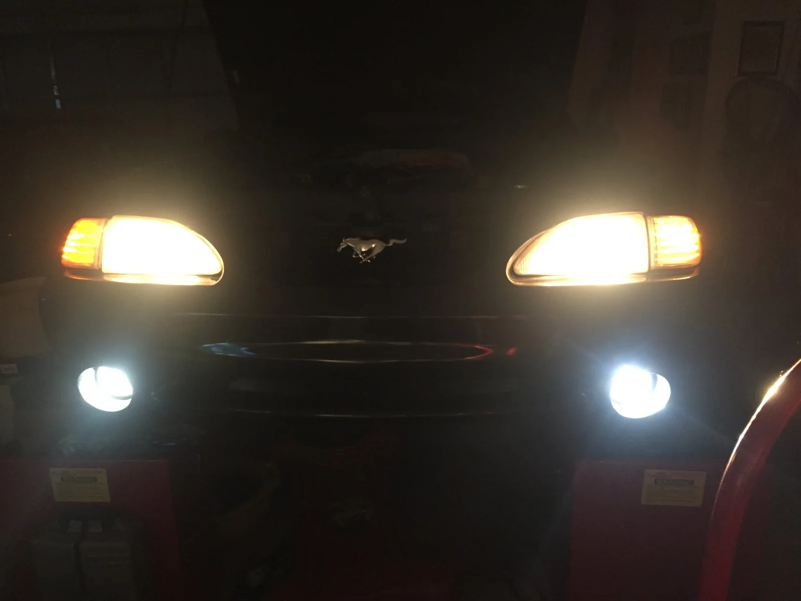

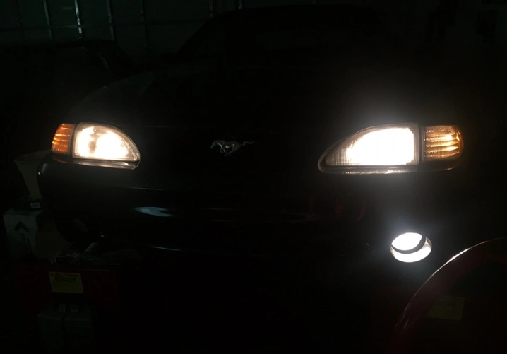

Did some LED fog lights on the cobra today, working on the full led conversion.
Before
After

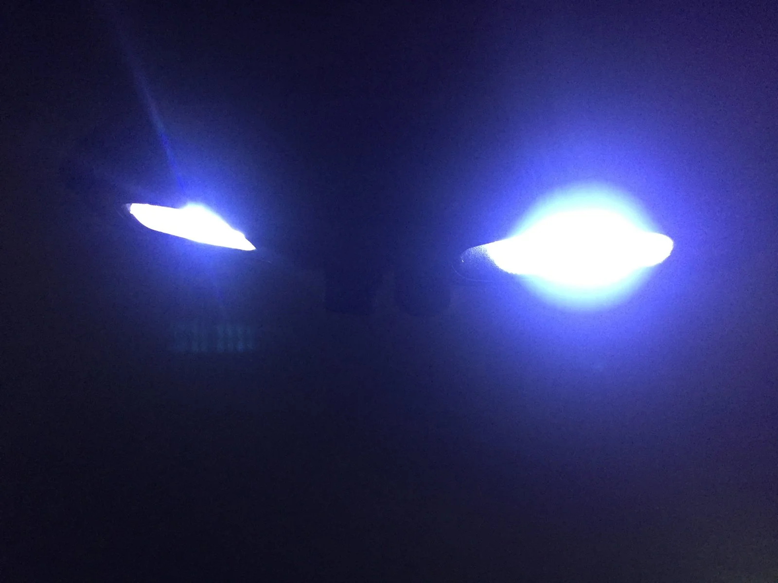

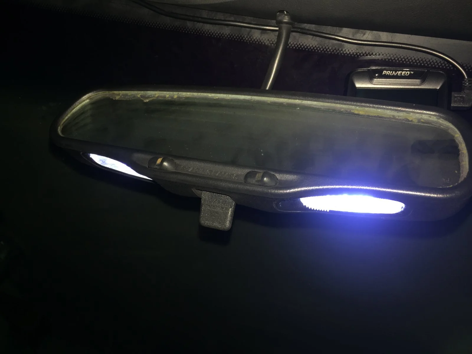

On the other hand got one more piece done in the LED conversion, did the map lights. I want to do the glove box light but can’t figure out how to access it, any help there is appreciated. After that and the dome light as well as hvac I’ll be full led interior.
