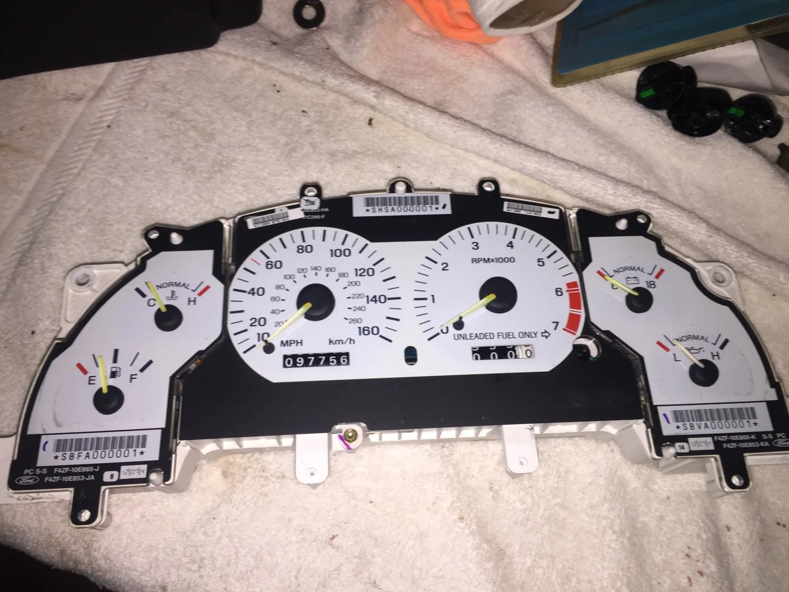

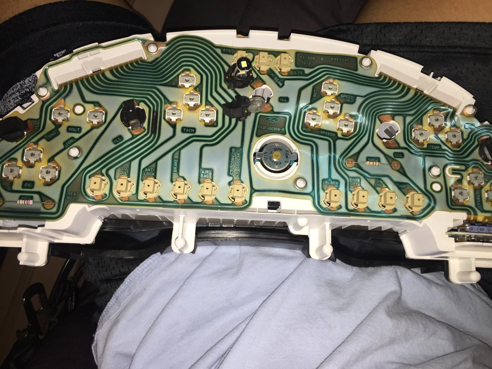

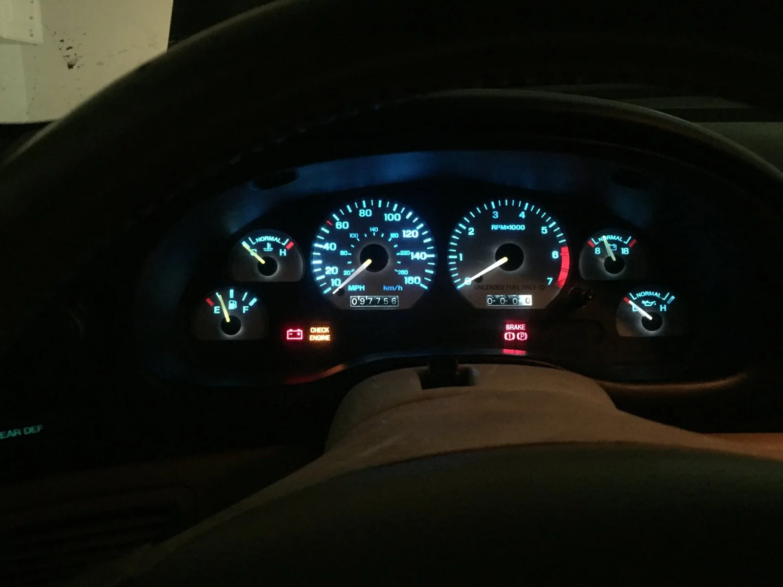

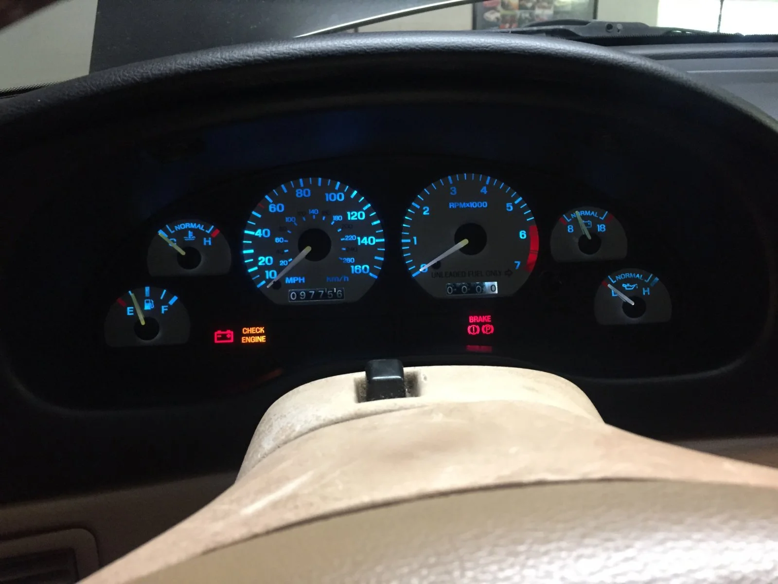

Just swapped in some leds to the gauge cluster and license plate lights, quite simple and good looking I think. Still have to do led map and dome light and eventually hvac
C6AE8B6D-1E7C-414C-90AE-999E357CA749.webp C6AE8B6D-1E7C-414C-90AE-999E357CA749.webp 56AC58C8-F97B-4076-9AFB-39B54131EC55.webp 491EF4A7-E77A-474A-9698-F07E3102453F.webp

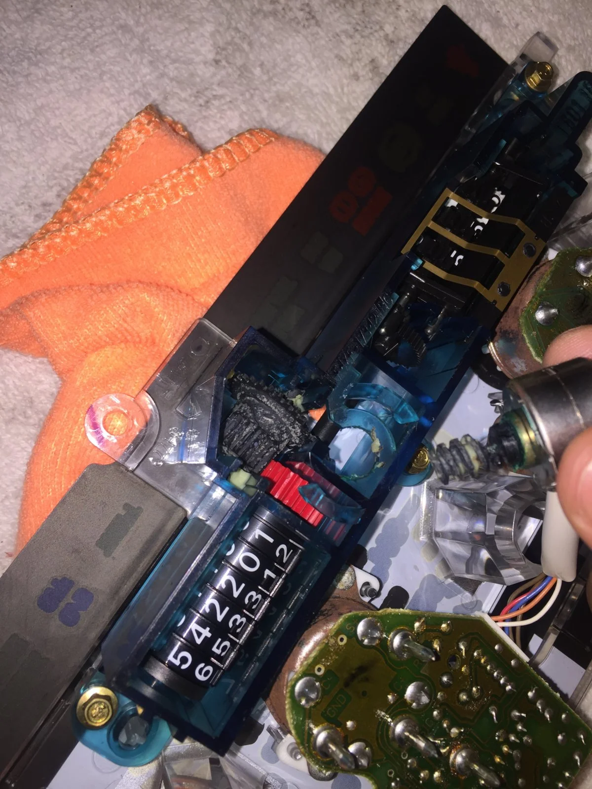

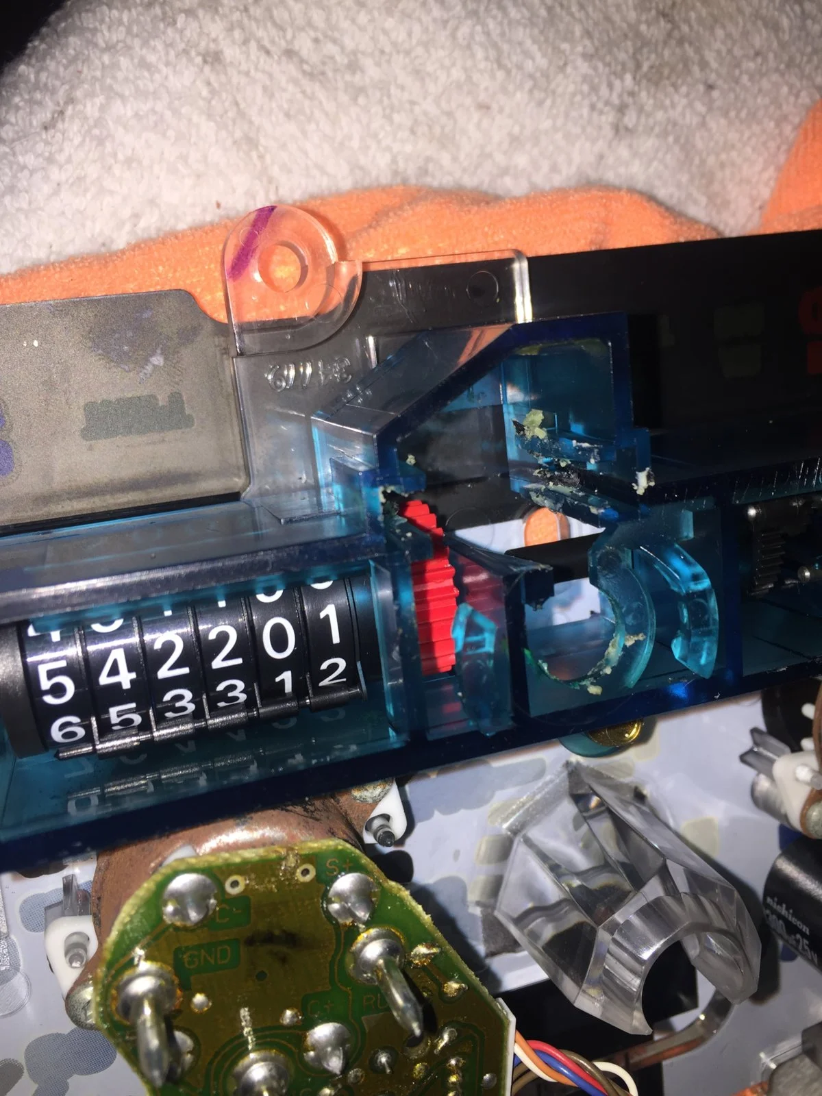

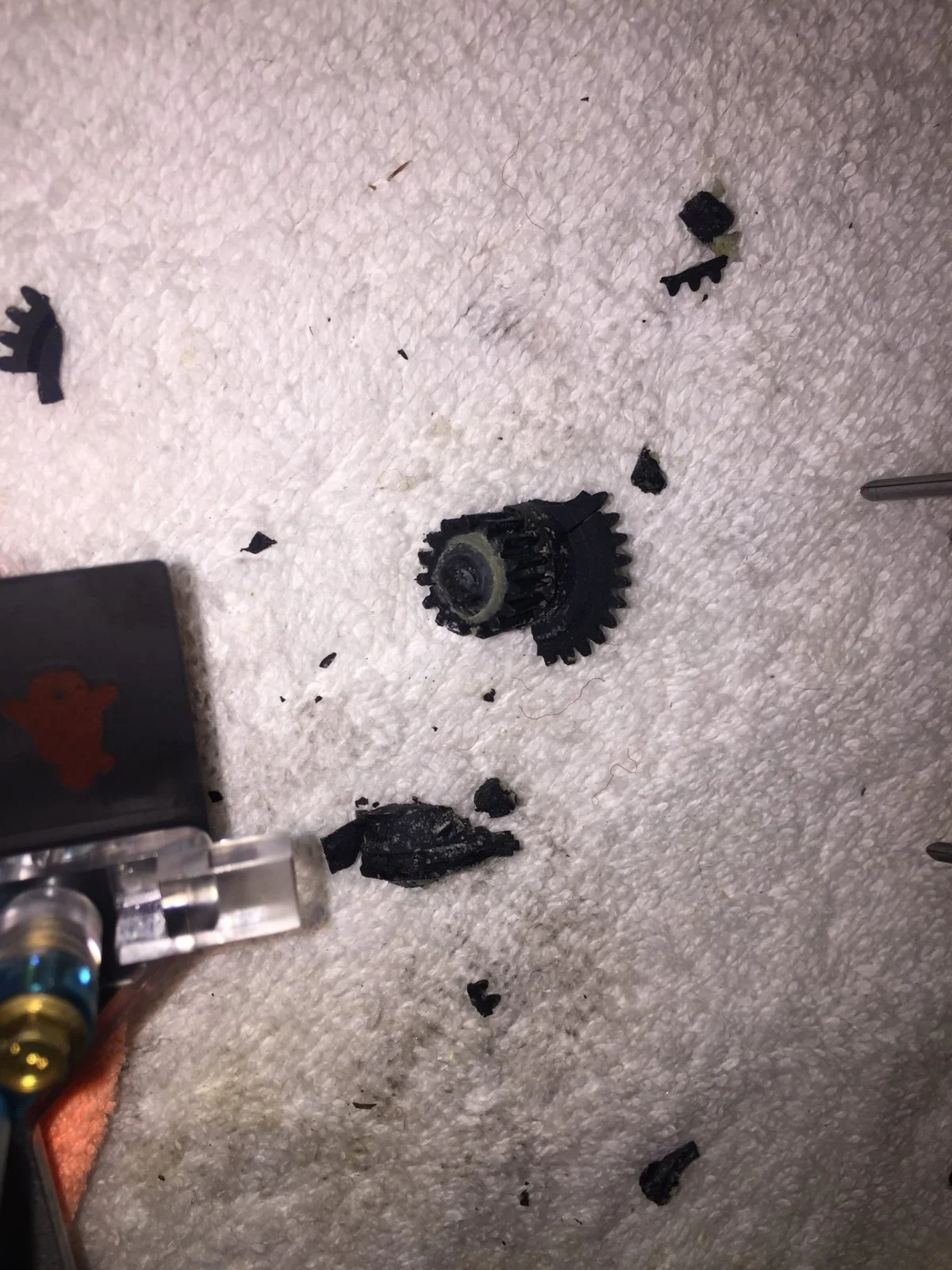

As for today I started on the odometer gear repair, picked the part off amazon for 6 bucks and it’s coming in tomorrow,
I’m the mean time I did all the prep work and determined the driven gear was all broken up and crumbling and the top of the worm gear is sheared off
E4626EDF-225F-43E4-886A-1C6EBE588A08.webp EB858E29-6718-434C-9298-873A1B5BB029.webp 8A2D9D77-86BF-4638-B177-7965EE4556F1.webp 48A56B9B-BA2A-46D8-B584-547400A723A7.webp
