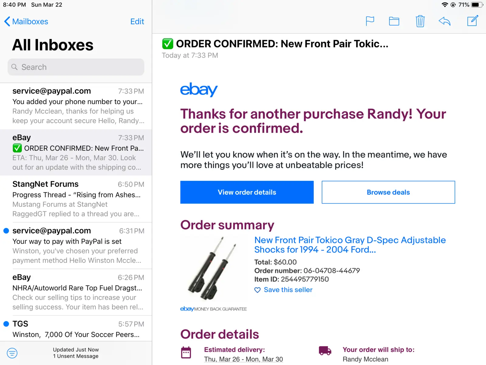

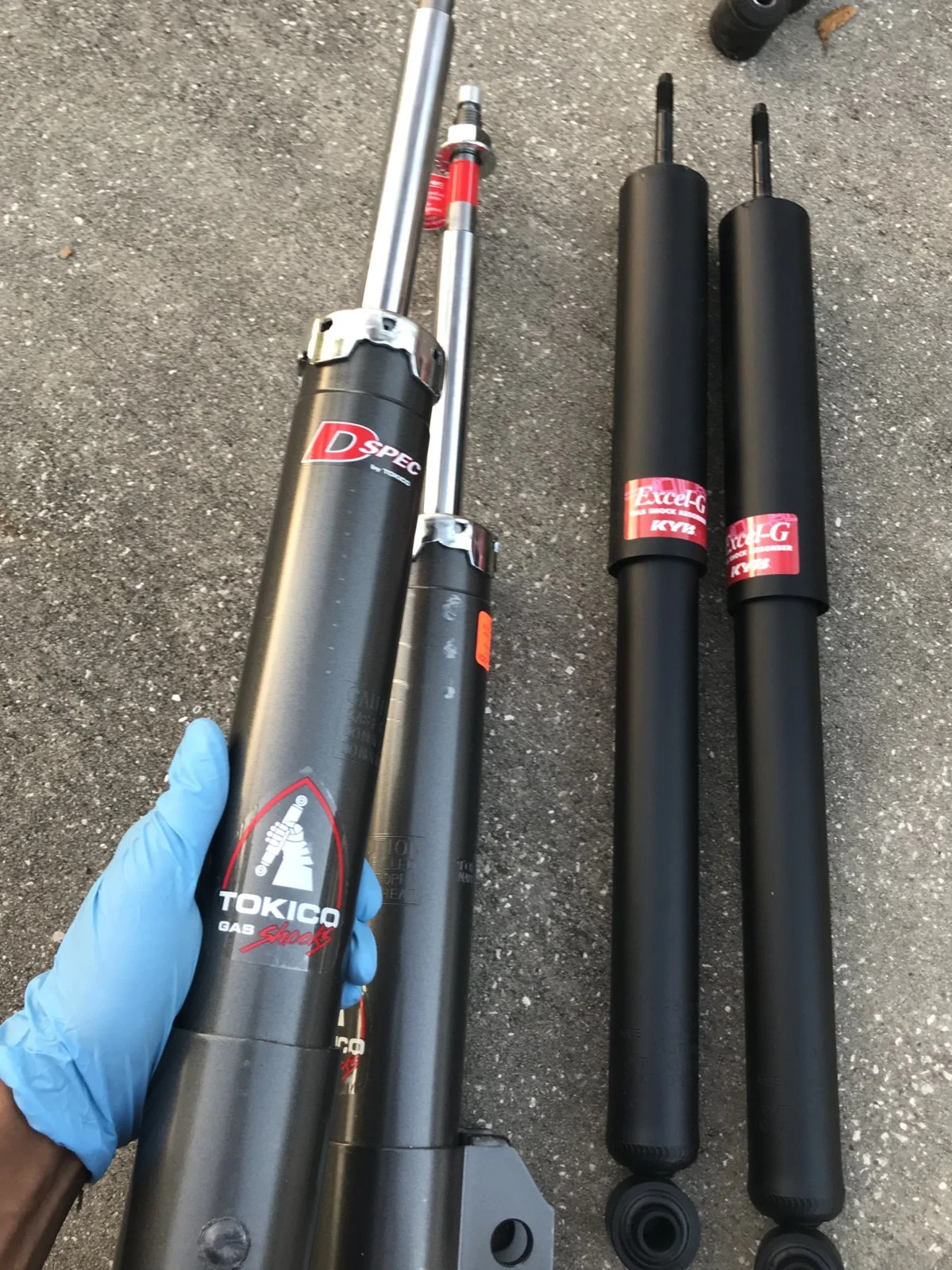

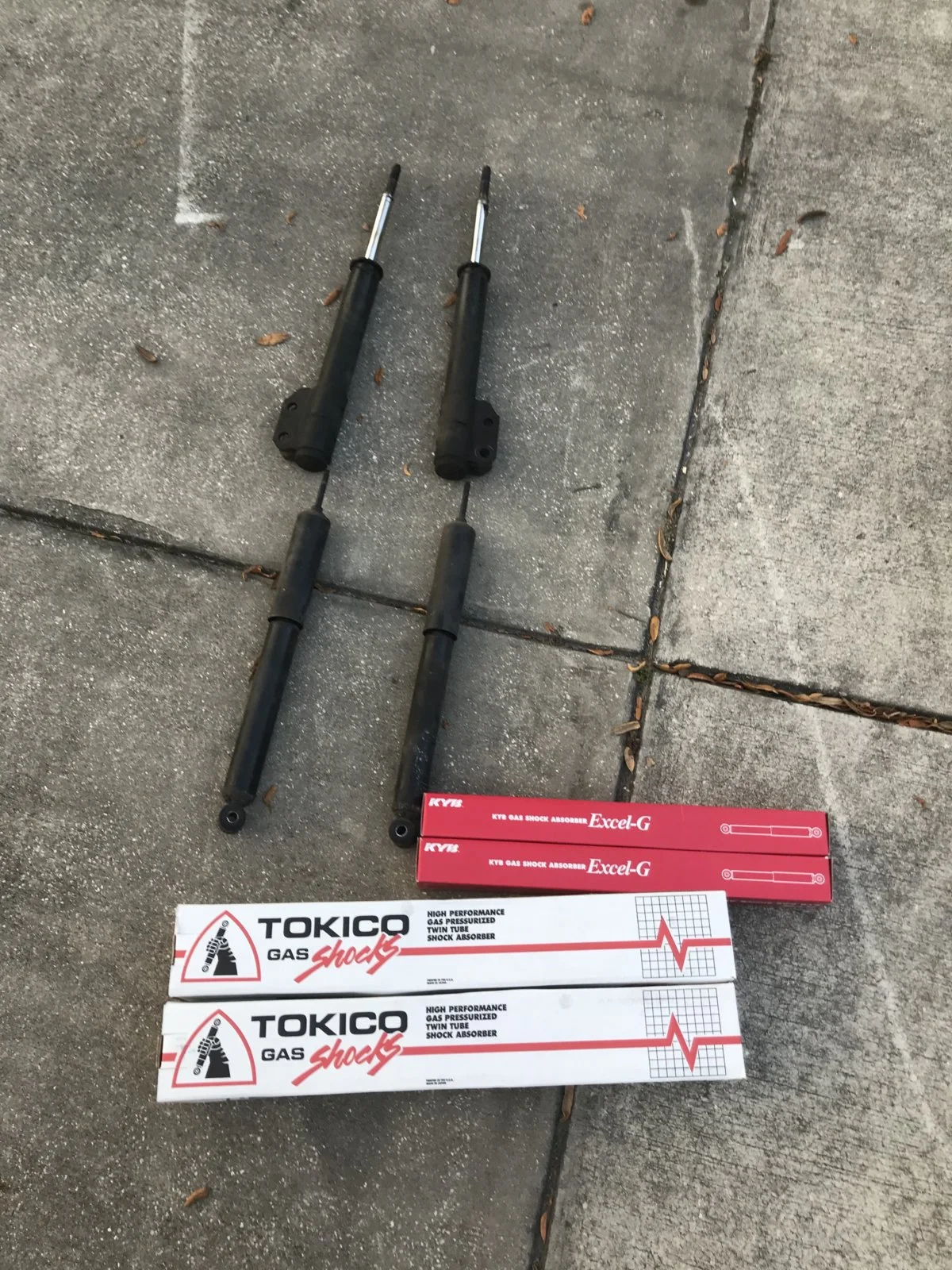

Found a great deal on a front set of Tokico HP Blues for $60. I’ve been searching for a rear set to match to no avail. Since shocks are usually done in pairs, would it be bad to have KYB GR-2s in the back? I can get those from rock auto for $47 shipped. Not looking to drop lots of $$ (because I don’t have much lol). don’t eant to put in the Monroe or Gabriel garbage, Just want a good ride for my mild drop.
Tokico d spec on the way! As well as kyb gr2 for rear
Reactions: General karthief
Sorry for lack of pictures, I ended up installing these late at night because FedEx decided to deliver at 8pm.. I tore down the old struts and shocks early in the morning and waited all day. Anyway, the car had Monroe oespectrum stuff all around. Tossed that out and got the new stuff in. I adjusted my new Tokico d specs 4 turns from full firm to start and I’m going to take a drive today.

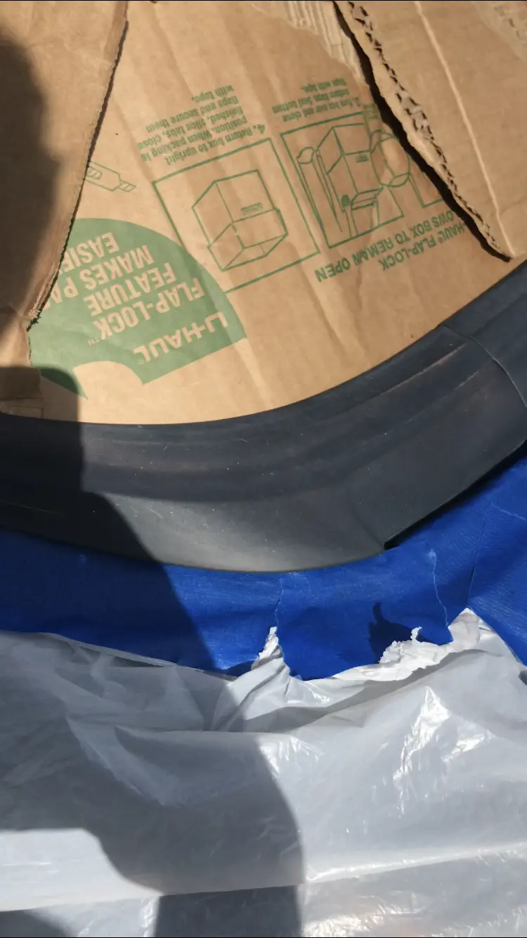

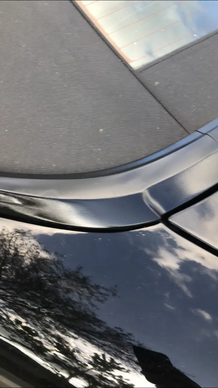

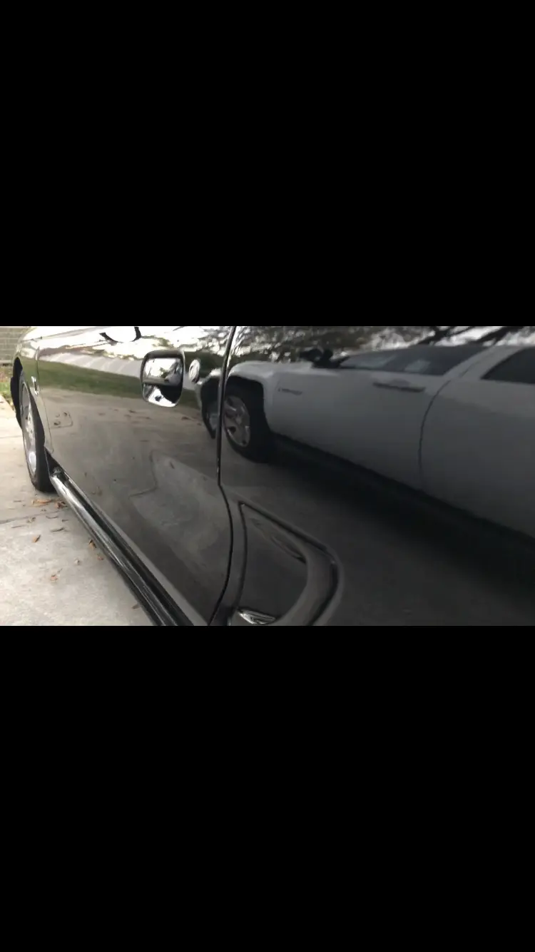

Just a little update, the car rides much better now. No more harsh ride and bottoming out. I found a nice balance at 3.5 turns from full firm in the D specs. Nice compromise for good handling and smooth ride. Also painted the convertible trim which I’ve been meaning to do for a while. Along with that the whole car got compounded, polished and waxed last week. Pics coming!

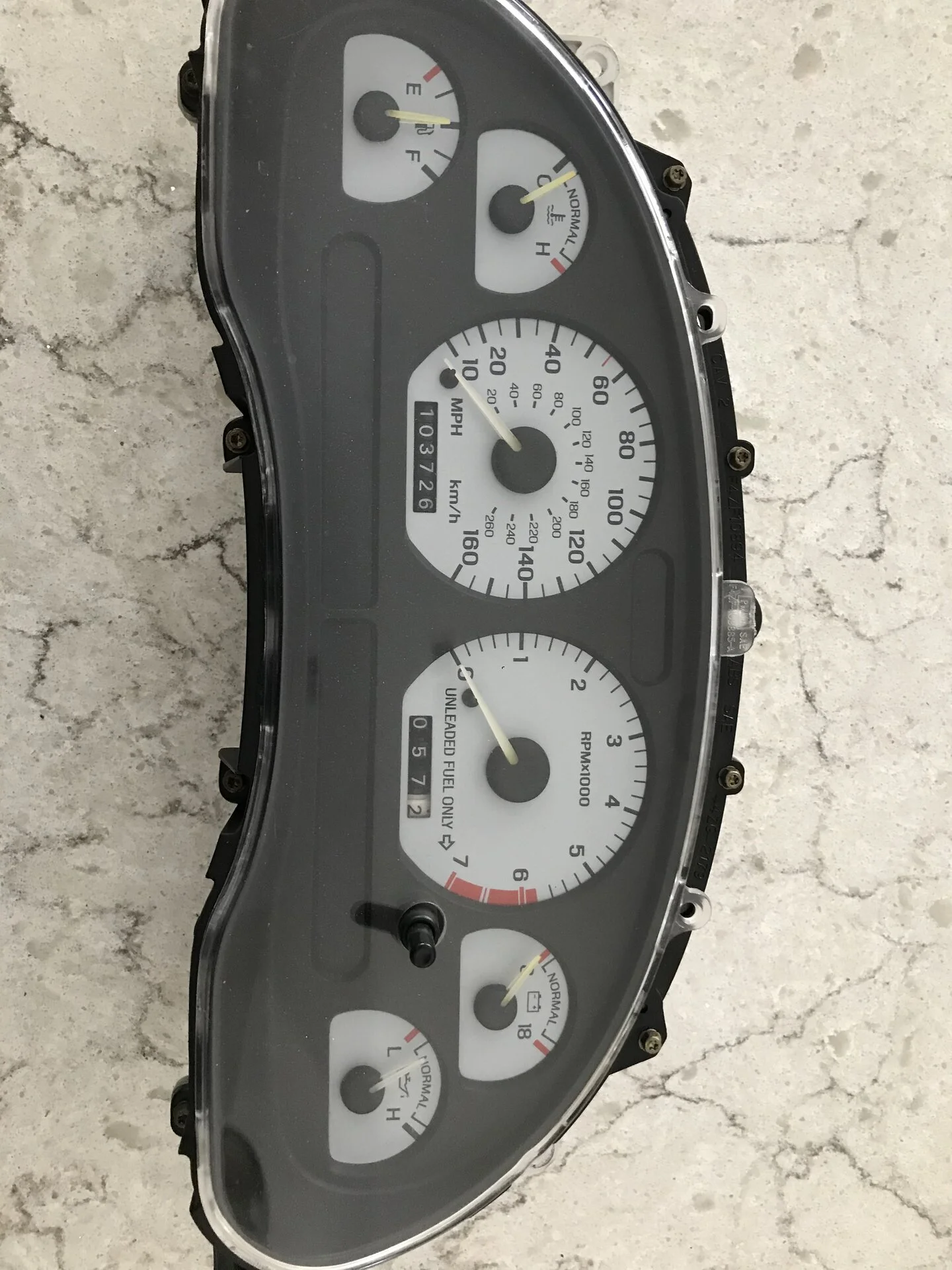

So with the quarantine, I’m continuing to work on the little stuff to make my car nicer. This week will be repainting my steering wheel column trim that is badly sunfaded and repainting my gauge needles. Bought the SEM saddle tan color coat and testers flouresent orange for the job at hand. My question for you is how I can check for slop as I tear down the steering area. The trim, wheel, and bottom panel will be off and I want to see if there’s any way to check why the slop is so bad. My wheel can turn like 25° before actually starting to turn. I’m hoping it’s something quite easy and not the steering shaft.

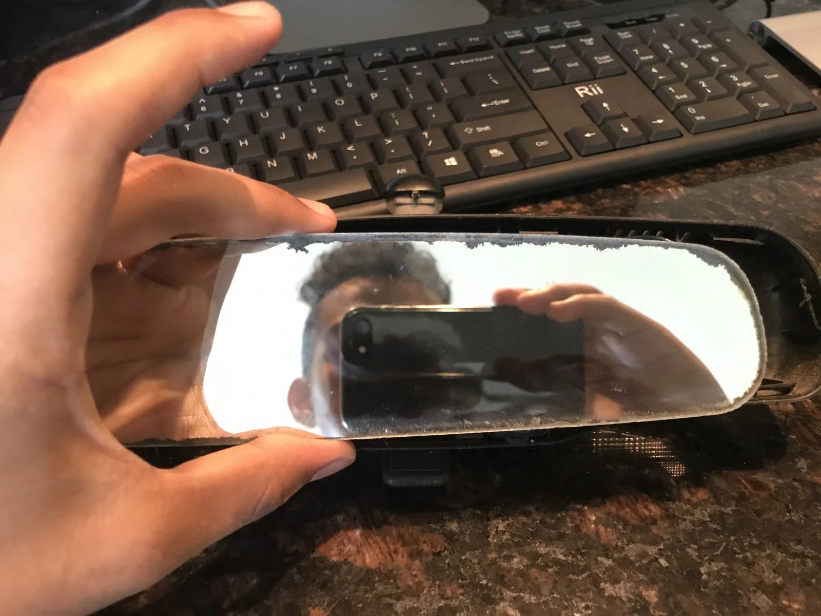

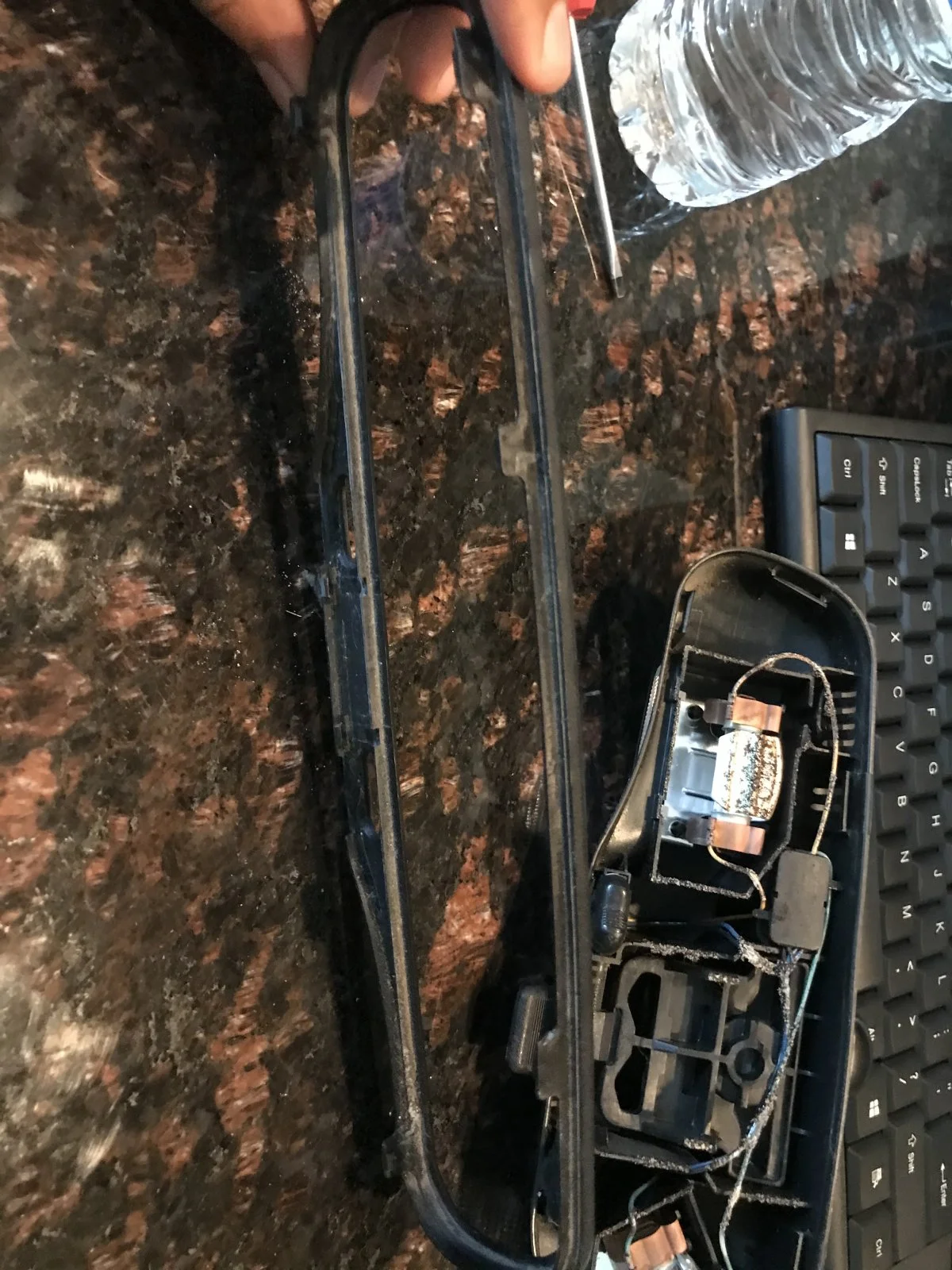

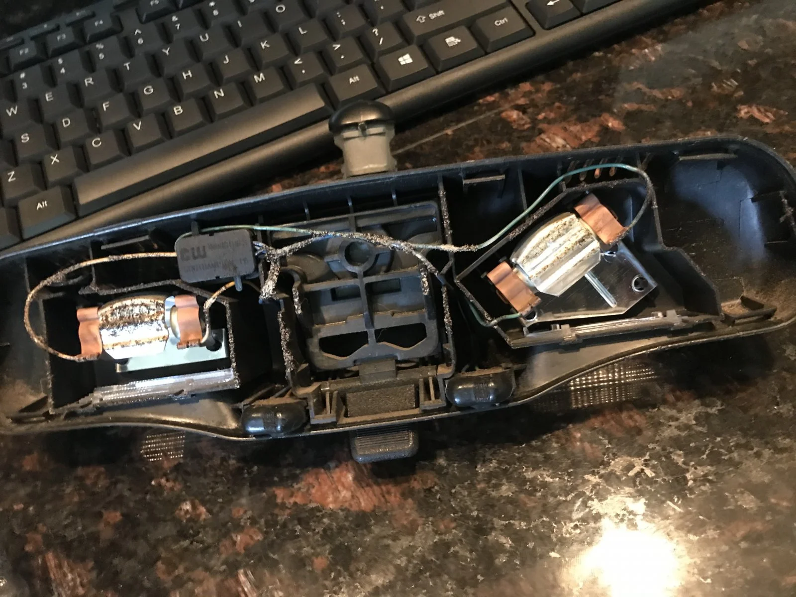

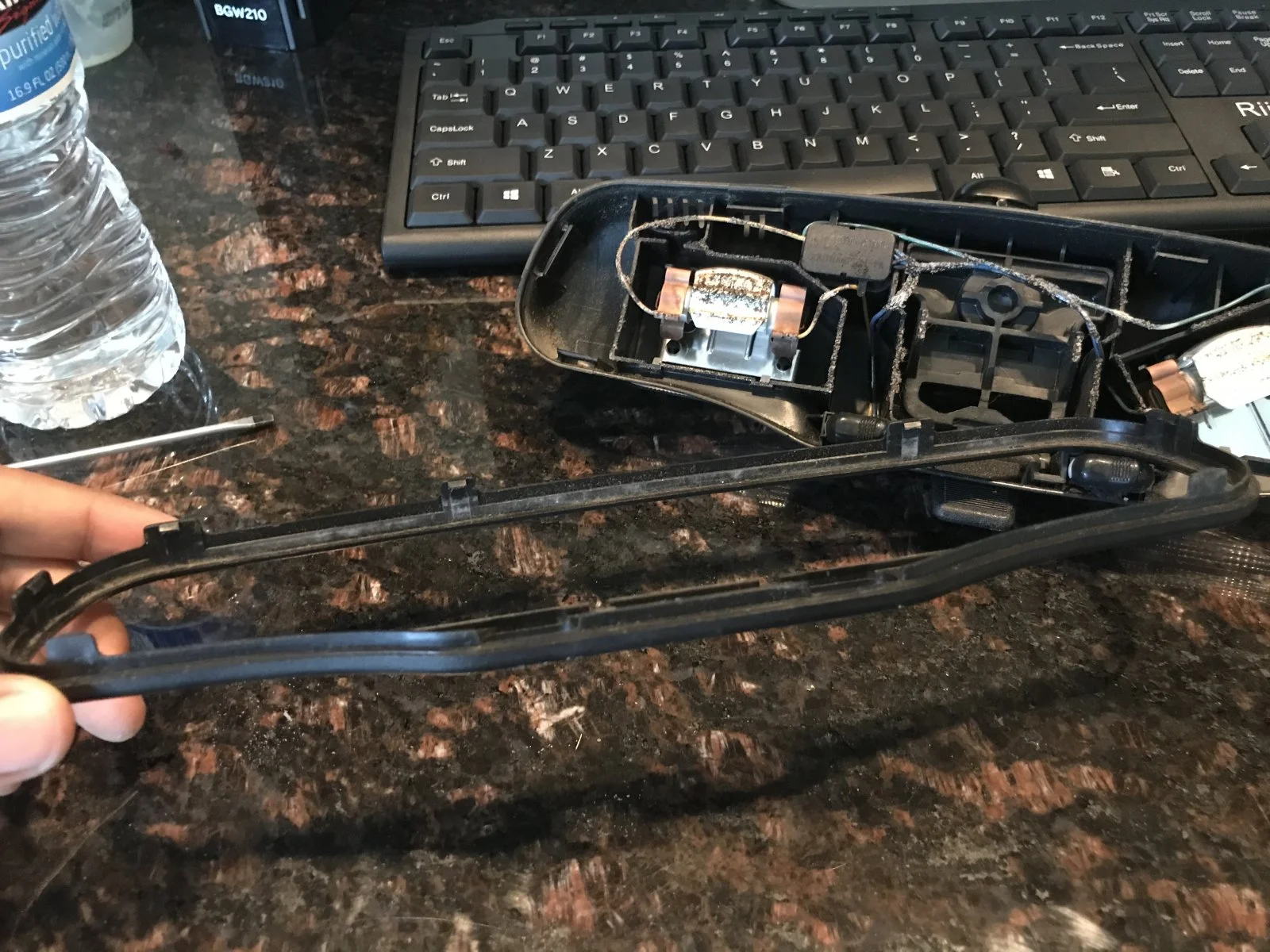

Swapped the rear view mirror out of one I had in the parts bin. I didn’t want to risk breaking the windshield swapping the whole assembly so I took off the face plate of each and swapped the mirror

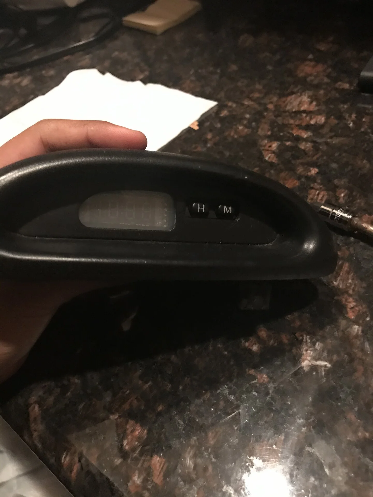

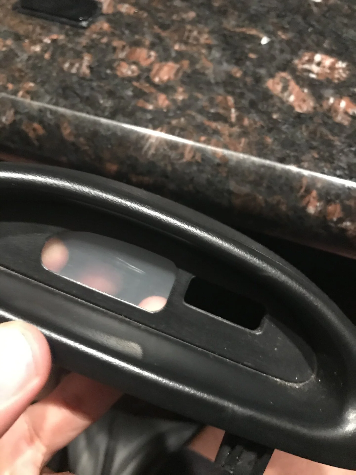

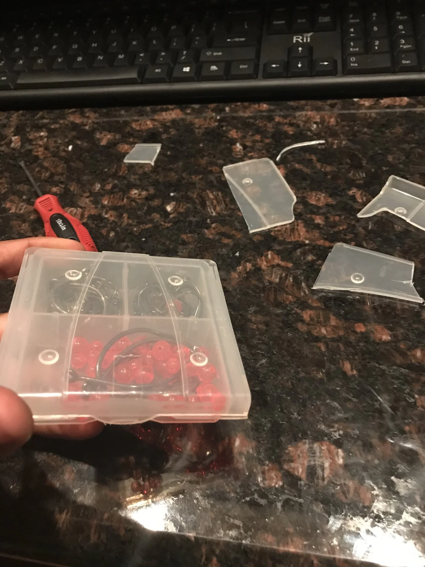

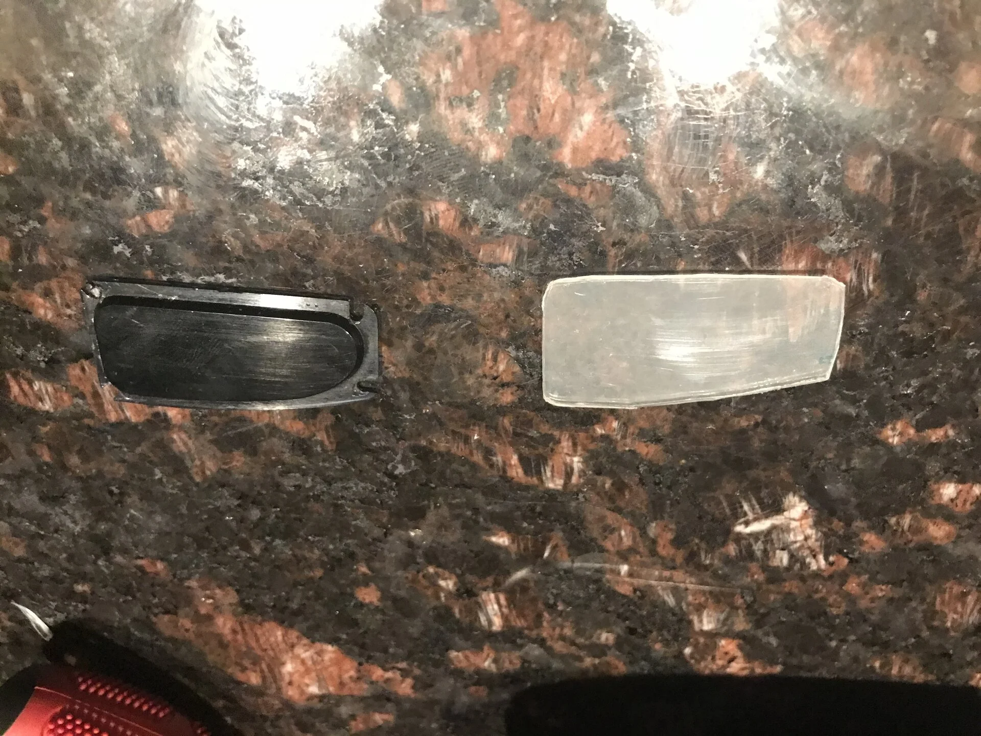

Additionally, I disassembled a spare dash clock I had in the parts bin to try and get it to glow blue to match the rest of the interior. I popped out the green tinted lenses and created an identical shaped pieces out of clear plastic. After I got that filed and shaped properly I went ahead and ordered some blue cellophane paper that should arrive tomorrow. I'm hoping wrapping the clear plastic in the blue transparent paper will yield the results I'm looking for. This is just my first trial and it might take some further attempts to get it right.
