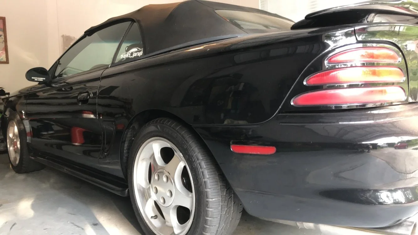

Just wanted to pitch in a little update and two nuances I’ve noticed in the car.
Today I got the rear B springs in with no isos, I’m glad I chose not to cut the deal coil off of them as I’m very happy with the height here’s some pics
Still have to get the fronts done.

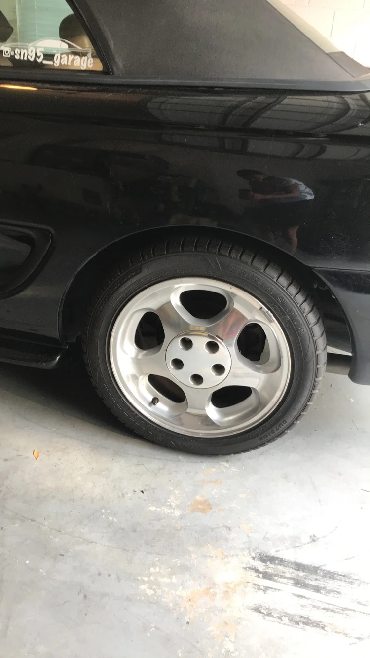

As for the two major issues with the car. When I’m turning and pushing in the clutch and releasing it for the 1-2 and 2-3 shifts at slow speeds the car clunks noisily. I’m almost certain it is the exhaust knocking agaisnt the frame, it’s very embarrassing having my car clunk about at slow speeds. I took apart the entire car back and reinstalled making sure to clearance all the exhaust form the frame and such, and I gave it all a good tug from the x pipe back and nothing hit. I took it for a drive and it was all good. Then the next day when I drive it the knock was back. When I took off my tailpipes that come right above the axle, the car knocked significantly less but I couldn’t stand the drone. Does anyone know what this issue could be. I really hate the constant clunking and it can’t be good for the car.
Second issue is the car sits .75 inches lower on the driver side rear only before AND after the lowering spring so I’m at a loss as to why the car sits so much lower on one side. If anyone knows that this could be all help is appreciated. Some threads I came across said blown shocks or bad control arms. Sorry for the long write up but these are the only issues with the car and I would love to resolve them. All help is appreciated

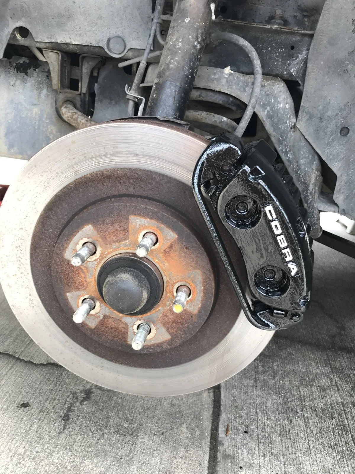

Painted my calipers gloss black with the duplicolor kit, very happy with results

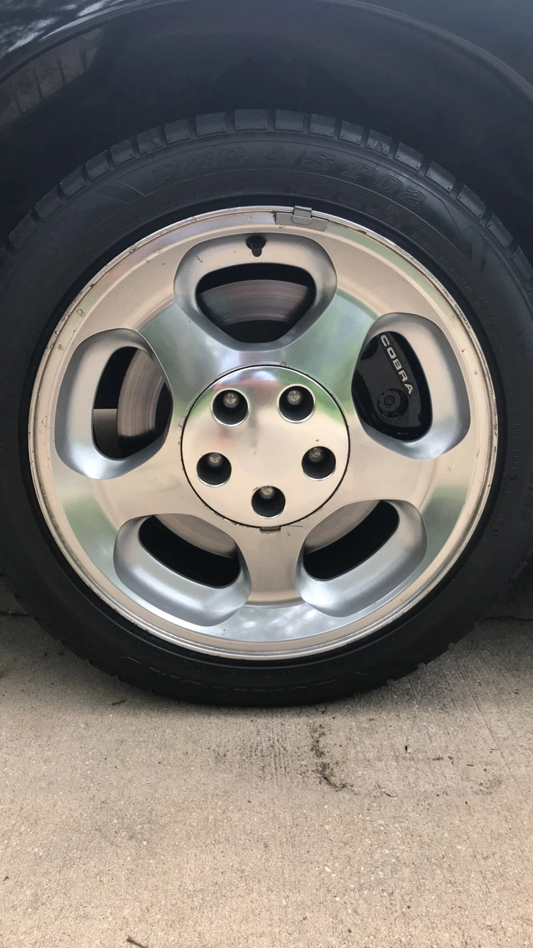

Also not sure if I mentioned in here but we picked up a set of Cobra wheels that were a little rough and need refinishing. We’re planning to get two of them widened to 10 inches to retain oe look but more meet out back, best of both worlds imo. If you guys have any shop recommendations for wheel refinishing and or widening let me know. I’ll attach a pic if I find it.
