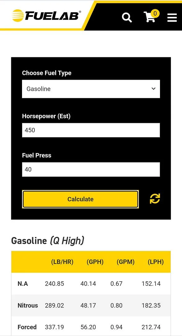

There are lots of fuel calculators available on line. Here's one:
https://fuelab.com/p-35856-fuel-pump-calculator.html
