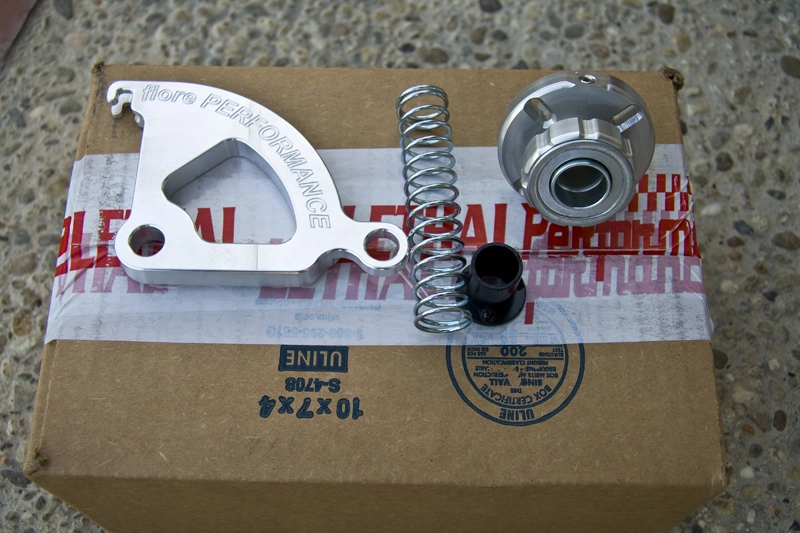

Want to adjust you clutch cable, then go to lethalpeformance.com and buy these 3 things.....
Fiore Quadrant
Fiore Micro Click Adjuster
LDC Clutch Free-play Mod
....You can re-use you stock cable and mod it or buy a new one. MM Sells a Free-modded OEM cable you can buy. Just stick with the fiore quadrant and Adjuster, they are the best hands down

I have been using the Steeda kit for 2 years no problems. It came with an non-adjustable OEM cable, double hook quadrant, and a firewall adjuster. I did have to mod the end of the cable at the firewall adjuster, which was just a matter of cutting of the OEM bracket.
I will say the Fiore adjuster is nicer because of the "click adjustment". Most important would have to be the initial adjustment at the clutch fork end. That is where you obtain the best pedal position and medium point. The firewall adjuster will fine tune it.
