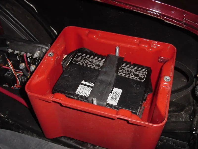

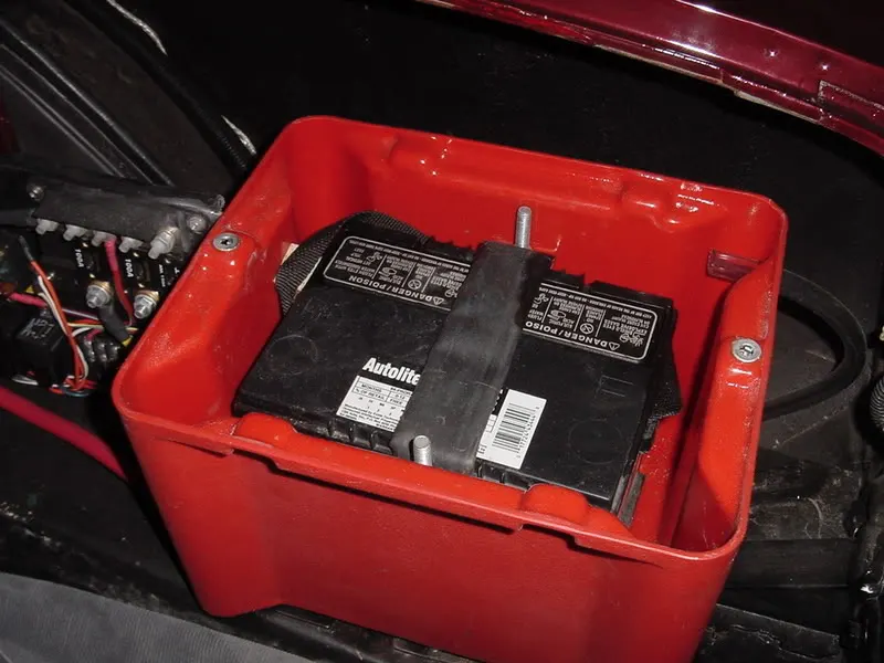

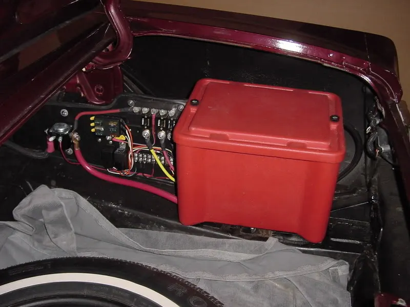

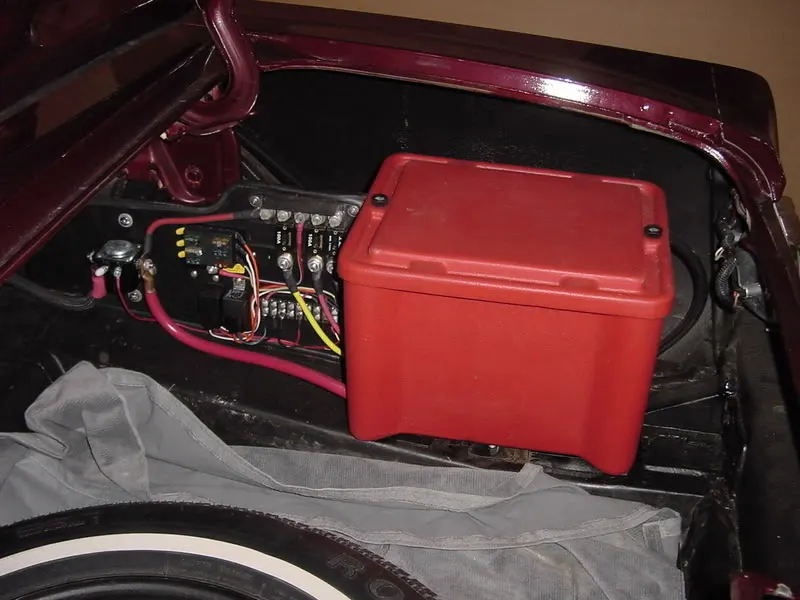

I have the summit plastic box, but I thought it was big. I mounted it with the two long threaded rods that came with the kit, and used 1/2" - 1" wood blocks under it to support and level it over the right frame rail. I also cut off the spare tire hook bracket to make it sit good. The vent tube goes down to the factory hole that normally has a plug it it and the tube sticks thru about an inch. The fuse/distribution panel was kinda overkill, but I was planning for future mods. I finished it back in July... so far no problems.

ok i think i see a bit of the problem....when people say they are using the Summit box, it must be the one you used.
I just pulled up the Summit site and you have the Premium Box.
Mine is the dinky little one that you most commonly see in boats :bang:
You've done an awesome job and the pics really show it well.

I love the way you ran your wiring and fusebox... do you have a picture of your engine compartment? i am wanting to rewire my car and do stealth wiring on it as much as possible
What part were you interested in? It's hard to get a picture of something you can't see very well. I routed the Starter cable and Alternator wire through grommets just below the heater. I might have issues when I add headers someday, but There is plenty of room I think.
