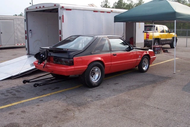

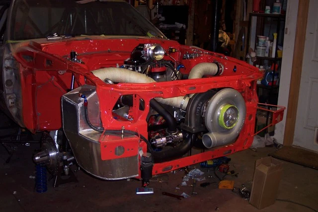

my last turbo project, it had 4 eyes and a mouth
so that turbo could eat!

:drool: Details?
Ditch the Cobra logo and that thing is just about perfect!
I assume you mean me, and you mean these details: 363 c.i R 302 block, TFS R heads, Methanol injected 2 150 lb injectors per port on a custom Super Victor intake, 11.5:1 CR, 95mm Borg Warner turbo running 39 lbs boost, 95 mm TB, Exhaust exited in front of engine and ran through fenders came out behind front tires, No radiator completely dry block/heads, Huges UltraGlide,
4000 stall conv 3.73 gears in a super 8.8".
1653 hp 5.09 1/8th
1653 hp 5.09 1/8th
this takes bad a$$ to a whole new level! very nice
