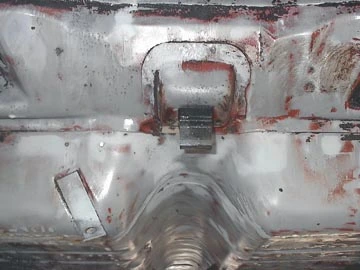

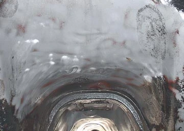

'cause today, after five days of wet weather, we got back to work on "sally"
Sandblasting is done.
Undercarriage washed clean.
Undercarriage has been "Metal Ready"-ed.
Undercarriage has been rinsed.

Tomorrow will be POR15 day.
Friday will be seam seal and undercoat day.
After that, it's just a matter of bolting everything up!:banana:

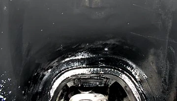

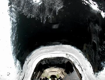

This morning was "POR15 Day", 20 minutes of set up and 20 minutes of clean up for 5 minutes of spraying, and here's the results..........:
attachment.php
attachment.php
If I can complete the seam sealing and undercoating early enough tomorrow, I may be able to install my brake lines / cables, and fuel lines tomorrow, otherwise I'll get them in Monday morning and start the rest of the reassembly Monday afternoon.:nice:

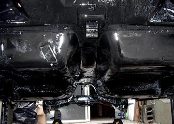

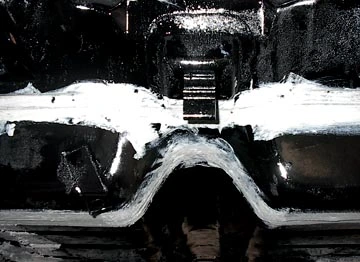

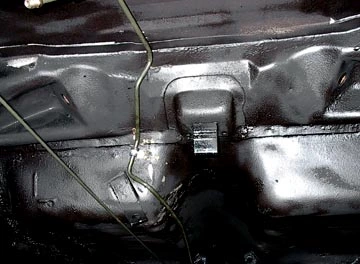

Well today is the day.......Seam sealing and undercoating, and mebbe perhaps if there is enough time and the undercarriage cures enough, I might start bolting stuff back up........fuel and brake lines, brake cables...........:nice:
As is the undercoating............
attachment.php
I've got the fuel line and the brake line hanging, but I have to wait until the undercoat finishes curing to finish installing them, 'cause I'm smearing the undercoat as it is now.....:p
attachment.php
BBFCM waiting for the undercoating to dry.......
