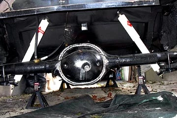

Most of the old undercoating came off with lots of elbow grease and a scraper (Zip Strip to loosen it) the rest of the stripping was sand blasting.
Looks like I got the underside re-coated none too soon....it's ANOTHER wet and miserable weekend forecast.....should be dry Monday (finish install of the brake and fuel lines and possibly the springs and rear end!):nice:

Game plan for tomorrow....:
Finish install of brake line and fuel line.
Install P-brake cables.
Install leaf springs.
Install rear axle (incl..: connecting brake line, p-brake cables, vent hose, and install of shocks).
Then if there is still daylight.....
Install front rotors.
Install calipers (incl..:connecting brake lines)
Then it will just be a matter of lubing the entire front end and bleeding the brakes.
After which, I will get to sit and wait, wait and sit, sit and wait, wait and sit, etc., etc., etc......until my tyres arrive.
But I intend to finish pulling the underdash electrical, cleaning up all the errant sand from inside the car, work on the passenger door, possibly work on the engine (still gotta strip and paint), clean up the tranny.........
I also need to get a new poly tarp to wrap "sally" in this winter. Her old one is rather threadbare.

Looks really, really good! How does the seam sealer work out with the POR-15? Do you paint the whole underside now to cover the sealer? Rear axle looks good too! I just hope it works.
Seam sealed AFTER POR15, Undercoated the entire undercarriage. As for that "new" rear working.......the wheels still turn by hand! Thank you!
