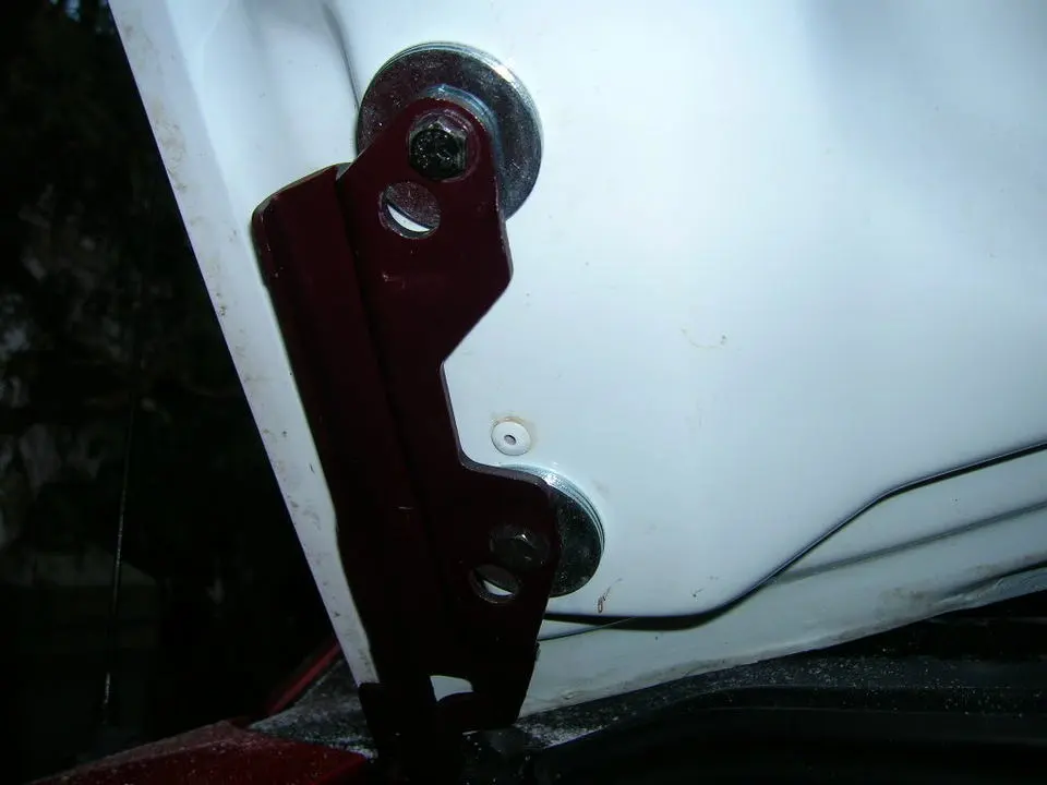

Today i started fitting the hood on the car....WHAT A BITCH! First i needed to find out which bolts to use to bolt the hood to the hinges. They are 1/4" course thread bolts...
Next i had to shim the hood with body washers to get it to sit flush with the fenders...

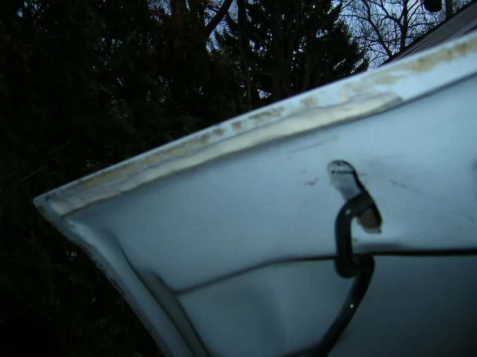

Then since the hood was contacting the top of the headlight housing on the passenger side, i had to grind some of the inside of the hood to make it fit better...

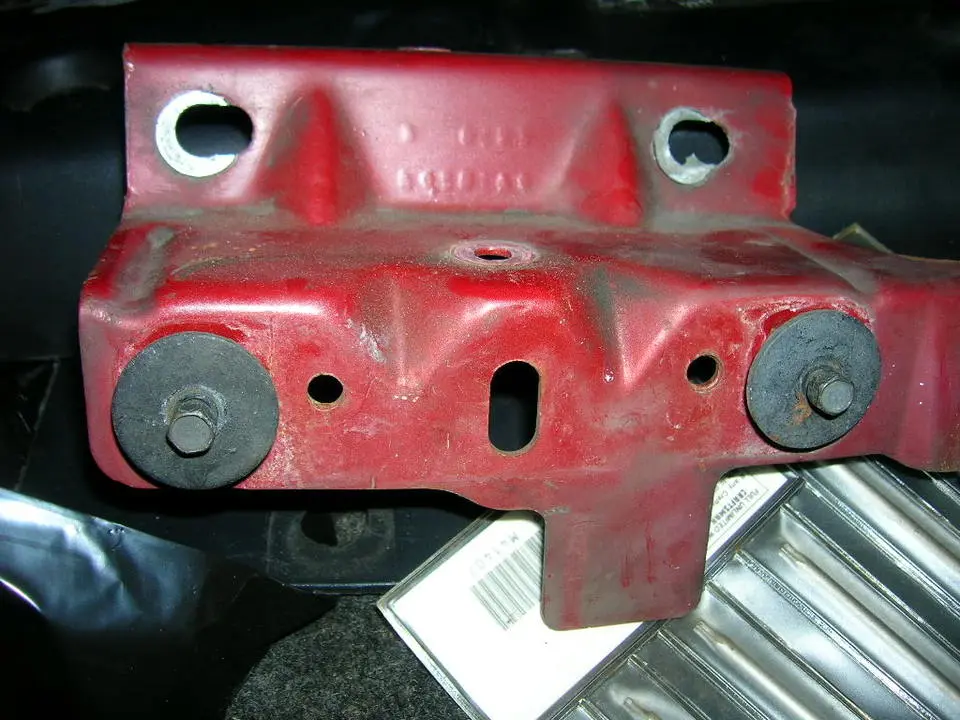

Since the hood STILL wouldn't catch onto the latch, tomorrow i need to drill out the latch mechanism bracket because there are 2 guide holes that are preventing me from moving the latch up on the rad support....Those holes need to be redrilled about a 1/4" up, so the pins will fit in...

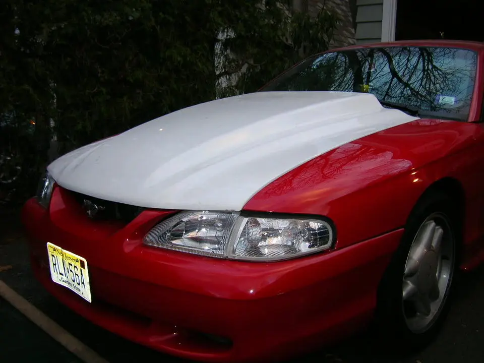

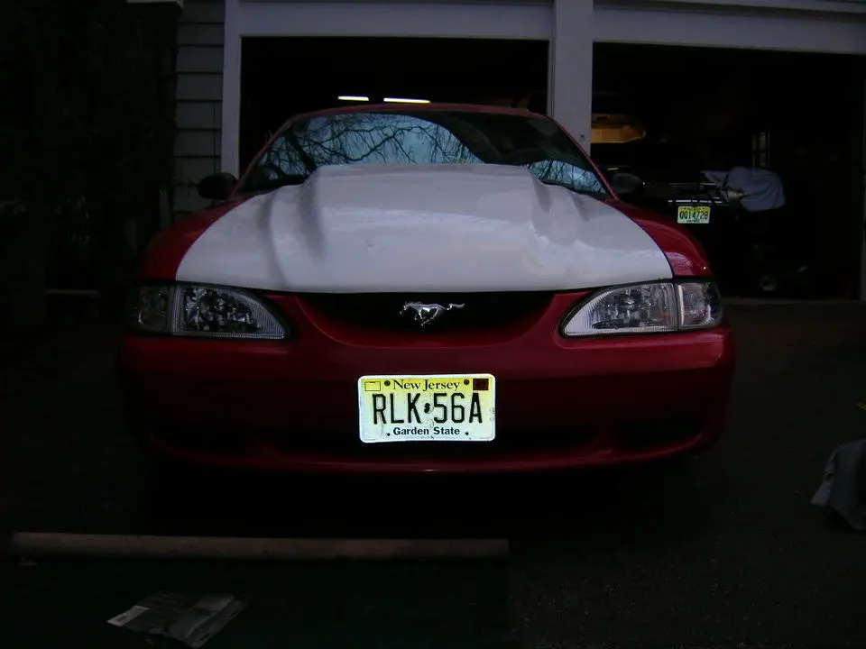

And heres 2 exterior shots so far...

UPDATE: the hood is on! after about an hour of fooling wit the latch, i got it to sit just about flush with both fenders....its a little bit high on the passender side by like a 1/16" of an inch which i may live with, but i might also just sand it down some before paint...

im gonna be honest...i heard a lot of great stuff too, and im very impressed with the quality of the hoof and the seams on both sides are perfect, but it took a decent amount of work to get to fit right...i needed 3 fender washers on each bolt on the hinges to get the hood to meet up with the fenders, and i spent about 3 hours adjusting the latch, and those bolt holes to get it to sit right in the front...i also had to grind off a bit of the fiberglass on the passenger side front lip cause it was hitting the top of the headlight a bit...overall, its a really nice hood, and i got a great deal on it...:nice:

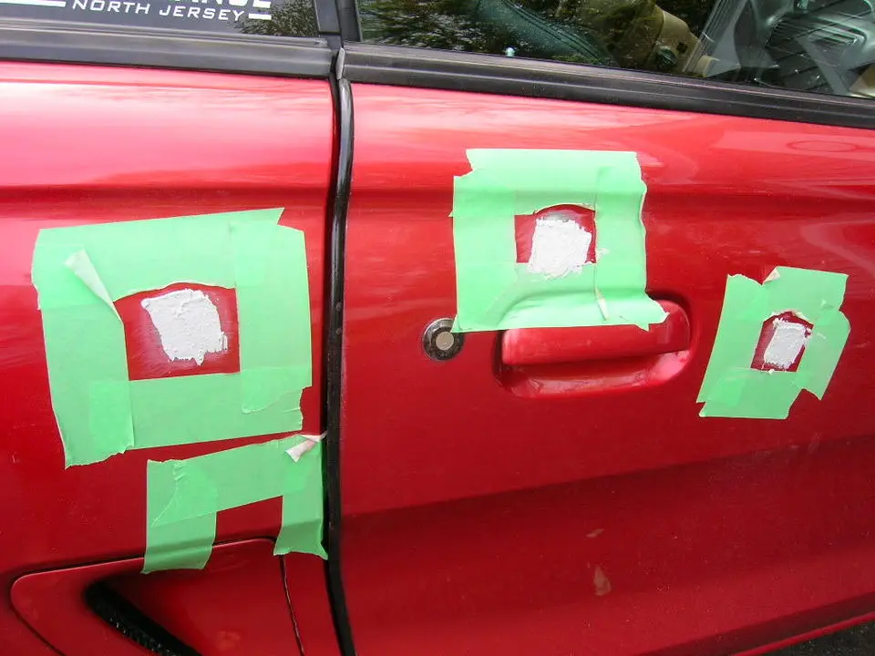

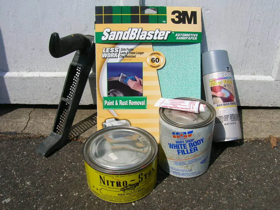

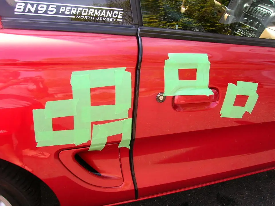

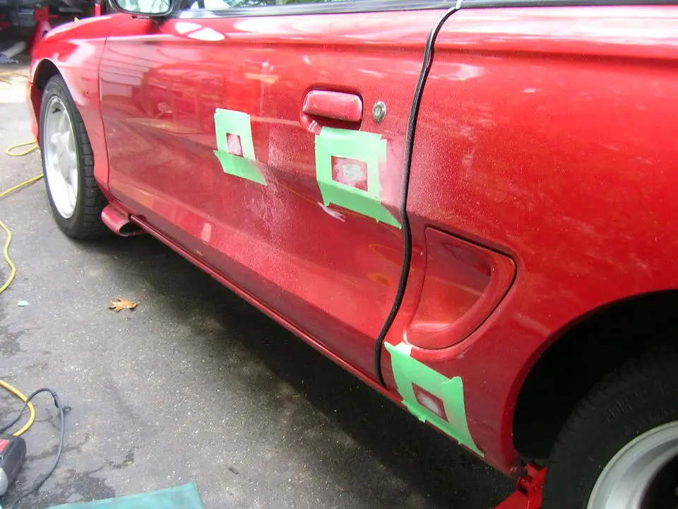

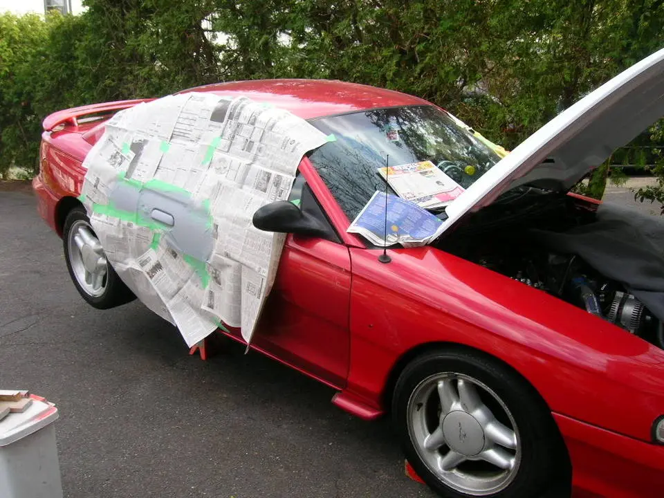

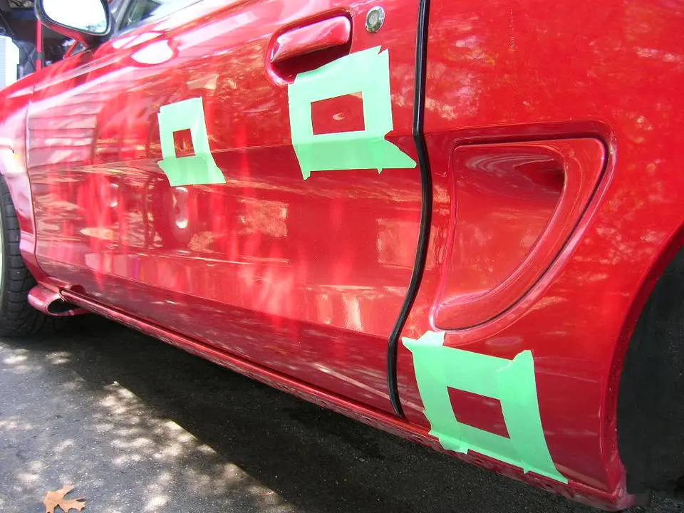

UPDATE: Well guys, its comin along nicely. This morning i was greeted by great weather and took advantage of it. I filled all the dings i wanted to on the car, then primered them. Heres some pics as i went along...
Materials: 60 grit auto sandpaper (great **** and lasts so long), bondo, red lead filler, primer, cheese grater (didnt use it)..
Took the side skirts off...
Masked up all the dings...
Sanded all the paint off around the dings...
Bondo applied...
Dings primed...
Even thought this took me all day in and out, it was pretty simple. Tomorrow i'm gonna fill all the sanding lines with the red lead putty, sand it out, them prime it again. This week sometime im going to get the paint from the painter, and spray the edges and underside of the hood, and teh edges of the new fender im gettin because the drivers fender was killed by AAA.

NOOOOOOOOOOOOOOOOO!
I realize that you're trying to minimize the amount of panels that you're going to have to paint, but by masking off the area like that, you're more likely to notice the fix by the hard lines at the paint mis-match. I figure that you're probably buying paint matched to the color code of the vehicle, but '95 has had 11 years to fade to a slightly different shade.
If you don't feather and blend the new paint into the old, you're going to notice the fix. The next best thing to painting the whole car is to do whole panels. The seams between panels help to mask the fact that they can be a few shades off.
